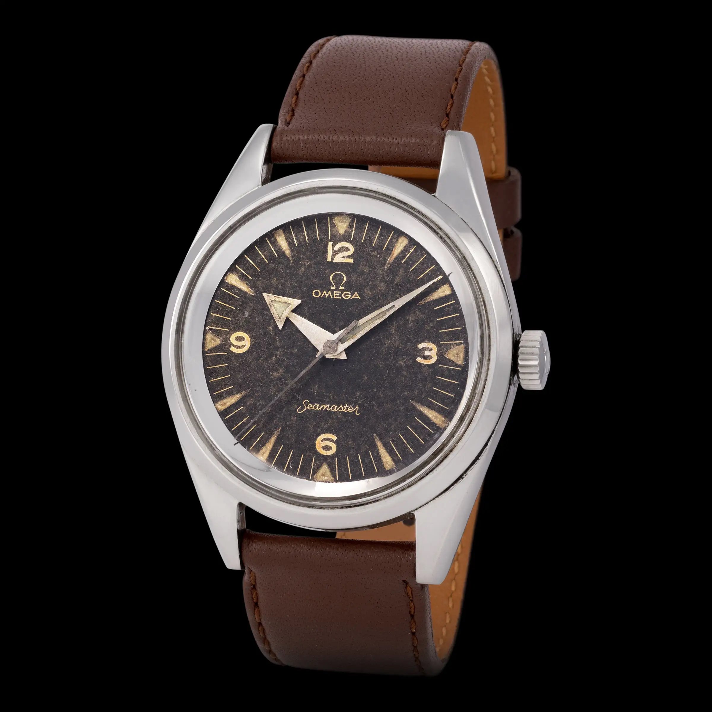

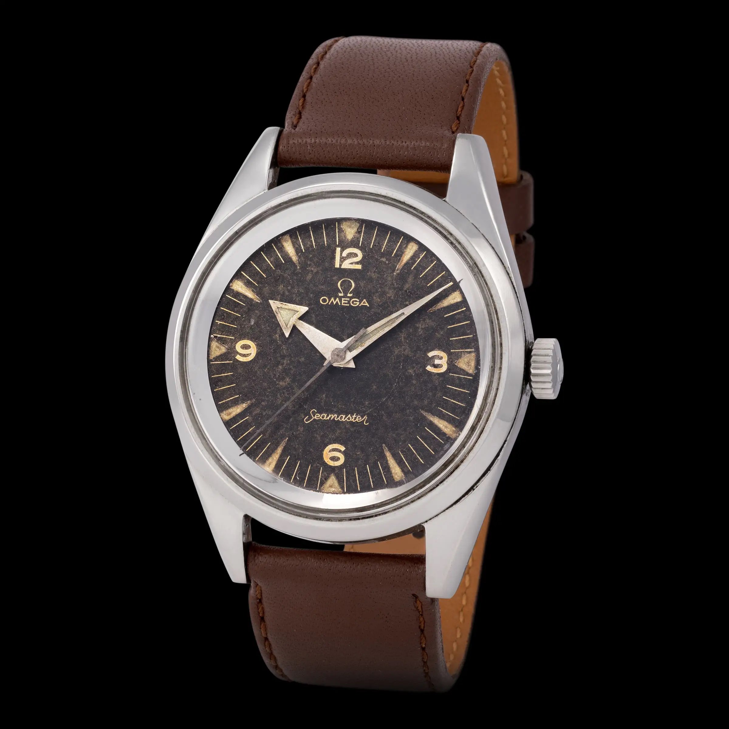

An auction house that makes as much fanfare as these guys do about their lots should do their homework, especially when it's so obvious and easy to deconstruct everything that's wrong with this PAF Seamaster being offered.
A picture to start with (more at the link here).
1 - The dial is clearly incorrect. With it's coat hanger S, and even the radium burn on the dial, it's from a 2914-5.
2 - Even the BA hour hand and the second and minute hands are from the earlier Railmaster reference, not the later 135.004 which should have the thicker syringe like hands.
3 - The caseback serial number don't match the movement serial number, which is never the case with these.
Bidder beware!

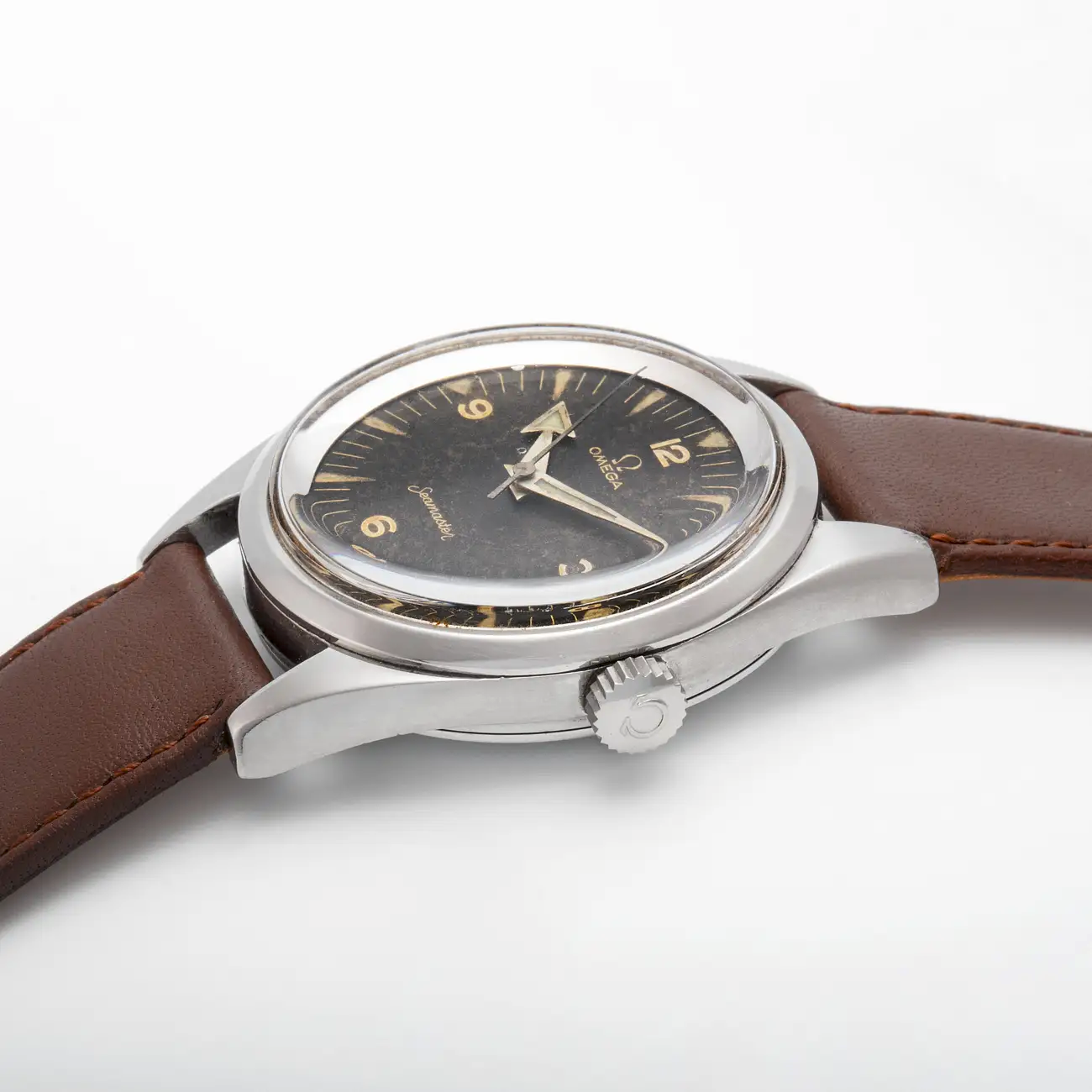

Look at that featureless case! These auction houses use strange image processing on their watch pictures. Care to comment @JwRosenthal ?

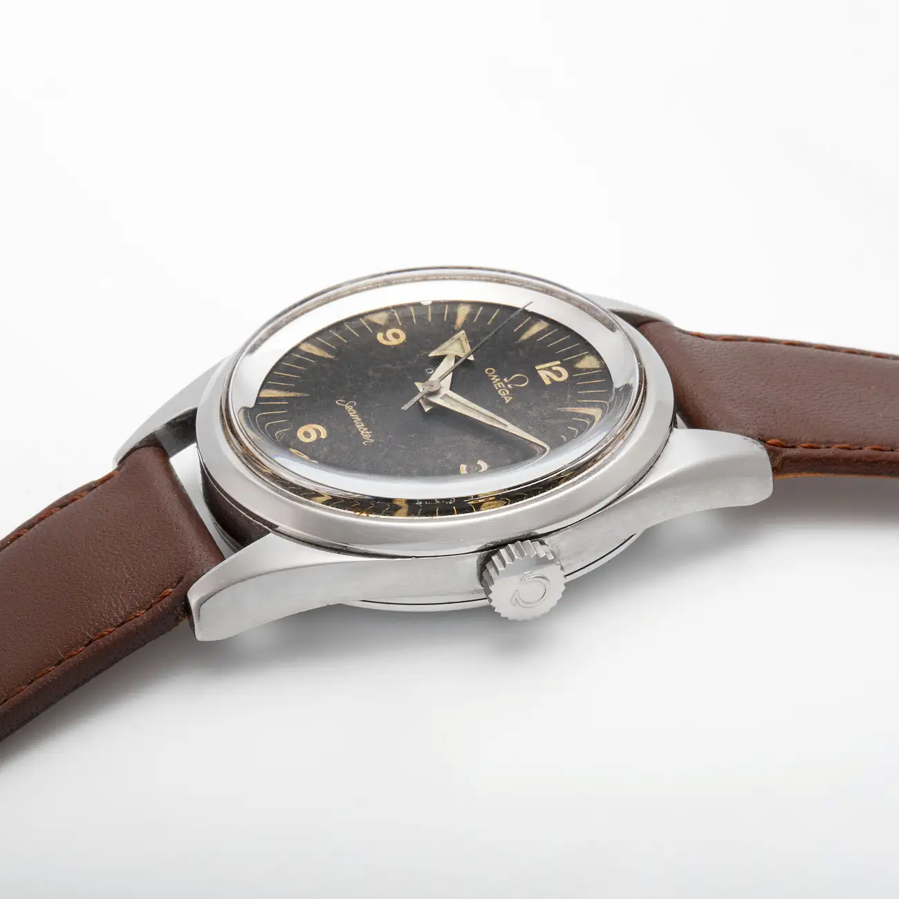

The shadows from the second and minute hand on the rehaut speak to directionally of light but you really don’t get a sense of any directionality with the rest of it- I’m thinking this it a composite from several shots stacked or HDR. Possibly they moved the light around and erased down the layers of deep shadow or spectral highlight, particularly where it has omitted any trace of the crystal (unless they removed the crystal for the photo). The result is a flat and unnatural looking image (or they ran it through an AI filter). Falls into the camp of just becuase you can doesn’t mean you should.

I mean, look at that case: it looks like a CAD rendering from two decades ago.
By the way, image processing aside, the upper lug is quite polished. The lower lug still has an edge at least.
Jeez-us. 🤦 That is absolutely shocking, isn't it? Good spot, Sir.

The difference in corrosion/patina between the dial, hour/minute hands, second hand and rehaut are all I need to see to stay away.

While the PAF models, due largely to military use and bad, local, country specific servicing, aren't ever in the best condition (the one's that I have are all suitably banged up, but there in lies their vintage charm), they are appealing when period correct/complete. The problem with this one is its a Franken/put together piece. But that's not the worst part.
The worst part is the misleading confidence in describing it with implied authority - using words like "very rare", "attractive" "meticulously preserved" "fewer than 100 pieces" - most of which is bullshit (the 2914-5 PAF variant was produced in 177 pieces and the later 135.004 in seemingly in higher quantity, though exact exact numbers of that latter reference are speculative an unknown). This is beyond comical.
What's worse in the narrative is some gibberish about this model being "crafted in 2 versions". There were 2 references of the Railmaster with Seamaster dial made for the PAF and multiple later references of the Seamaster made or commissioned for PAF going into the early 80's, so their facts are merely an assemblage of unrelated information just thrown together to sound coherent.
I am convinced ChatGPT could have generated more accurate and useful publishing material to go with their advert.
