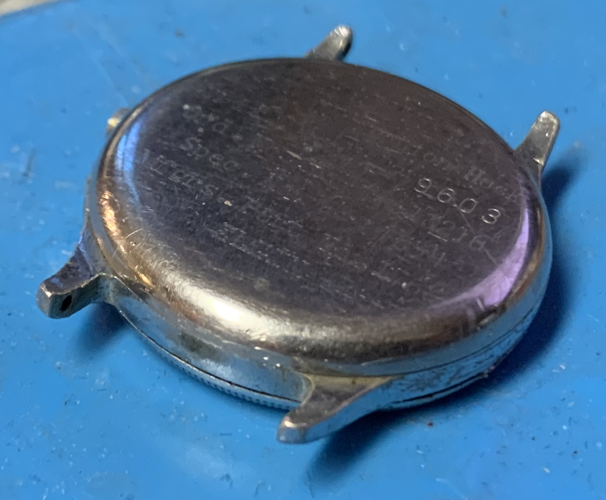

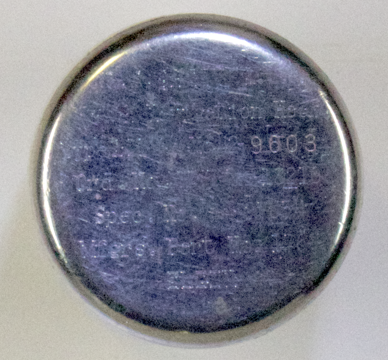

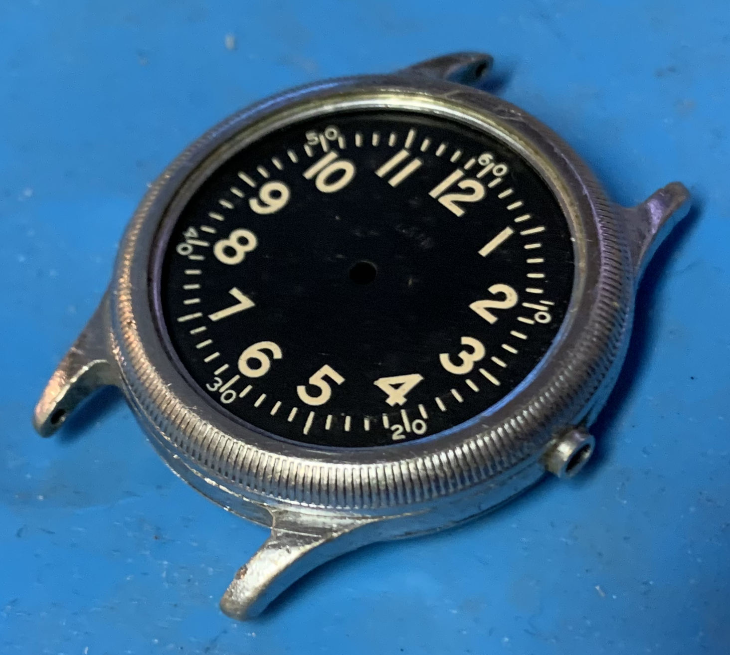

While sorting through some watch backs I noticed one had faint almost unreadable markings. (which I Have been unable to photograph.) I was able to make out some words like US Army and Elgin.
Further angling with the loupe I was able to extract the following text.
US Army A.C.
Watch Navigation Hack
Type A11 Ser. No.42-9603
Ord No. W535ac-18210
Spec. No 94-27834
Mfgrs. Part. No. 1768
ELGIN.
I did a search on this and found a video on one of the You Tube repair sites. Further searching showed what a typical case looked like. That seemed familiar so I went to the drawer of case cores and found one that fit the back. I then went to the box of dials and found a dial (actually 3 dials.)
There my luck ended, I do not seem to have any Elgin wrist movements that small. Plenty of Elgin pocket watches, 1/3 of a drawer full. I have plenty of balance staffs (way too many staffs a whole cigar box full. plus one of those bestfit assortment cases. Perhaps something will turn up when I am not looking for it. Have lots of hands too so it is probable I may have some hands.
Still it is pretty neat I can match case parts and dial parts. Not sure what I will do with this, Seems these are fairly common and do not sell for much online.

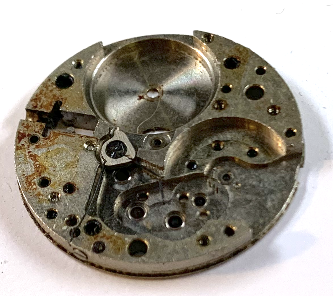

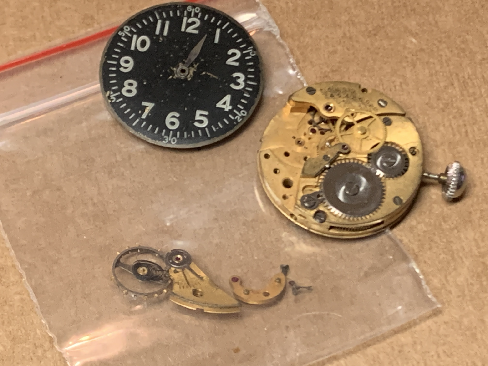

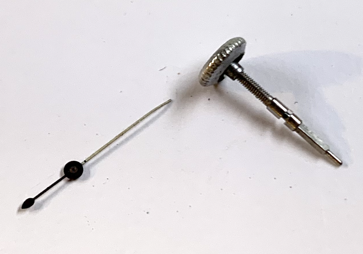

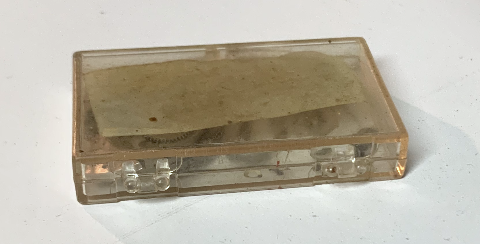

These are the hand and crown I found. The crown is quite worn, but the evidence is that this is a stem for an Elgin 539. I found these in an old pill box too small to contain a watch. (or so I though.)
Of course I was not expecting to find any more A11 parts. I looked for this last week with dedication. What I was looking for was a case back that might fit one of the Landeron 48/51 cases. As noted in my recent thread 'Sacrifices to the Floor gods ...' I went down a rabbit hole this morning based on an old post which was recently liked that pointed out the subtle differences in watch calibers, and a link to an archived site which detailed said differences.

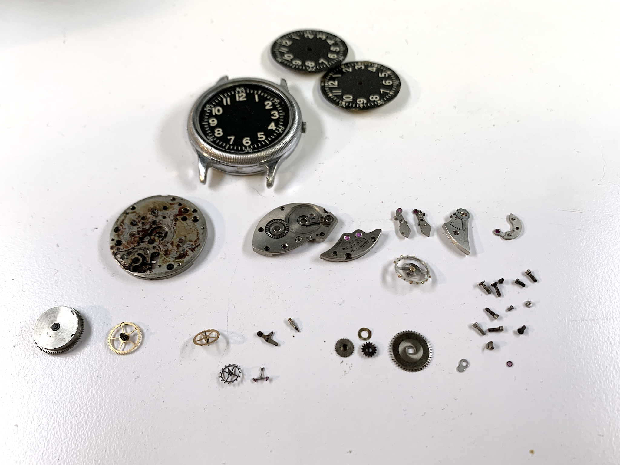

So when I did spread the parts in that pill box out I got this:
The case and dial I found earlier included here for completeness. It is evident though that this seems to be a parts movement. There are two seconds hand bridge, but no wheels. The balance is pivot less, which is not surprising. There is also a lot of oily rust residue, that I would almost state was cosmoline, what a lot of ordnance is packed in.
Not sure if this find is a good thing or a bad thing. I have dozens of project watches, with more on the way. (If selling was not full time work, I would probably list the ones I am not likely to get to in this phase of my passion for watches.) Still this sort of feels like finding a bunch of loose change behind the sofa.
Perhaps the missing hands will turn up. I have a lot of hands, The loose ones go into empty parts bottles. That though is another thread unto itself for another thread in some distant future.

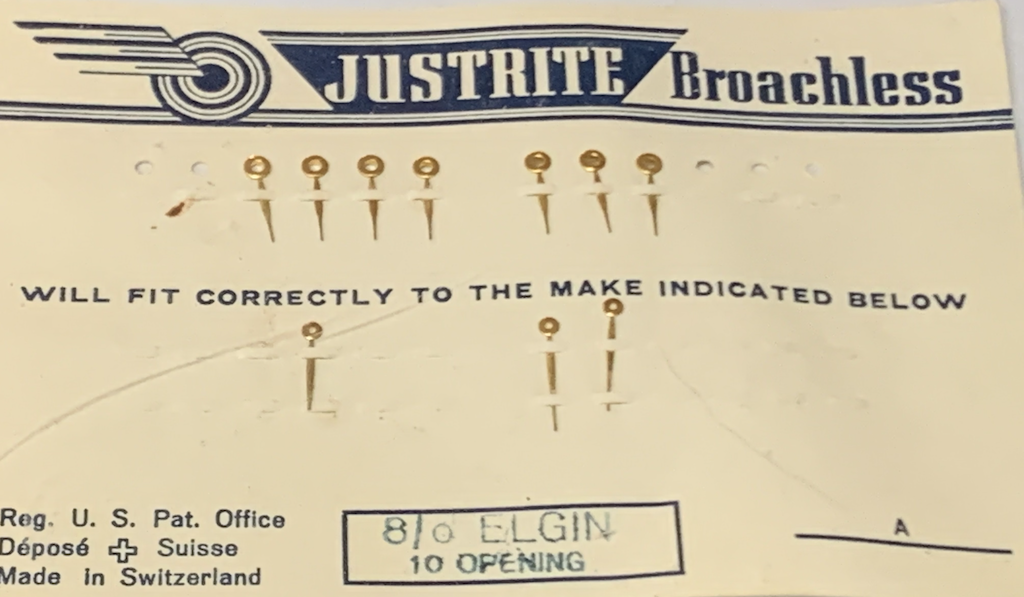

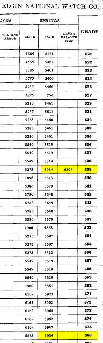

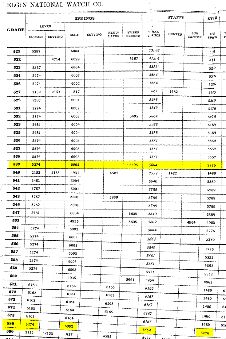

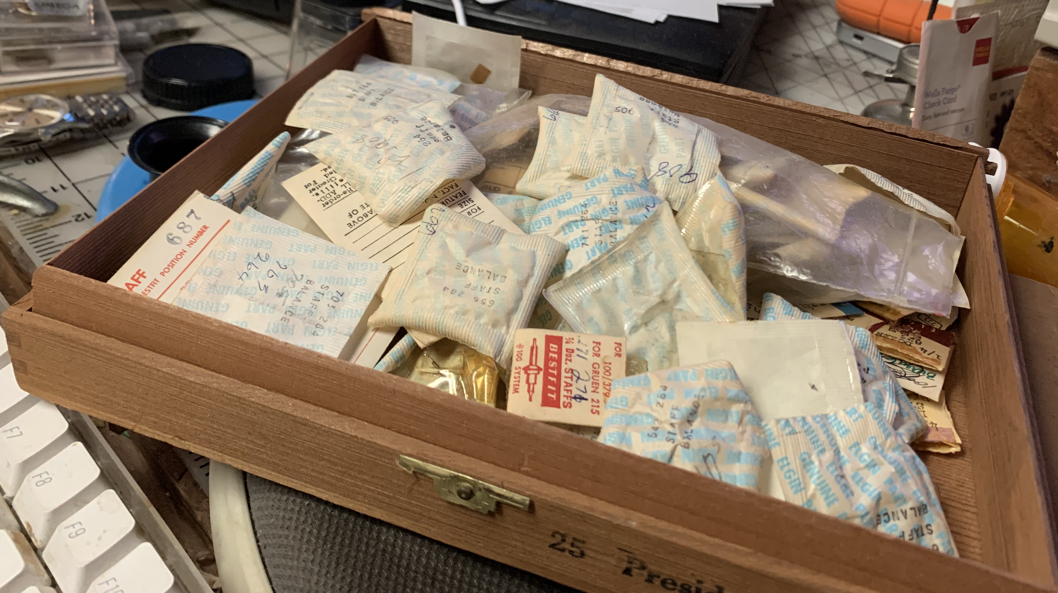

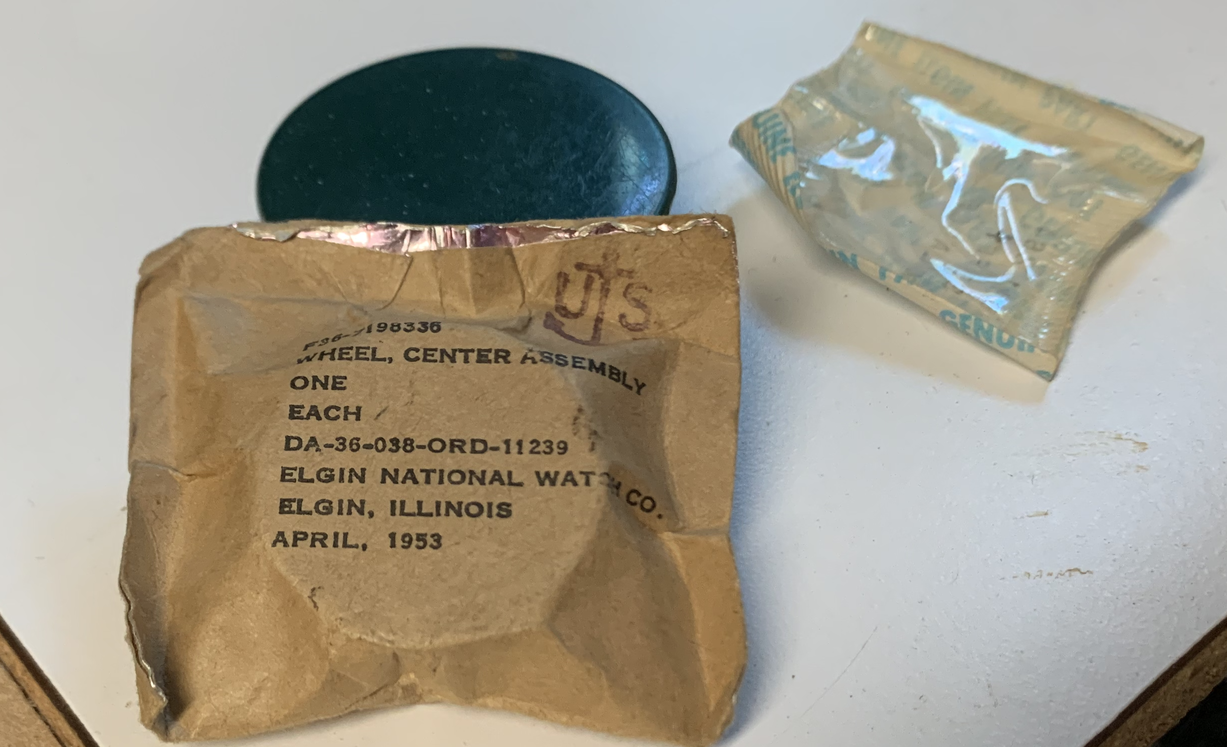

I did take another trip down the rabbit hole. Partly as I had this package which is still sealed. I was also able to cross reference what may me the correct balance in my large cigar box full of Elgin staffs.

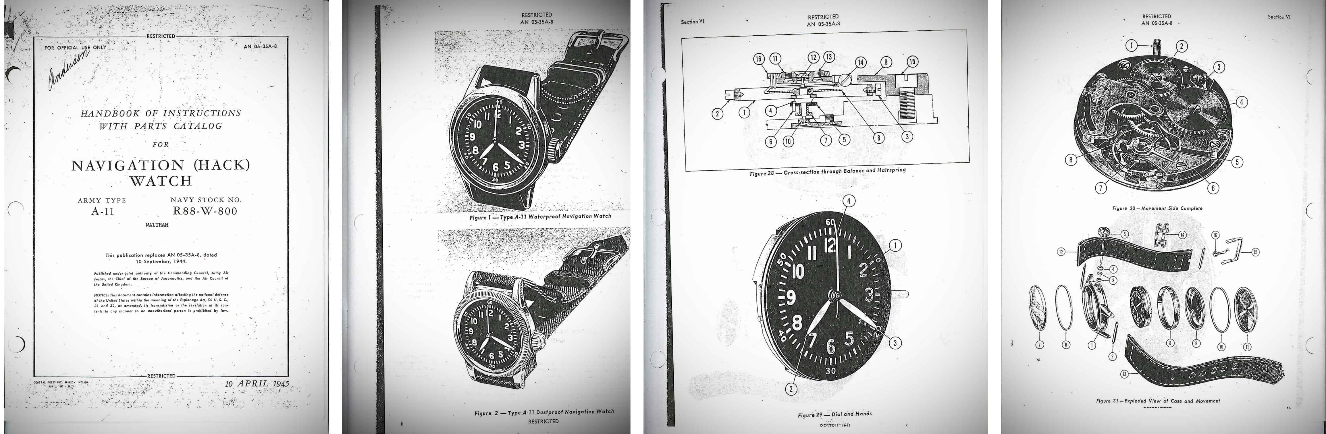

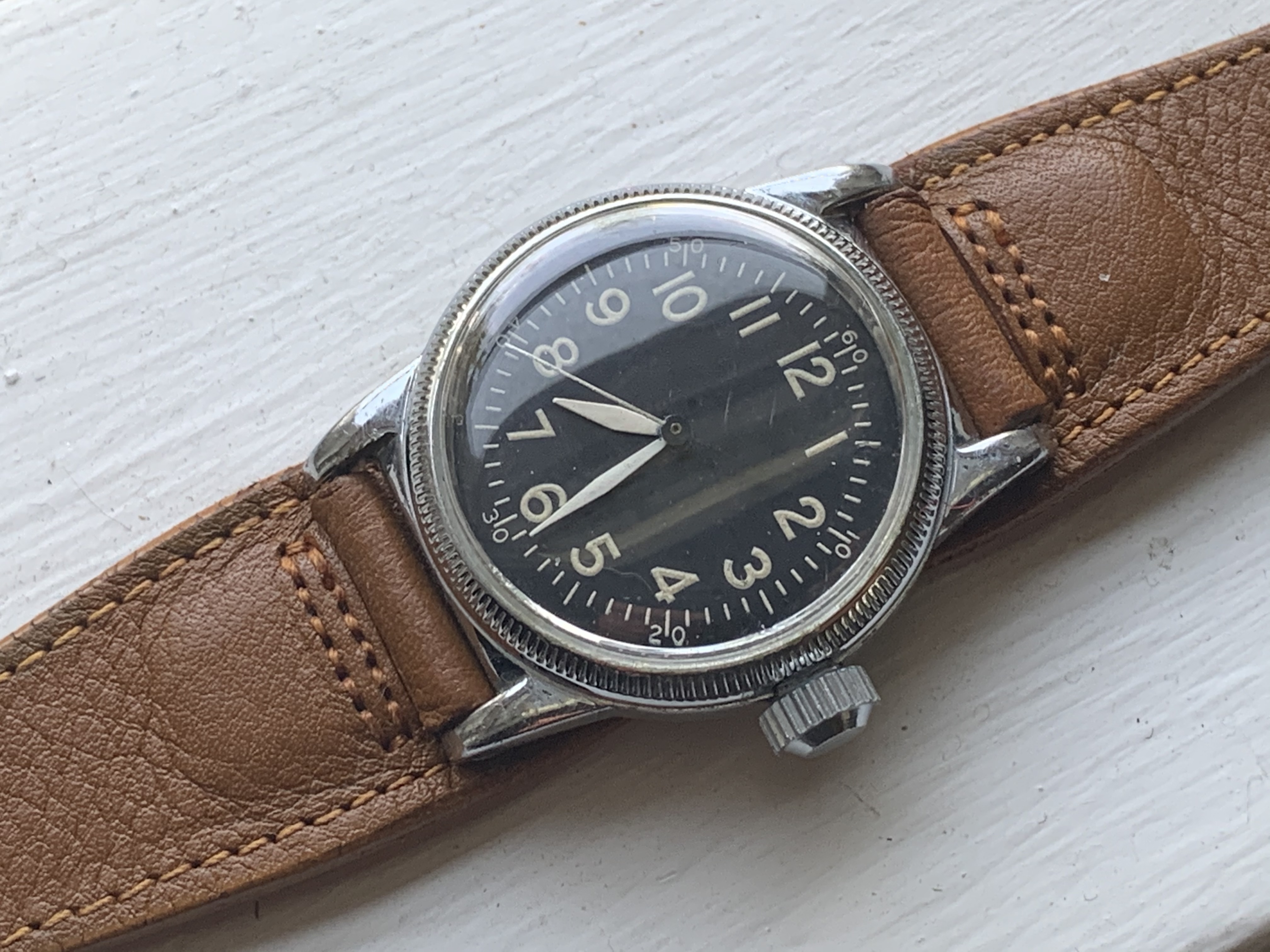

There is also a document 'TM 9-1575.pdf' which can be found with a simple search. This image is also easy to find and is probably posted elsewere on these forums or related ones.

Case example the photograph above of the sealed part. It is hard to know what model this fits. Opening the package would only destroy it. Of course it it was the part I need, I would do so, these are not that uncommon.

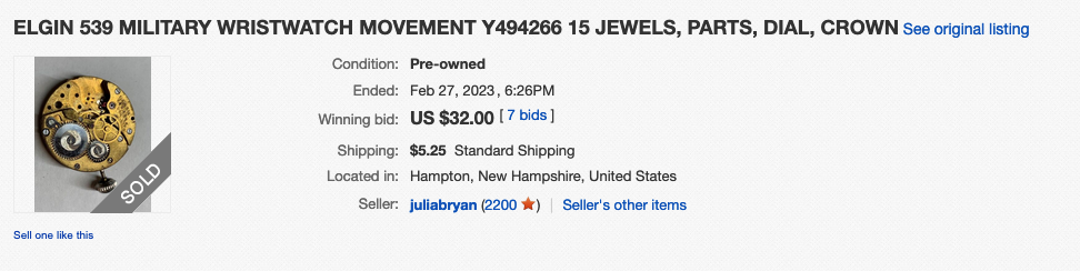

I have been keeping a search open for Elgin 539 parts for this. A few weeks back one came up for auction. I jumped on it and got it for a good price.
Usually these seem to go for closer to 250USD and I have seen dials go for 90.
This evening it finally came.
Looks like it is mostly there. Hairspring got tangled, but the movement I want to restore has a decent balance.
The dial looks a bit like it was in a fire. The hand is blued at the root. The numerals are grey and do not pop like they do on the other dials.
Since the movement parts I found in the junk drawer has the sweep hand I am surprised the other hands did not turn up. I did find some gold leaf hands online when I was looking for Omega 351 hands.
My plan was to paint them white.
I think the balance assembly is shared with the 554. I have a number of balance/hairspring combinations which are likely candidates for staff replacement.
These may not have been the parts I was looking for, They are the parts I found.

from the elgin chart I have, the 554 balance staffmatches the 539 but only the 580 has a matching hairspring ... not sure if that matters
3,017
4,789
I have the same chart. I call them the 'rabbit hole map.'
