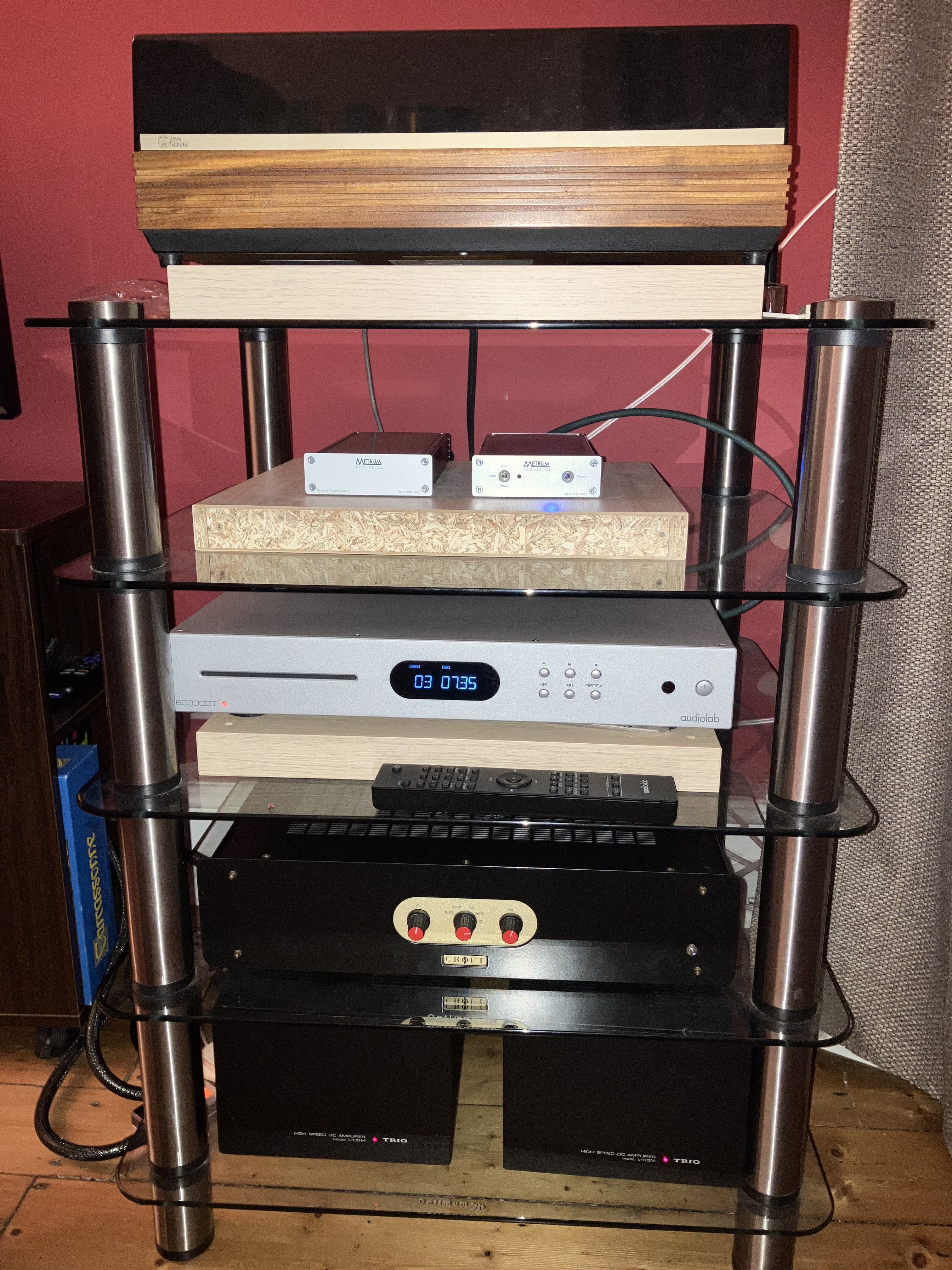

So here’s the upgraded set up from top to bottom:
Linn LP12 with Ittok LVII tonearm and Dynavector DV 10X5 cartridge
Metrum Acoustics power supply and DAC
Audiolab 6000 CD Transport
Croft Vitale pre amp (the only component apart from the speakers that survived the upgrade)
Trio L-O5M monoblocks
and out of the picture, a pair of B&Ws on the wall.
