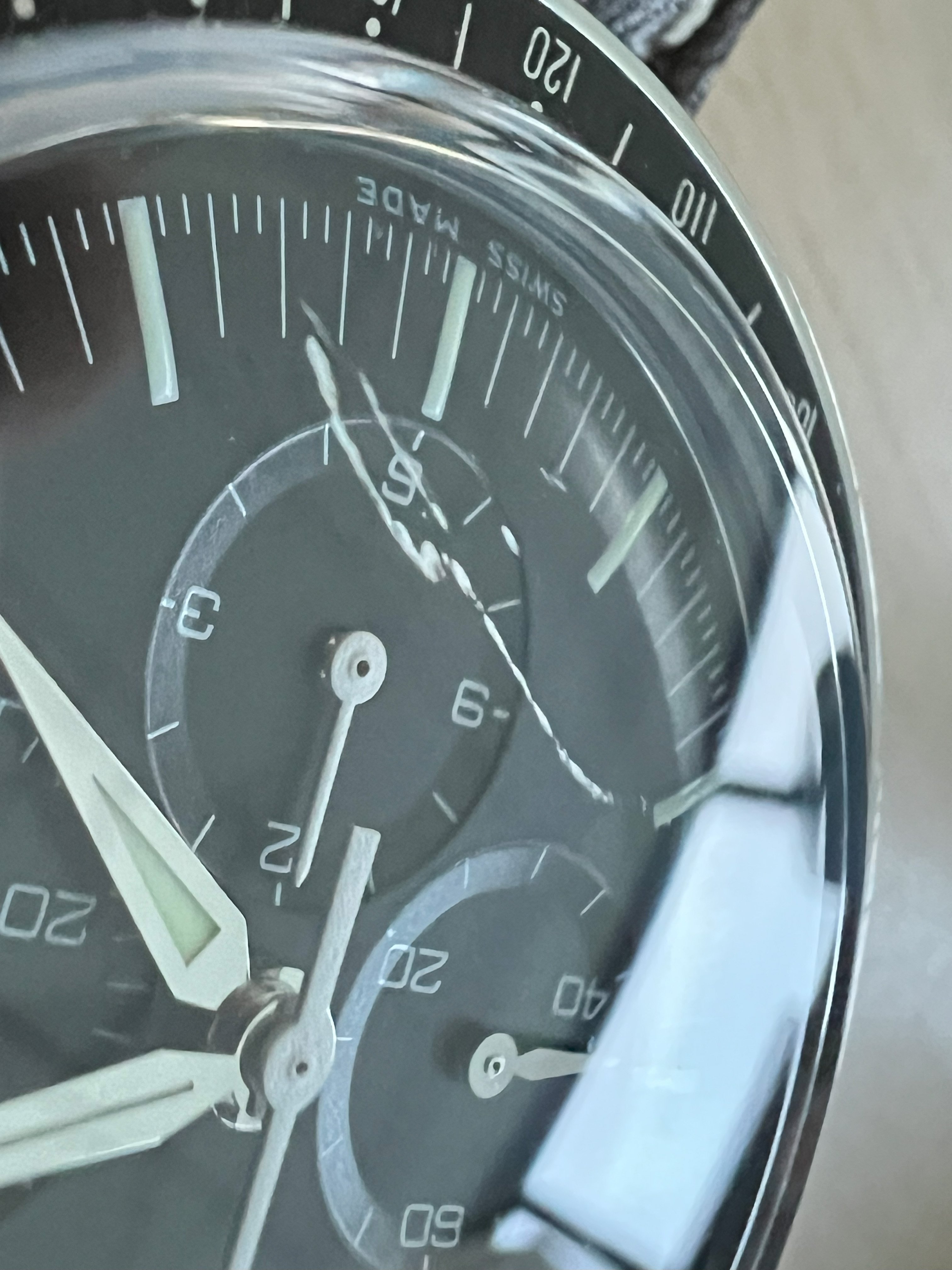

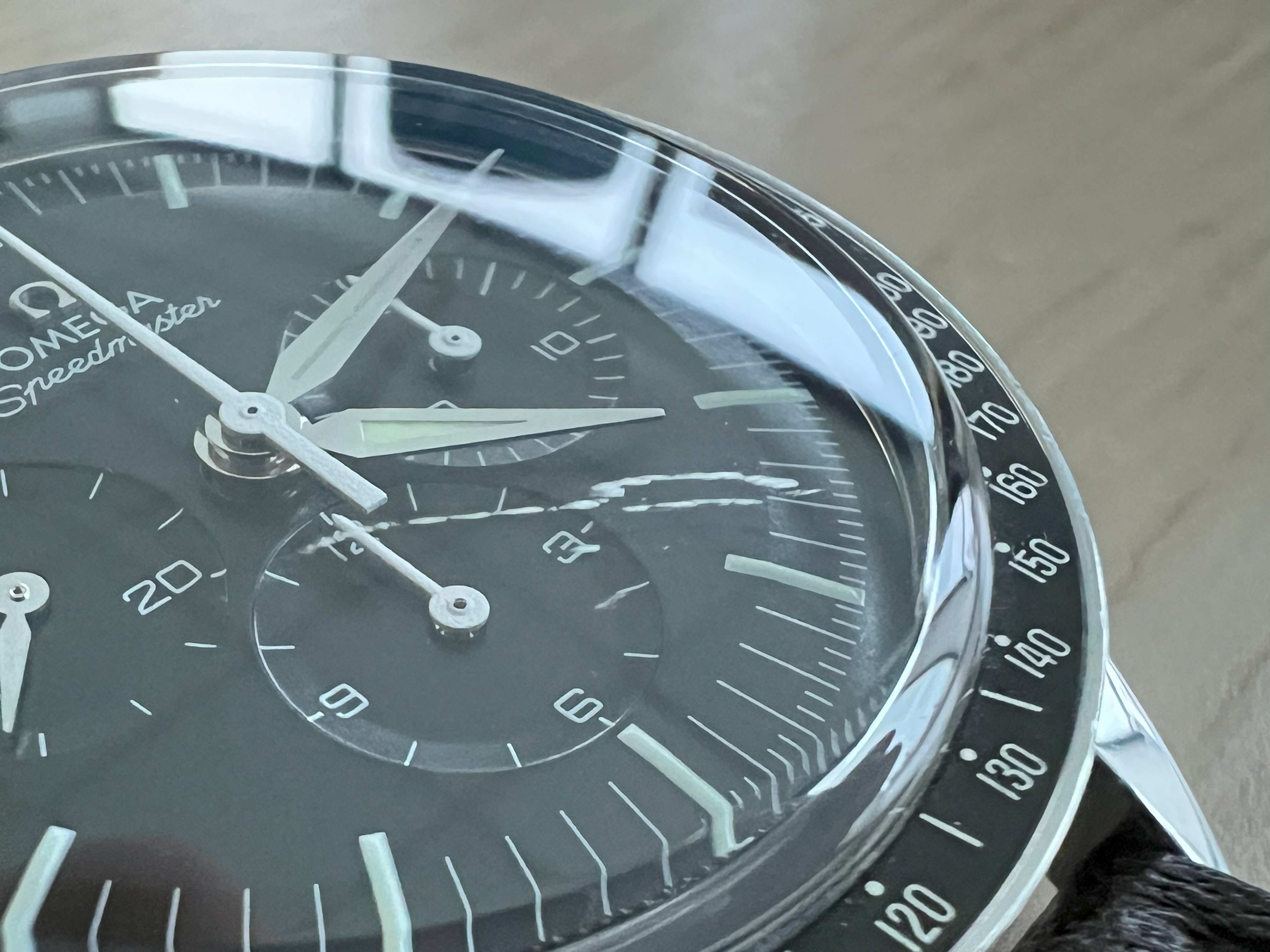

Hi all,
My FOIS hitted something and it damaged the front glass.
Is there away to minimize this (like hesalite for example) or must it be replaced ?

Looks like paint transfer from whatever you hit. Try scratching it off with your nails or something else soft and see if its still a visible issue afterwards.

Yeah, that looks like a transfer smudge. Try a light abrasive, toothpaste often works, and see if it doesn't come off.

I'd try a wet cotton swab, first with water, then you can try isopropyl alcohol, to get rid of the caught paint.

Thanks all for your positive answers.
I tried with my nails and wit ha paper tissue but no change.
Following yout posts, i gave a try with acetone, 70% alcohol, polish (for cars) but non of this worked. Scratche is still there and i feel the relief when i pass my nail on it

Strange.. it really doesn't look like a deep gouge to me but if it is then it would need to be replaced.
I'd try with poly watch and/or toothpaste as previously suggested. Even if it is a gouge, theres definitely also some paint transfer going on so cleaning that off would make it less noticeable. Then you can decide if you want to pay to replace the crystal.
Toothpaste didn't help more.
I'll pass by my local watchmaker some day (i need to retrieve some quartz watch he changed the cells on) and will show him.
If it needs to be replaced, depending on the price, i might leave with it and consider this is part of a watch's life when you wear it

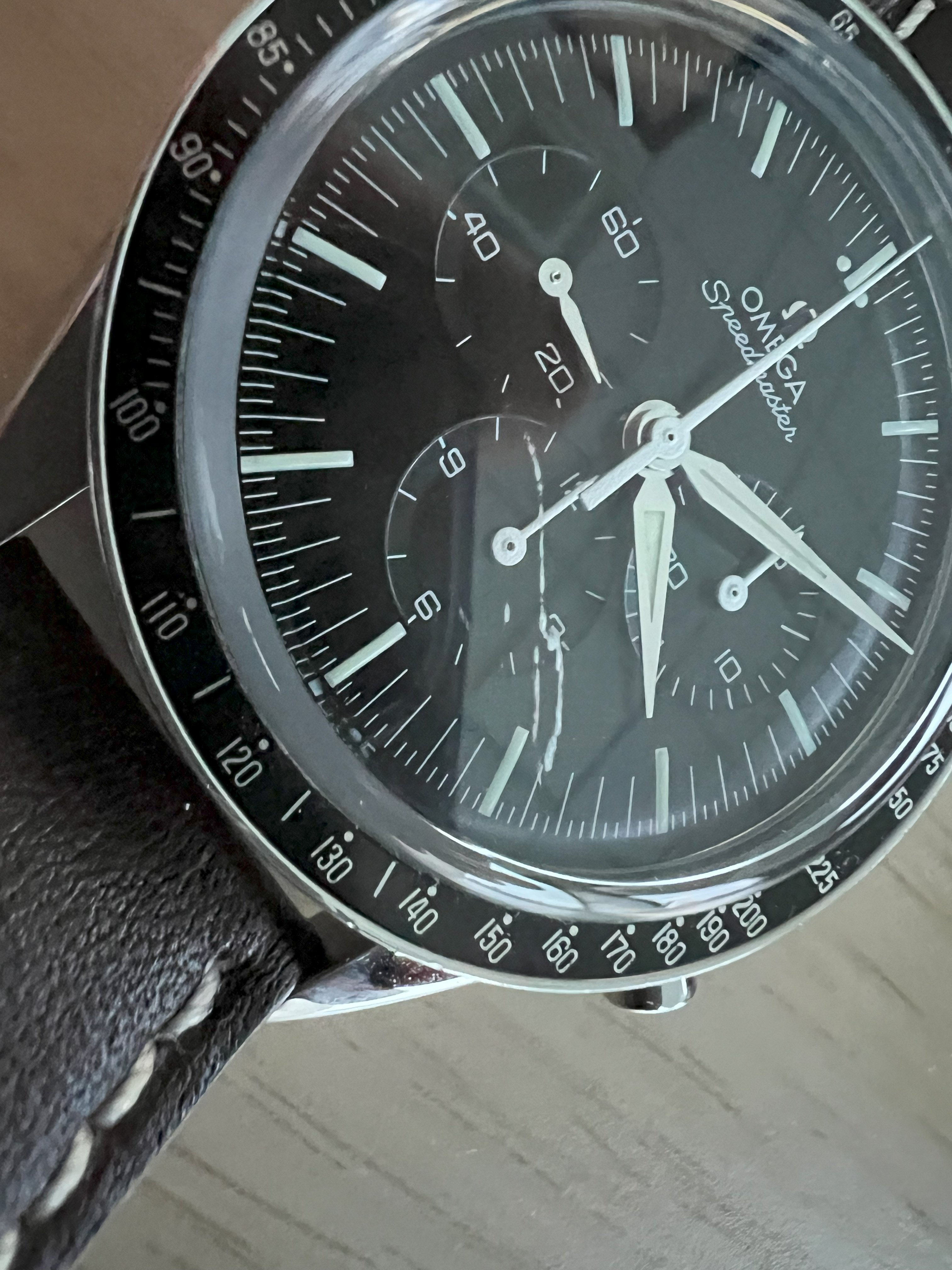

Exactly. Rubbish. It might affect the bezel though. Not much will mark sapphire. Or remove marks. Diamond paste maybe but even then not easily. If the marks we see here are paint it’ll come off. If it’s damage then the crystal is very expensive toast.

I used a small amount of Acetone, applied first on a tissue, and then i swiped the glass. I don't think i damaged anything with such a small quantity locally applied on the scratch.
4,136
8,855
Try using a chopstick to scratch it off. A chopstick is not going to damage your Crystal but may have enough mechanical advantage to remove this if it is paint transfer
