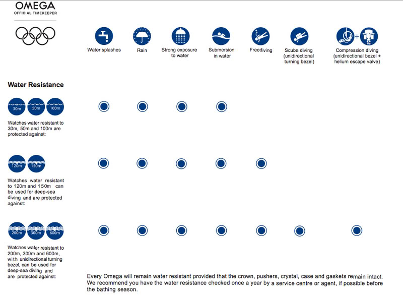

some of the most misleading statements in horological terms relate to water “resistance” 😗
Can you elaborate on what you mean by that?
Cheers, Al
372
1,222
Cheers, Al
When a customer who is not an expert buys a diving or similarly named watch that claims 150m 200m 300m etc..... your first impression is that it is waterproof and you can dive or wear the watch to that depth it's not until you really read up or have an issue you realise that this is not the case
29,671
76,830
But defects notwithstanding, it is capable of the depth that is on the dial or case. There's no mystery to be solved by extra reading - it is what it claims to be so if it says it's rated to 300 m, it can go to 300 m and more given the safety factors involved.
Cheers, Al
372
1,222
Cheers, Al
This one should I agree, but my point is that putting a depth on the face of a watch leads the buyer to believe it is waterproof to that depth not water resistant? i.e the water resistance chart.
29,671
76,830
Not really sure why this should cause anyone any confusion - the depth is the depth so up to that depth, no water will enter the case if the watch is used to that depth, assuming the watch was put together correctly in the first place, and that it is properly maintained.
372
1,222
That’s not what the chart says.........submerged in water does not mean you can dive to 100m for example.....confusing isn’t it!
18,202
27,530
Diving watches work a bit differently... at least those marked diver or scuba on the case. Which oddly omegas are not.
Google it. Hint “ iso diver”
29,671
76,830
There's nothing in that chart that suggests that a watch rated for 100m is not good to 100m. You are making this way more complicated than it really is...
372
1,222
Not at all. The chart clearly states I cannot dive to 100m
18,202
27,530
Hint google what I said... then think legeal reasons outside of water resistance. As well as physical issues outside of water intrusion on a watch that might make it unsuitable for life support equipment.
29,671
76,830
You can believe whatever you wish - the watch will withstand 100 m if it says that on the dial...period.
372
1,222
Yes confusing isn’t it, my point is a normal consumer not expert wants to go diving to say 80m the watch states 100m water resistance as in the chart above, he dives in it watch fails and you return it your out of luck, the graph above clearly shows in row 1, no diving?
372
1,222
It’s not what I want to believe, what I am saying is that the chart and wording is misleading, you are wrong if we are both looking at the same chart
29,671
76,830
If the watch is in good condition, it will not fail at 80 m if it's rated to 100 m.
100 m means it's good for 100 m. That doesn't mean it meets the specs for a dive watch, as that has very specific requirements set out by ISO.
For example, the AT is rated to 150 m, but it is not suitable for diving because for one it doesn't have an elapsed time bezel, which is requirement for a dive watch. That doesn't mean that the AT will fail if you take it to 150 m.
372
1,222
My point from the start is that the industry use wording which I believe is misleading, so if I want to dive to 100m would my watch be waterproof at that depth if it says 100m, yes? But other factors would mean it may fail. And if I can’t dive to 100m how else would I be taking it 100m down......misleading
18,202
27,530
You can, your not listening. It’s just that they are not going to say you can use it for diving.
13,199
22,953
No one (apart from @Hotwheelbill) is saying it will fail. The watch will be fine at 100m. The issue is it can't be labelled as suitable for scuba as it doesn't have a uni directional bezel as required by ISO 6425.
One thing I'll partially agree with you on however, is the free diving section. I'm not sure why they separate it from simple immersion in water (down to specified depth rating).
