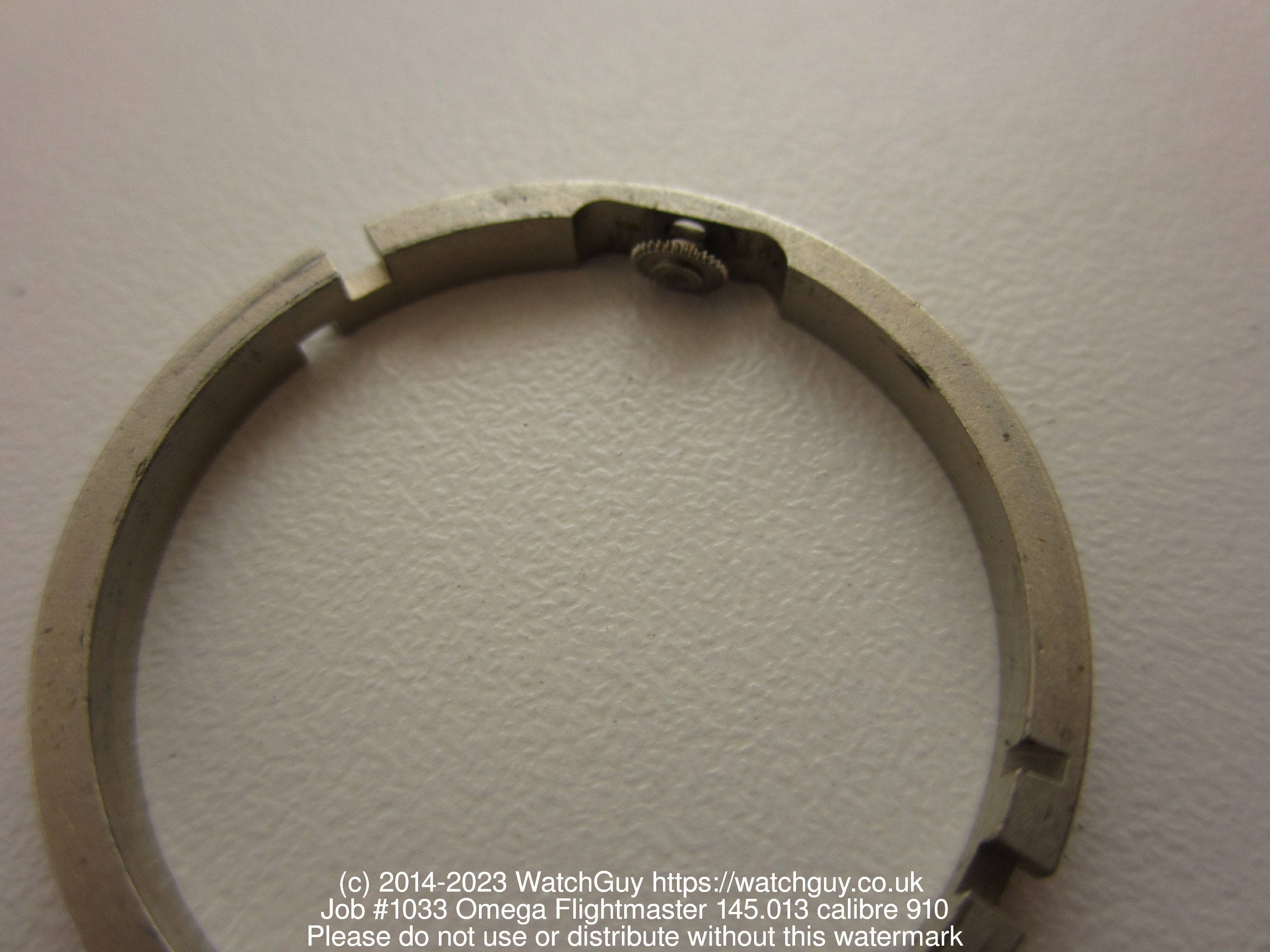

Posts 326 Likes 558 Arancio601 ·Feb 25, 2023 Hi guys, my Flightmaster project watch is missing the movement spacer ring. Is this specific to the Flightmaster or common to one of the 861 movement watches? Unobtainium or available from Omega? Anyone got a part number? Watchguy’s photo for reference
Posts 30,289 Likes 78,180 Archer ·Feb 25, 2023 If that is what you need, the part number is 079LC091001, and it's still available from Omega. It's not the same at all as what the regular Speedmaster uses.
Posts 326 Likes 558 Arancio601 ·Feb 25, 2023 Archer If that is what you need, the part number is 079LC091001, and it's still available from Omega. It's not the same at all as what the regular Speedmaster uses. Thankyou Al, exactly what I needed to know.
