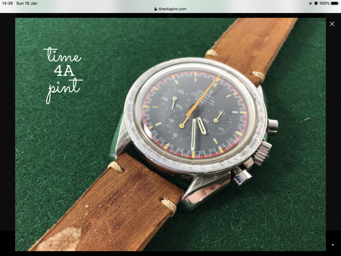

Pretty sure Spacefruit has also done this - i pulled this from a Time4apint podcast ( hope Chris and William wont mind!)

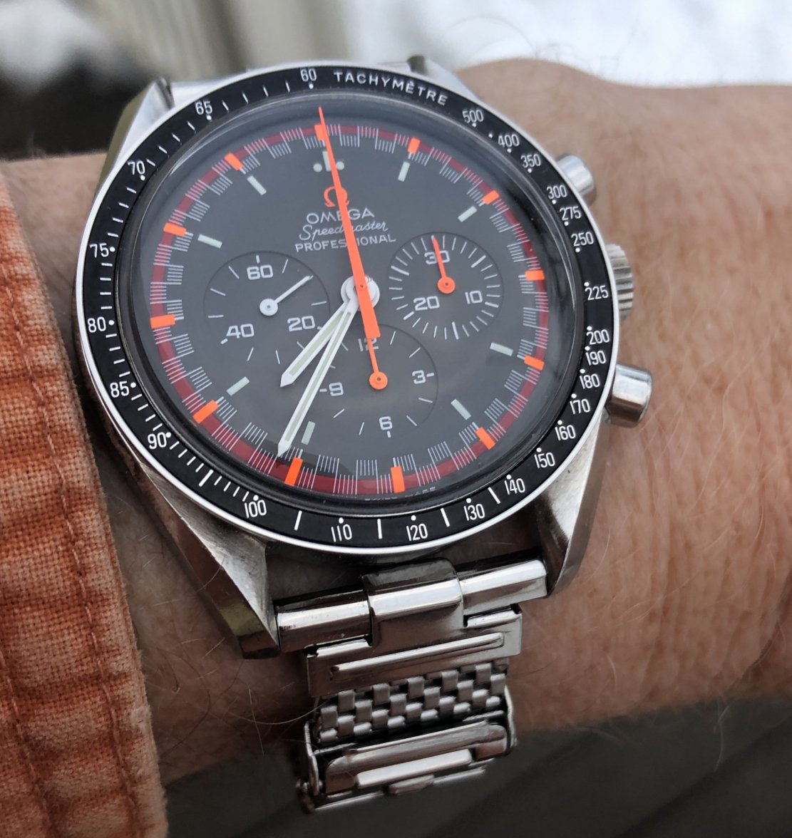

I believe finding a tritium racing dial will be rather expensive as you suggest and agree it may take a while to get one.
I did something similar, but with a modern superluminova JR service dial and handset. The service dial and handset was achievable to me from a cost standpoint, and IIRC, well less than $1000 USD all in.
I kept all changes using 861 speedy Pro compatible parts for ease now and in the future. I did not want to be clipping dial feet or take any other steps that would not be reversible. From my viewpoint, all parts had to be “ Remove and replace” compatible.
I bought a nice 145.022-69 with a nice original dial and handset - both dial and hands which I removed and placed in my dads .022-69. Those donor tritium parts replaced a SL service dial and handset which were installed on my dads watch at an Omega Service around the turn of this century.
so, now, the donor watch case and movement could have used those same SL service dial and hands, which were removed from my dad’s watch. However, I was not a fan of their aesthetic look. So instead, I bought a Japan Racing dial and handset as service parts. My local watchmaker then installed the JR parts for a modest cost in the donor watch case.
This SL replacement may “scratch the itch” and might be an interim step for you until your sought-after tritium dial finds its way to you?
Result Seen below
