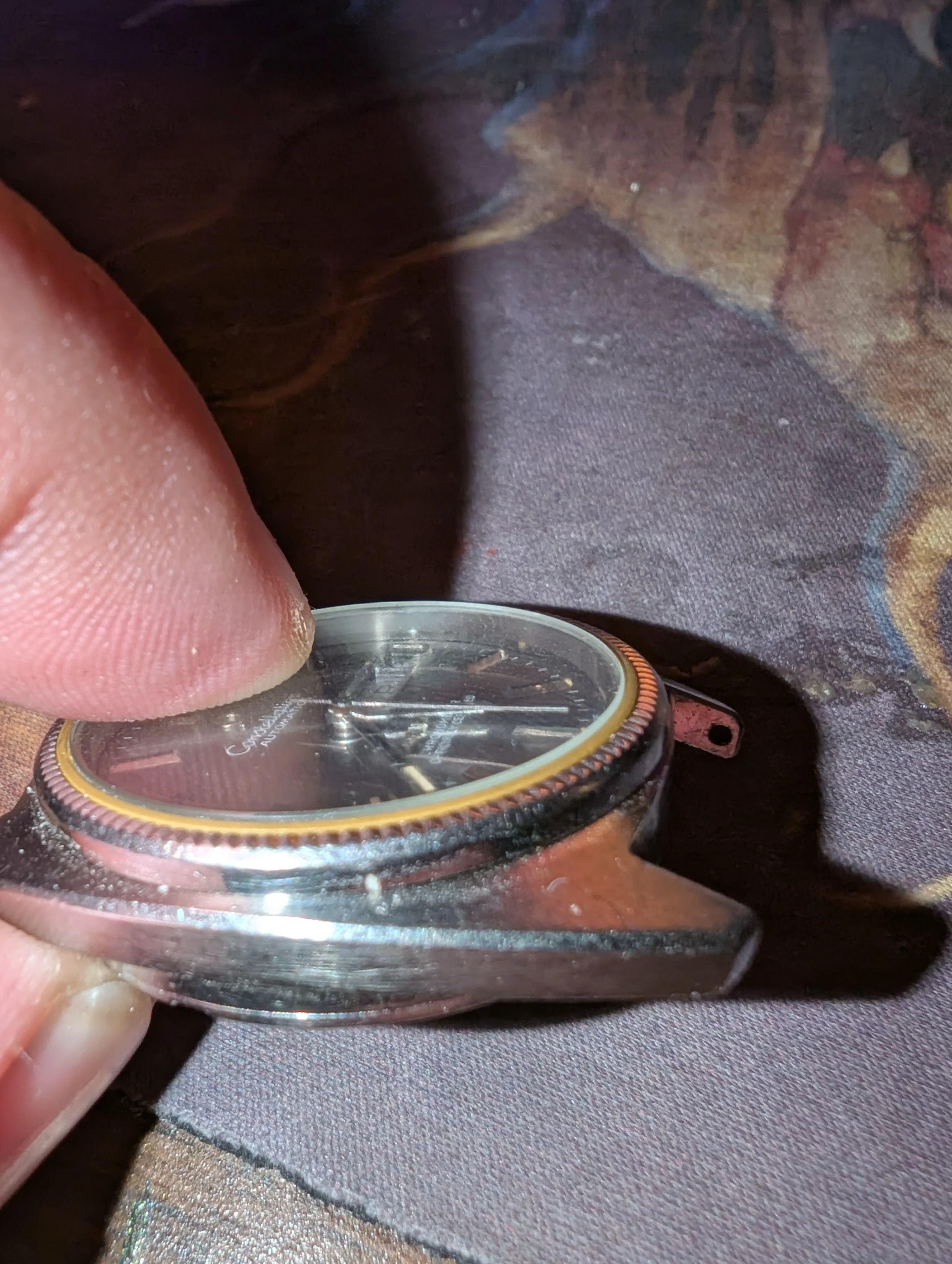

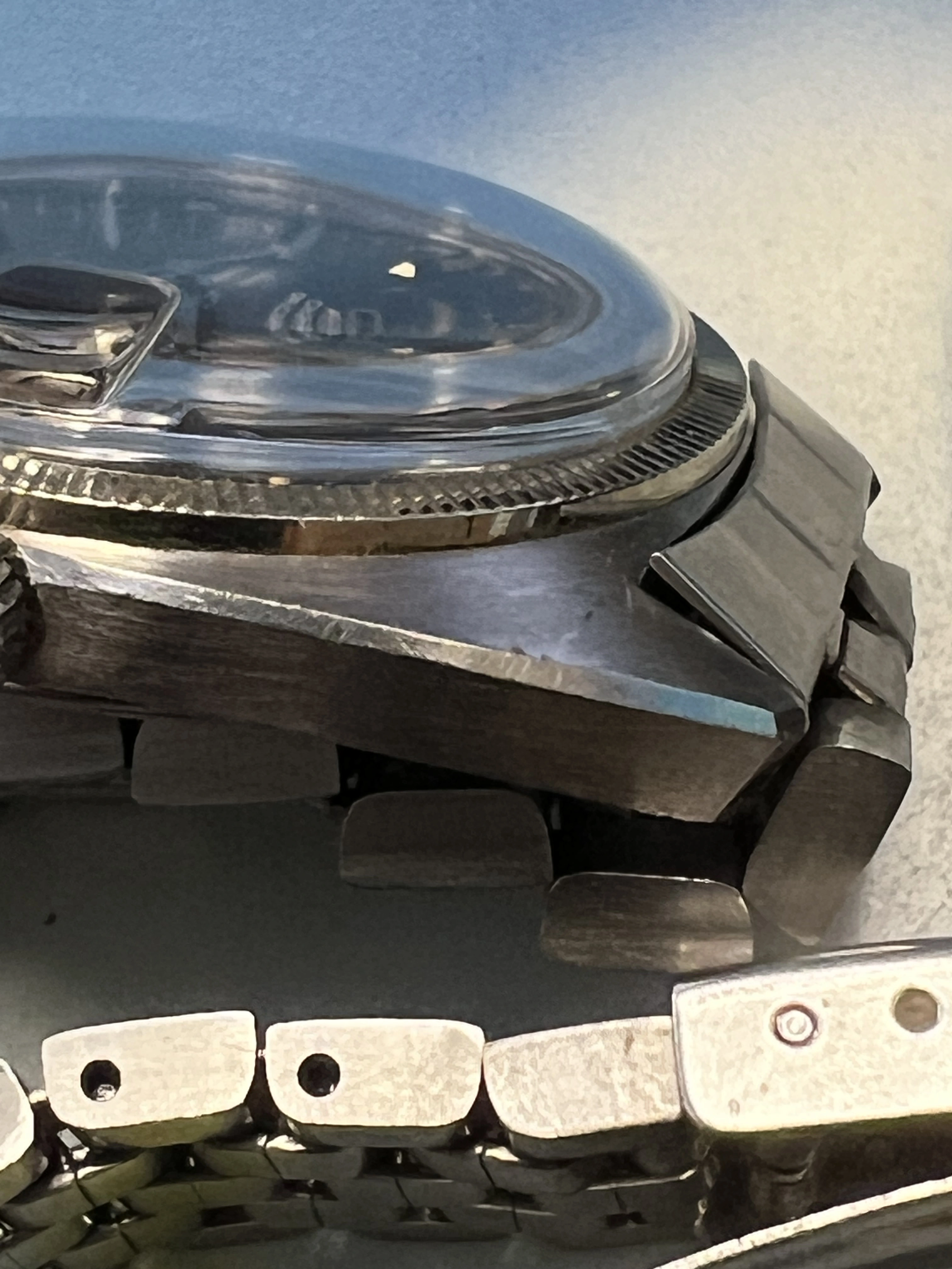

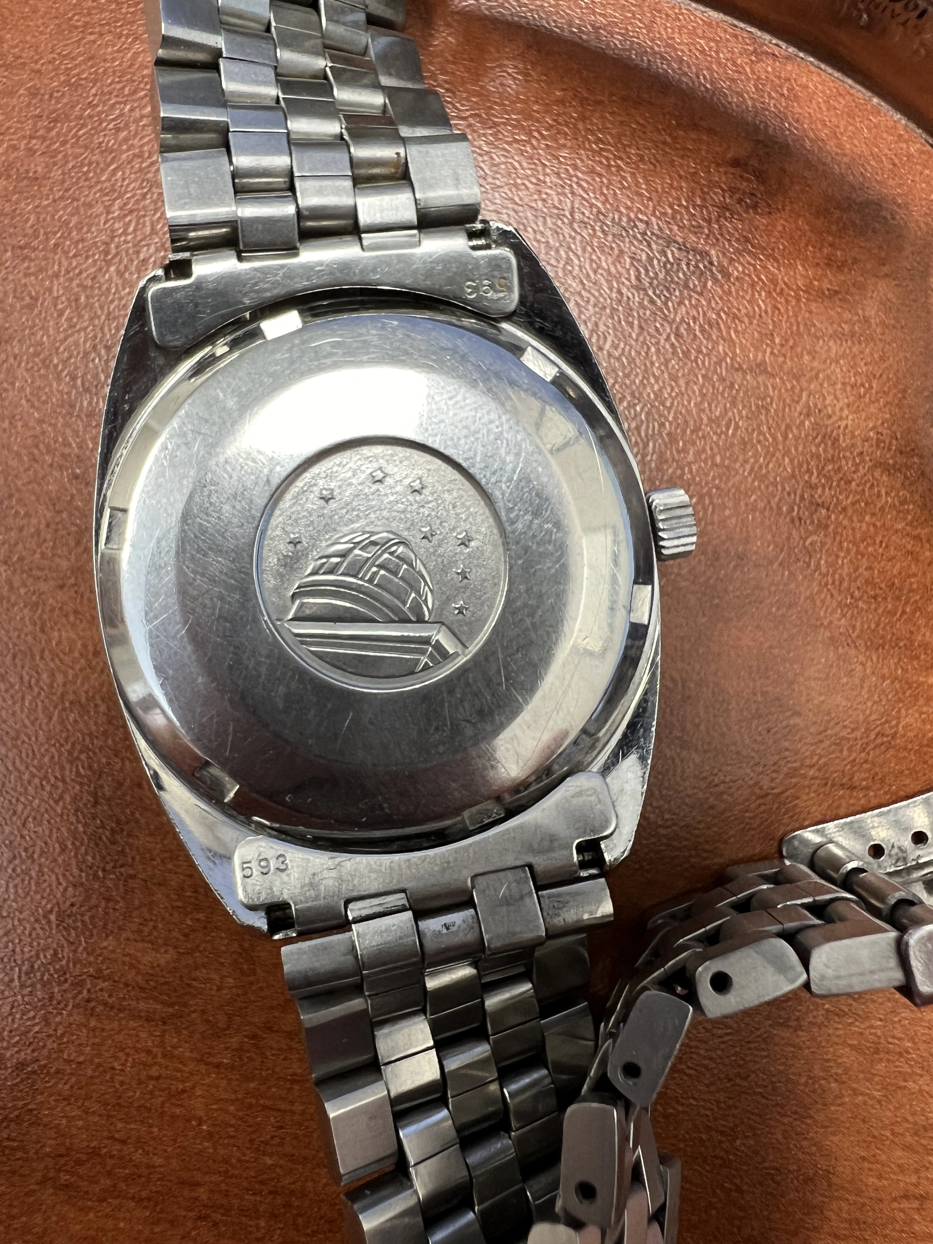

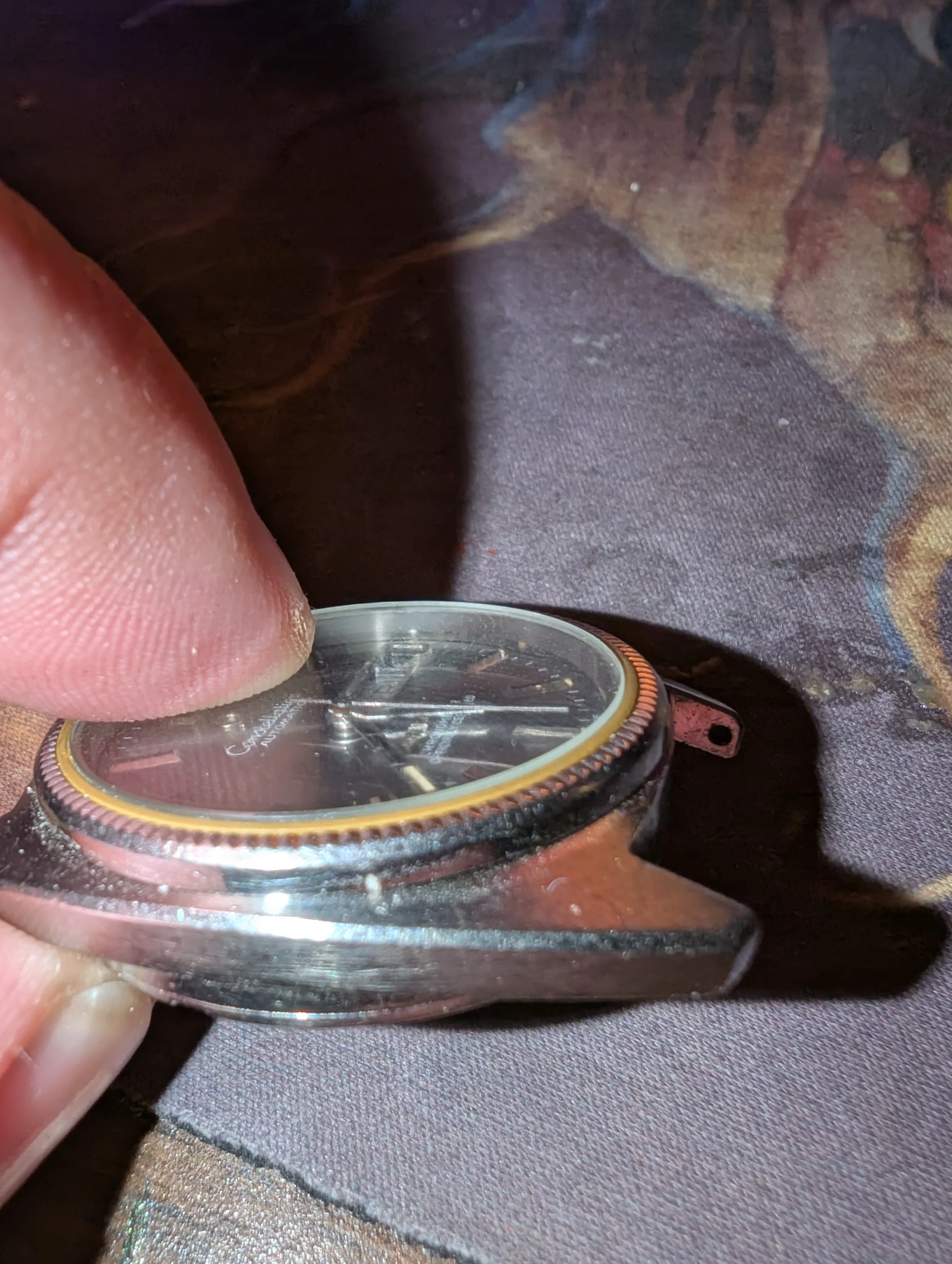

I've never owned one of these, so I'm not familiar with the construction, but there seems to be some sort of gold-colored retaining ring around the crystal. Is this meant to be a two-tone watch?

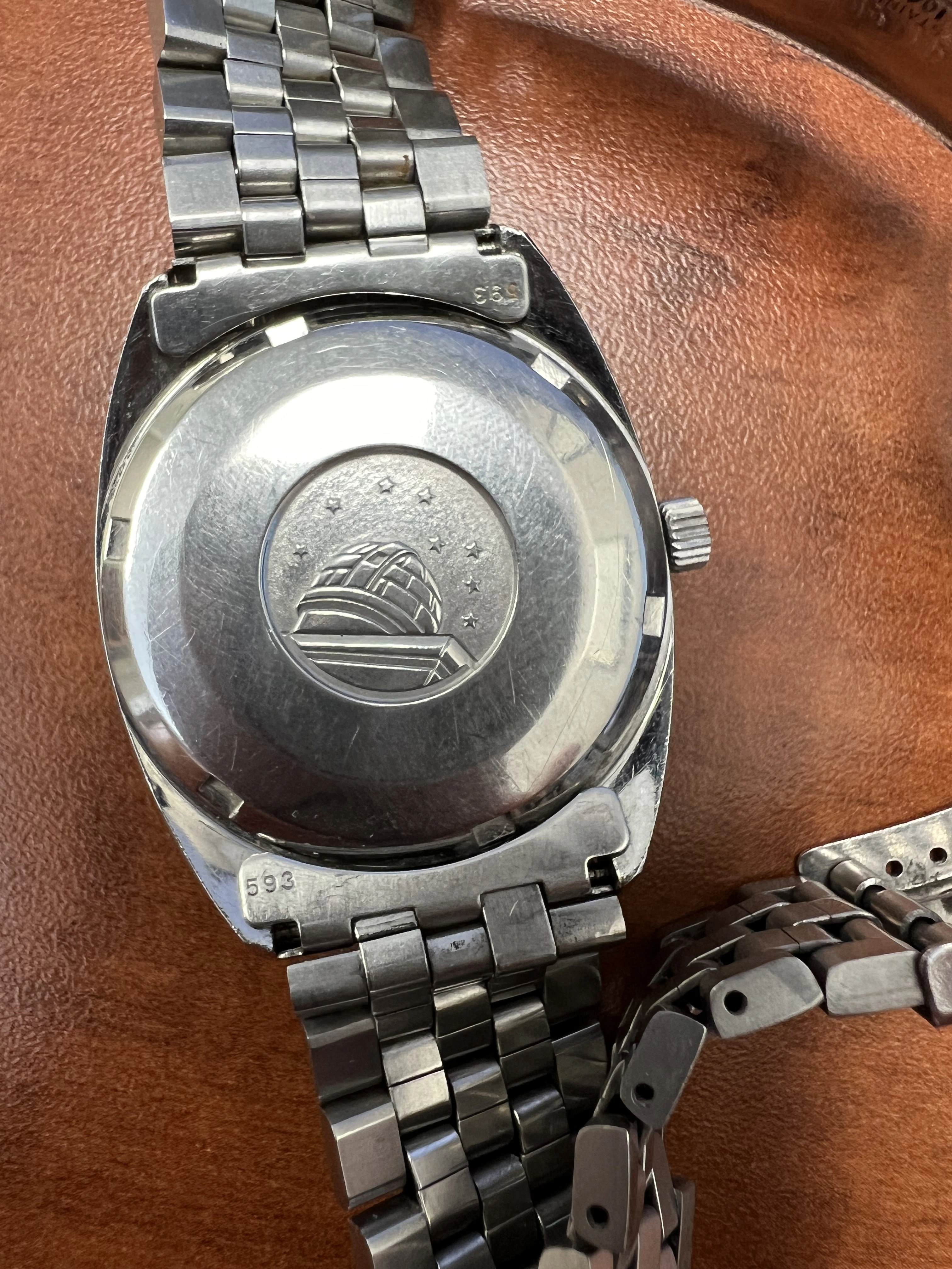

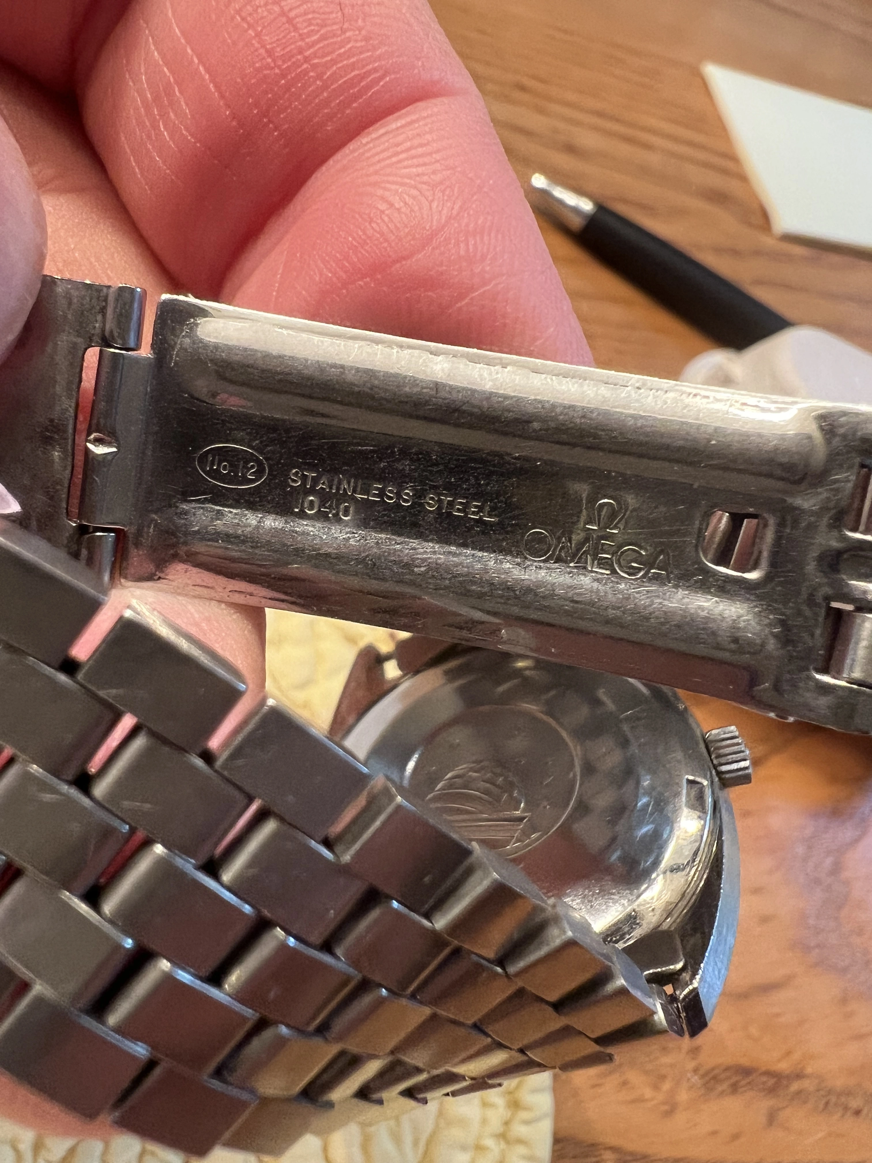

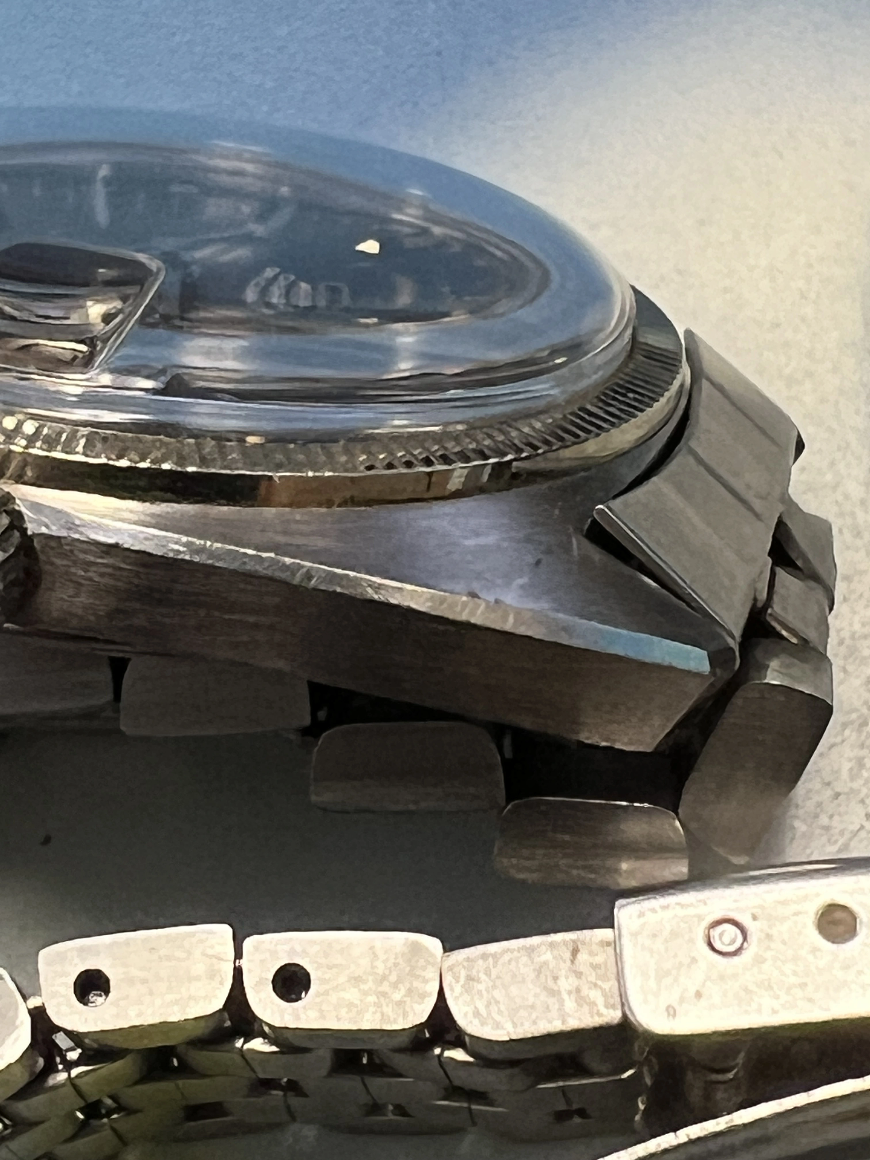

Regarding bracelets, there appear to be two "correct" options:
1172/736
1040/593
8
4
Not sure if it is meant to be two-tone, however once I get my grubby mitts on it, I will have pics.

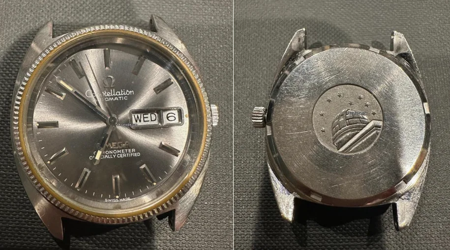

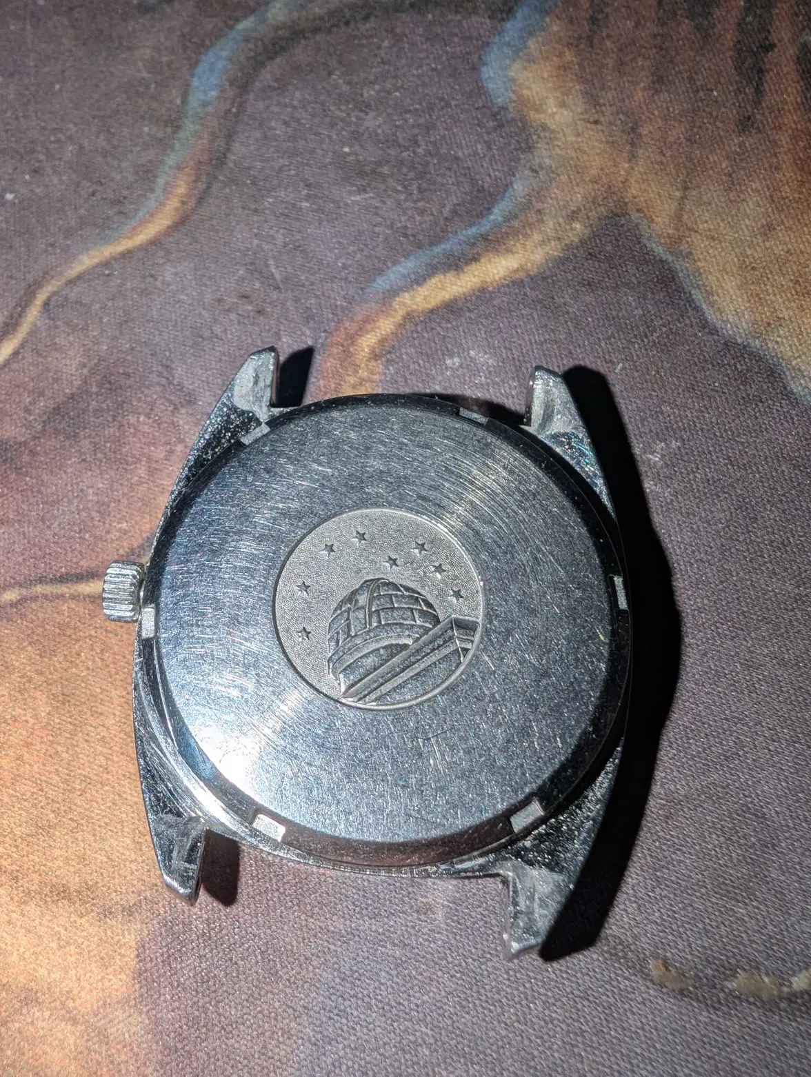

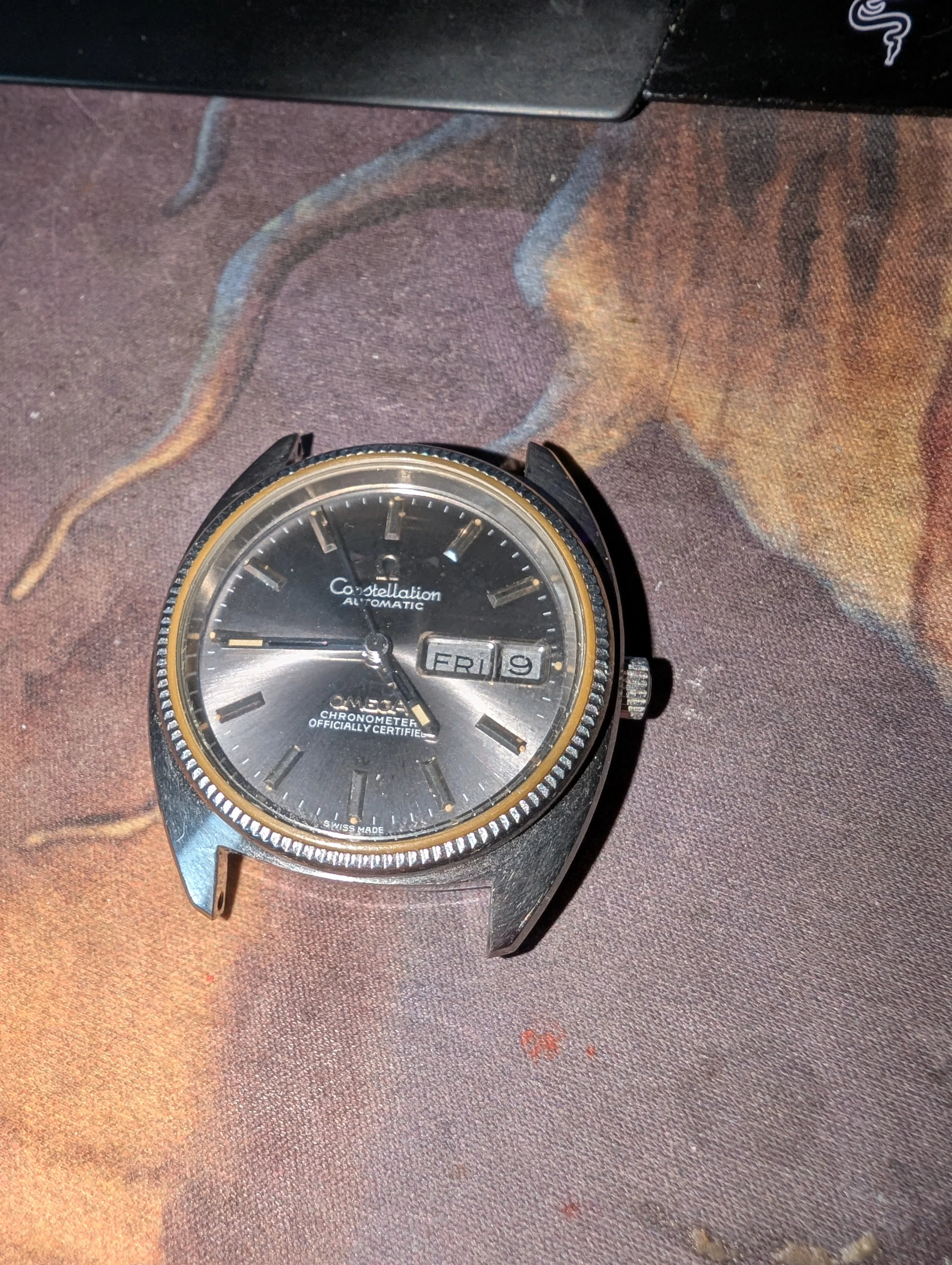

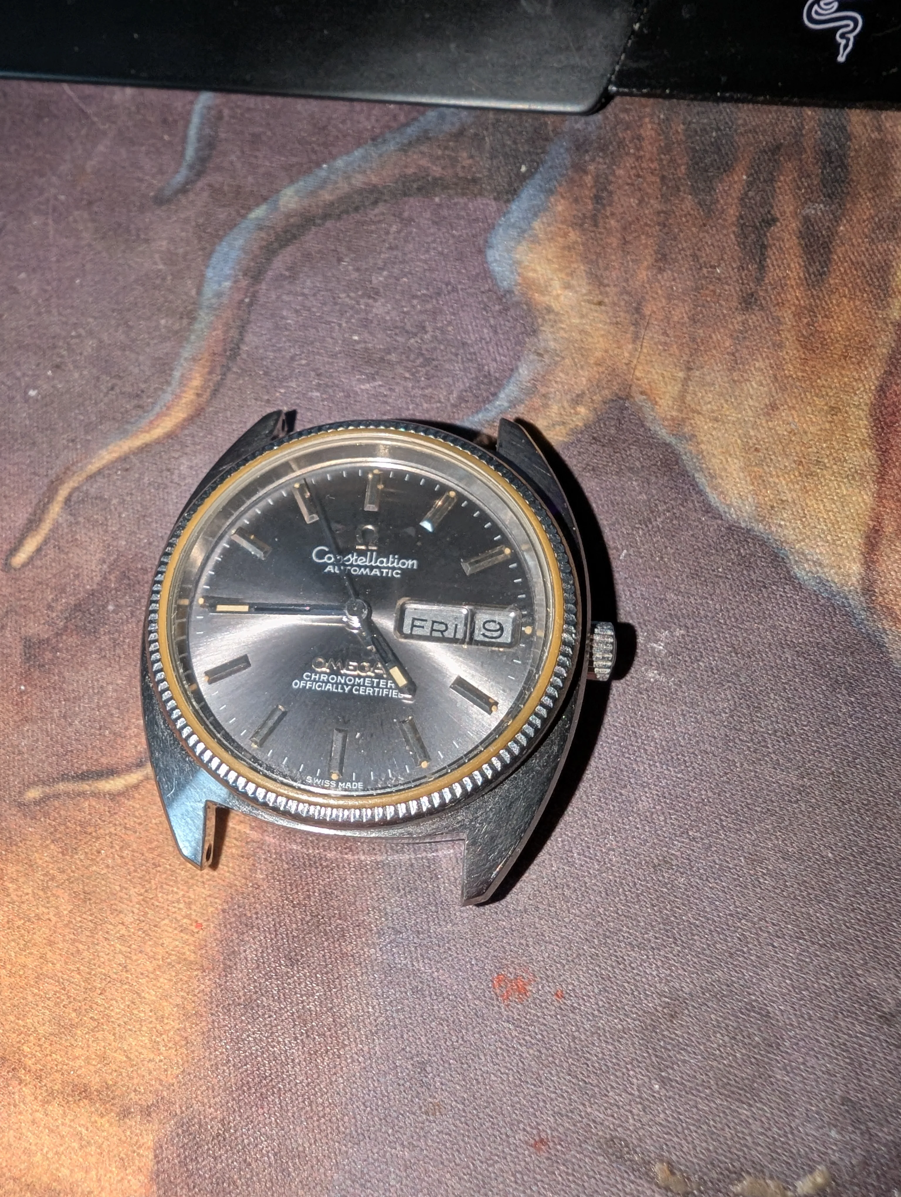

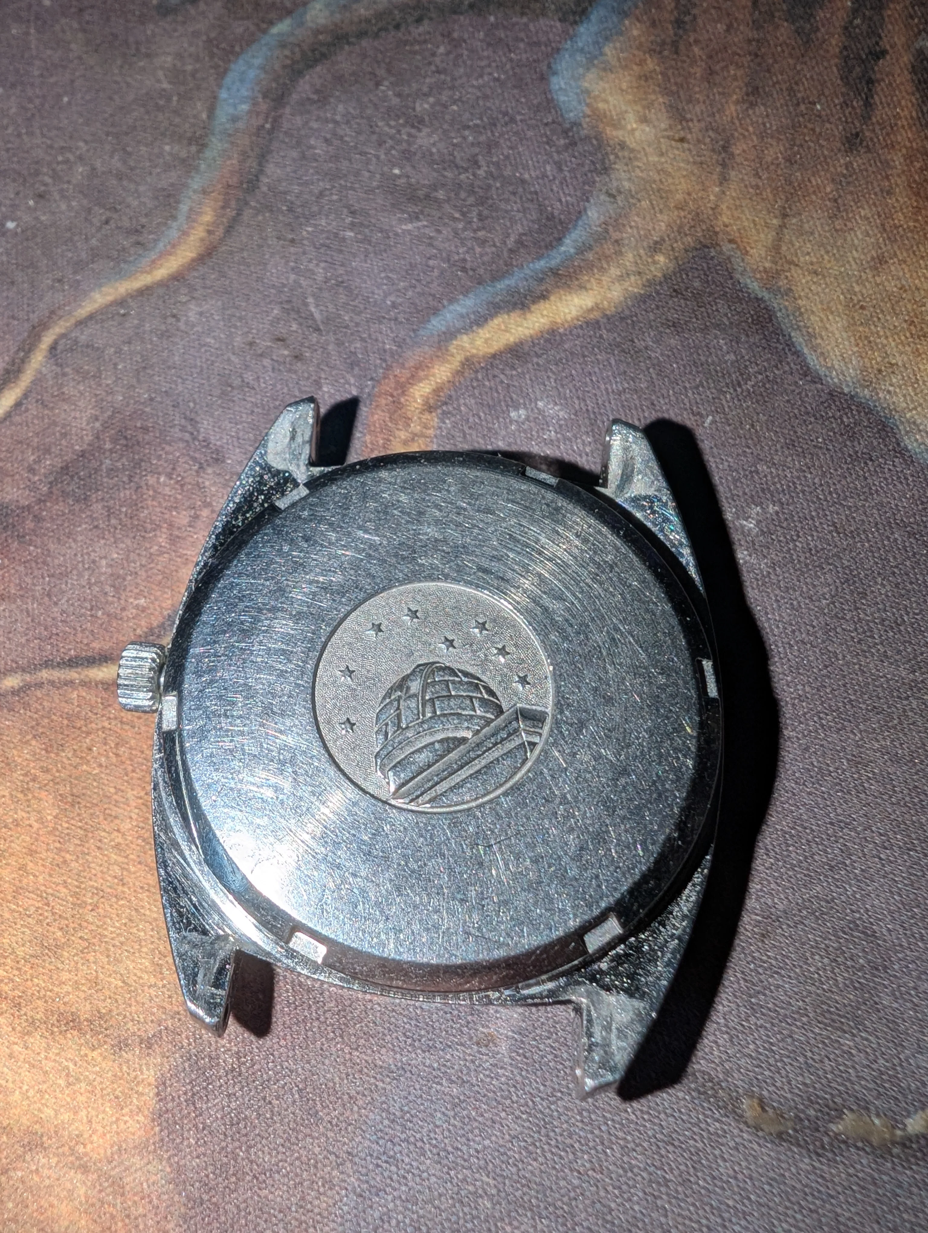

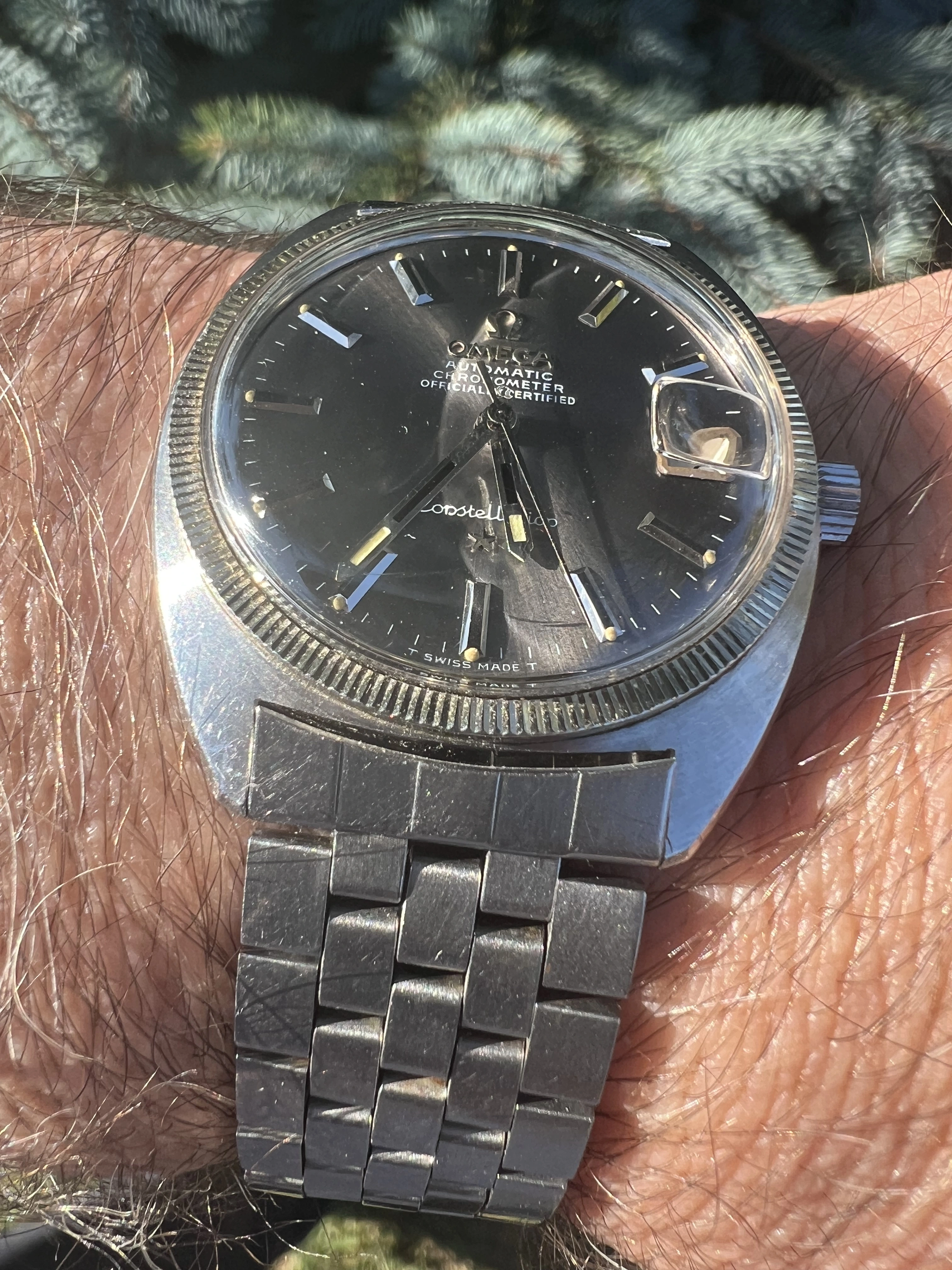

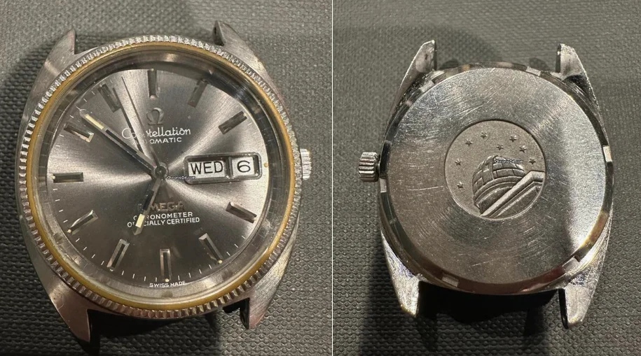

Got the watch this weekend. I am still looking for a watchmaker to handle the service. I found one but I got the willys after texting with him about scheduling.
Here are the pics. I want to leave the case as is with minimal polishing. Any suggestions on a leather strap?

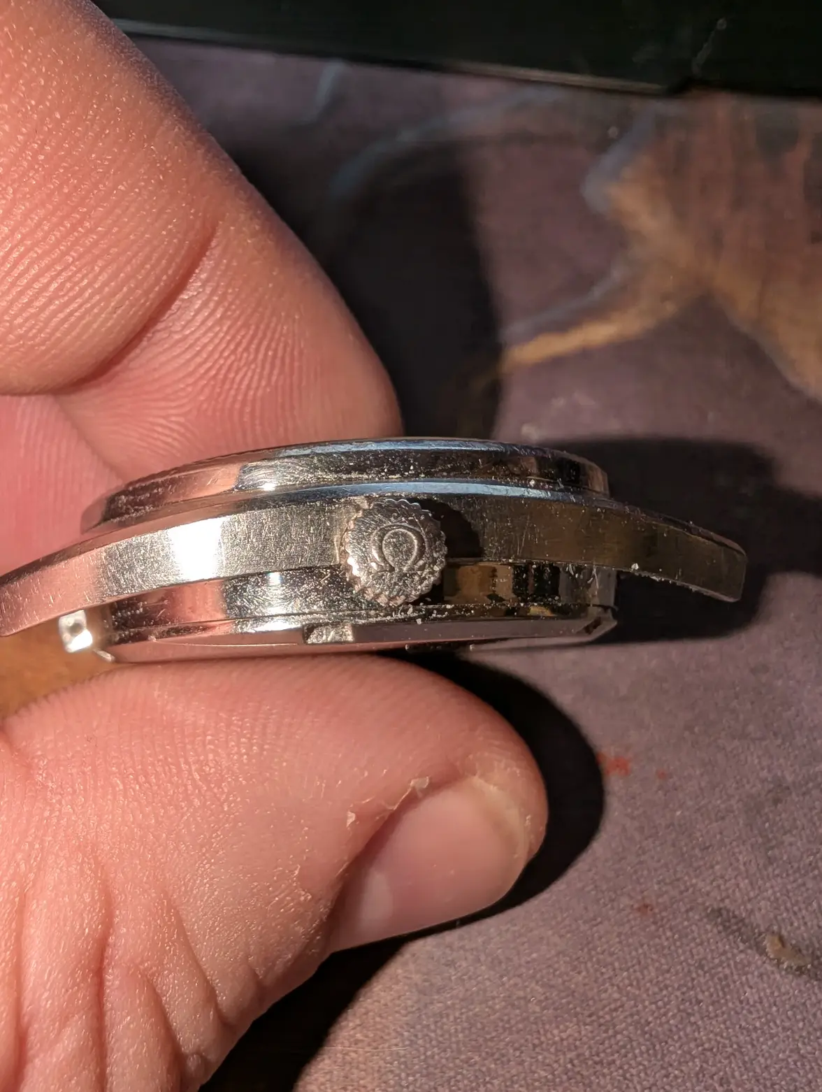

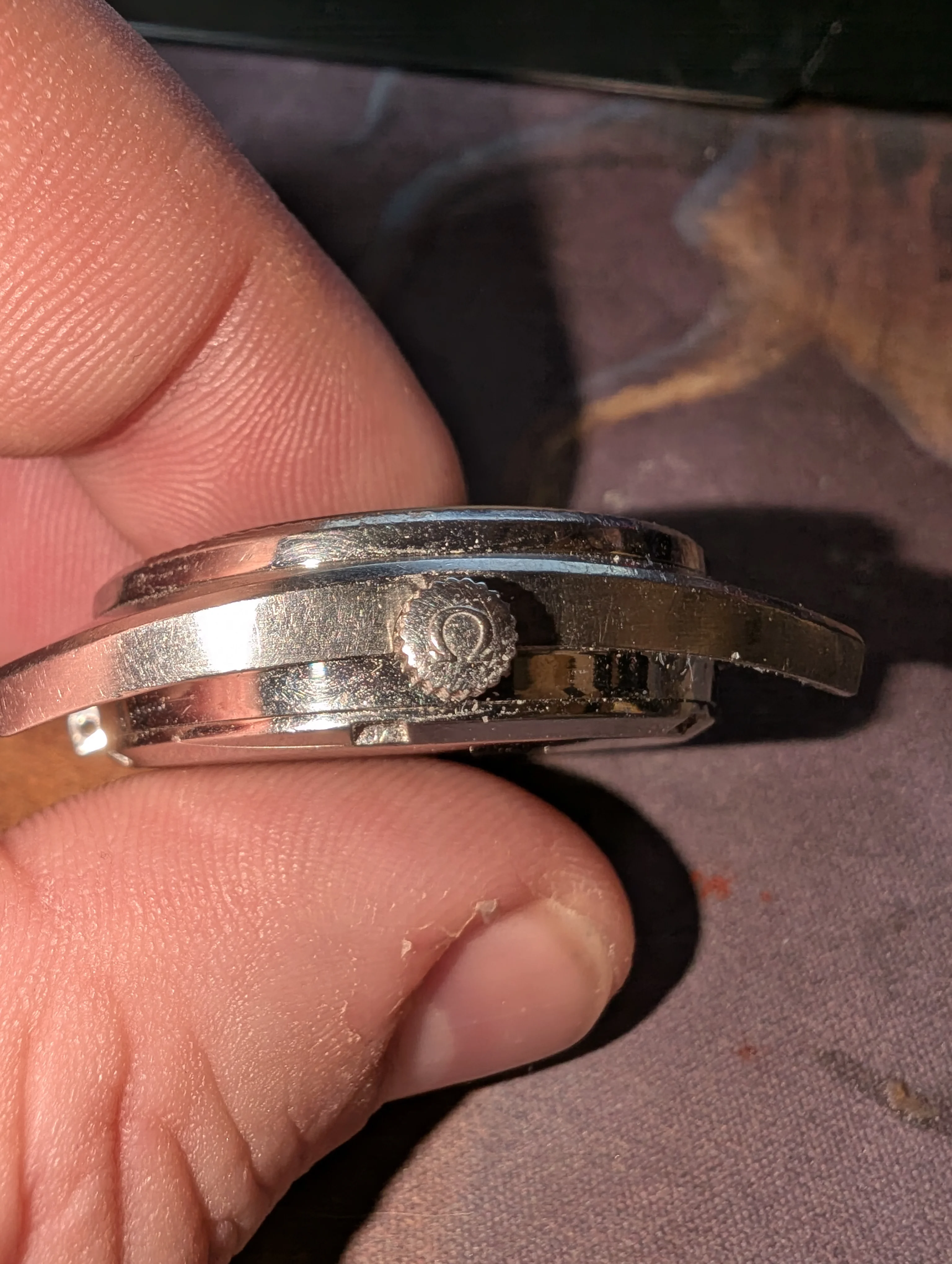

Can you take a picture at this angle? Trying to see if the brown color ring is inside the crystal
1,981
2,144
IIRC, that brown ring is a rubbery-plastic gasket that goes around the crystal. I've got a ladies watch in need of some that I'm going to try to make someday soon.
If you search the forum you may find recommendations for a watchmaker in your area - or alternatively you could always ask for recommendations.

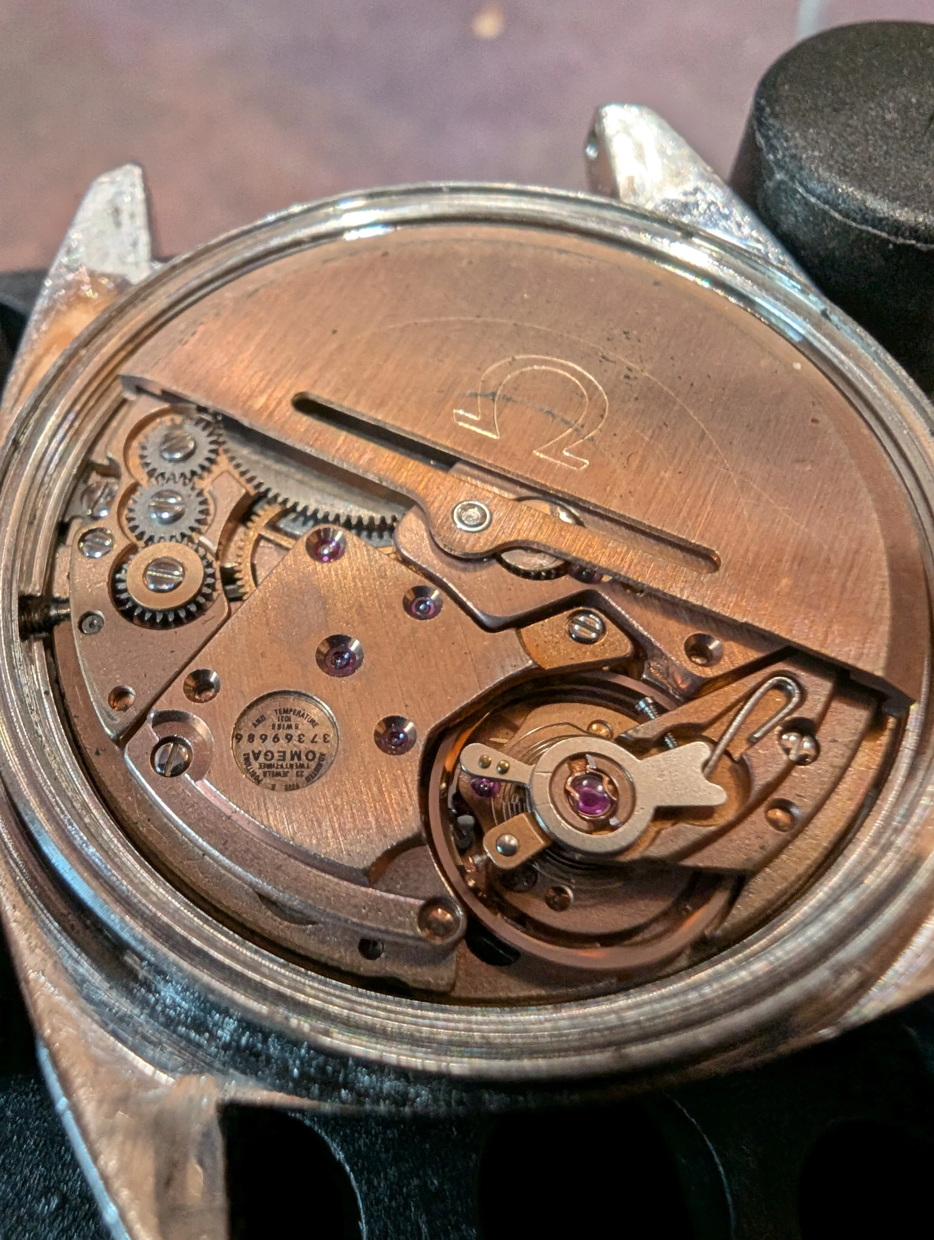

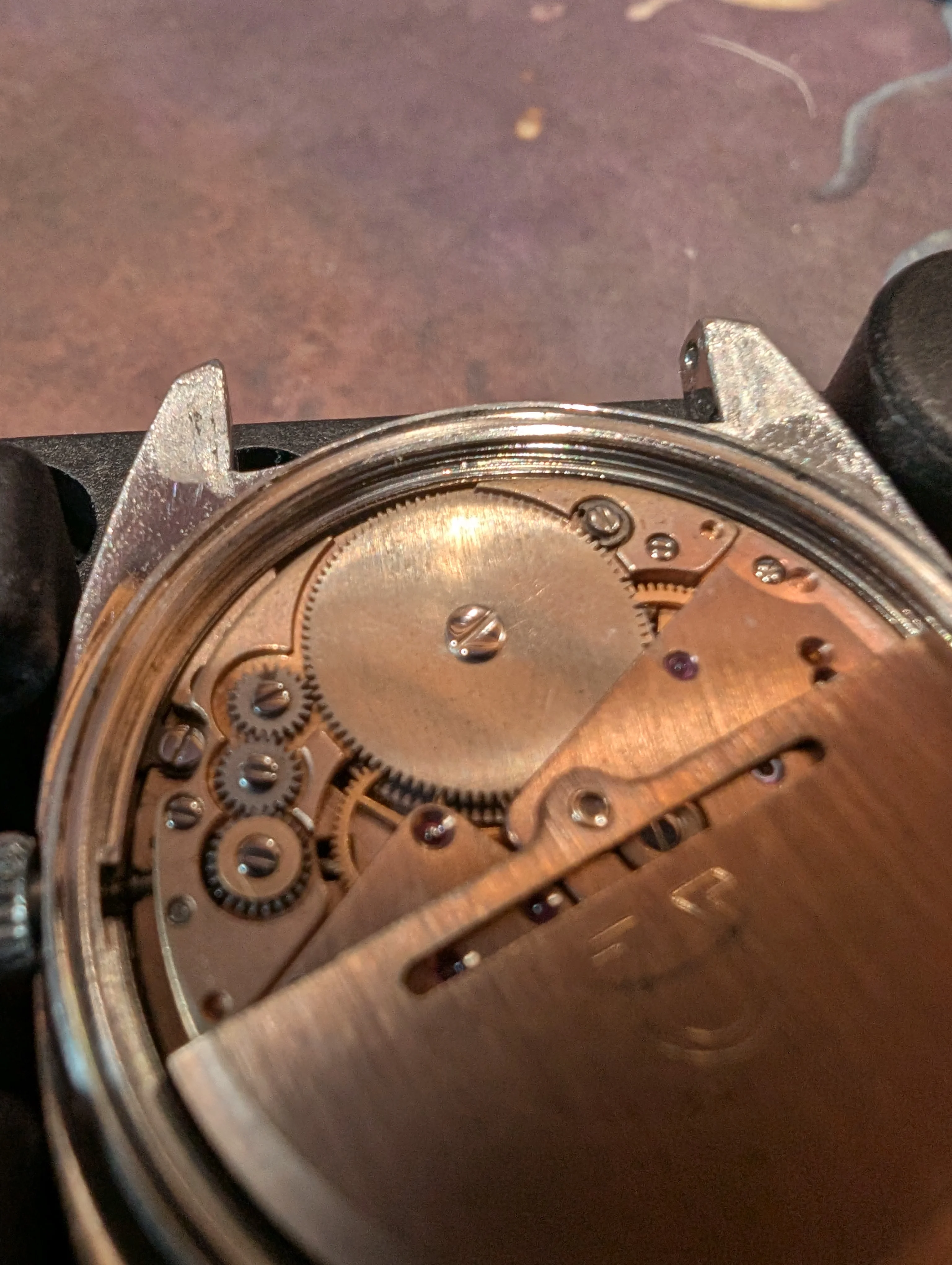

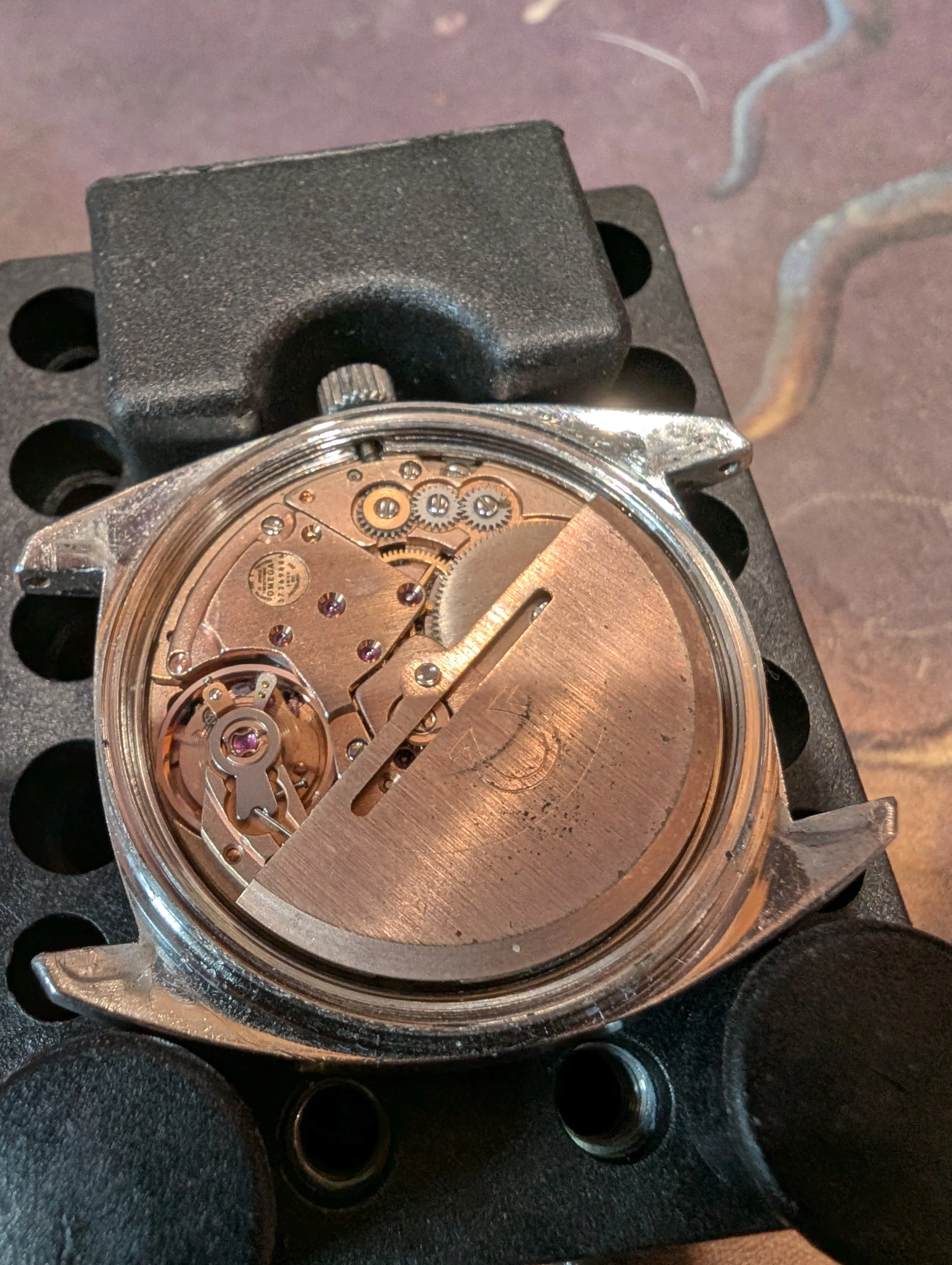

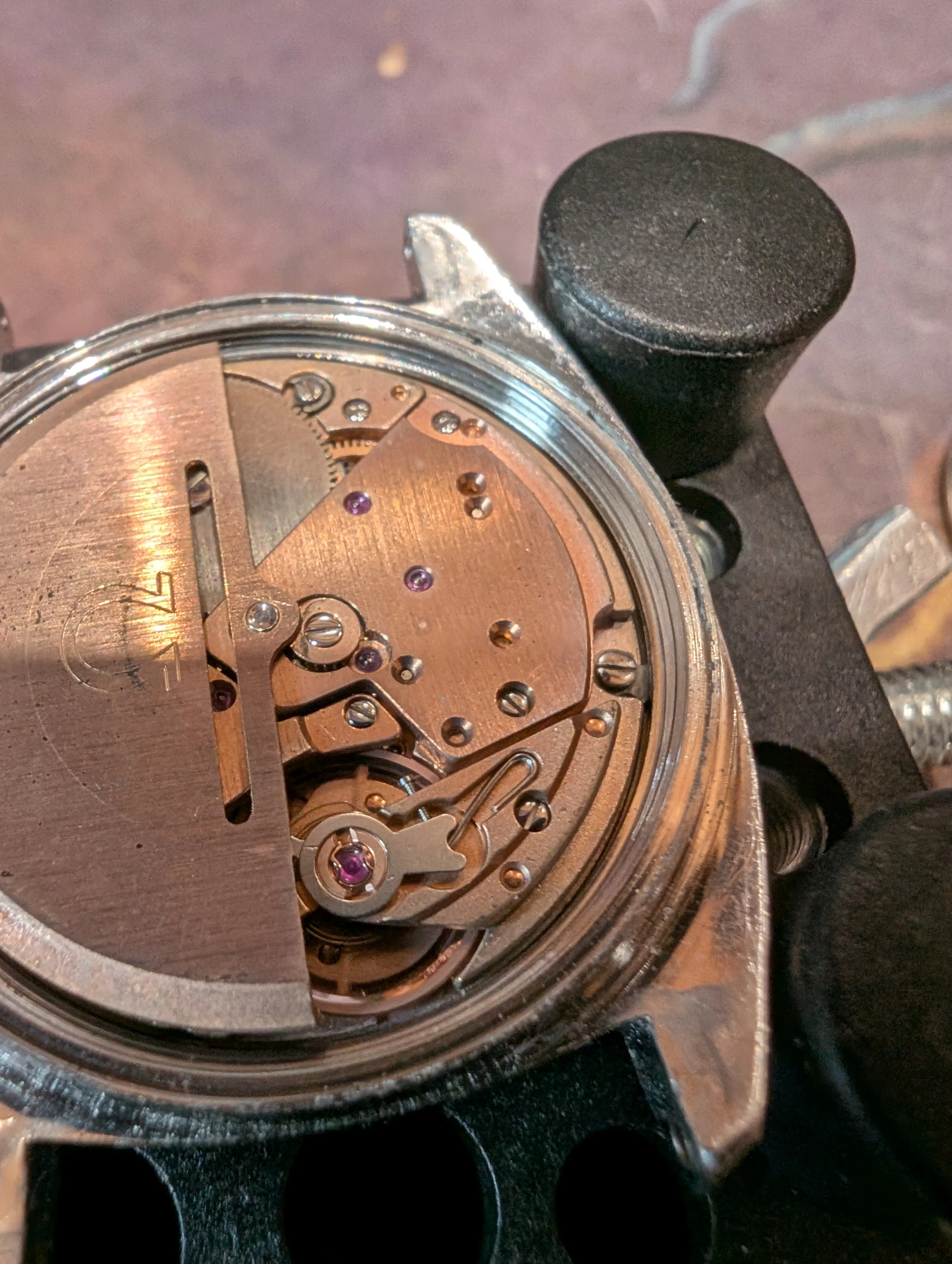

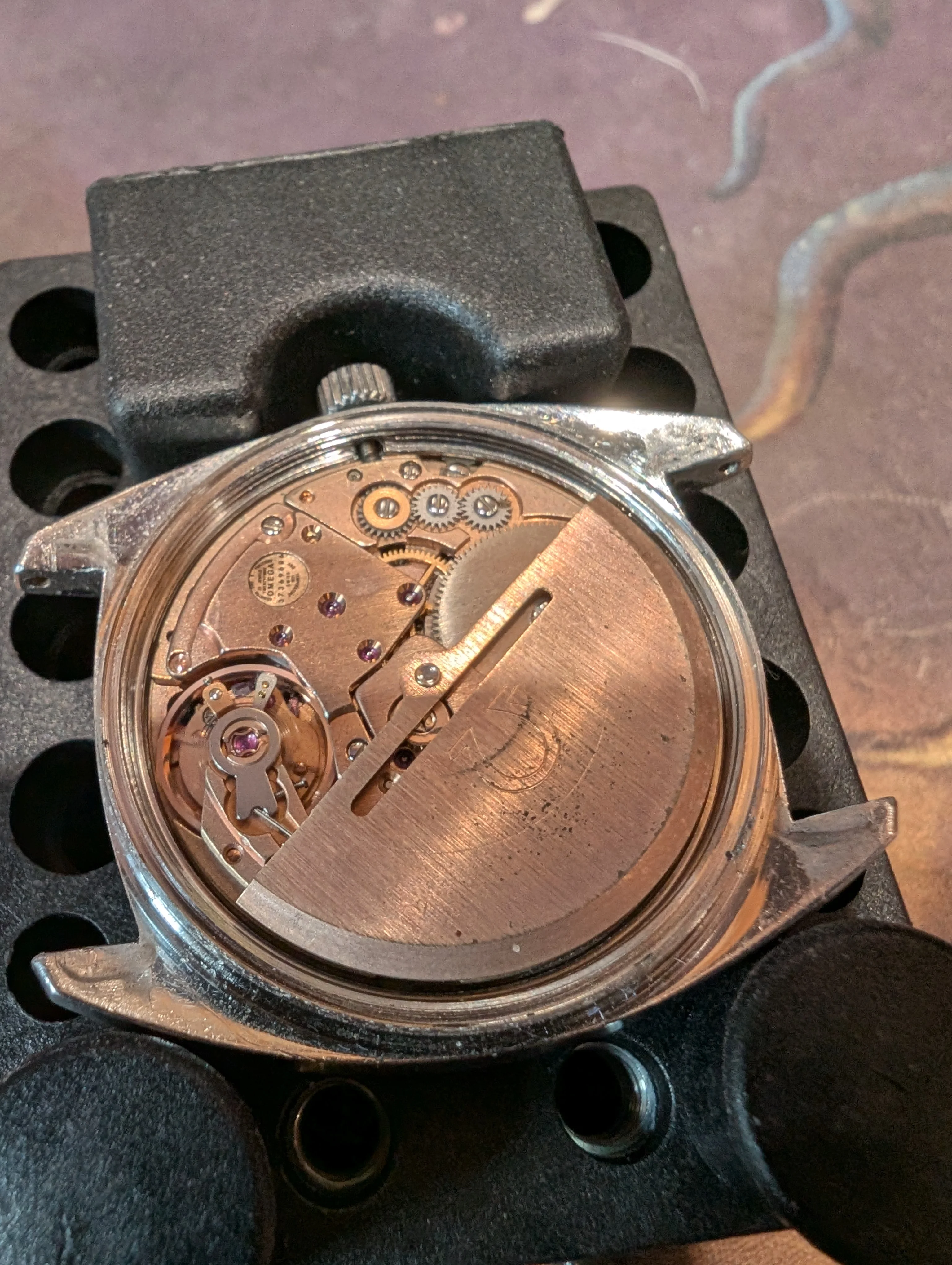

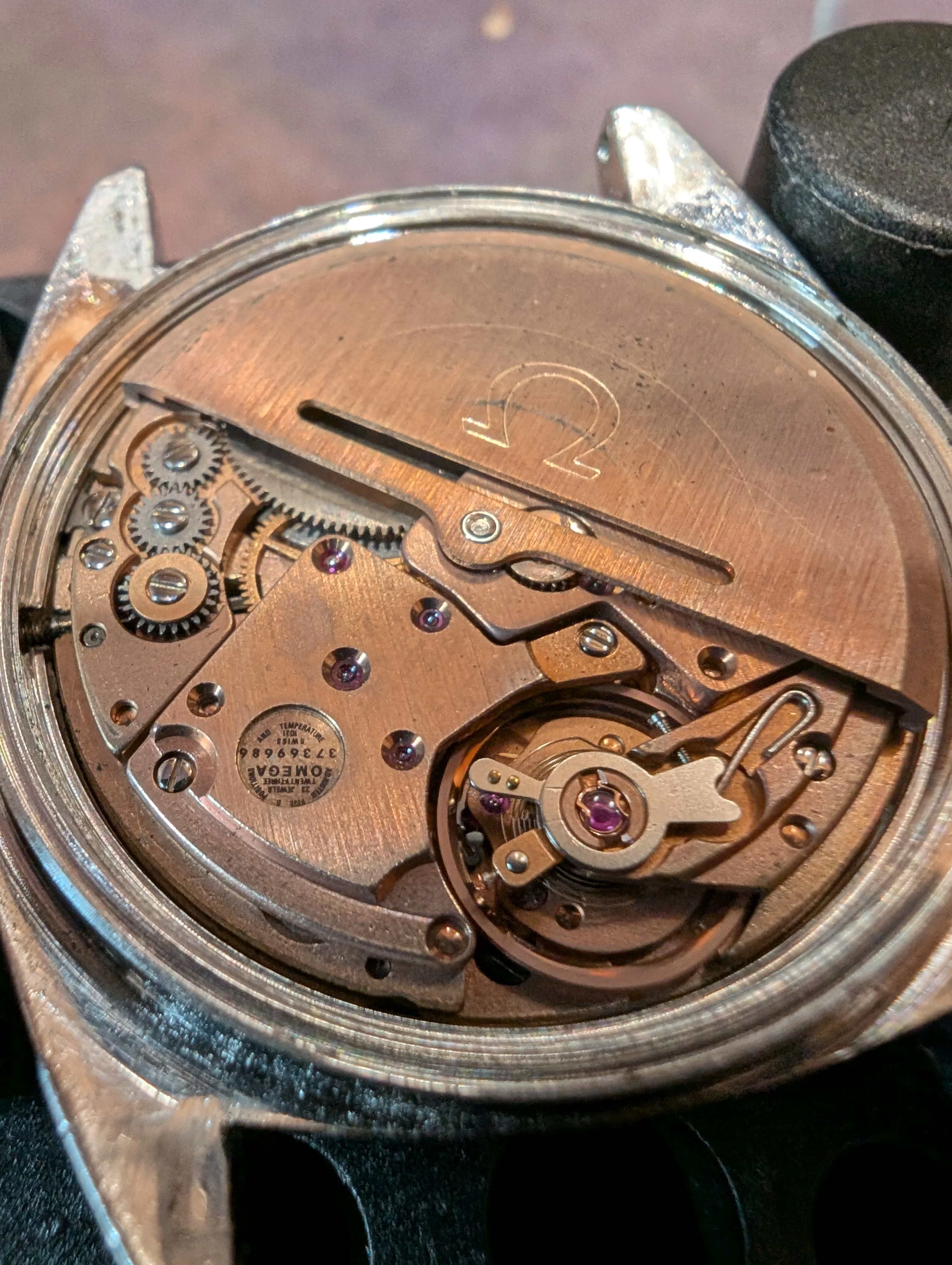

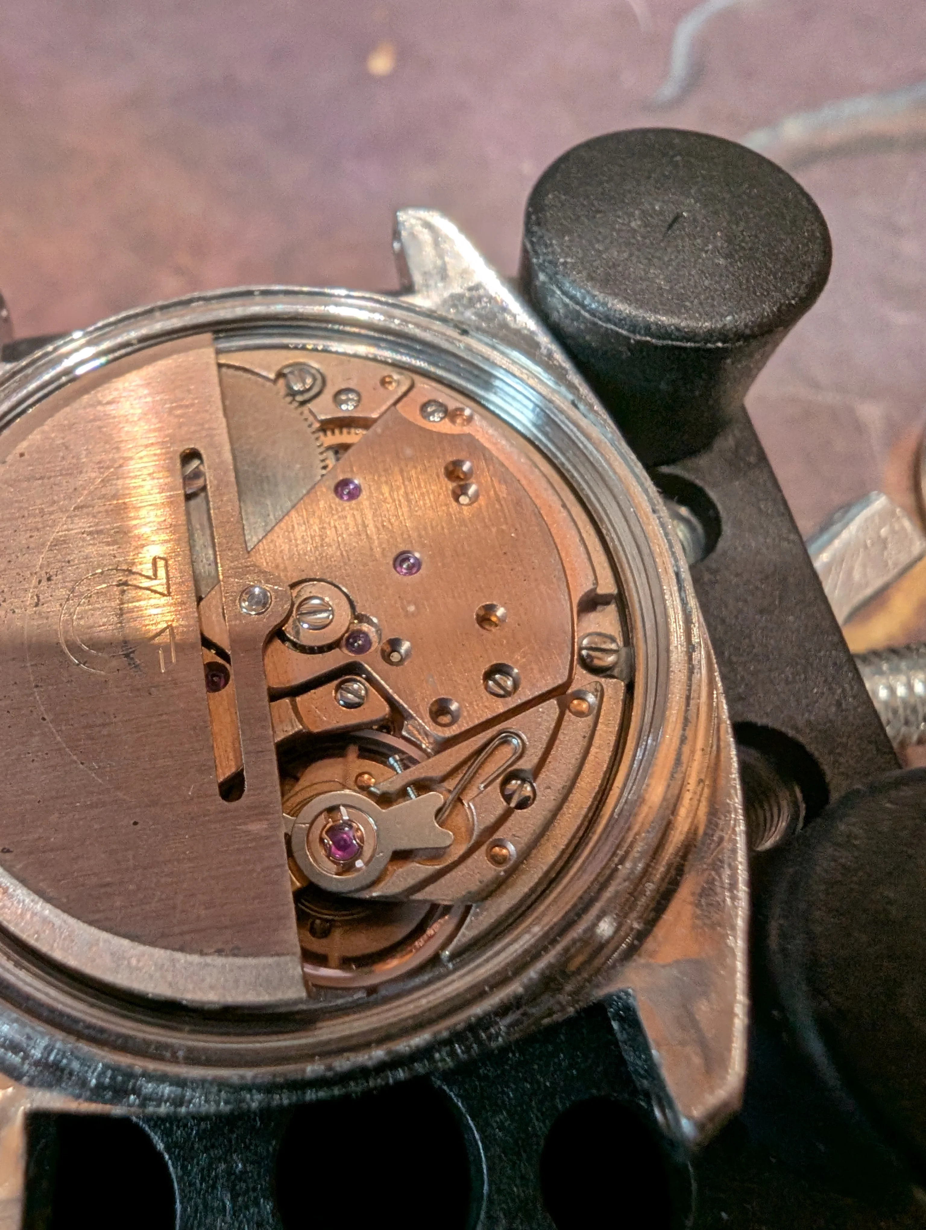

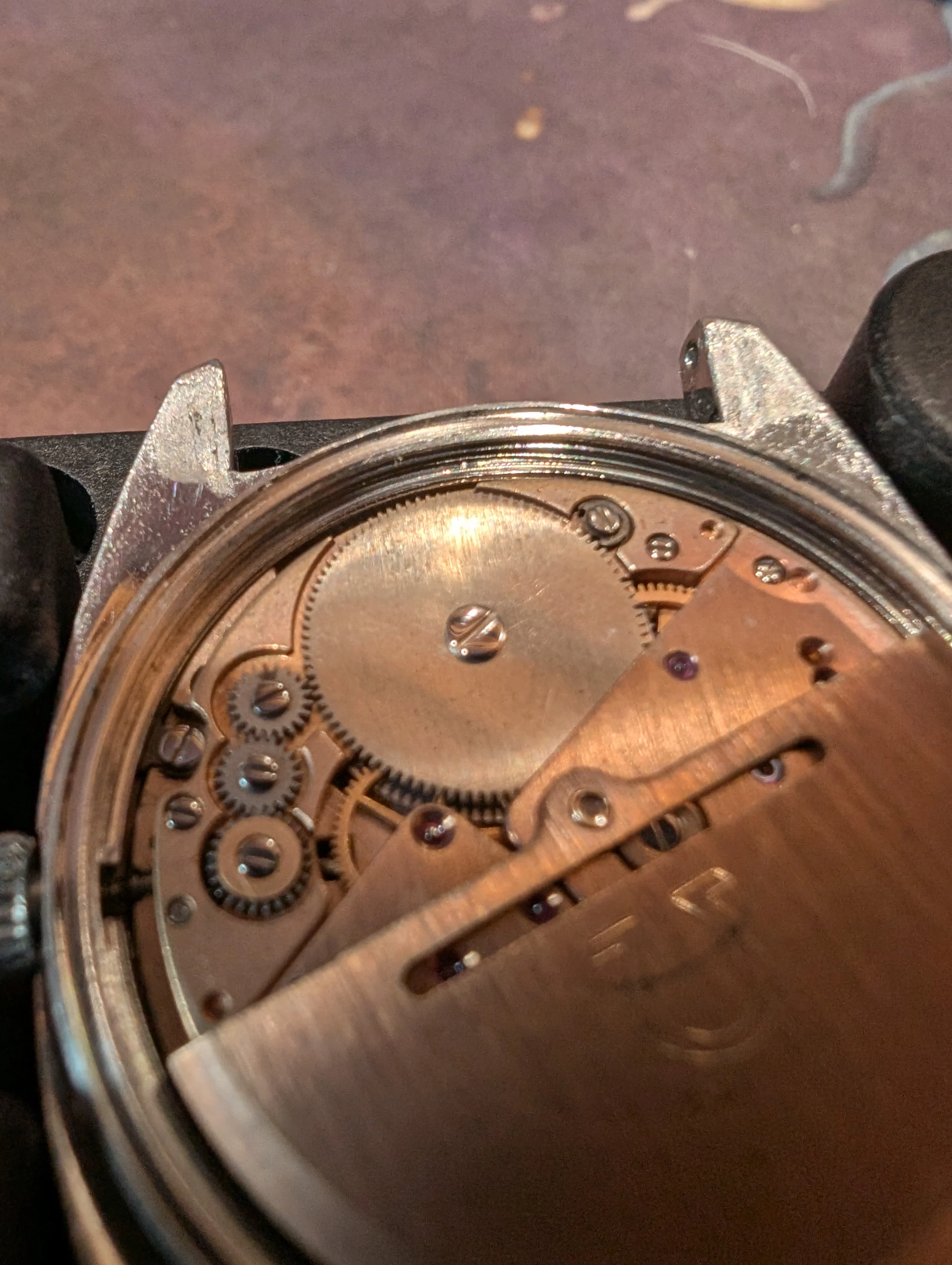

Got the back off. Was able to get pics of the movement.

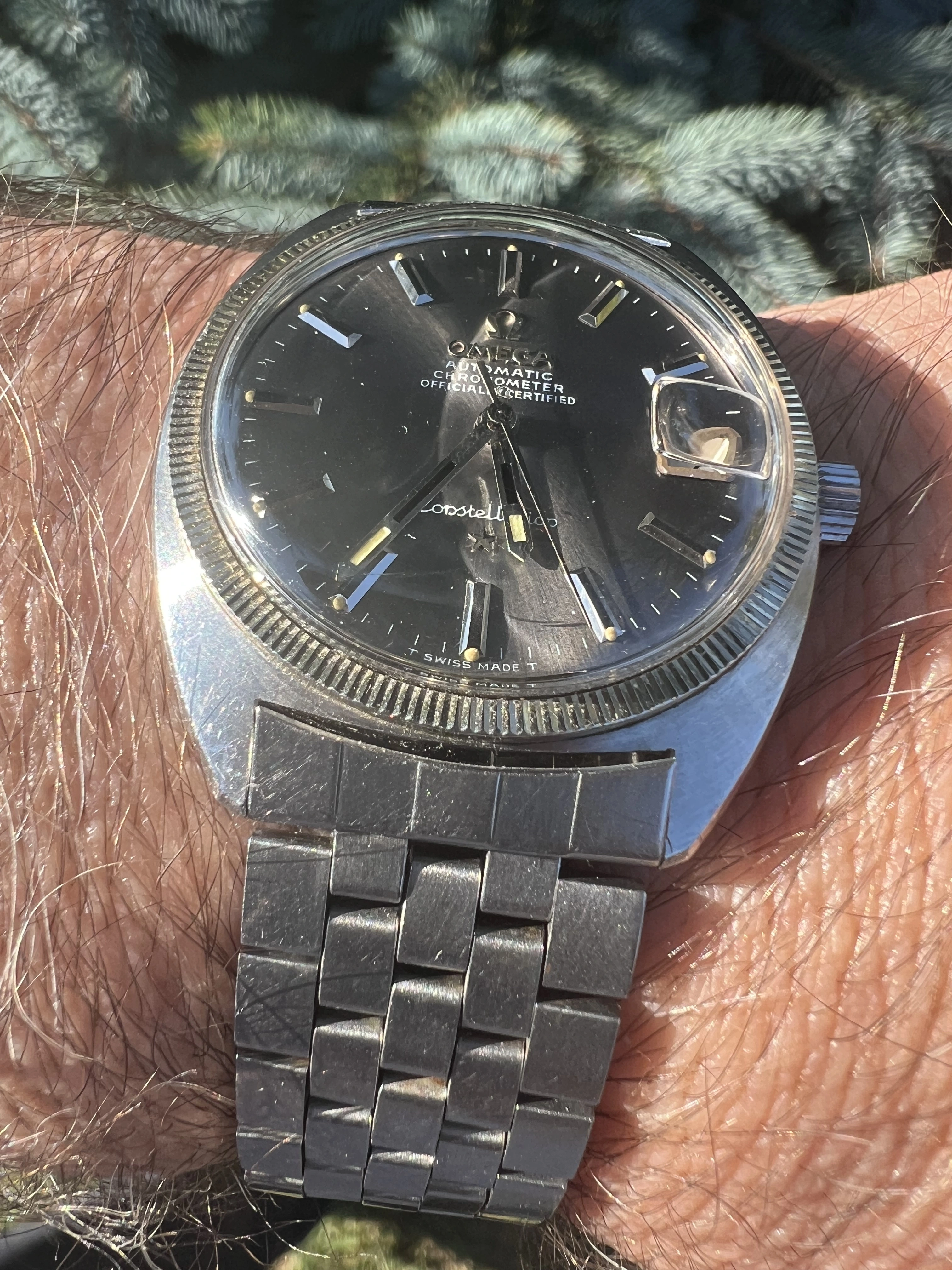

Doesn’t look to be in too bad of shape! I would agree with previous posters on finding an independent watchmaker to perform the service. Omega is nice, but you are going to pay a premium and it will take longer. As far as a strap, I would recommend the brick bracelet that someone had posted earlier in the thread if you like bracelets. If not and you want a strap, there are many quality suppliers out there but I always use Tunsleather on Etsy. He is shipping from Thailand I believe, but there is no better quality strap than what he sells IMO.
3,017
6,434
If you need a better pic let me know.

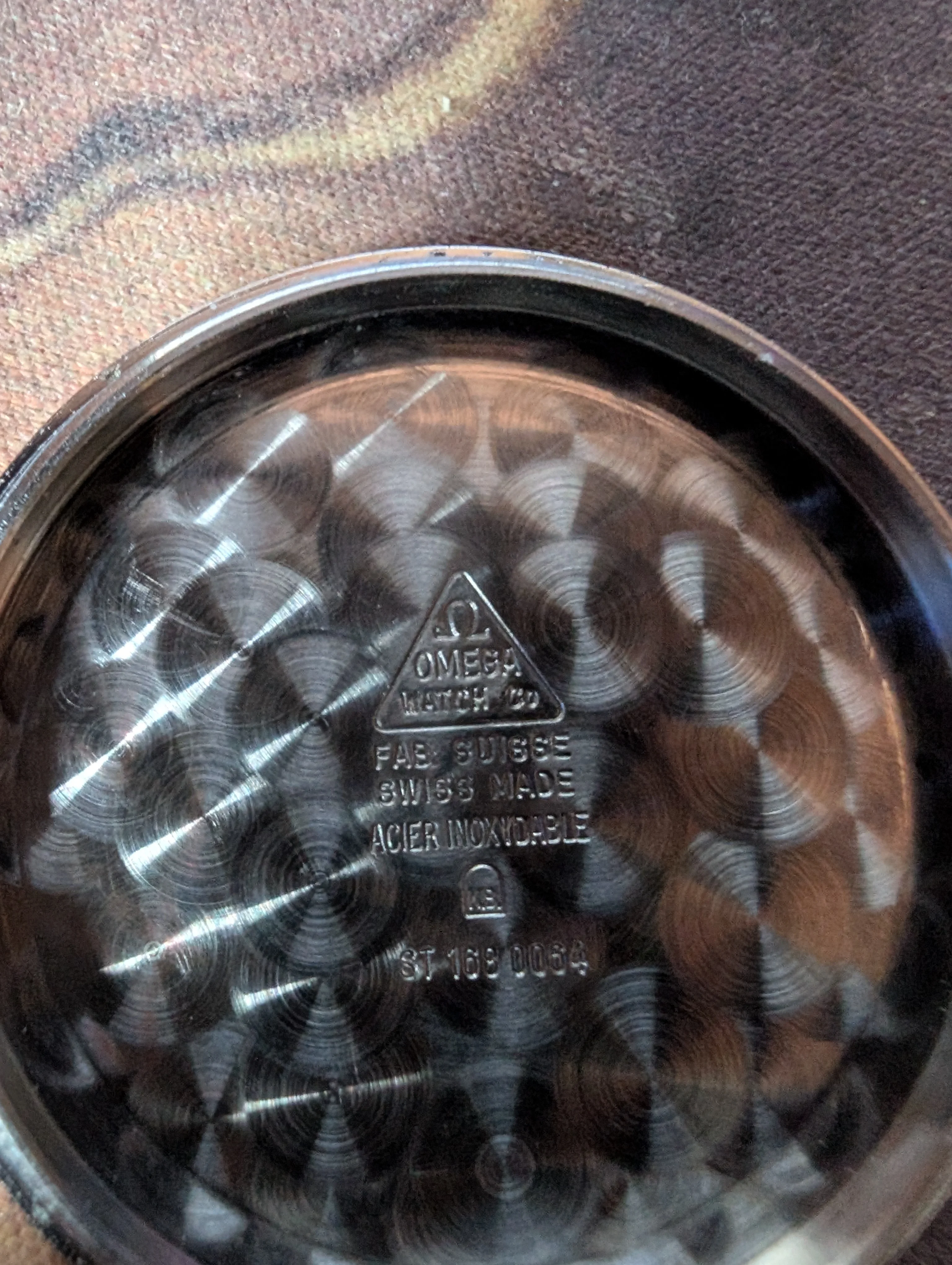

Thanks the yellow gasket is exterior to Crystal. I don’t think it is an Omega crystal and dont think an external gasket is correct for the watch. your watchmaker can source proper crystal and sort that out should not be problem.
29,671
76,828

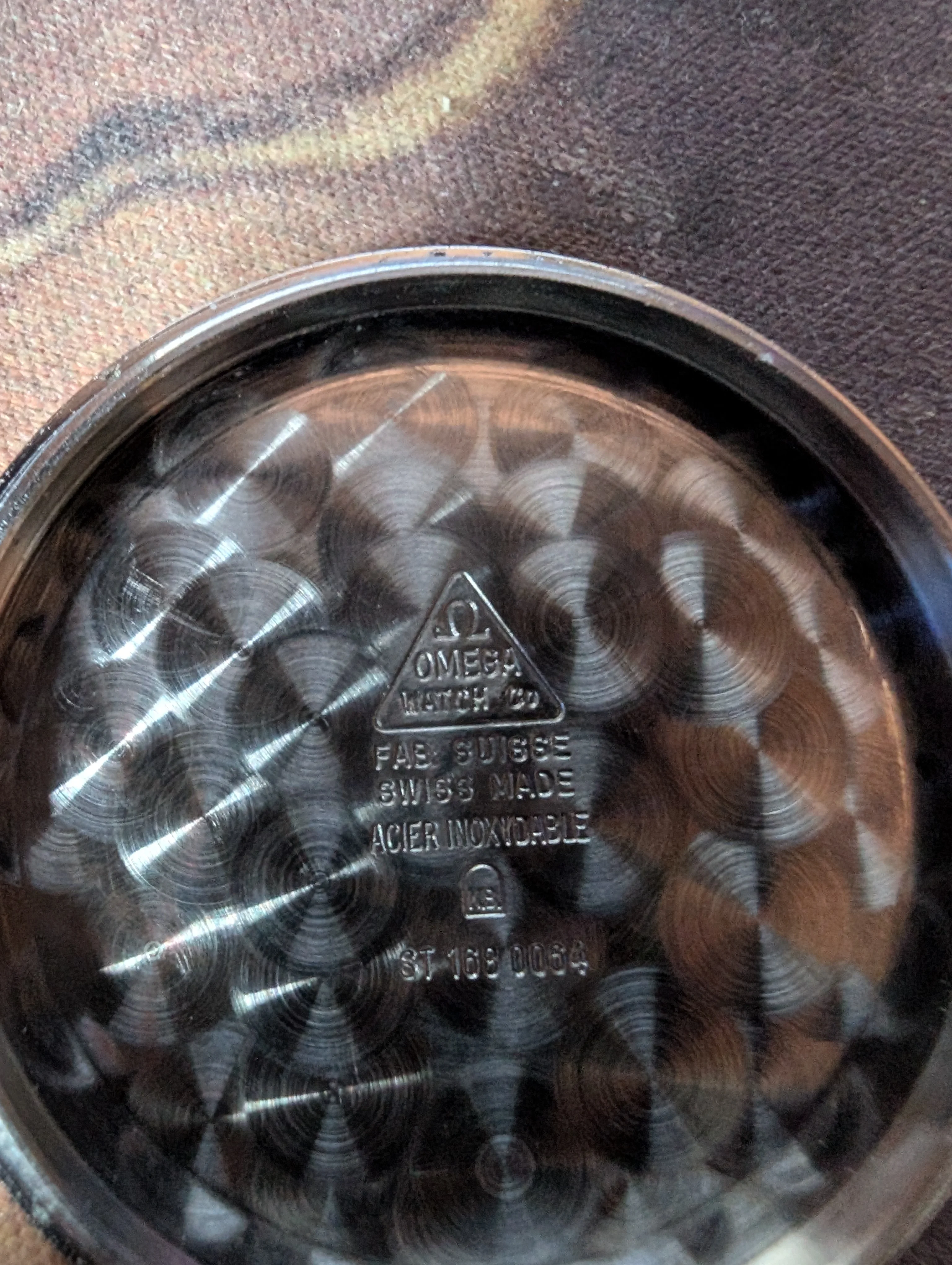

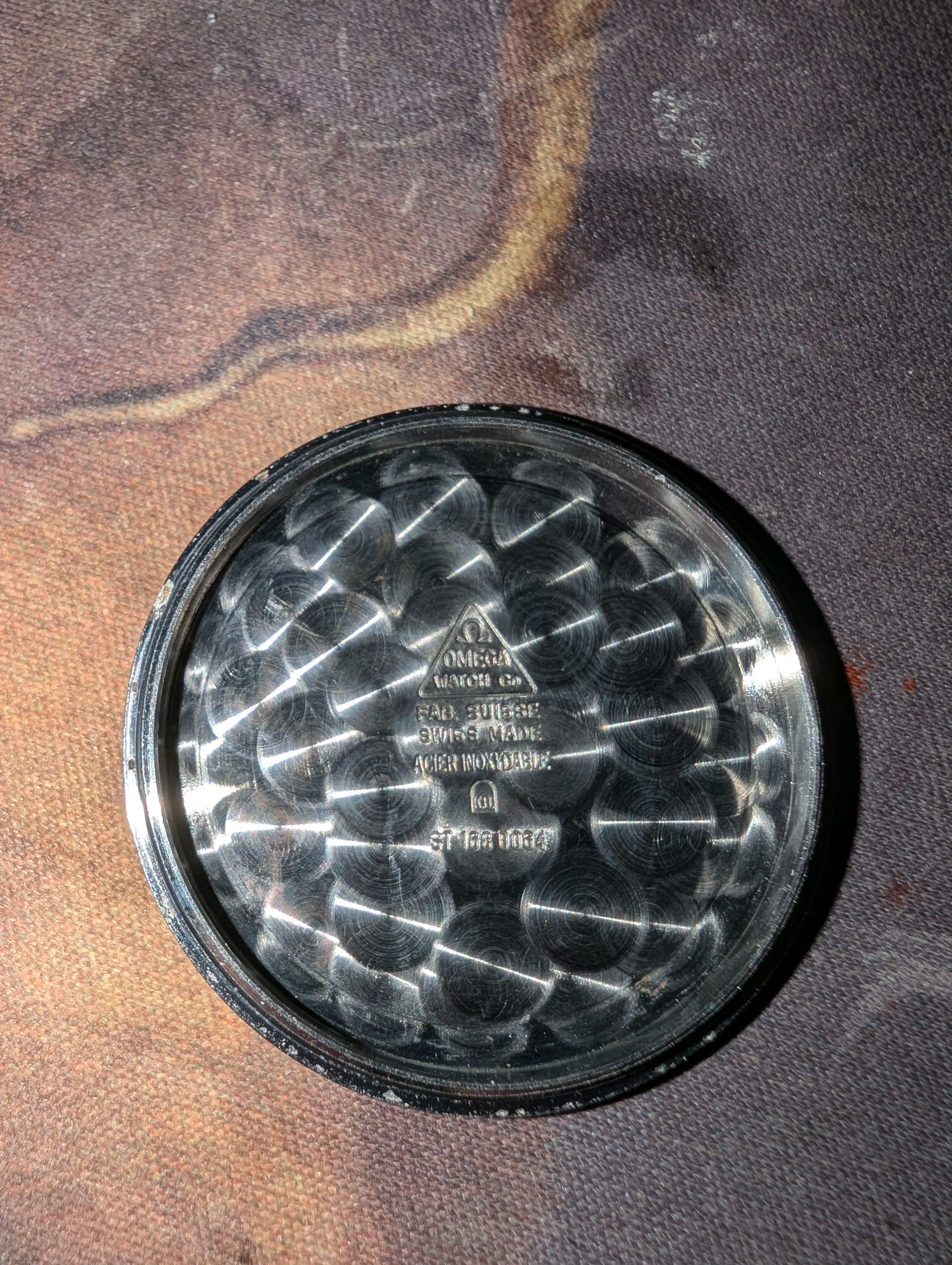

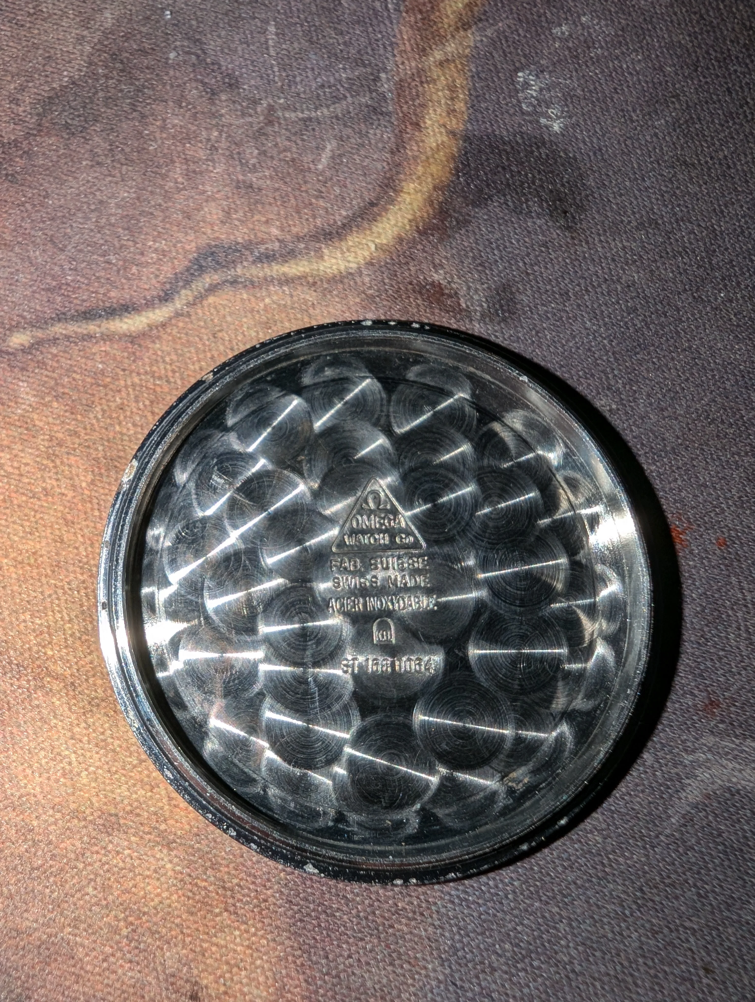

Can you tell us what is written on the inside of the case back? There should be a case number in there. Then I can tell you what the proper crystal is for this watch, as I don;t believe it should have the crystal and seal that you are showing. That looks like someone had modified this to accept a sapphire or mineral crystal.
29,671
76,828
Thanks - well I'm surprised - this actually comes with a sapphire crystal. So everything there looks good.
I believe Hirsch Straps has been recommended else where on the forum. I just ordered a leather strap from them, happy with the selection options and quality
