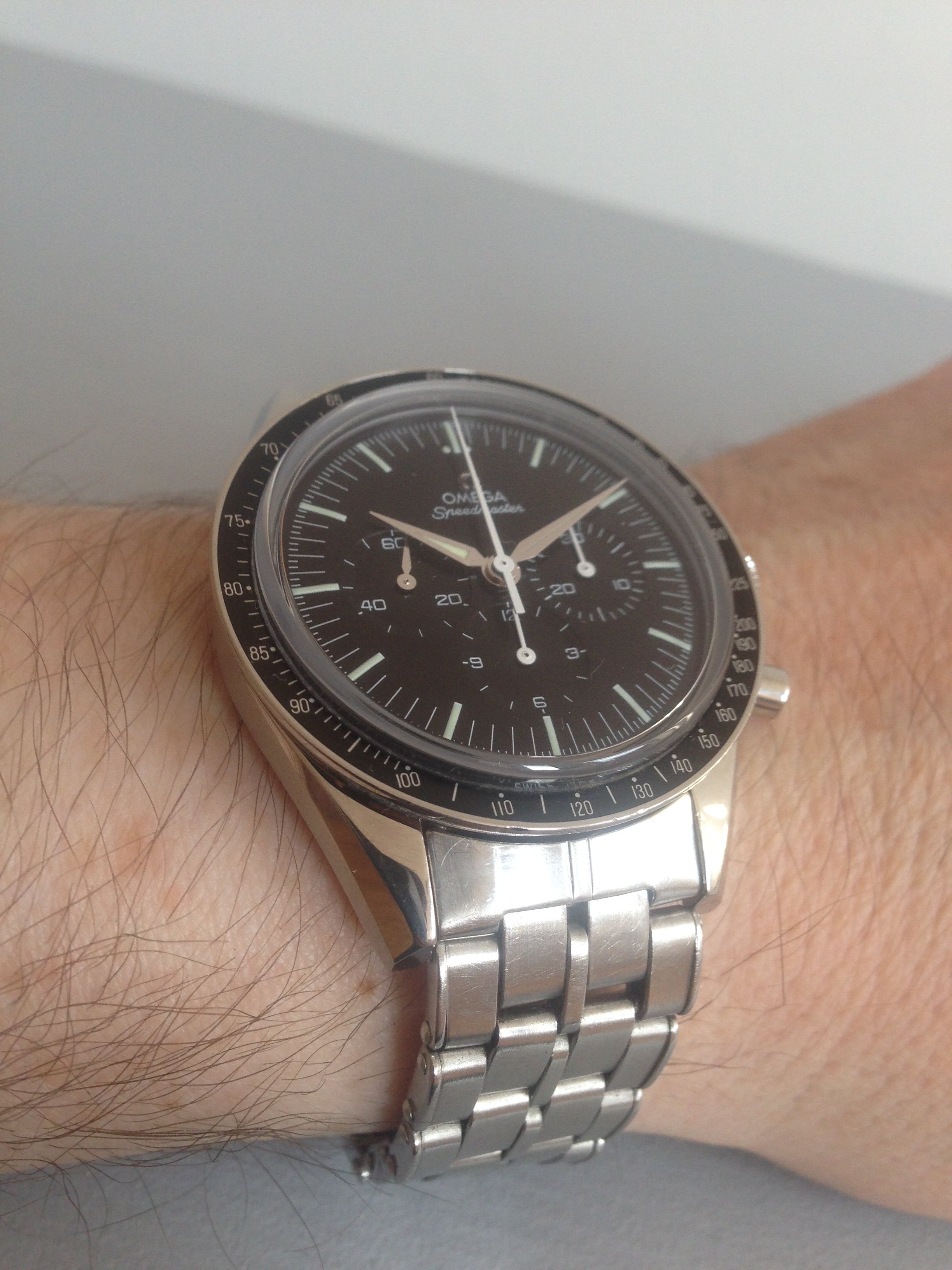

Riveted bracelet with spring-loaded links
Here is a 1093 bracelet with "borrowed" end links 524.
I will post better pictures when I have found the right 538 end links.

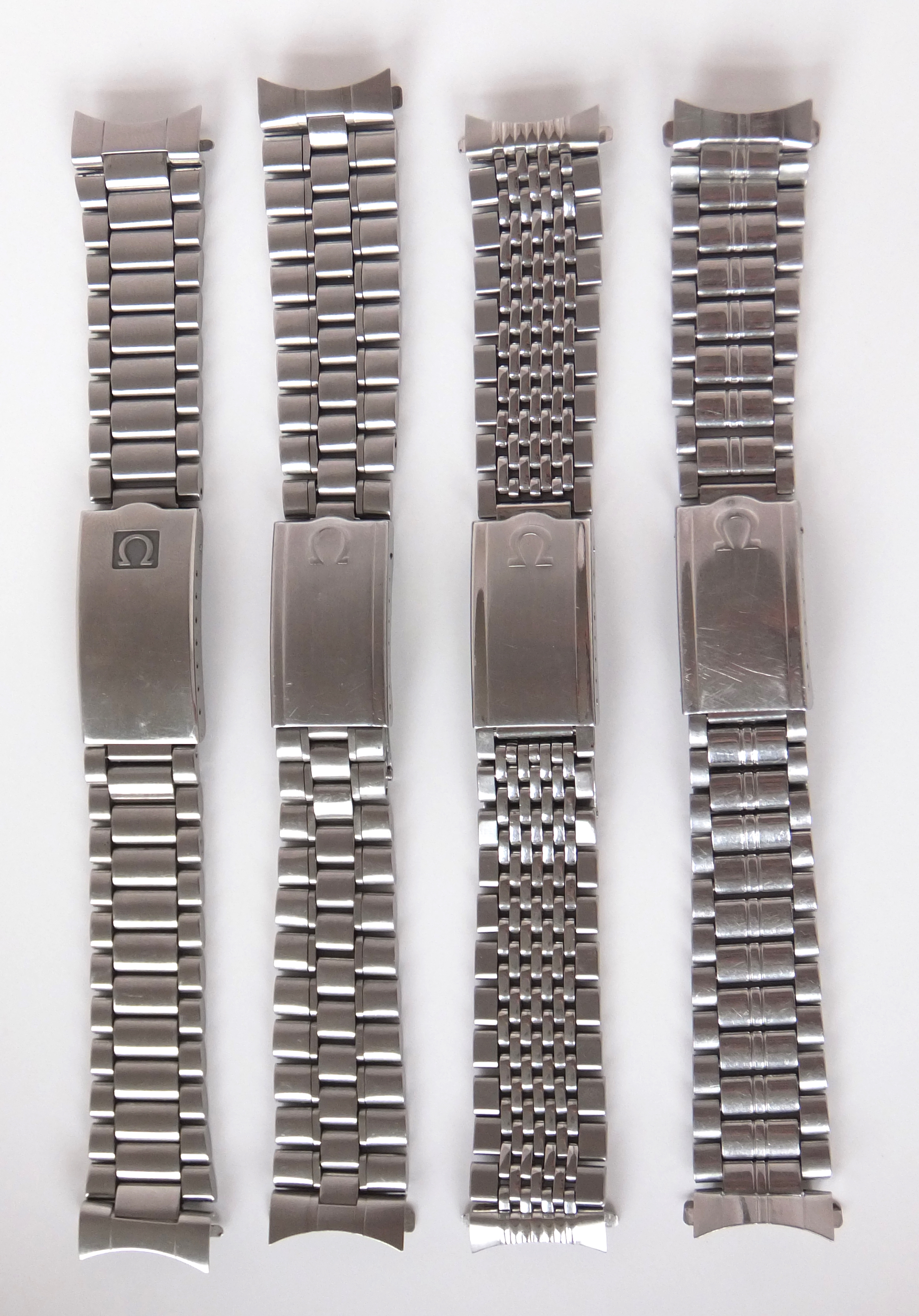

Group photo of the four tested bracelets.
From left to right: 1125/617, 1098/540, 1068/556, 1069/524

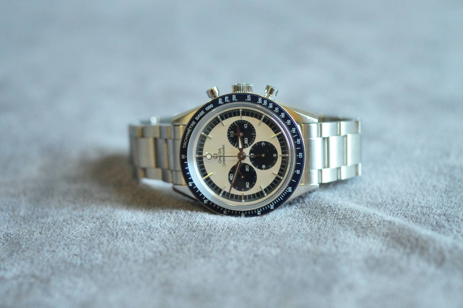

FYI The " real/original " FOIS (Wally Schirra's personal CK2998-4) was worn on a metallic elastic strap during training and on a Komfit Forstner during the actual Sigma 7 spaceflight in October 1962... exactly 57 years ago.

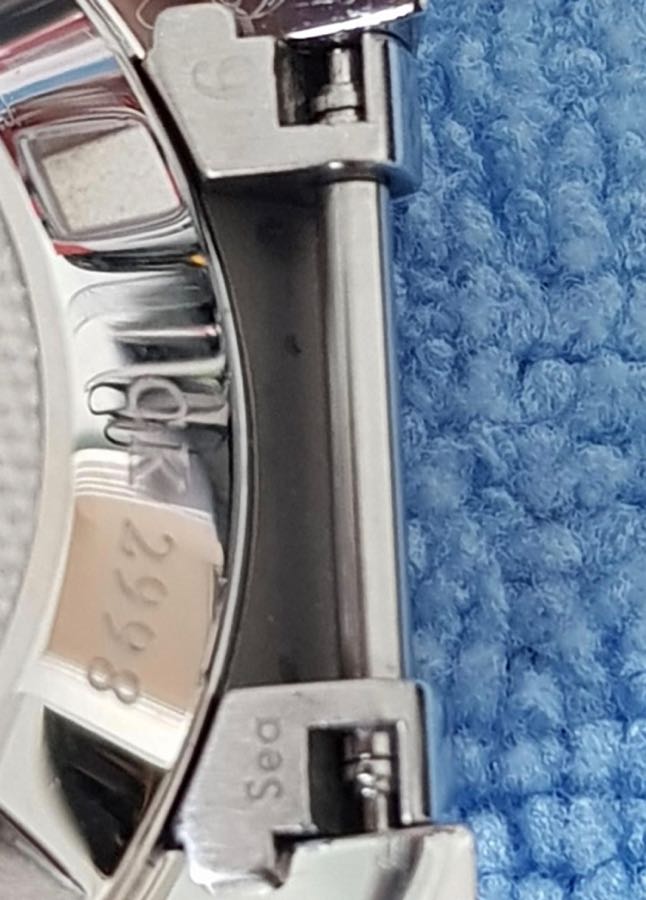

It definitely doesn't fit. The attached photo shows a seamaster end link on a CK2998. the link itself fits, but if you look closely you can see that the springbar ends are still compressed and haven't engaged with the case. This is because the holes in the lugs are deeper, or nearer to the watch face than the depth of the springbars in the end links.
