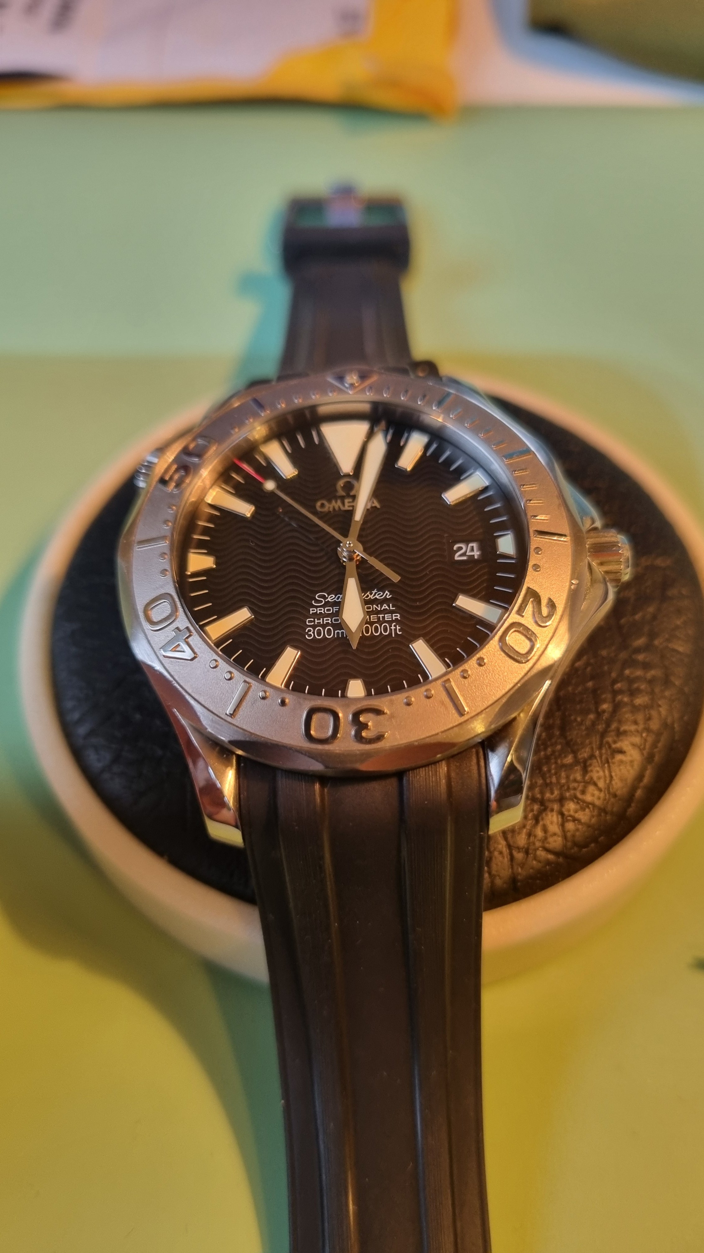

Hi, I've recently got my first Omega, a Seamaster 2230.50. I specifically wanted this watch for the white gold details on the dial. Although I quite like the bezel insert, I would like to preserve it by swapping out a bezel insert from a similar model; a 2254.50 for example.
I know there's some difference in height due to the clearance needed for the hands and the indices but not sure how that may affect a insert swap.
Is this as straightforward as I hope it will be or do I need to buy a whole new bezel from a Peter Blake or similar.
The watch is due for a service soon, so I hope to get the necessary parts to pass on and let the watchmaker swap them out.

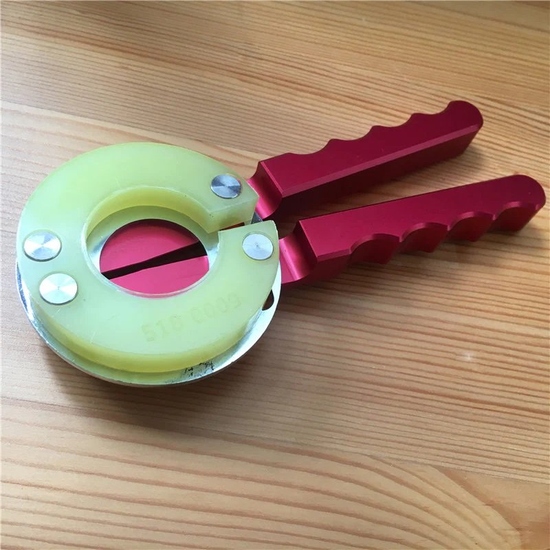

Another word of advice--Omega bezel assemblies cannot be popped off with a case knife without doing damage. DO NOT DO IT!! You need a pliers with a soft synthetic ring that evenly pulls the assembly free while you rotate it counter-clockwise.

I'll be wearing this watch every day and as a service engineer, I fear the bezel will not wear well. I'd rather swap it out for something that doesn't cost half what the watch did.
