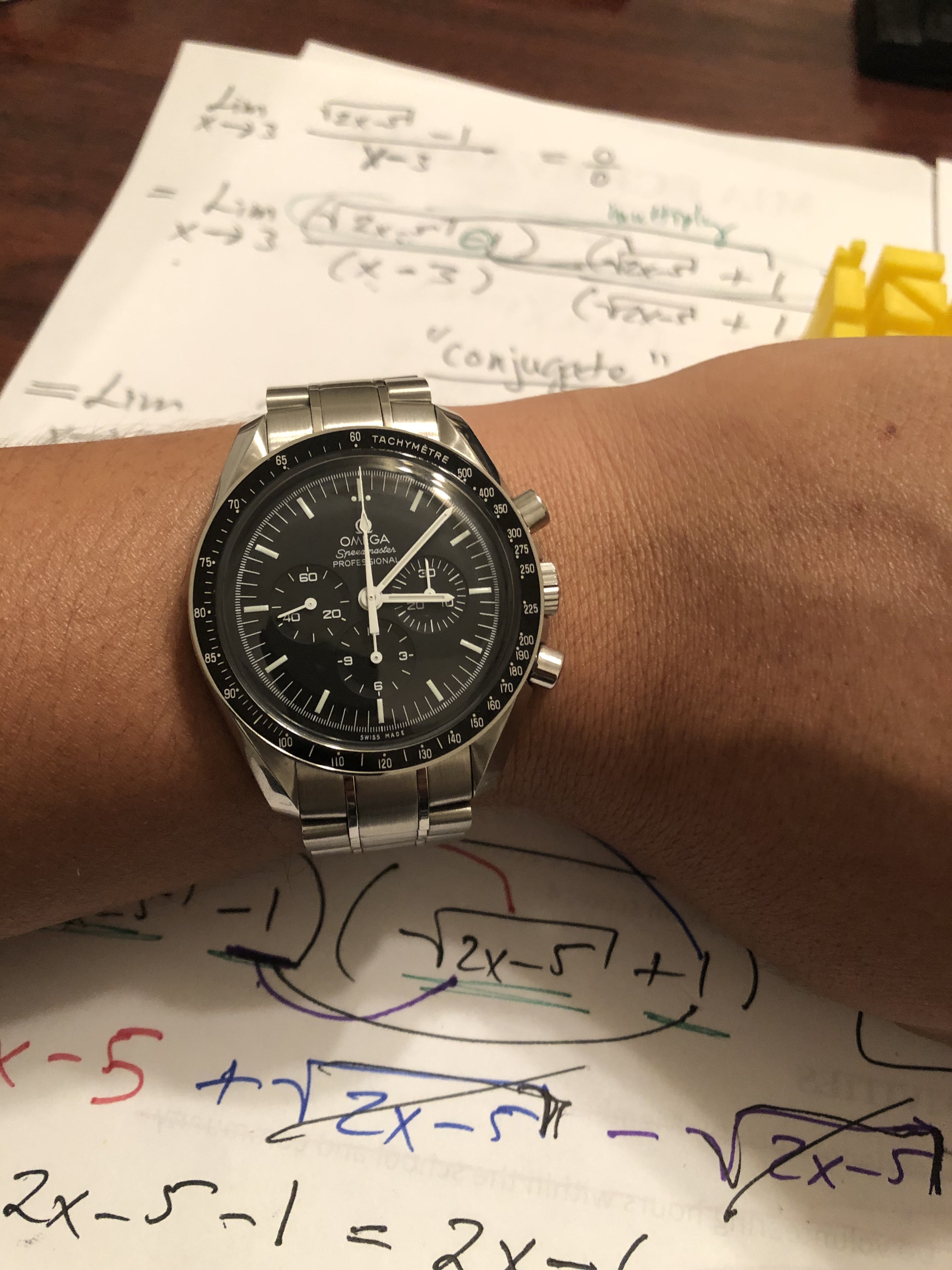

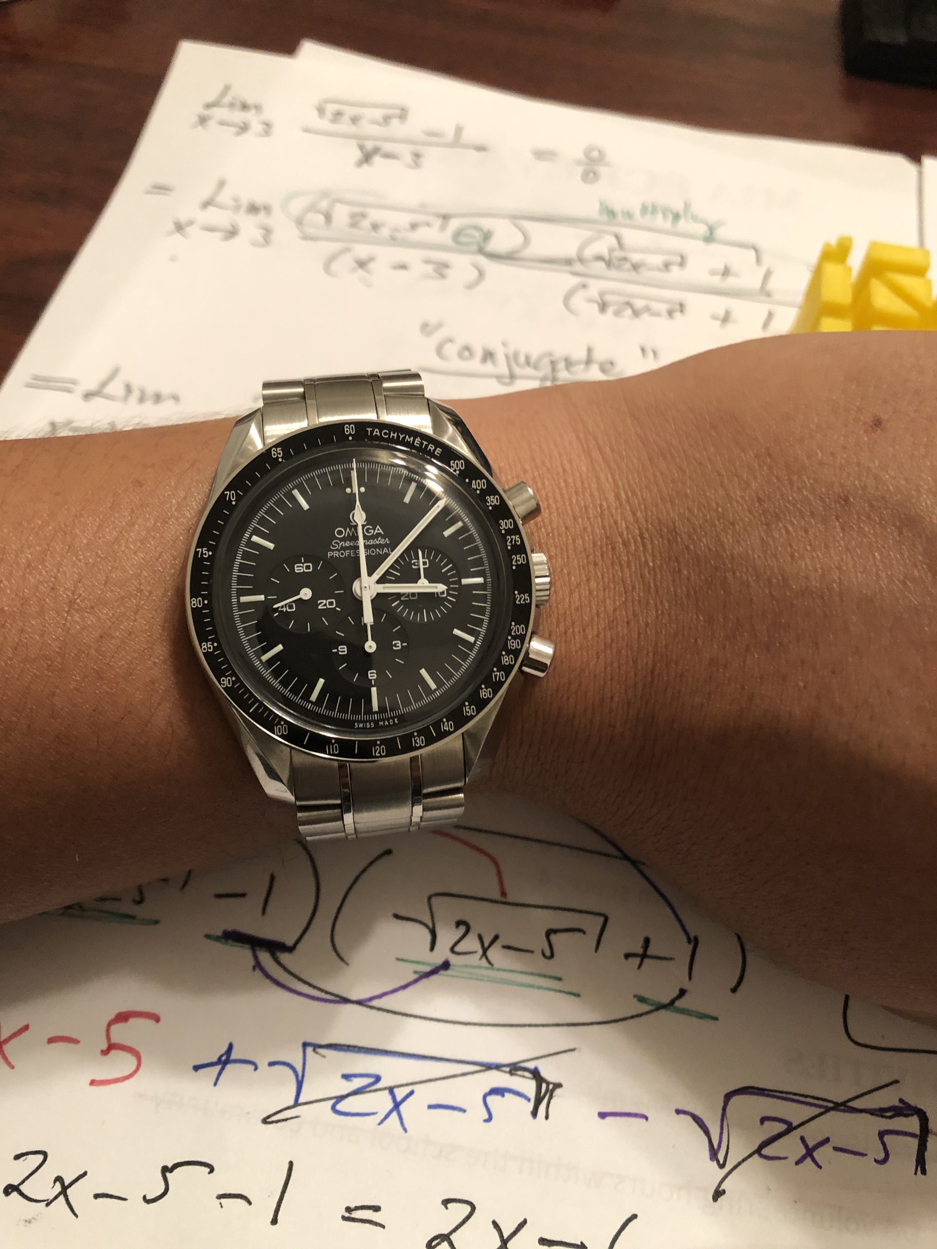

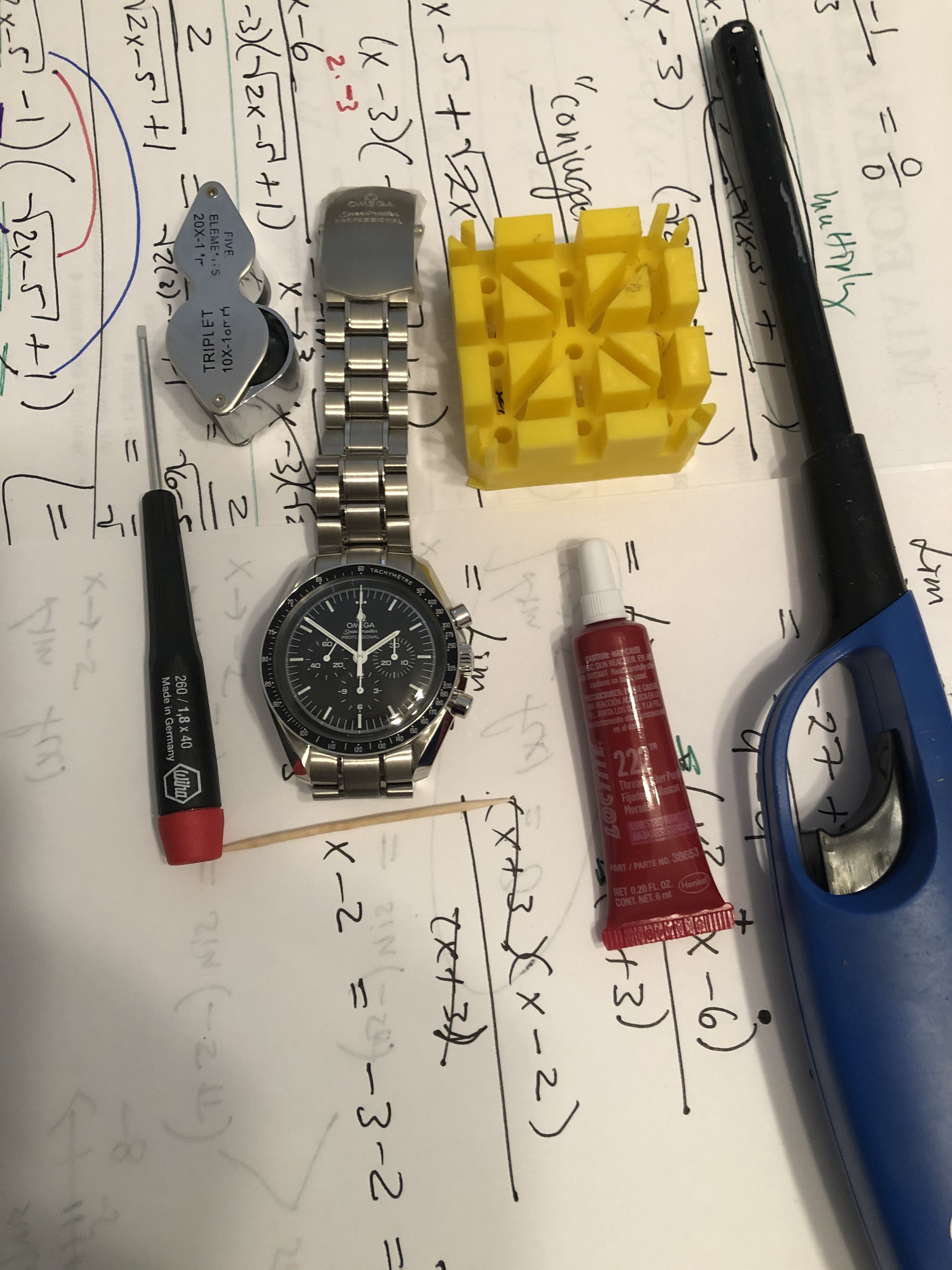

Alright y’all, so I wanted to size my new speedy, looked on this forum; and someone said to order the wiha 1.8mm slotted screwdriver and it would fit like a glove.
Well it didn’t !

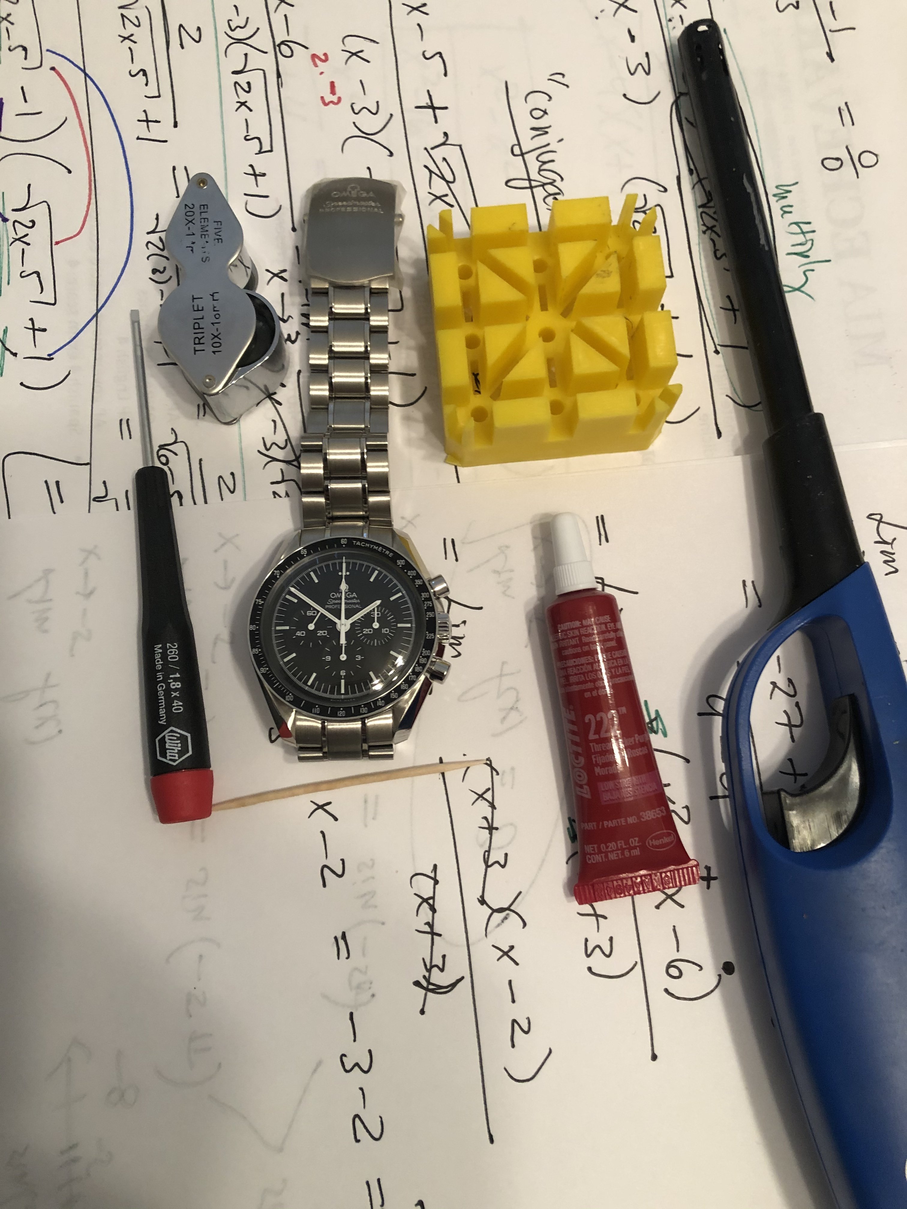

Anyway, here are my materials:
477
496
I don’t have a nice pad to work on my watches so I used some scratch paper that I had in my recycle bin.

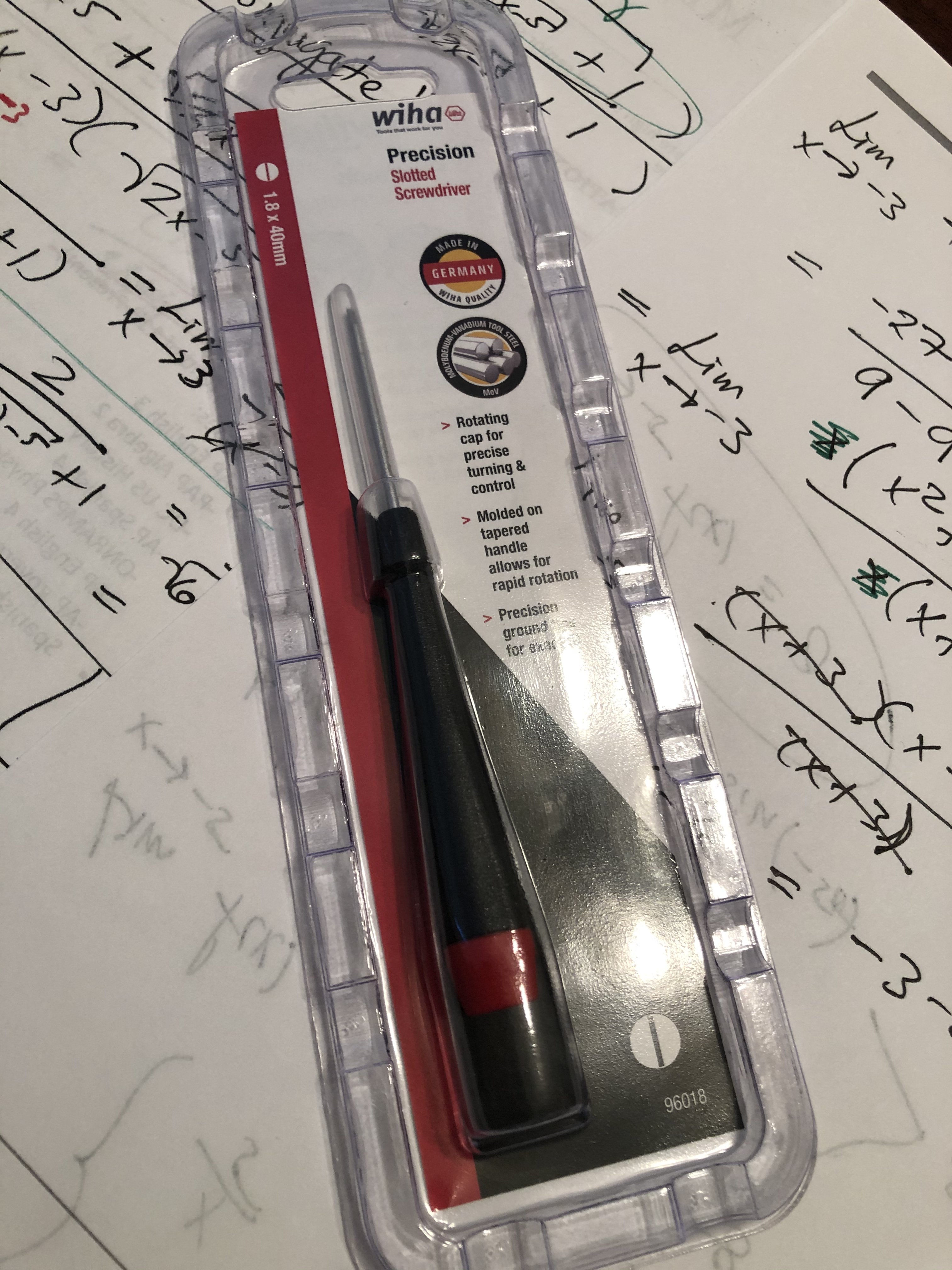

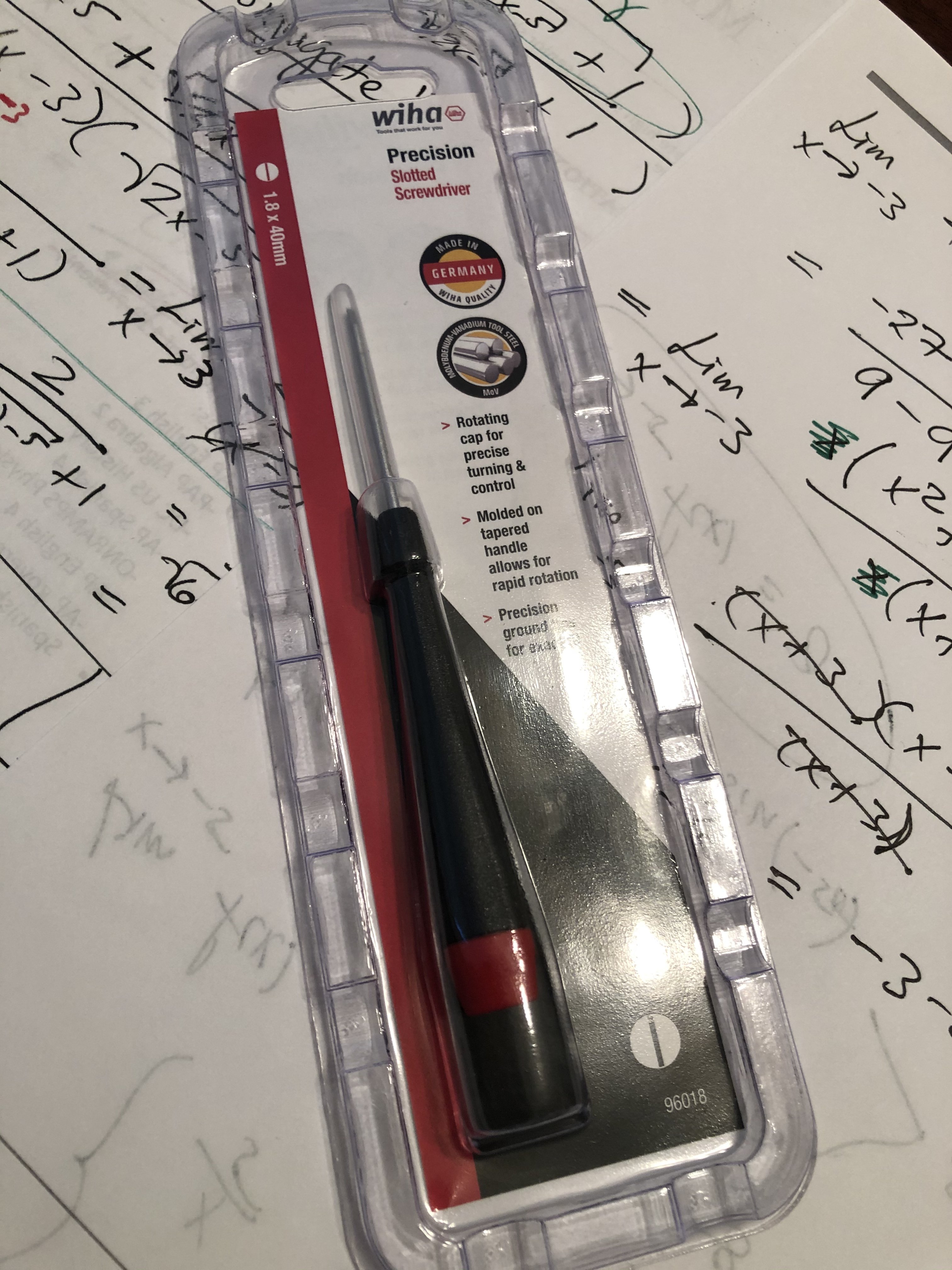

Here is a pic of the screwdriver that I bought.
477
496
I used the lighter to loosen up the loctite, one screw at a time, and the yellow box to hold the bracelet, the toothpick to apply the loctite 222 that you also see in the pic and the loupe you see better.
because the screwdriver didn’t fit perfectly; I had to use a 320 grit sand block that I had laying around to shape the tip until I got it to fit good.
It wasn’t too hard, but I just wanted to point out that the screwdriver doesn’t fit right out of the box like some people said it did.

Glad it all worked out for you... looks great. At first I thought you were using calculus to determine how much rotational force to exert on the screwdriver, but, alas, only used paper as a work pad.
Wear in good health.
