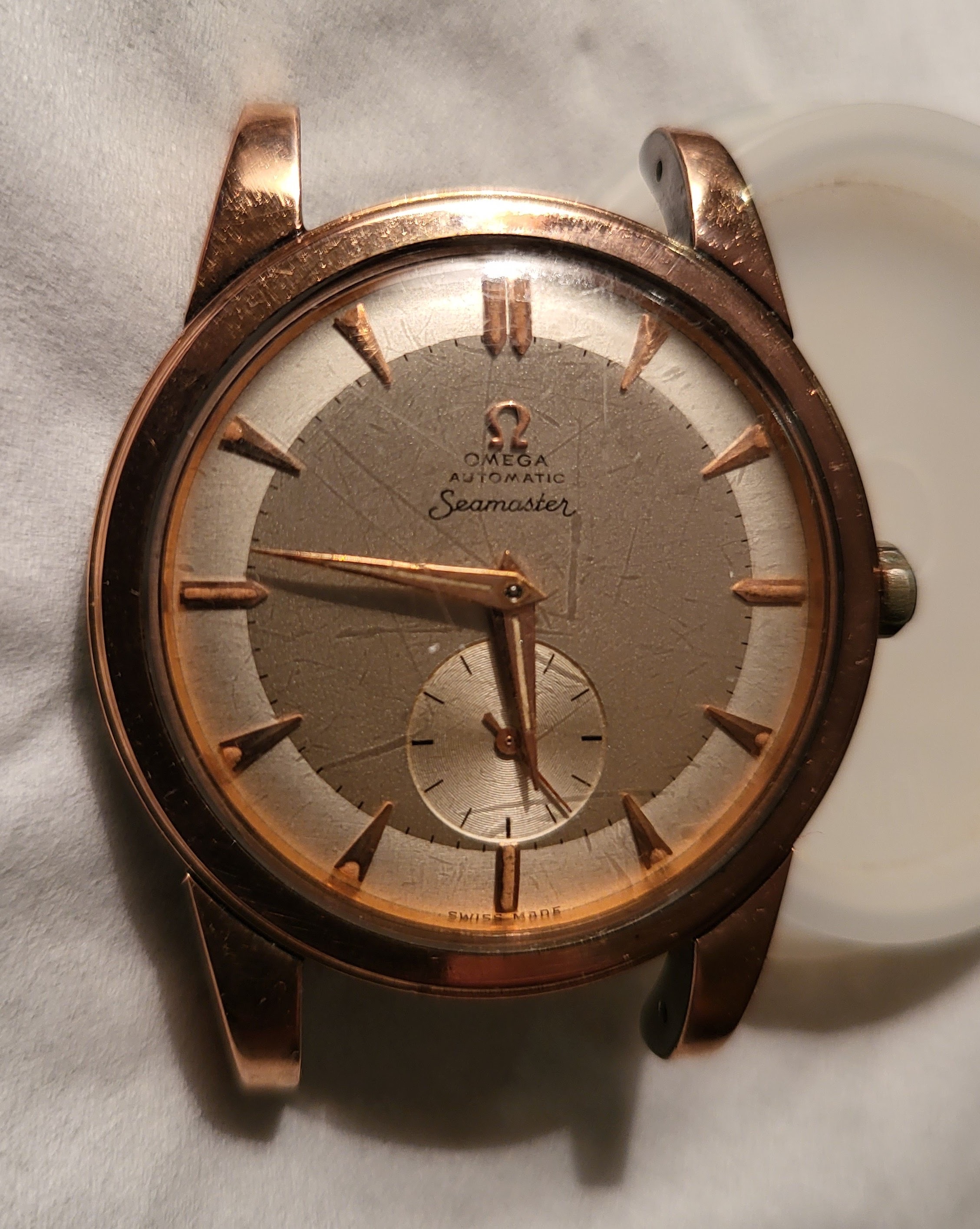

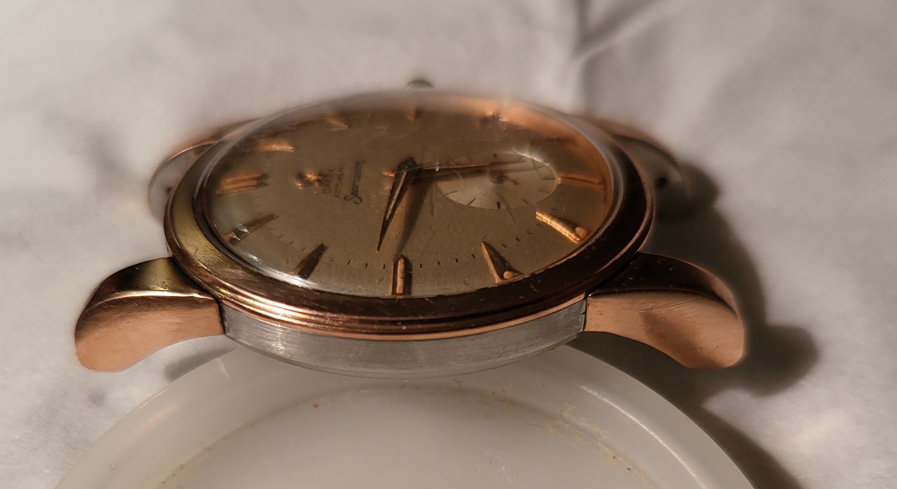

I can't get the back off this for the life of me, so I thought I'd post a picture and ask here. This is a Seamaster from my wife's family. They only know who had it, not when he may have gotten it. After poking around a while, it looks like it might be a very early model, as it is similar to a 1949 I saw. I haven't found any that combine these three aspects, though:
1. The heavy lugs which are less integrated than the later ones
2. The second hand dial which sit above the hour indicators, rather than protruding down into the six, which most examples seem to do
3. Non-numeric dial indicators
4. Oops, my second third, the watch is a very deep gold/rose gold color on the front with steel sides and back, but I can't find this in any material
If not late forties, I'm guessing 50's, but I'd love to know more.
The dial is in great shape. It runs (no idea how accurate yet).

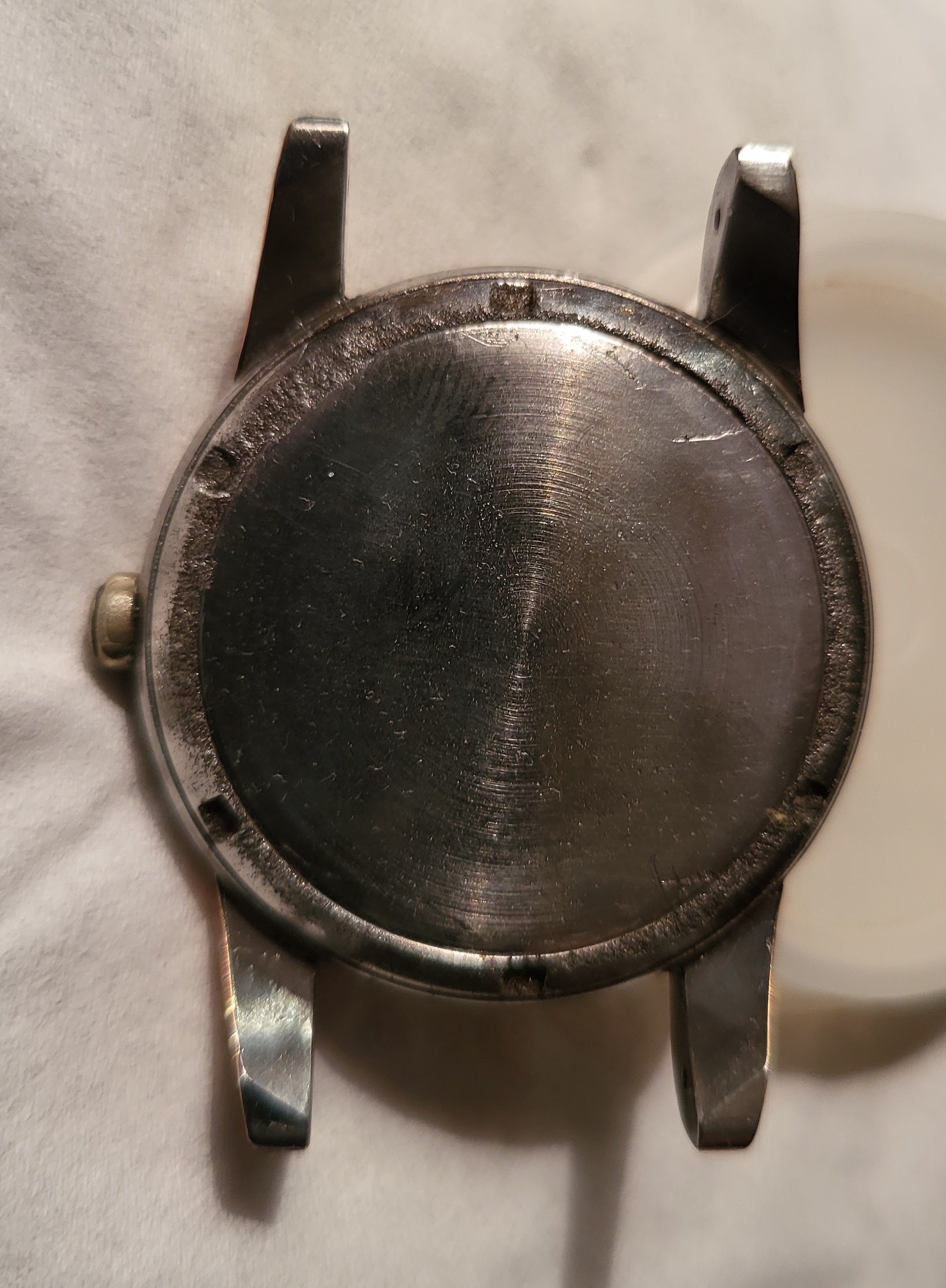

Regarding the case back, I've tried all the tricks I know: jaxa wrench of course, using just 2 pins, tape, even tried super gluing a nut to the case back, but I can't get it to stick. I'm waiting on my second attempt with penetrating oil.

Instead of trying to get the caseback off yourself, get that beauty to a watchmaker who is familiar with servicing vintage watches (this is not the same person as the mall-kiosk quartz battery changer). You don't want to scratch up that caseback any more than it already is from normal wear and tear, and a watchmaker has the correct tools to get that stubborn back removed. Then take plenty of photographs of the mechanical movement and the numbers on the inside caseback and post them here.

This is a cool watch. Rose gold capped jumbo reference (probably 2493?) with probably a 342 movement dating to the very early 1950s. Dial condition is excellent (particularly the lume color).
For reference, these are fairly uncommon in rose gold and fairly uncommon in jumbo size. The biggest downside I see is the caseback condition - it seems to have significant rust?

Thanks for the details, SeekingSeaquest! You are correct that the back has corroded extensively somehow, but I'm not sure I'd call it rust. It is more like pitted.

Back likes that is due to someone with a high acidic content in their sweat. Best way to tell. Wear a piece of sterling silver jewelry and if it turns black. Lot of acid in the system.
I would find a replacement back. Reference number doesn't matter. Similar back from a similar case should fit. Save the original.
Crown is going to be tough. Rose gold filled is rare. I had over 400 crowns at one time and only found one. Maybe buy a s/s one and have it heavy gold plated. Not perfect, but no other real option as Omega no longer sells rose gold crowns that I'm aware of

Very, very nice example. Looking forward to a picture after the plexi got a good polish. Do make sure though whoever you hand it to won't polish the case itself to keep it as is. That slightly aged rose gold tone is just perfection in my book.
Regarding the crown: I'm fairly certain I should have a rose gold clover example at home, should you want to replace it with a correct one. Feel free to drop me am PM if that's the case. 😀
