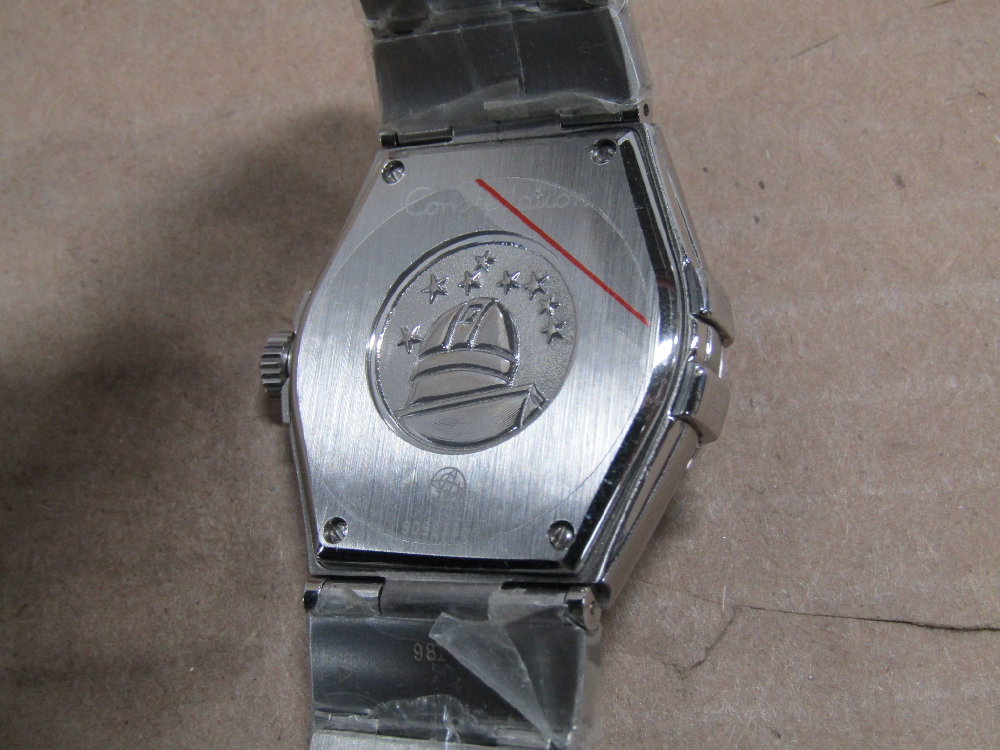

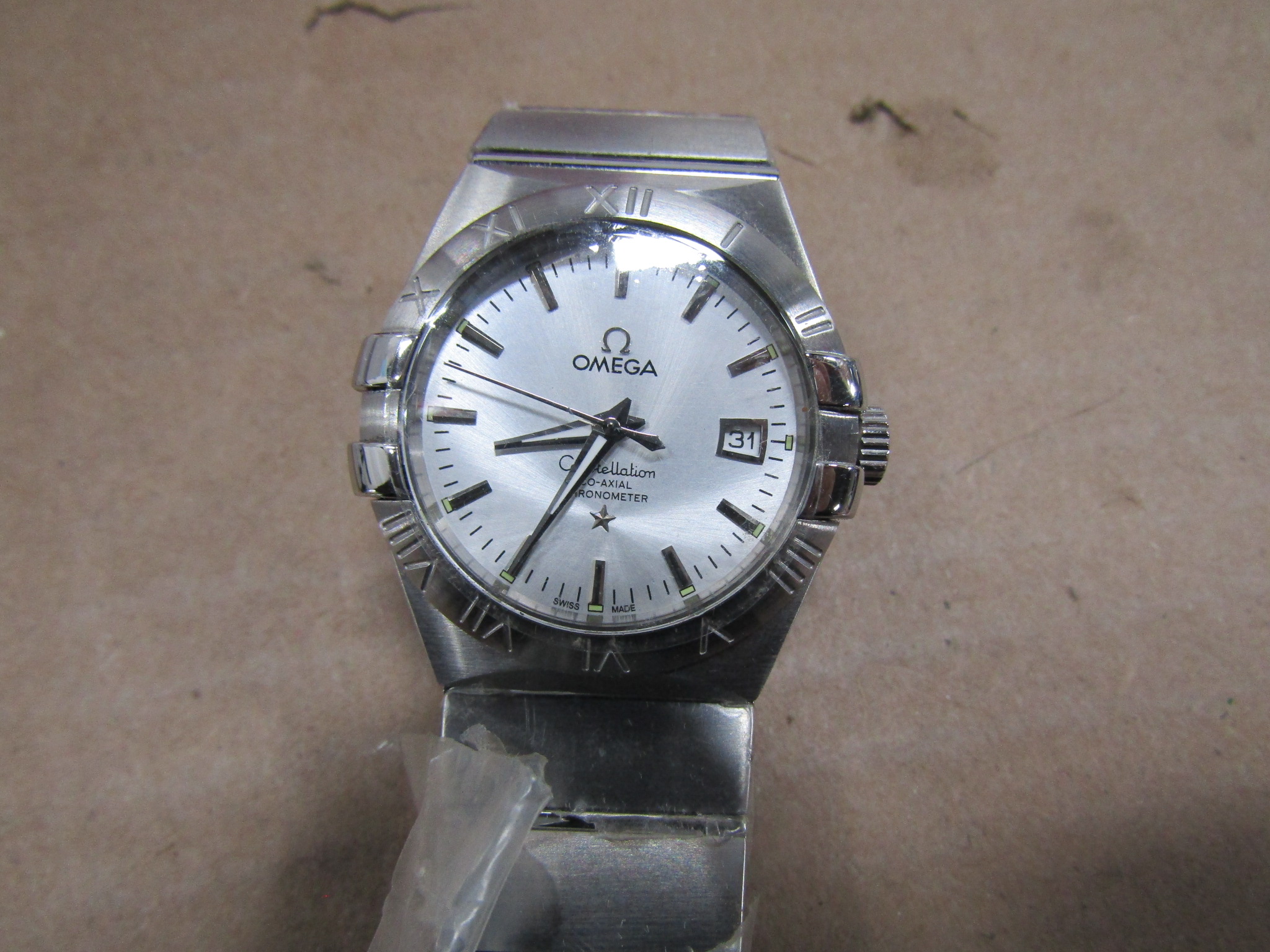

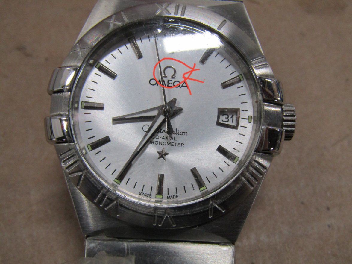

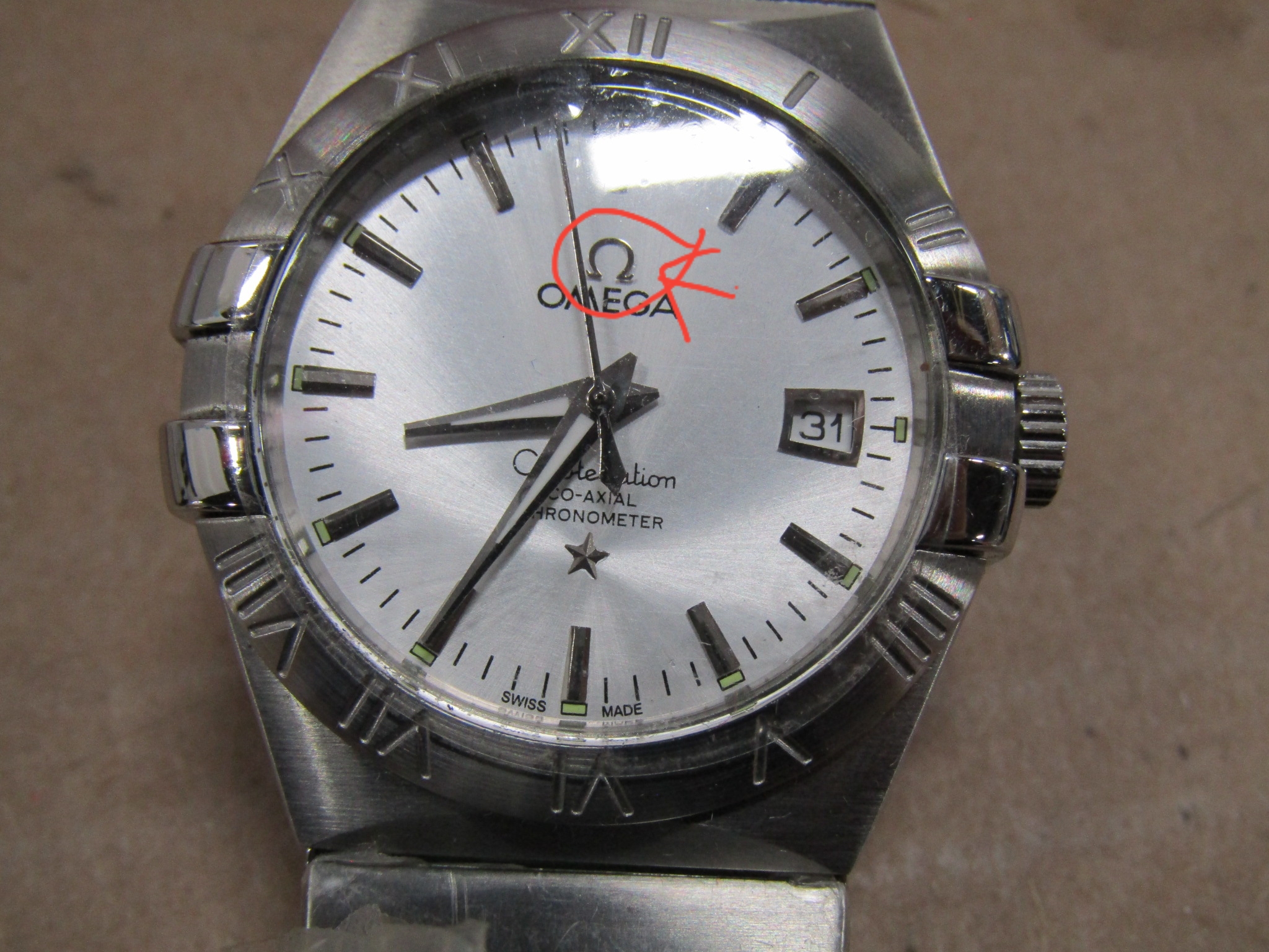

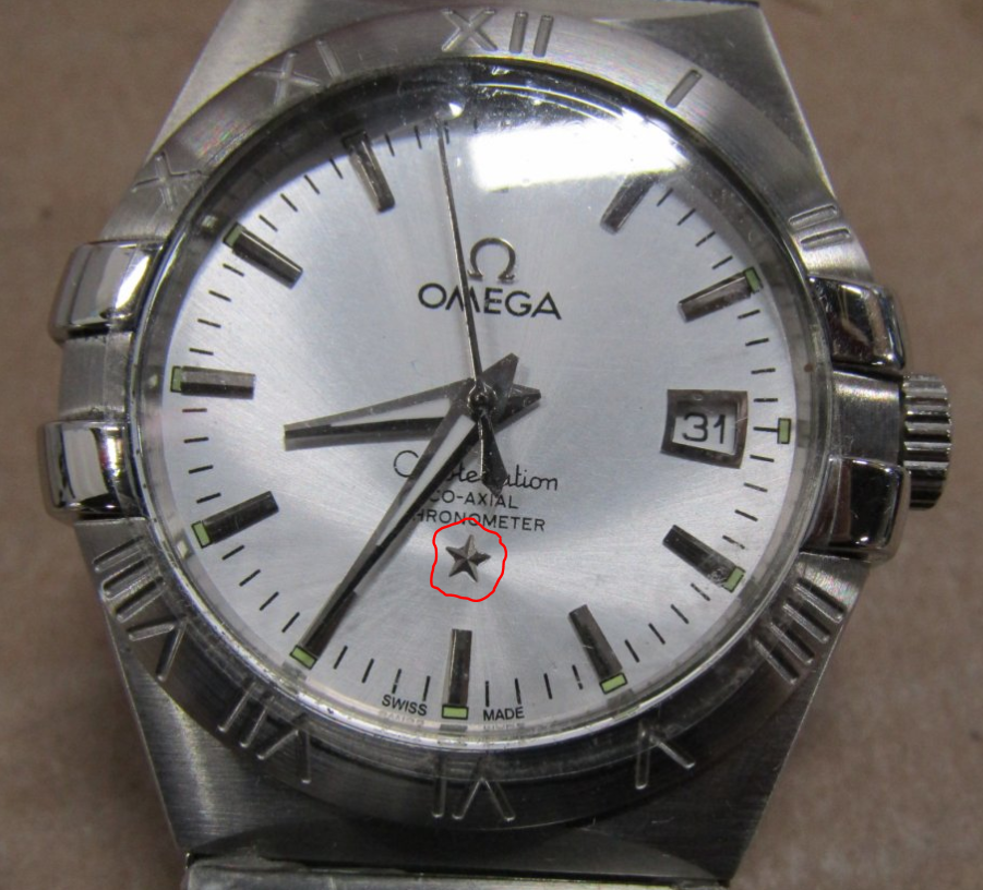

Hello! I'm having trouble determining whether this watch is fake or not, what do you guys think? Any help would be much appreciated, thanks!

It seems to me to have either been heavily polished in spots and possibly relumed, or possibly fake, but don't take my word for it, Connie's aren't my go-to. Others much more familiar with them i'm certain will be more helpful.
1,440
3,774

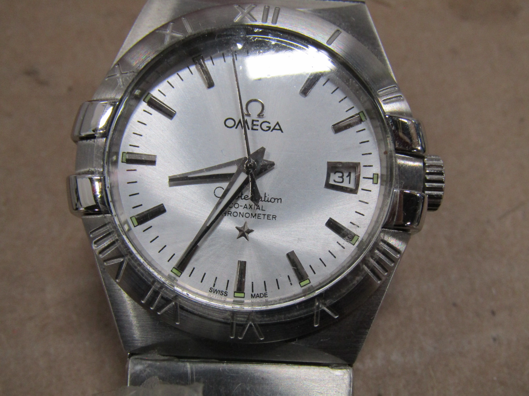

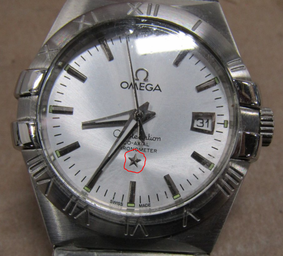

Star is off.Bezel is not too far away from the star actually. I'd be surprised, if this is real.
18,326
27,695
It looks off.
The globe etching seems wrong also.
3
Was it priced accordingly?
I actually got it for $300 at a flea market which would be dirt cheap if it were real, I guess I was hoping for too much haha
1,441
3,809
ouch - not sure if it’s worth much more as authentic
4,517
11,119
Does it run?
I'm betting that it's a quartz movement inside.
30,274
78,127

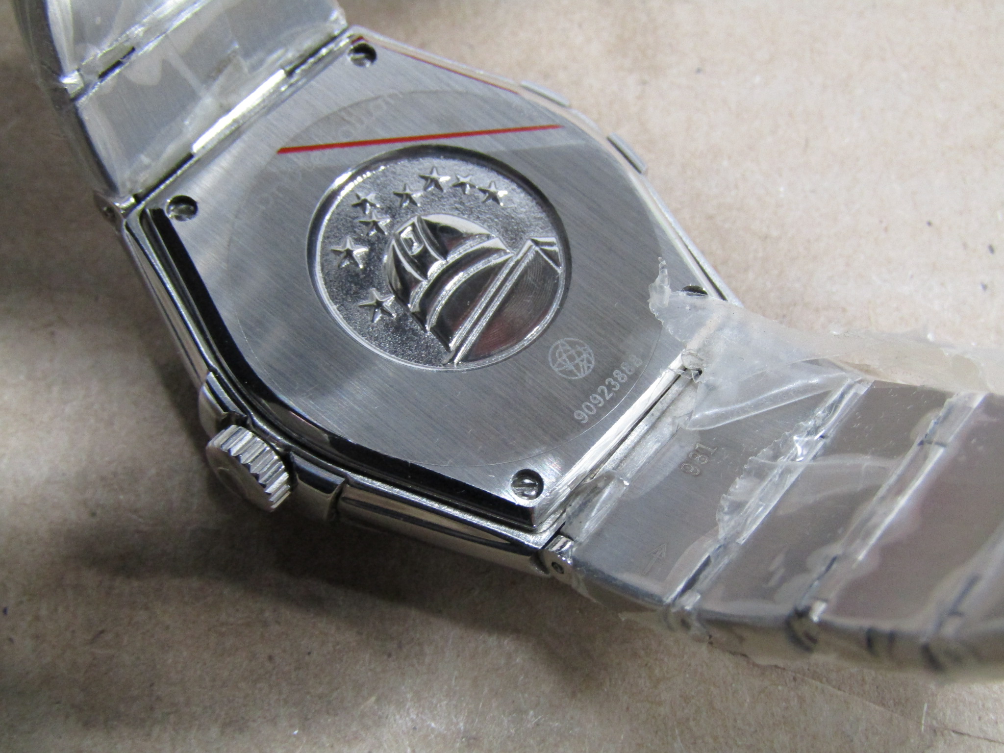

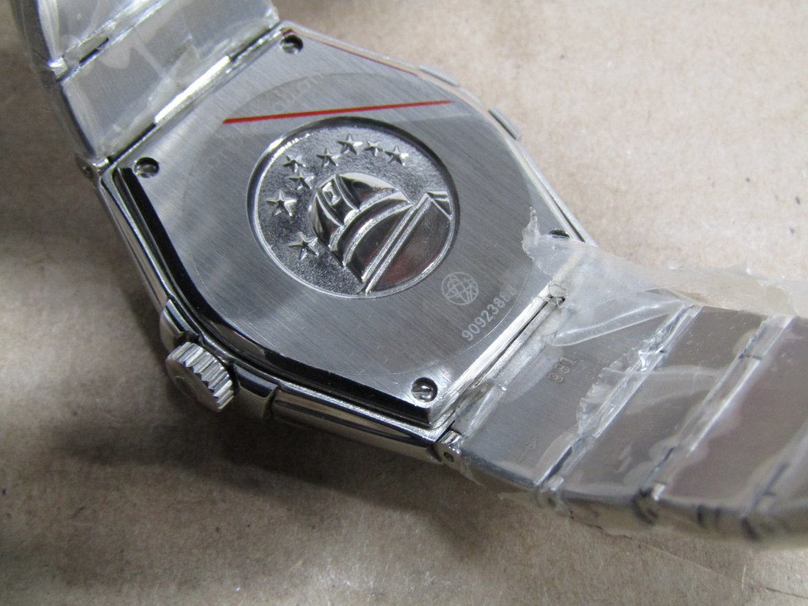

It is most certainly a fake - serial number check reveals the following:
Serial number: 90923888
Article ref: 12325276063002
That reference is for a steel and red gold ladies Constellation ( quartz) with a brown dial fitted with diamonds, and a diamond bezel.
1,440
3,774
Sorry to hear this. Call it a newbie taxes and move on. Next time you know where to get info also watches for sale by members here. Could've been much worse.
