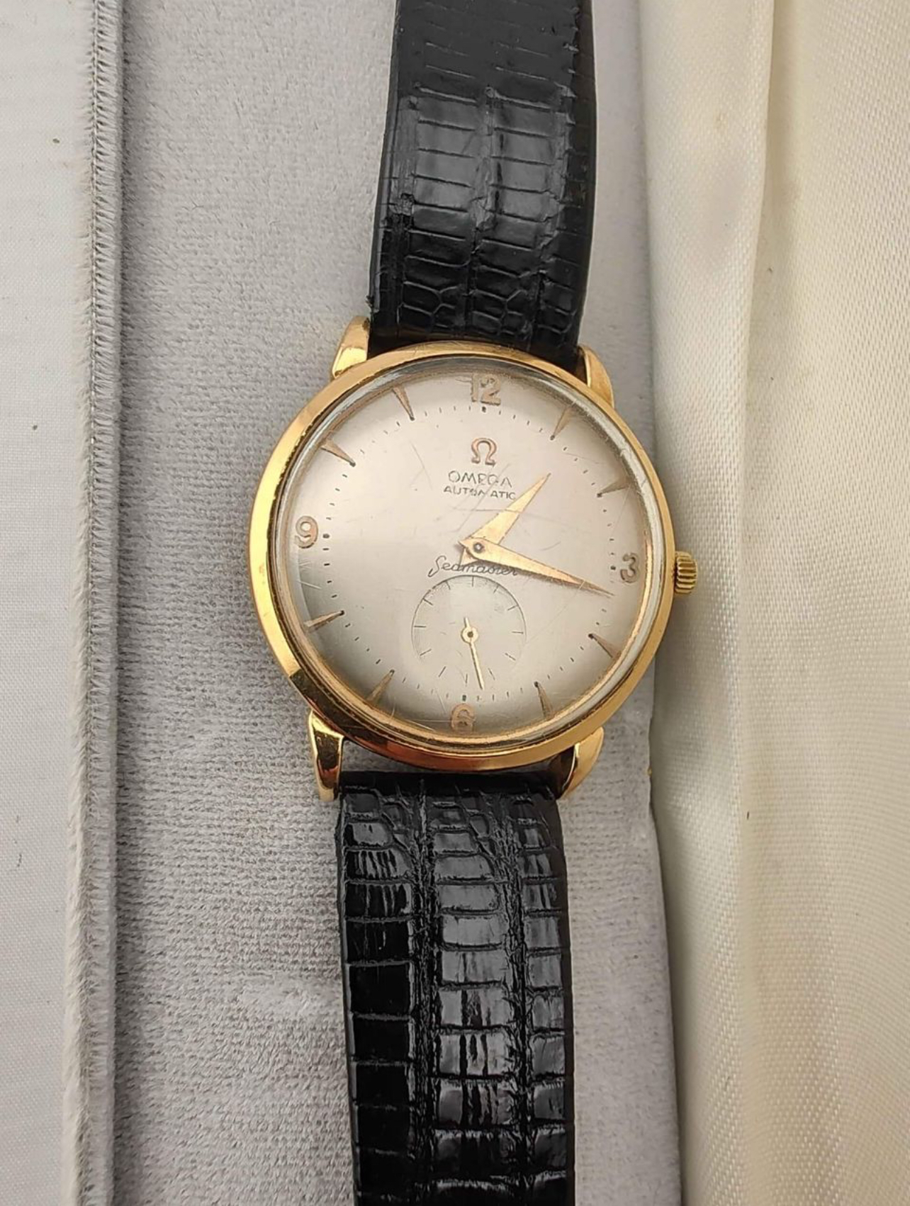

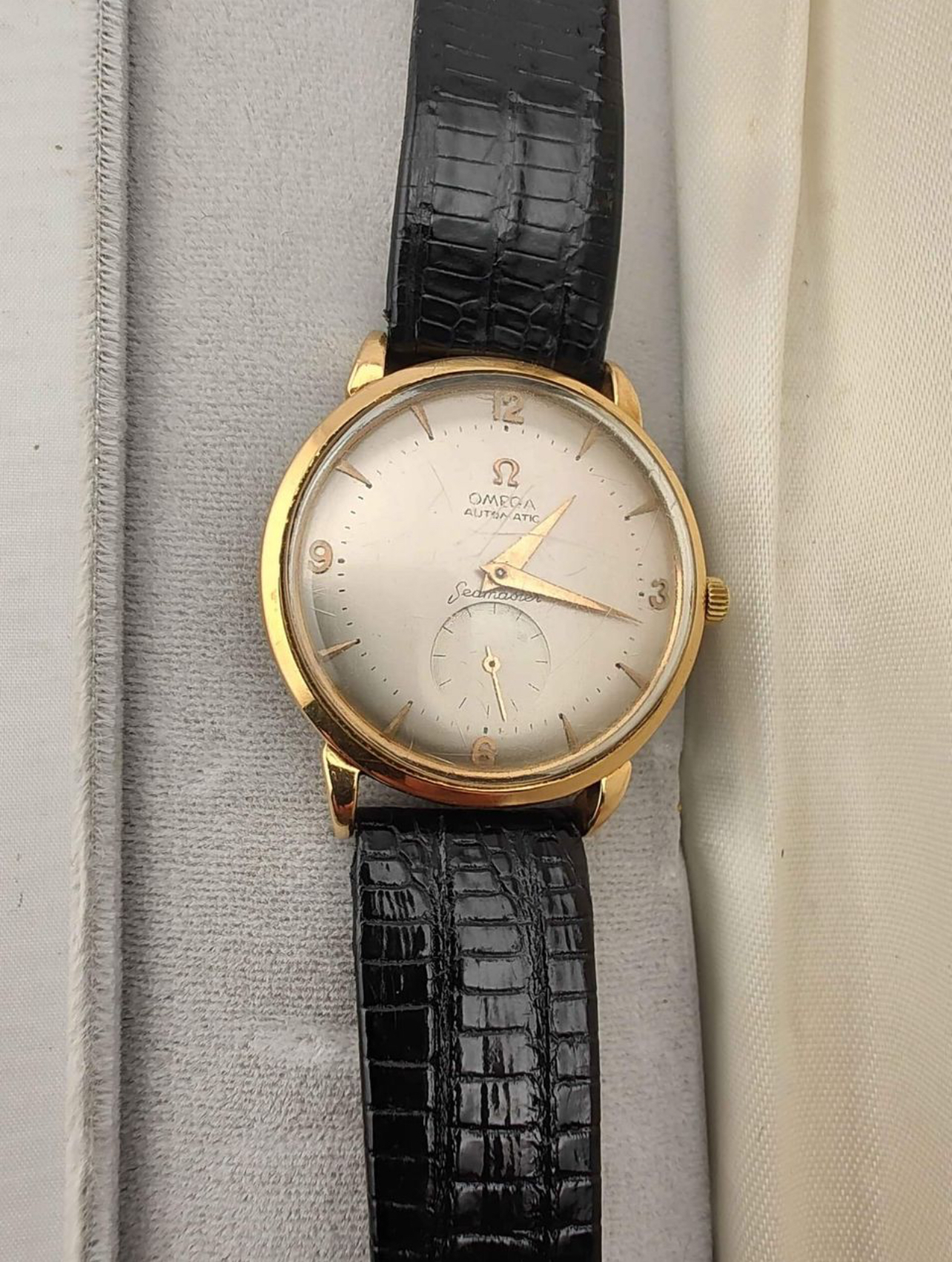

Bought this recently. Looks like a redial based on what I found out. But everything else looks real ??

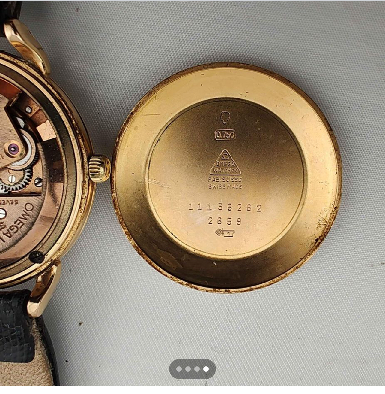

the marking are inside the case

Redial for sure, font is crude, poor minute marks,sub-dial has been polished away at bottom. Case has soft edges.

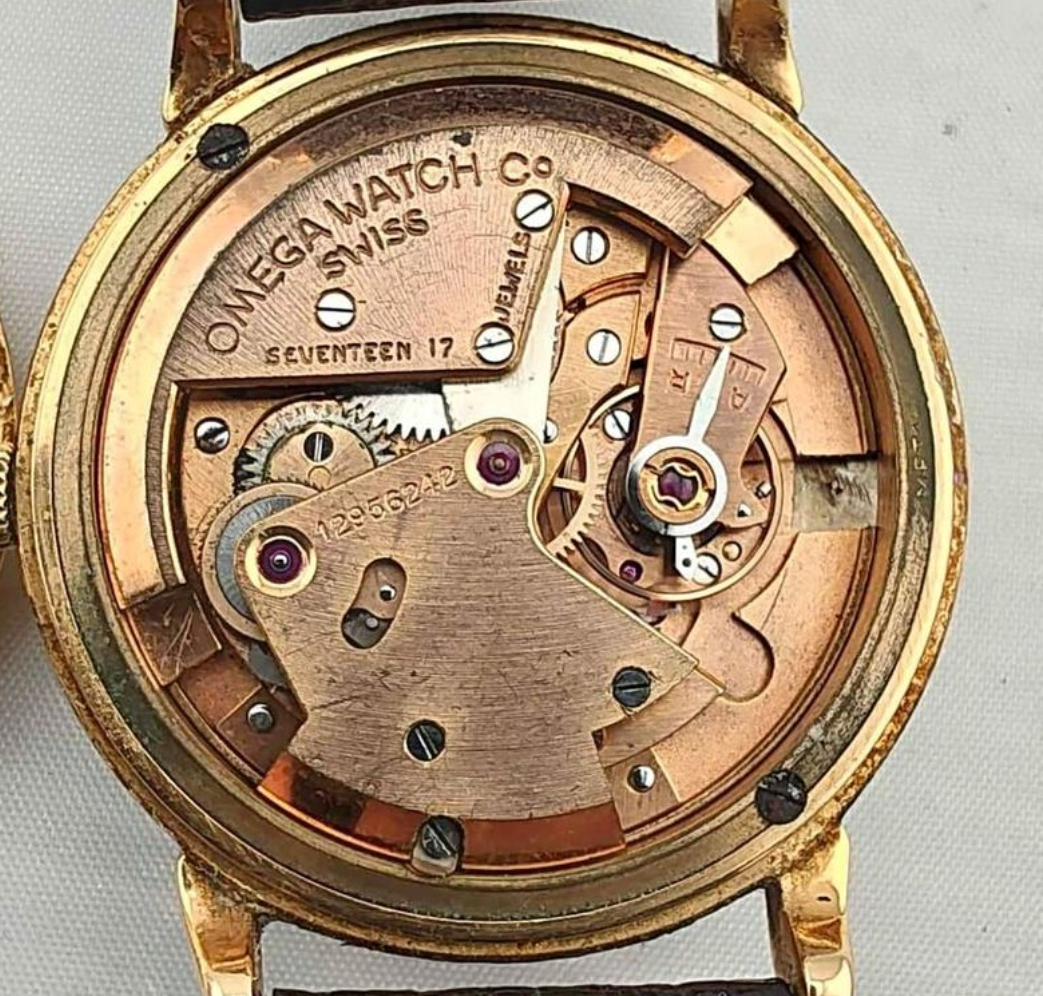

Movement looks to be omega, but can't say what state it is in by looking at it.
Melt value might be your best option given price of gold.

With a snap back case like this it never was a Seamaster.

As stated above, melt value plus maybe $100USD for the movement and hands if you get lucky.
Now, if you like it, and wear it (after a service) and you can still pay the mortgage and feed the kids, I guess it is an ok buy.

The good news:
It is Omega, not fake
It is solid 18K gold case
Has bumper movement cal 342
Bad news:
Redial (which you knew or suspected already)
Condition is not good due to polishing
It is not a Seamaster- but a Tresor
It is not worthless, and you can wear and enjoy it (does it run?) So I would do so, and search for another over time, but research a reference you like and educate yourself so you don't make similar mistake. And I suggest posting pictures and info on future prospective purchases here before pulling the trigger. Many others have paid much higher noob tax- dont feel bad about it!

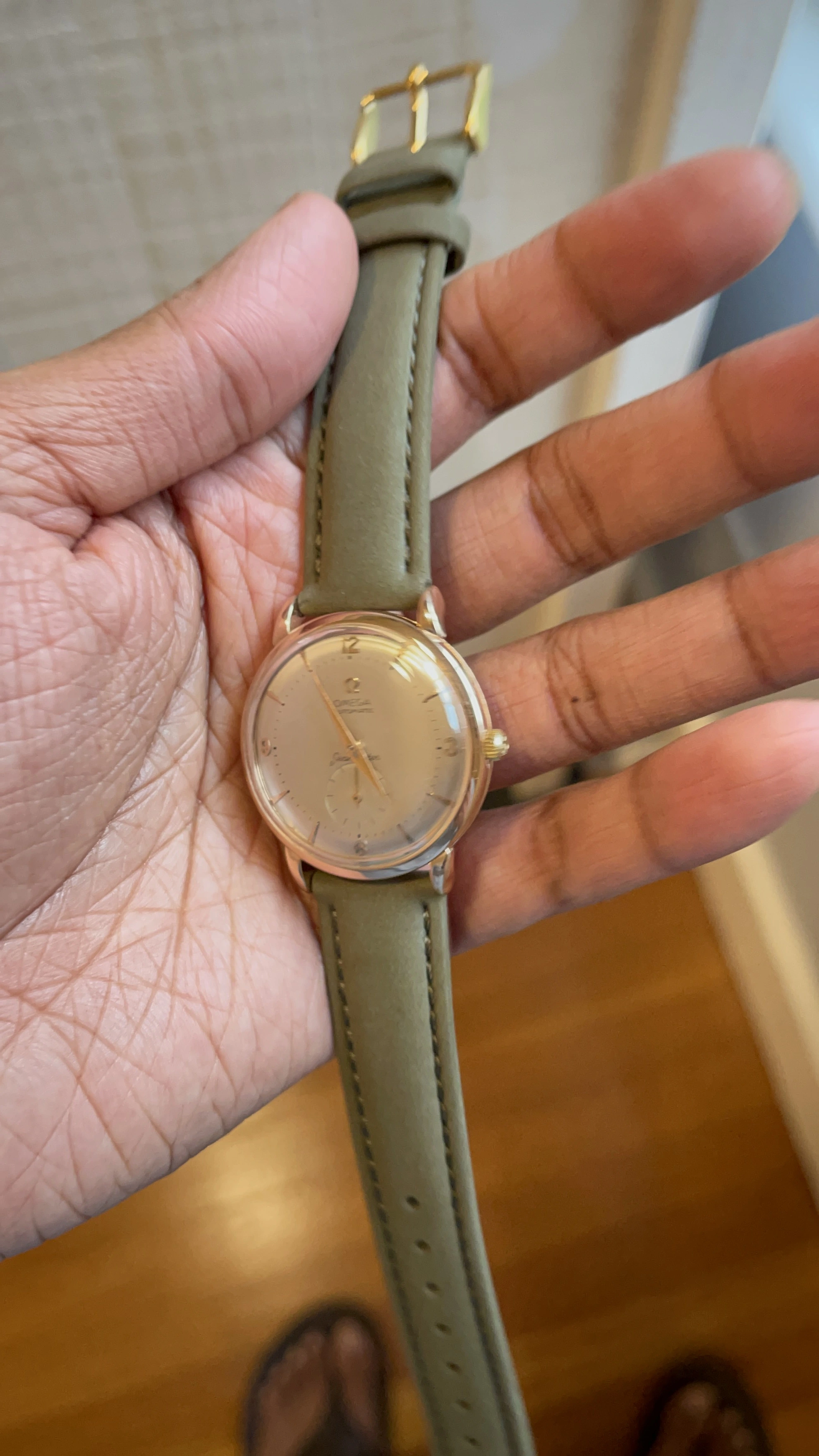

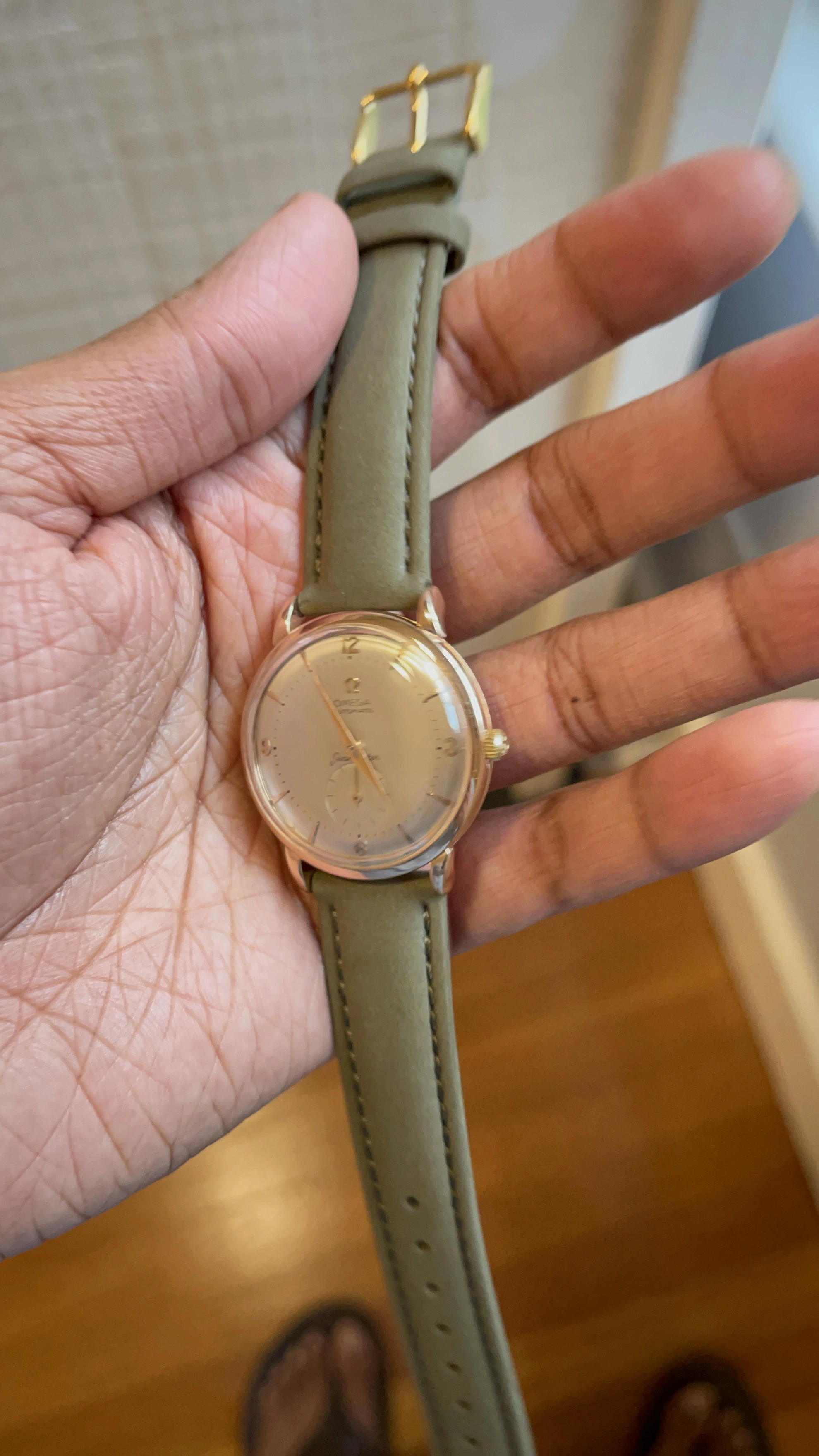

Thank you. I have some post service pics which I’m happy about.
