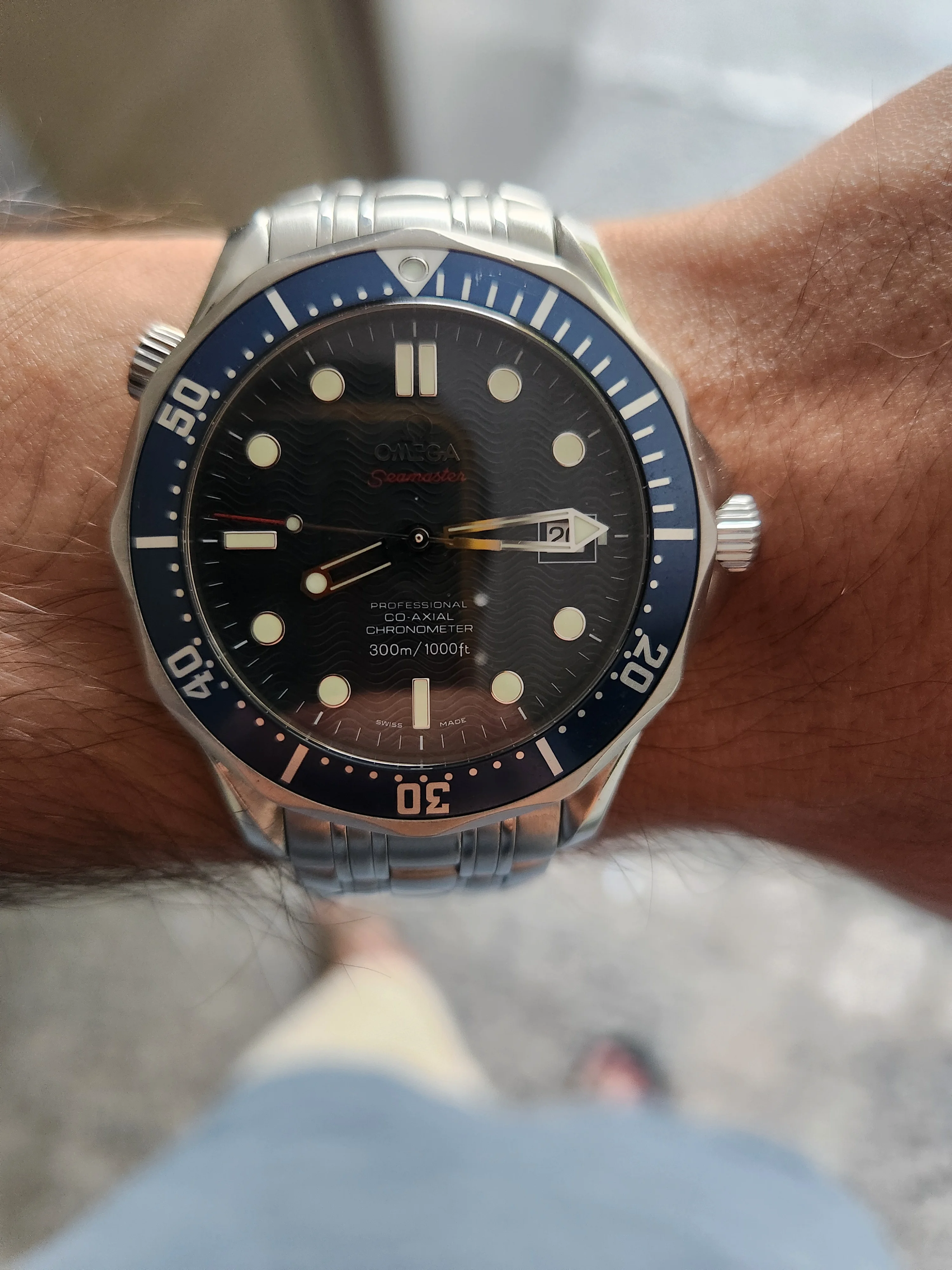

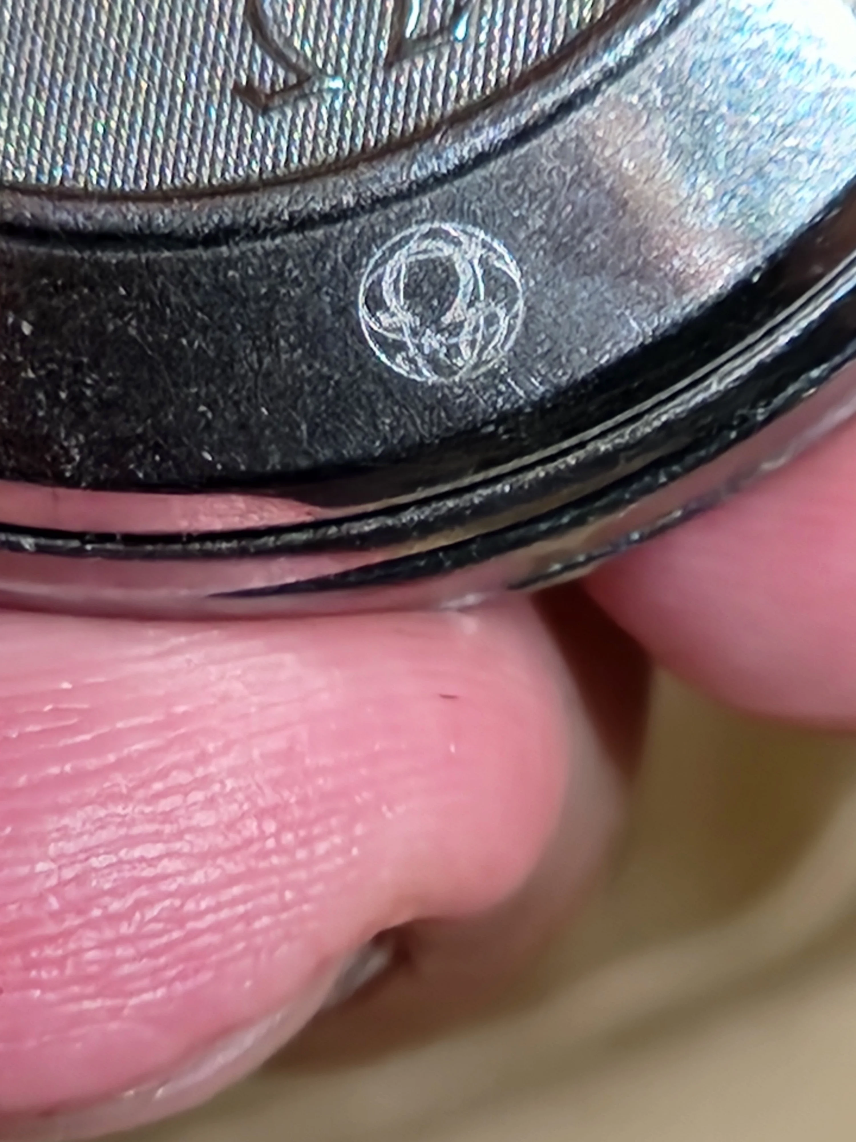

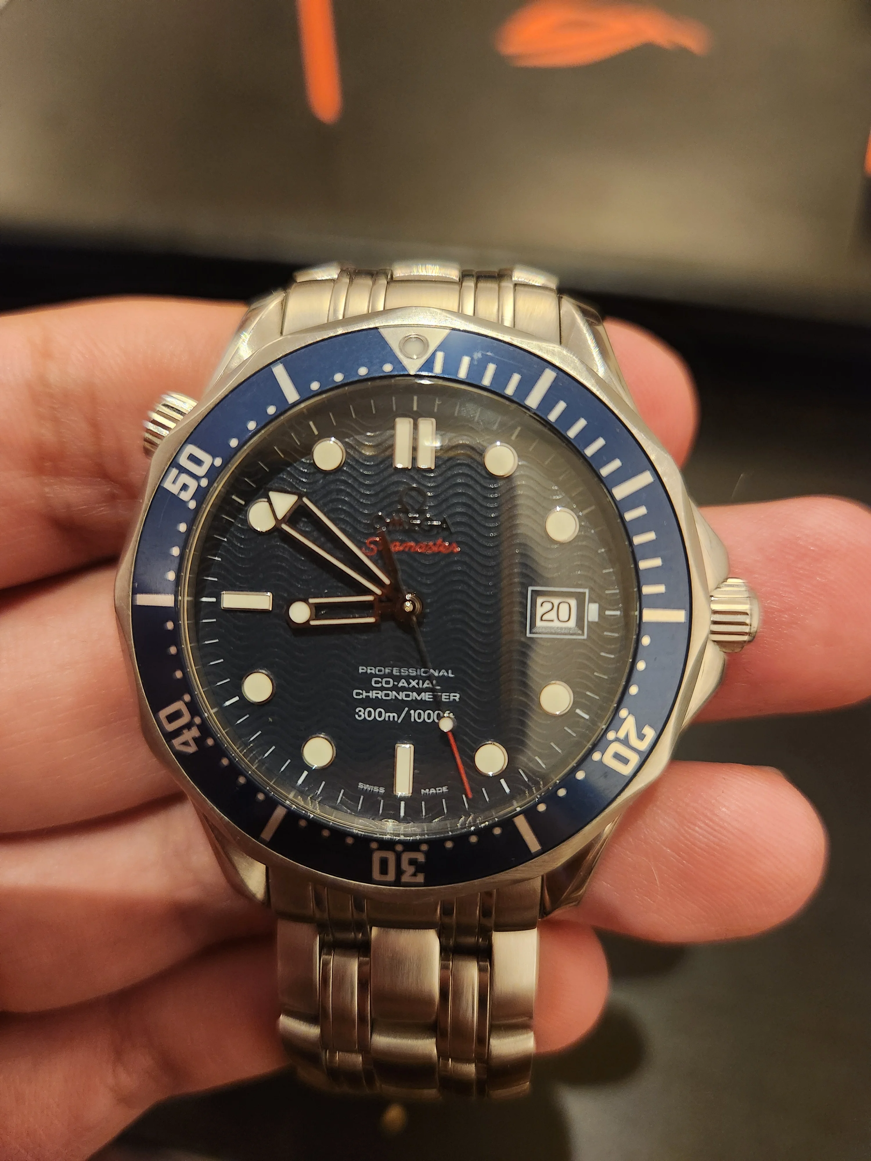

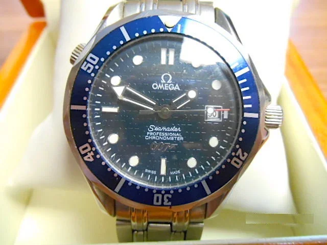

My father recently bought this seamaster 2220.80 and I have doubts if it is real or not, it came with extra links but without box or papers

Can you give a clear (straight on) shot of the front (dial) and the case back?

Looks nice from what I can see. What are your concerns? Almost all of the fakes that we see here were purchased at "too good to be true" prices or from suspect listings with terrible pictures. If he paid a reasonable price through a relatively well-known seller, you probably don't have a lot to worry about

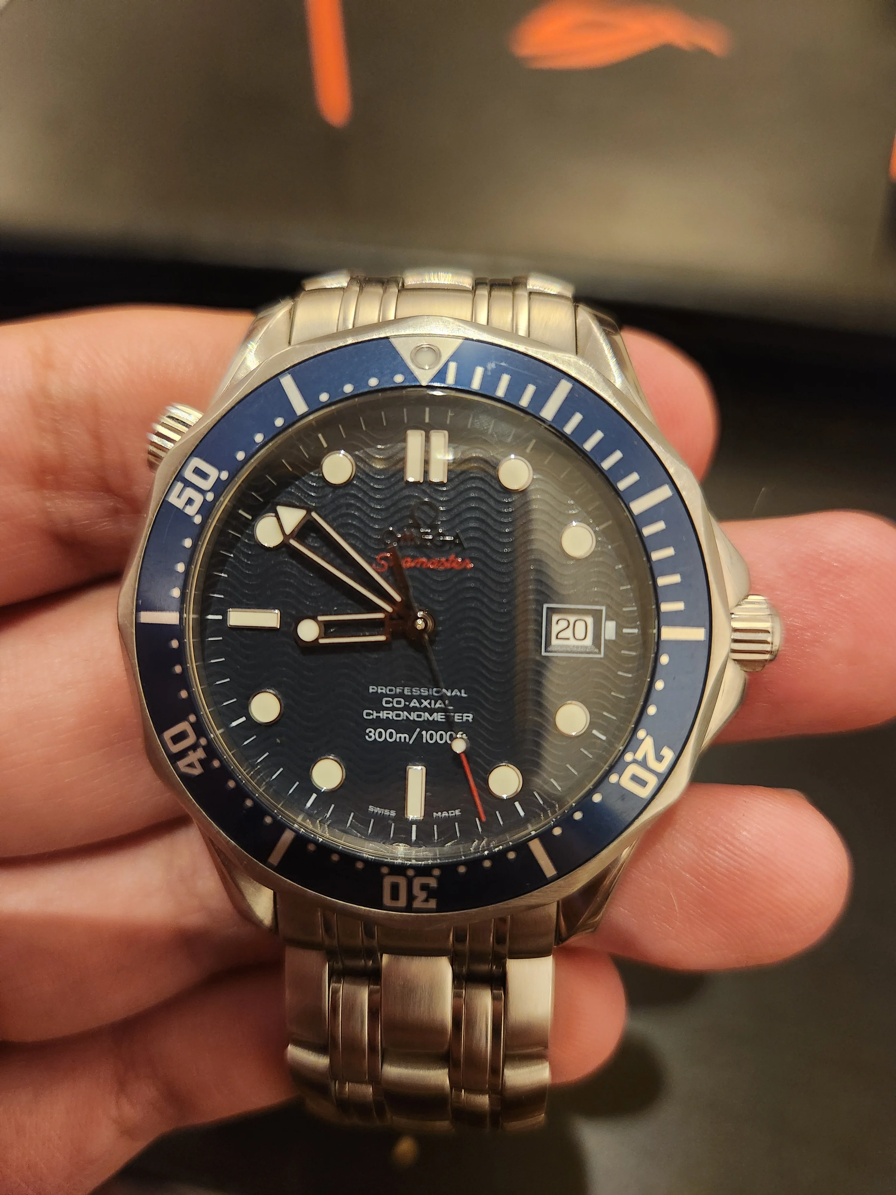

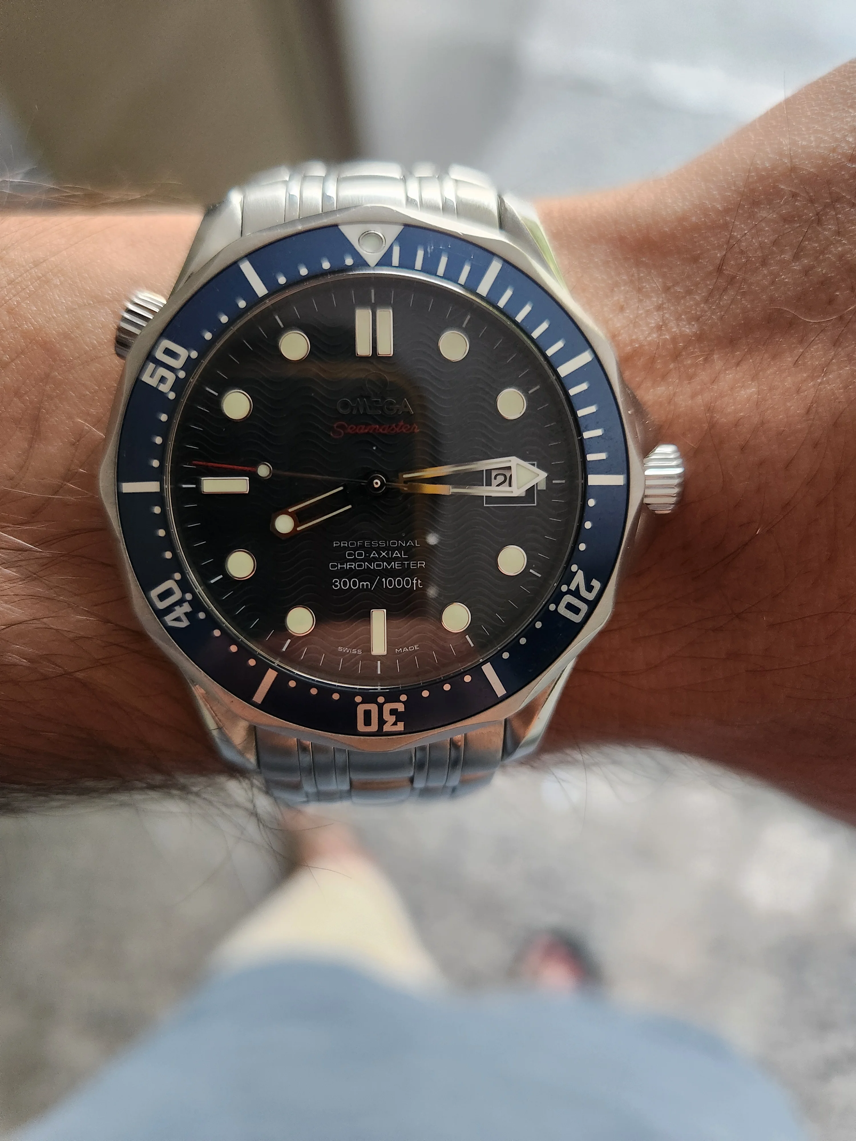

He paid 2.870.000 CLP around 2.840 USD the thing that concerns me is the white leters a the 6, all the pictures that I see on internet the text font is thicker, but in one of my pictures it looks correct so I think that is an effect of the camera and/or angles

I've owned three different 2220.80's and yours looks fine to me. I see nothing suspicious.

I once owned a 2220.80. Nice watch. Yours looks fine to me.

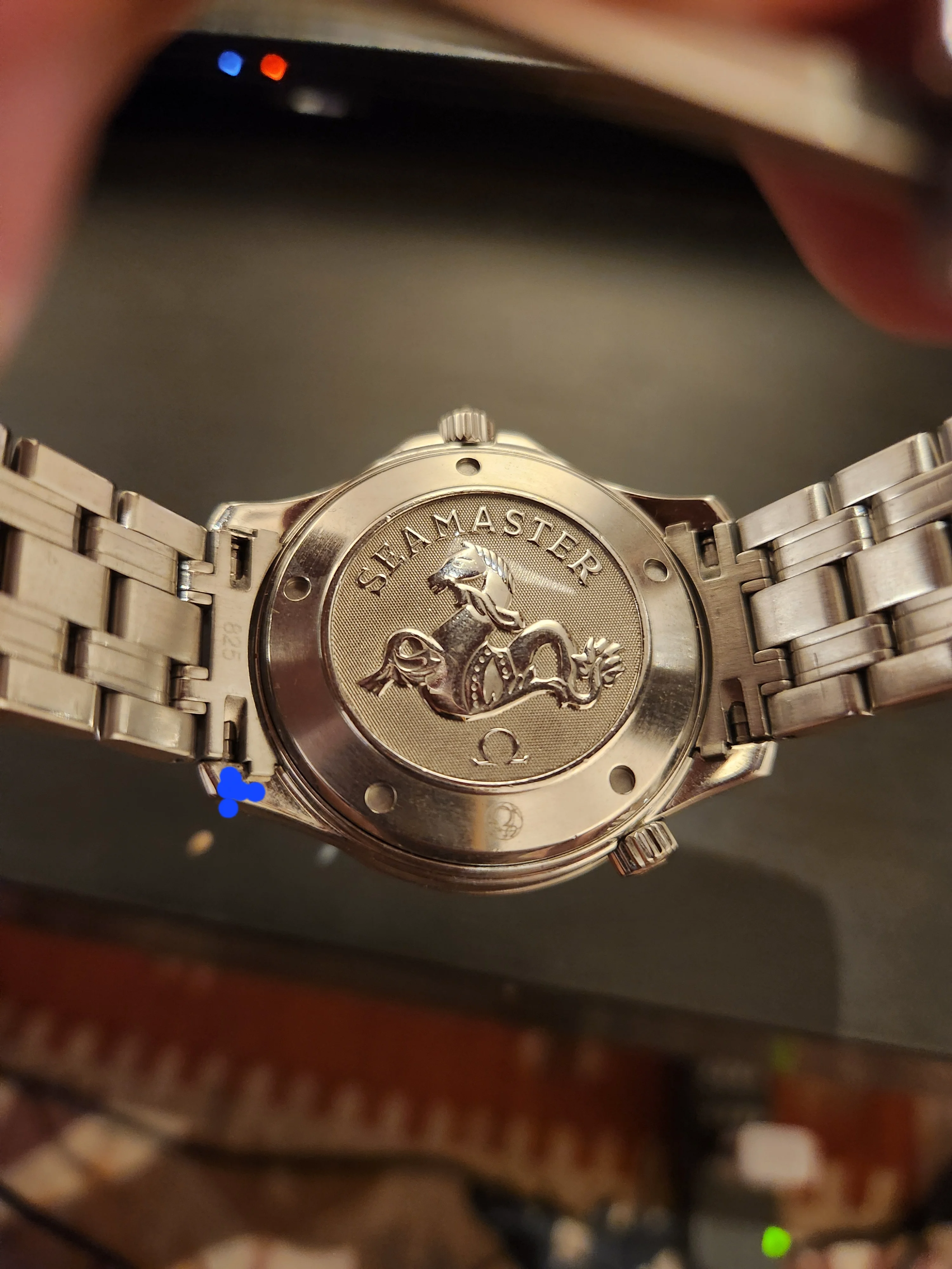

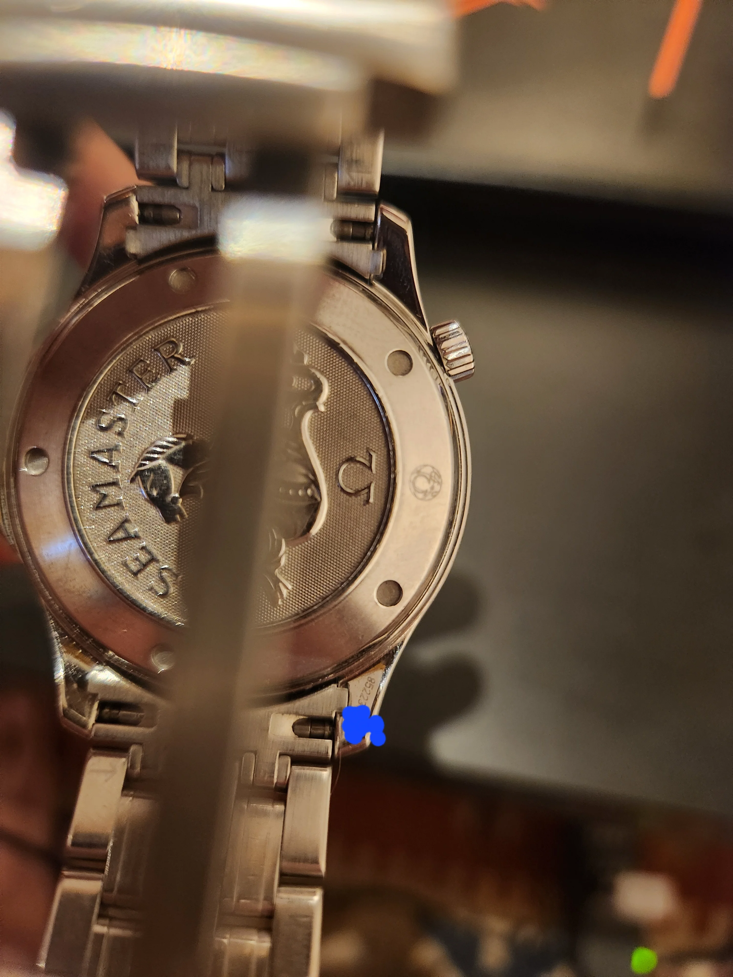

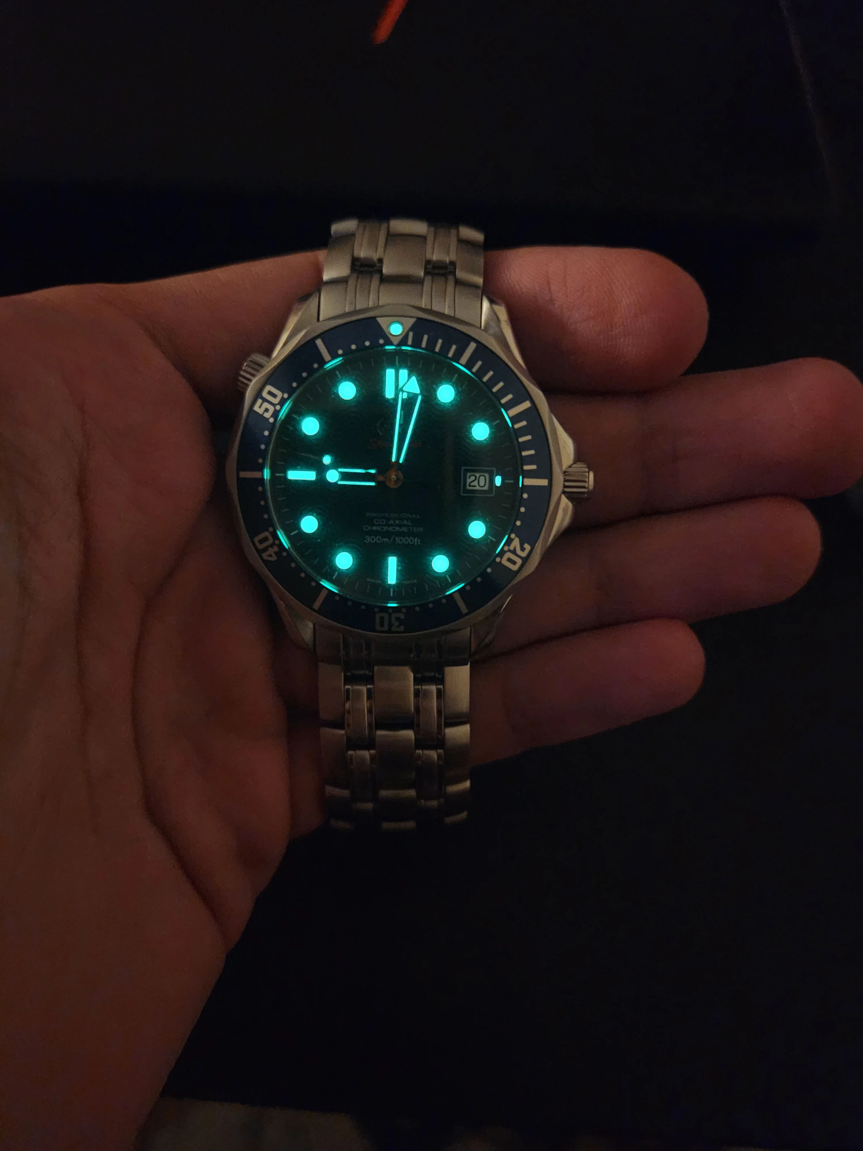

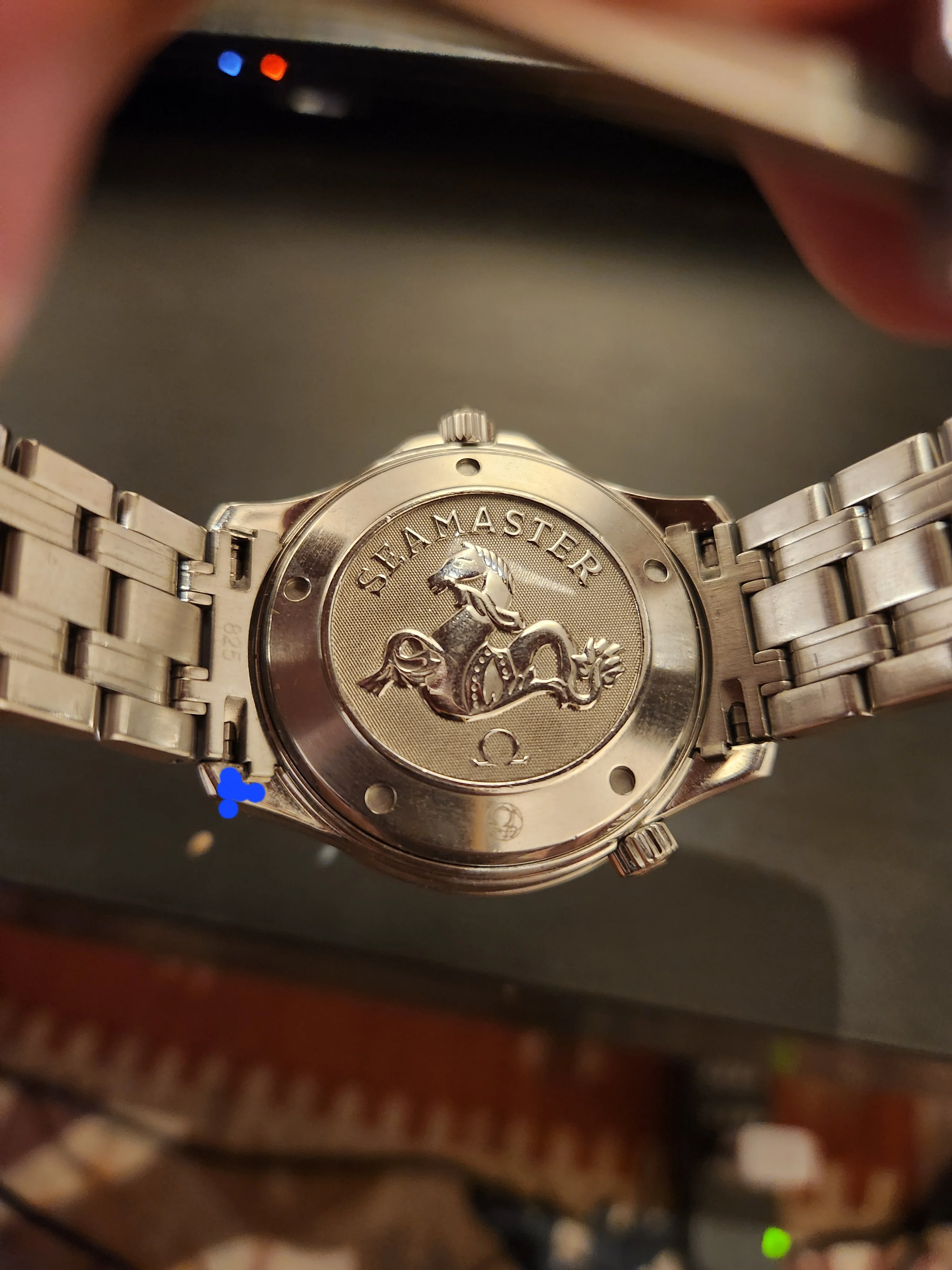

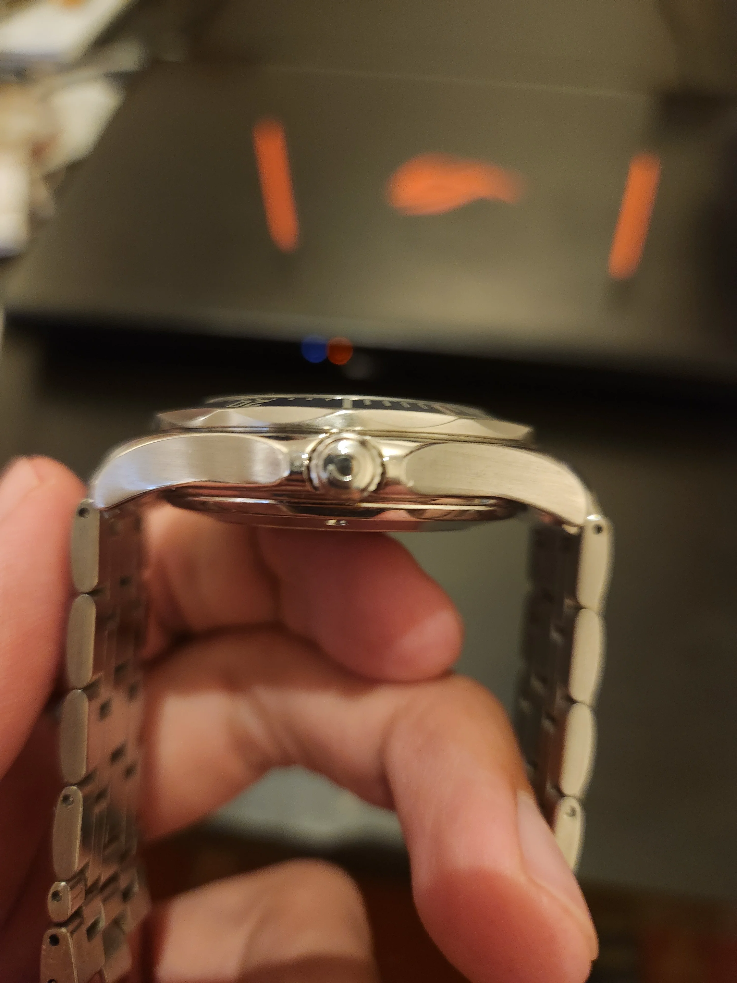

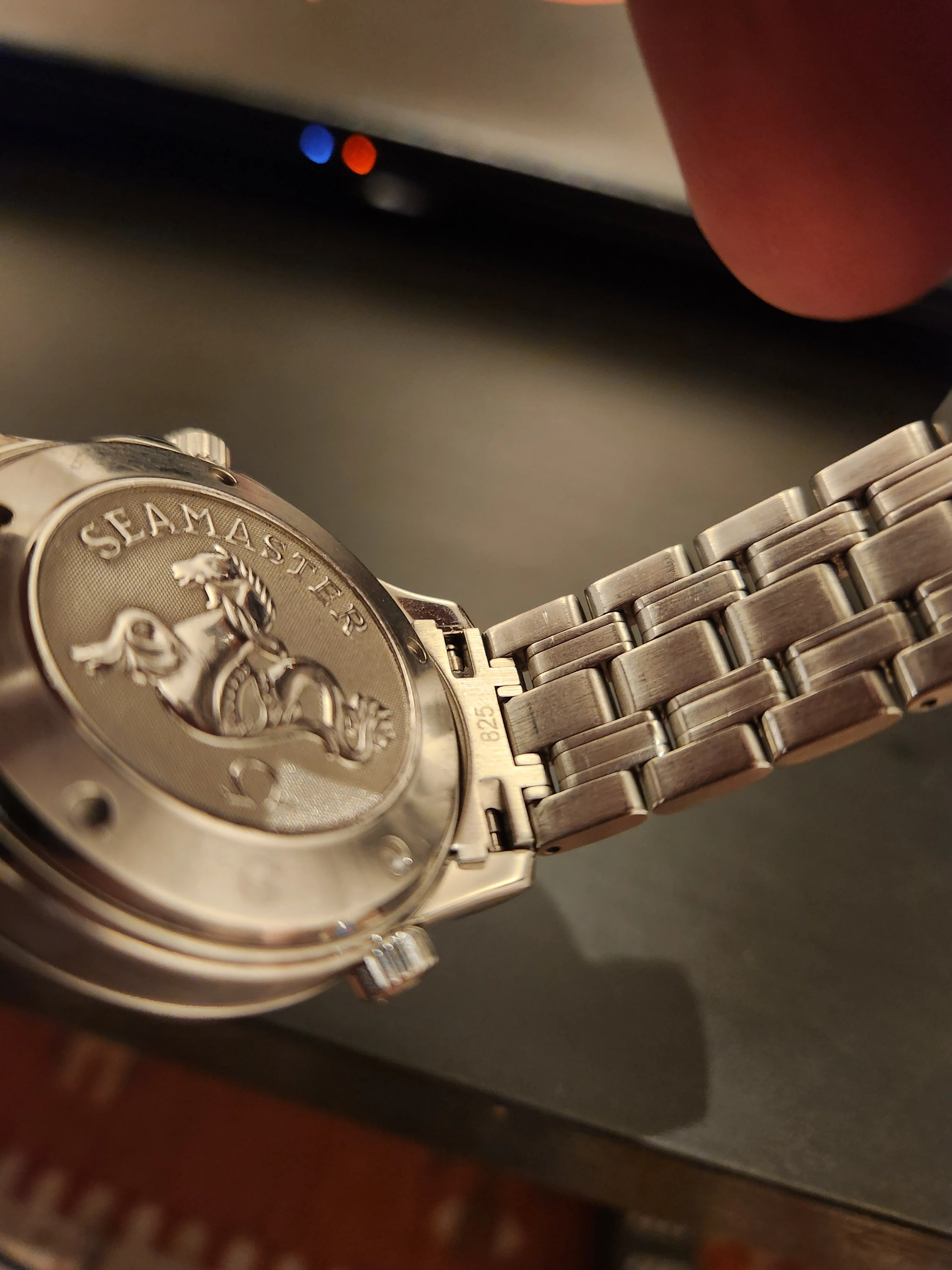

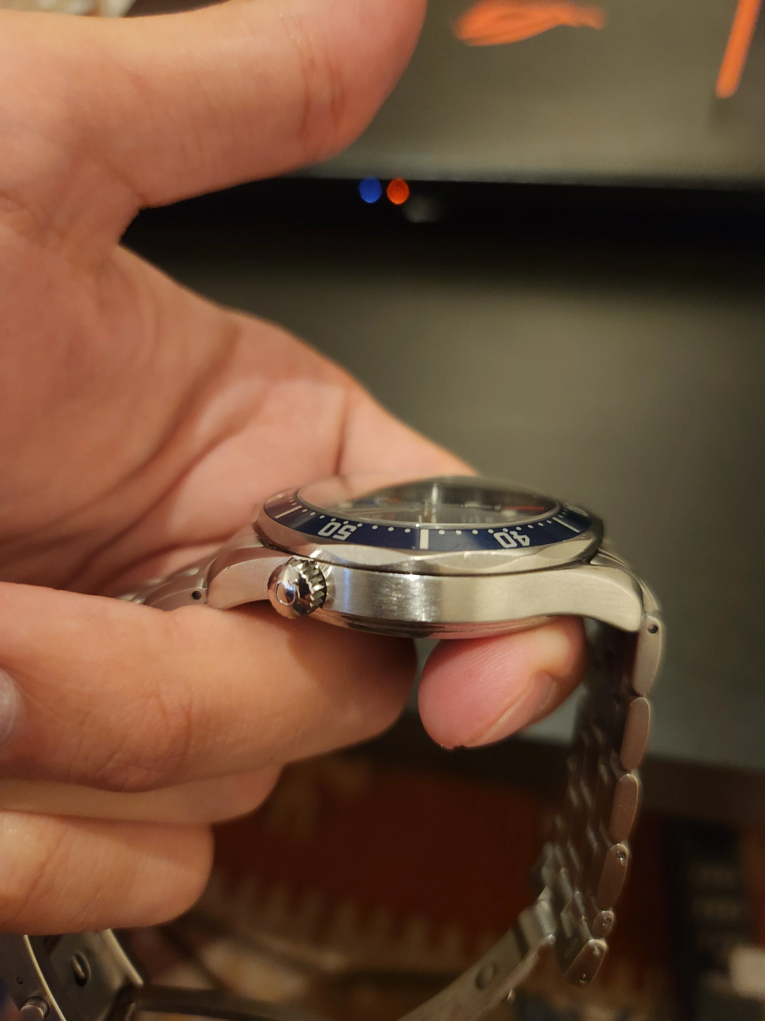

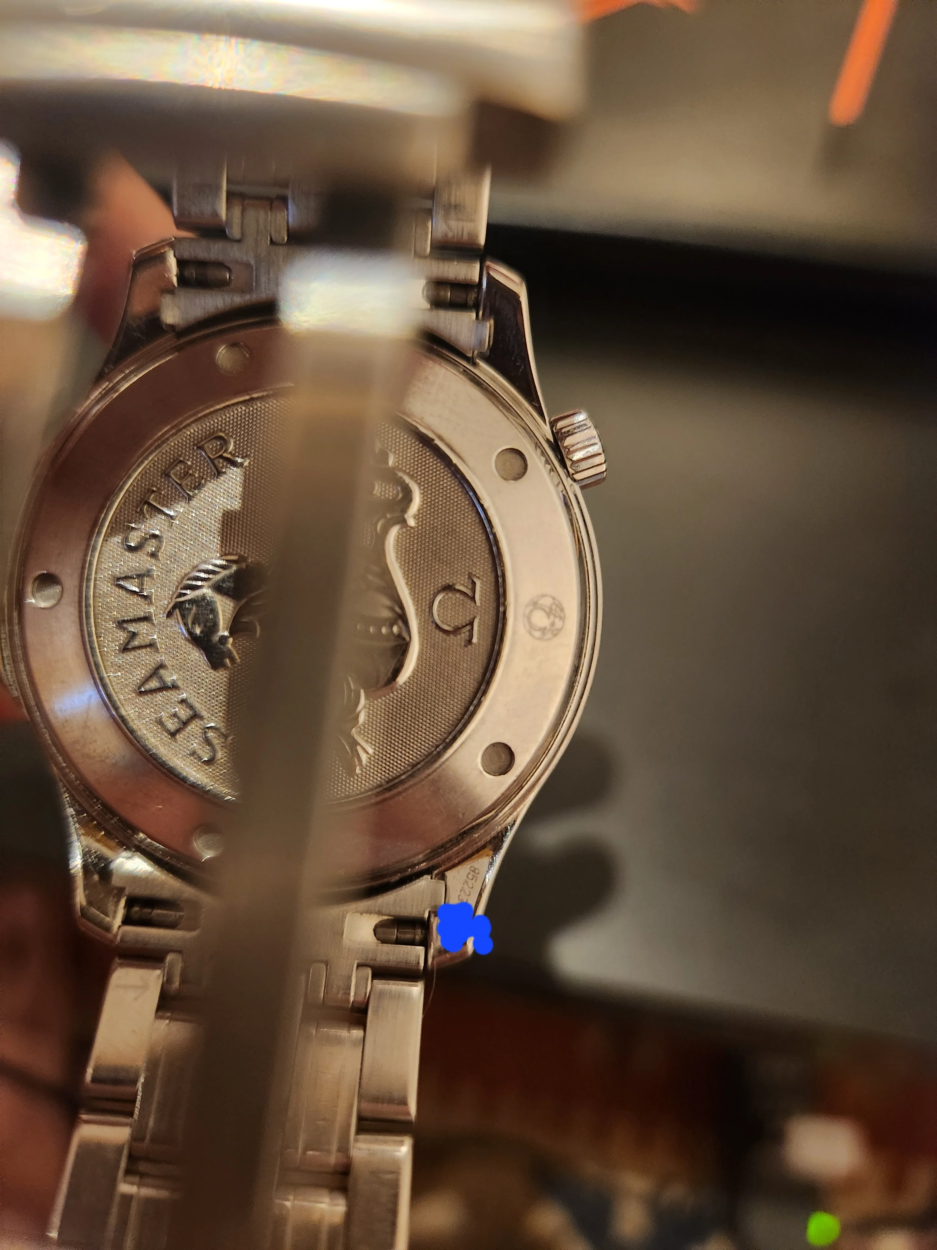

The Lume pip on the bezel and the location of the He valve looks right, and the seahorse always looks sad on fakes.
Picture below is a fake watch and shows the pip and He valve and a certain degree of lack of quality. Picture is from Omega forum and is showing another model of fake, but you get the point I am sure; your watch dont look like this!

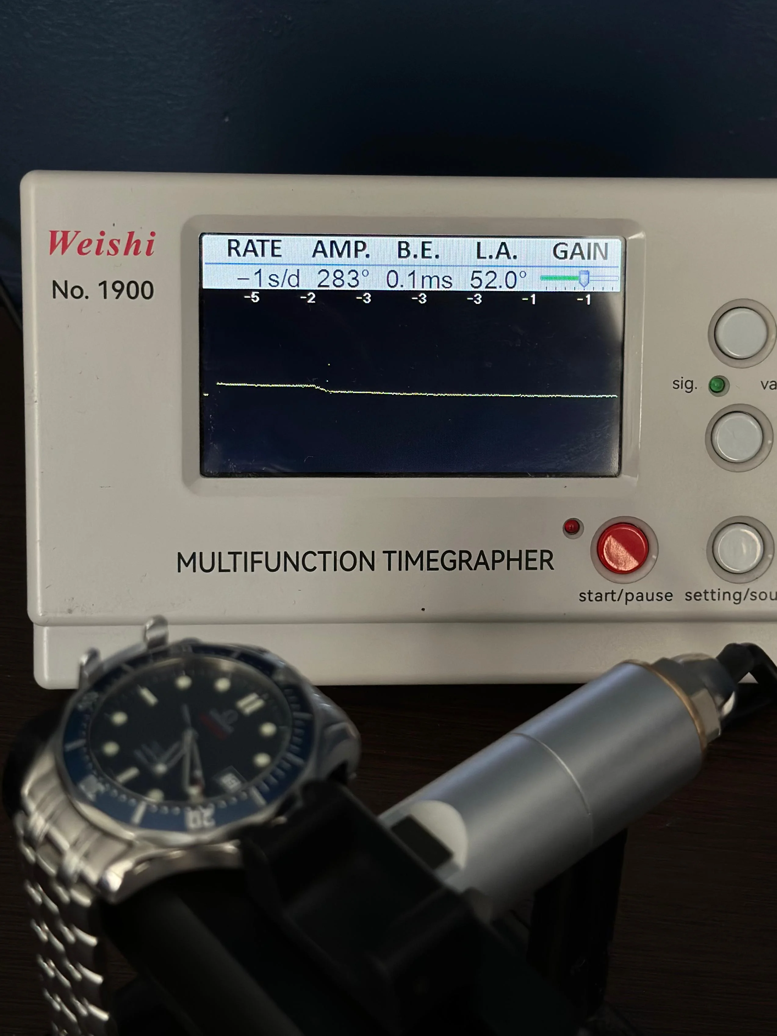

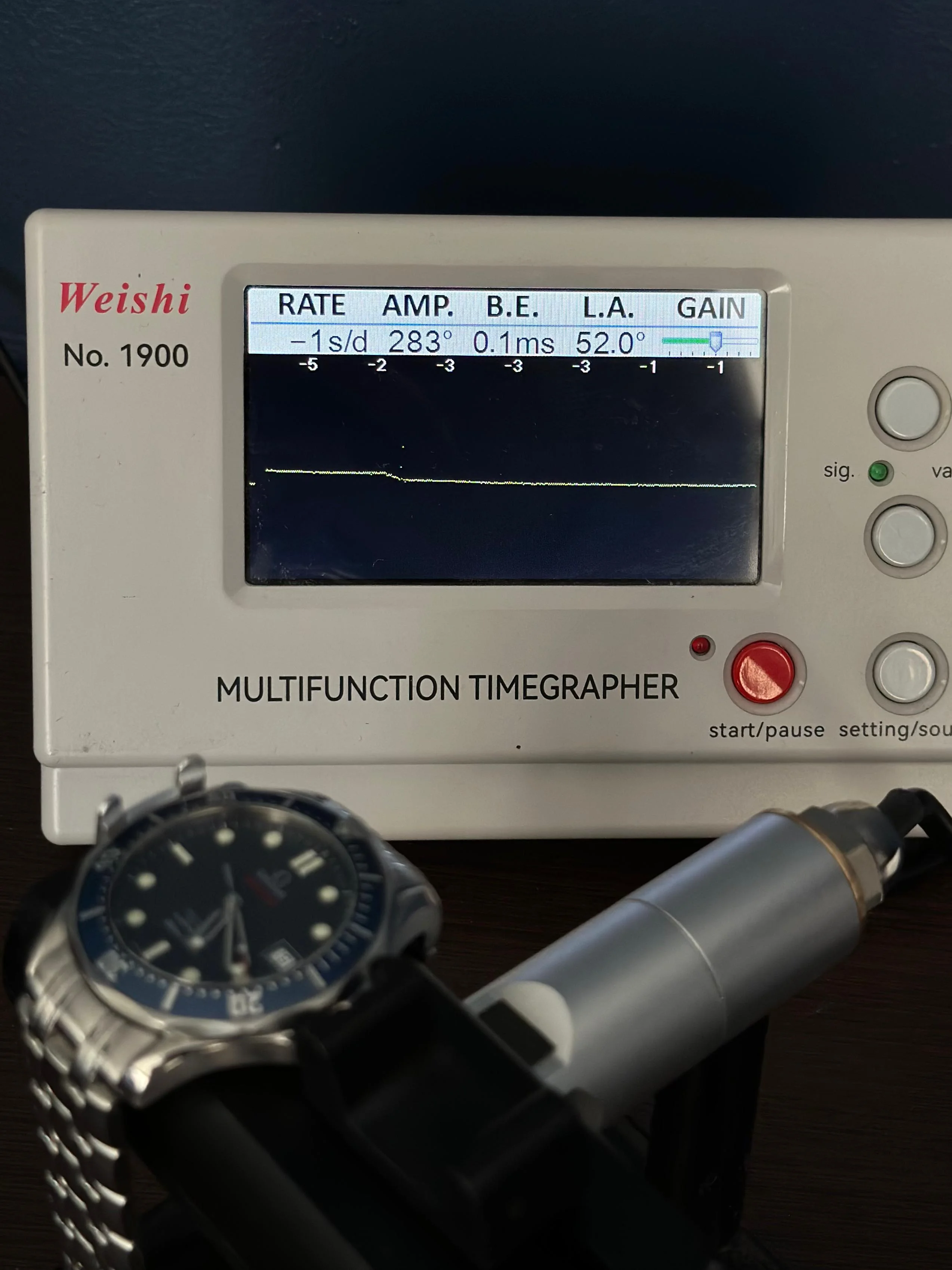

They are all like this. The MADE seems bigger than the SWISS. You can control the reserve if you can't/won't open it. You're suppose to find at least 42 hours. And you certainly will.
4
Good idea thanks
288
433
Looks perfectly legit. Hope your father enjoys his new watch.
