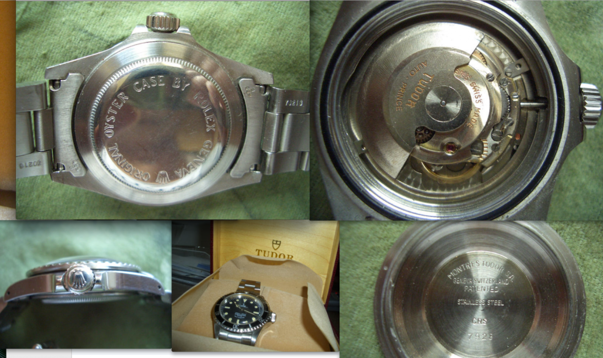

I have another picture from the Ebay Ad with inner caseback, movement, case. Seller claims case was never polished which might be true, who needs to Polish a brand new case..
Needless to say that he didn't reply to my mail pointing out this one might have authenticity issues.
That's a fake 7928. Besides the repainted dial and bezel insert, this watch also has wrong movement, wrong case markings, too thick crown guards, etc.
