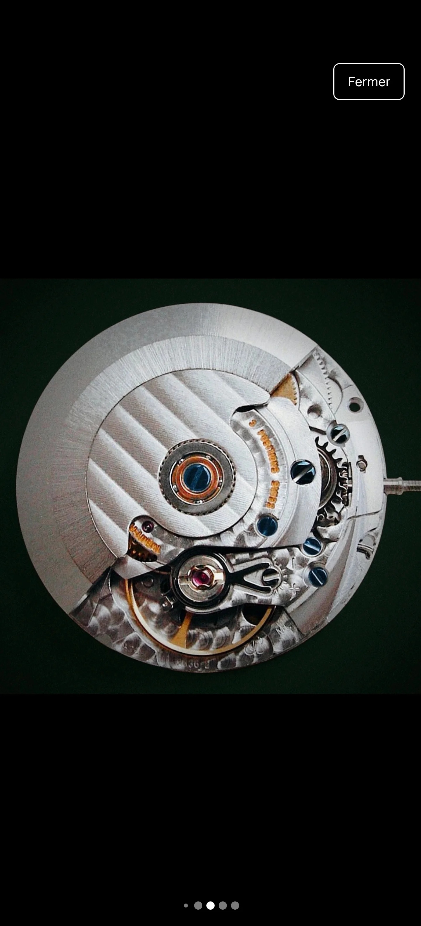

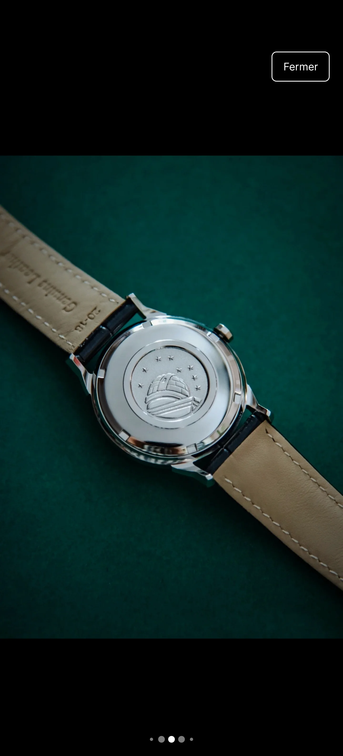

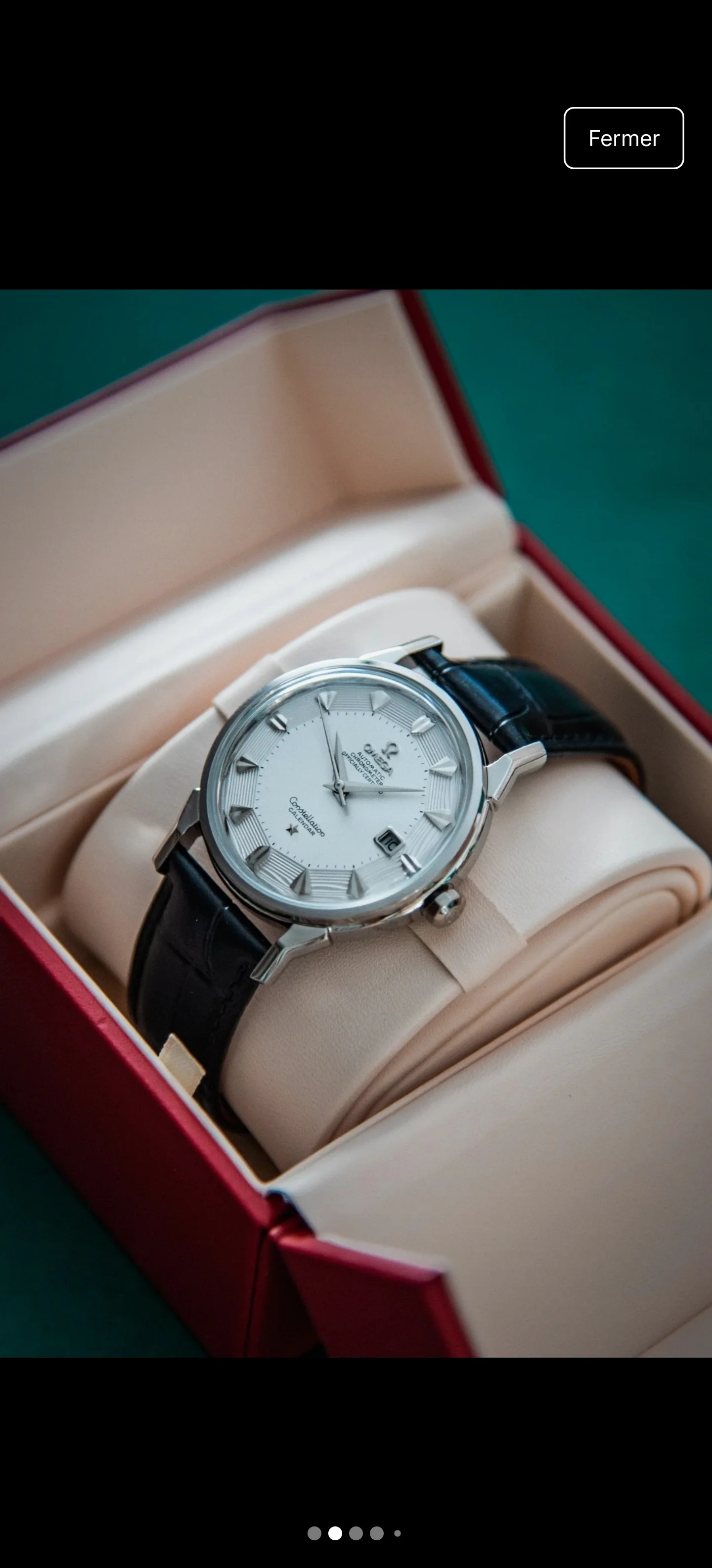

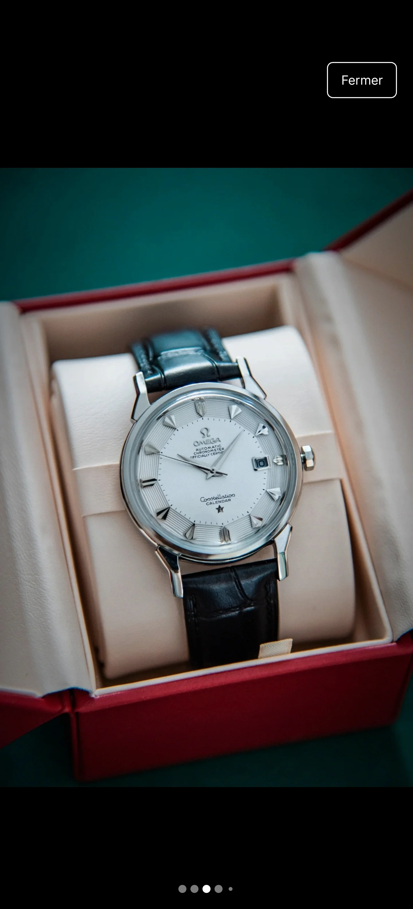

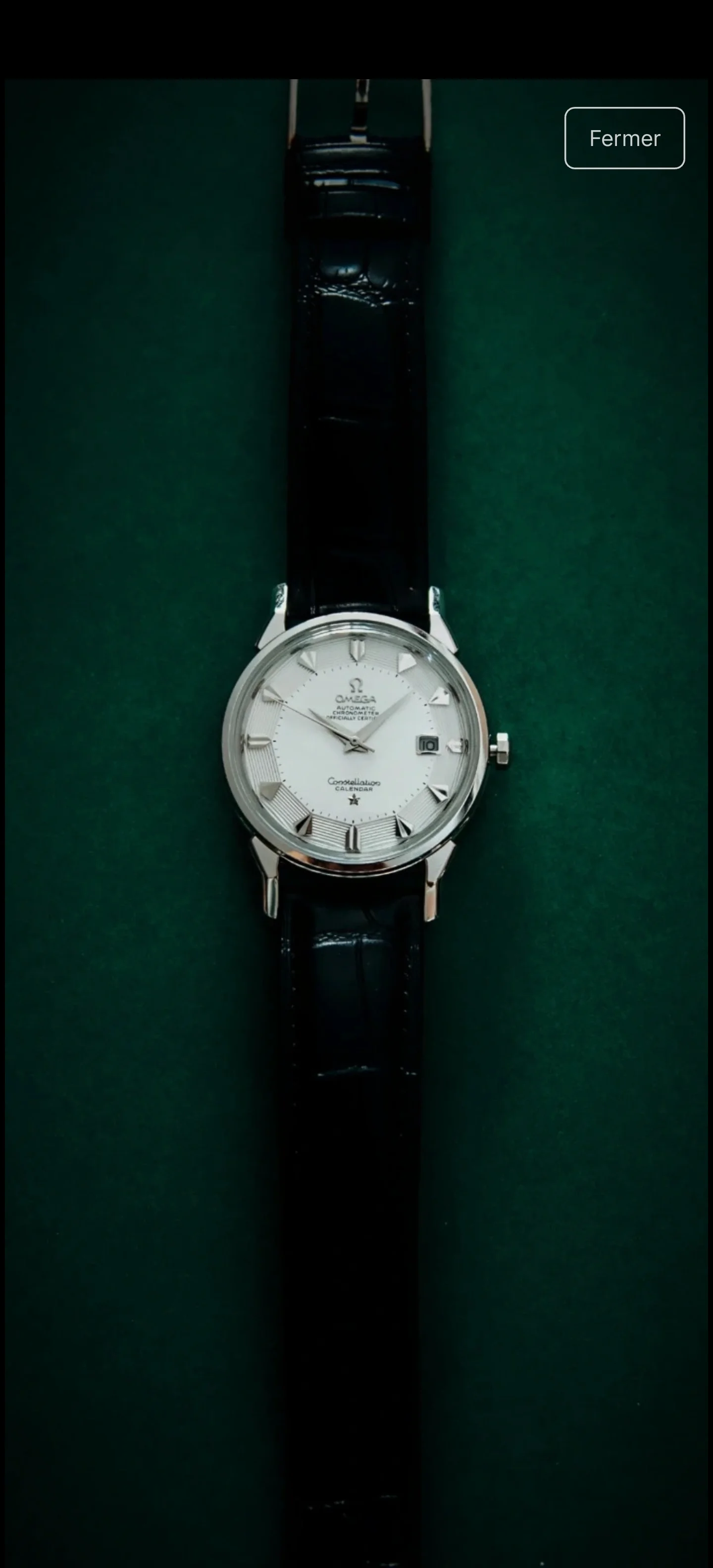

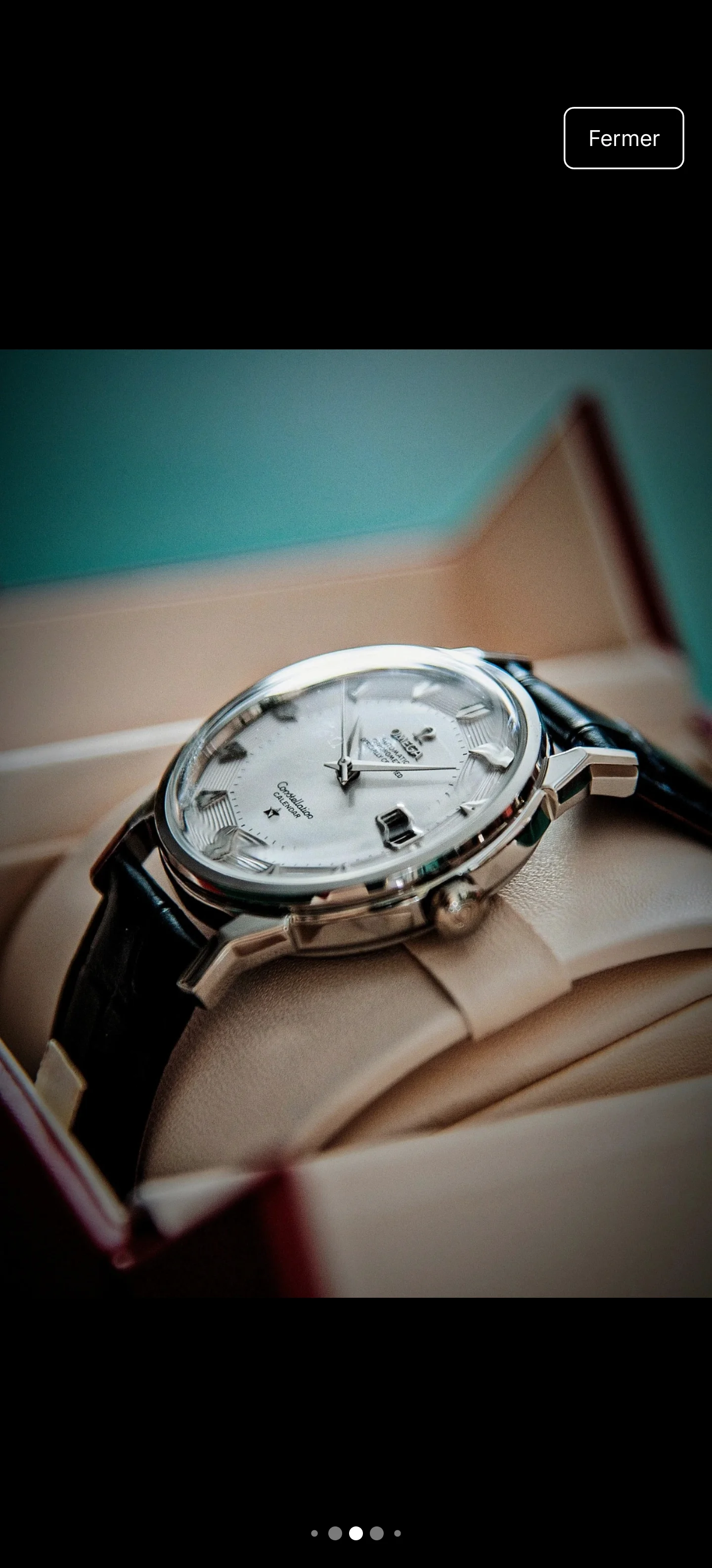

Hi I would like to know if there are some experts here that can give me answers regarding this watch. Which is an omega constellation calendar.
Movement is not the original one. (I know that)
But I would like to know if some experts are spotting any thing strange?
Thanks for your help guys !

Have you ever seen a reference 14902 / 168.005 look like this? Nope.
10,506
16,411

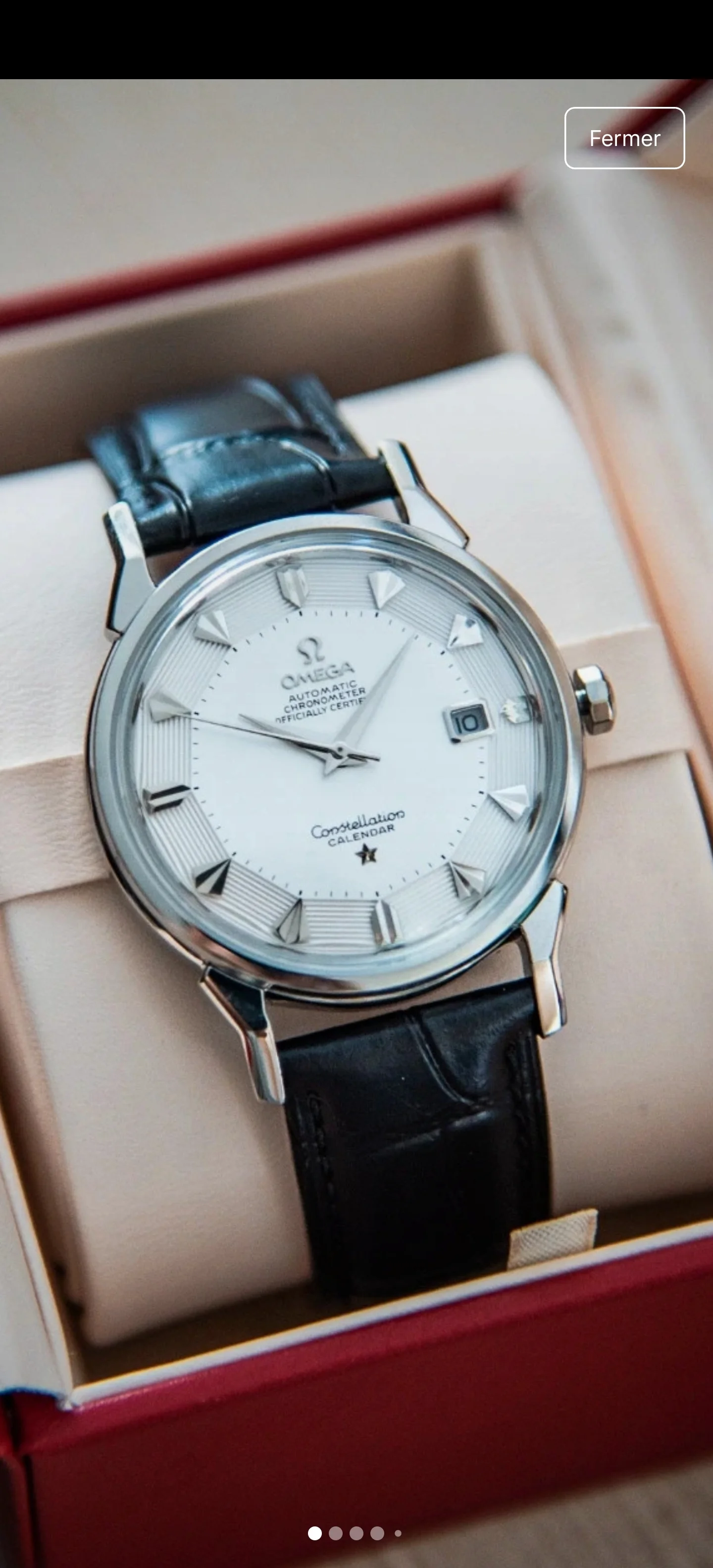

About a dozen things are wrong there, but since you haven’t told us the case number who knows. The first flag is that it has a ETA 2836 movement. An original omega 60s or 70s Connie dial would not work with that movement. Have you got a pic of the inner caseback? You have everything else so if not I would ask why?
It’s an attractive confection and there were some weird dog leg Connie’s sold in Japan in the 1970s but I fear this wasn’t one.
You have to ask yourself:
Can you find another steel cased Connie calendar with the facet ridges like those on the deluxe models seen there?
Can you find a Connie dogleg pre 1980 that uses an ETA movement or is compatible with one?
Can you find another dogleg with such a wide stamped observatory medallion?
It’s a fake from somewhere like Vietnam, but it’s a jolly attractive one. At one point I owned a fake SM300 with the same movement. I wonder if it came from the same Far Eastern source as this.

Show us what is on the inner caseback.

You should start by identifying the reference (that's what the inner caseback would tell you). From there, you would evaluate whether the example you're evaluating matches the known characteristics of that reference.
Unfortunately, what I'm seeing here is all wrong. I have not known any dogleg Constellations to present in the manner you have shown. The non-Omega movement, the dial layout, the caseback medallion, etc. All are incorrect. When you have that many things wrong, it is likely that nothing on this watch is legitimate.

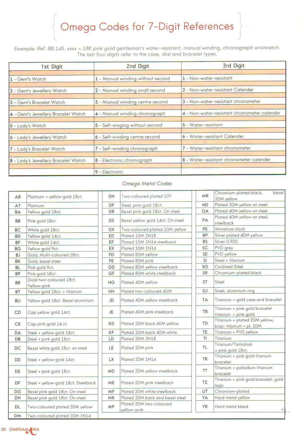

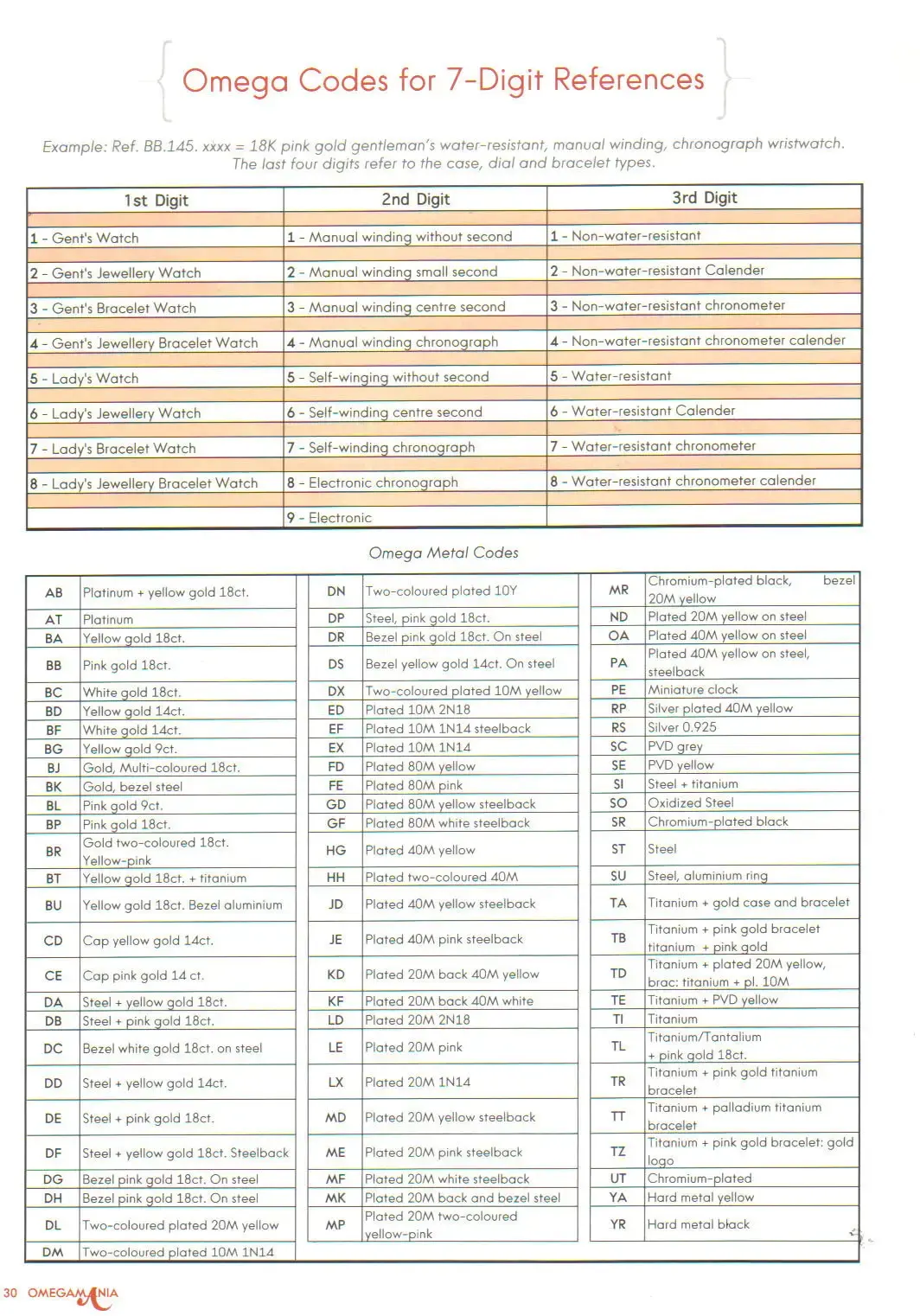

167.005 was specified is there any ressource that can confirm without any doubt that this model (presented like this) actually don't exist?
212
347
A reference 167.005 should have no date.
1: Gent's watch
6: Self-winding centre second
7: Water-resistant chronometre
Well if it was advertised as a 167.005 you should have been concerned off the bat since the 167 prefix denotes a non date equipped watch. You can perhaps use that as a means to enforce a return.

Well it’s not an Omega movement and the case is fake. That should be enough for a refund.

Fake dial
Fake case
Wrong movt.
‘nuff said.
