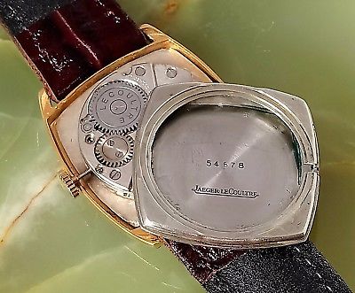

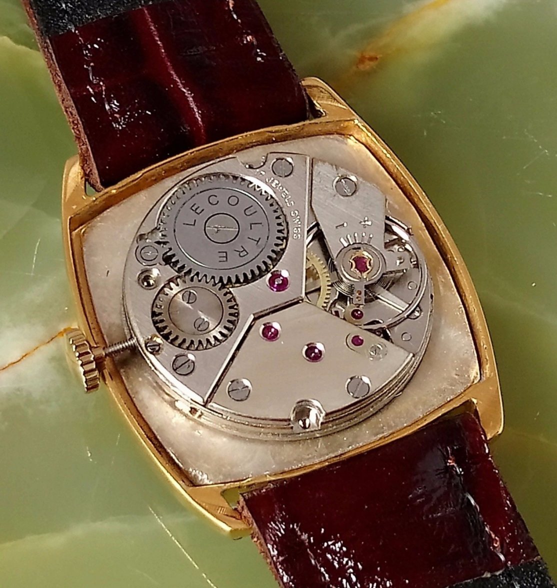

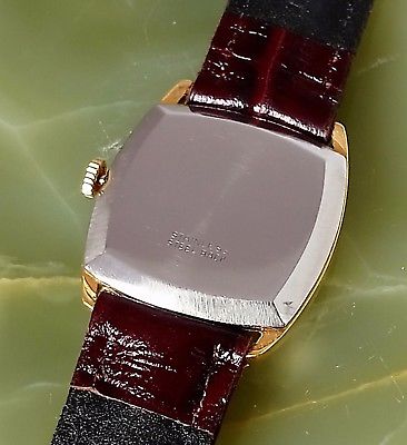

  7. Dan S Nov 18, 2018
    18,814
    43,264
    Sorry, I should have been more clear. As mentioned by @JimInOz and @X350 XJR, the presence of the Peseux movement means that it is not an authentic JLC watch.

  8. X350 XJR Vintage Omega Aficionado Nov 18, 2018
    12,625
    29,931
    Take a quick look at the sellers other offerings, all horrible fakes. As a matter of fact I've reported a number of their offerings over the last several months and the Argentinians simply turn a blind eye.

  12. chipsotoole Nov 19, 2018
    1,061
    1,924
    JLC only ever outsourced movements at one point in their history with some of the JLC club models in the late 60's early 70's. I got caught out by this a while back and was lucky to get out of it financially unscathed. I'd say this was an older and on the face of it a slightly more convincing fake from the 70's.... until you pop the back open...With the exception mentioned you'll always see a top notch quality movement with beveled movement edges and hopefully (still) polished screw heads..
