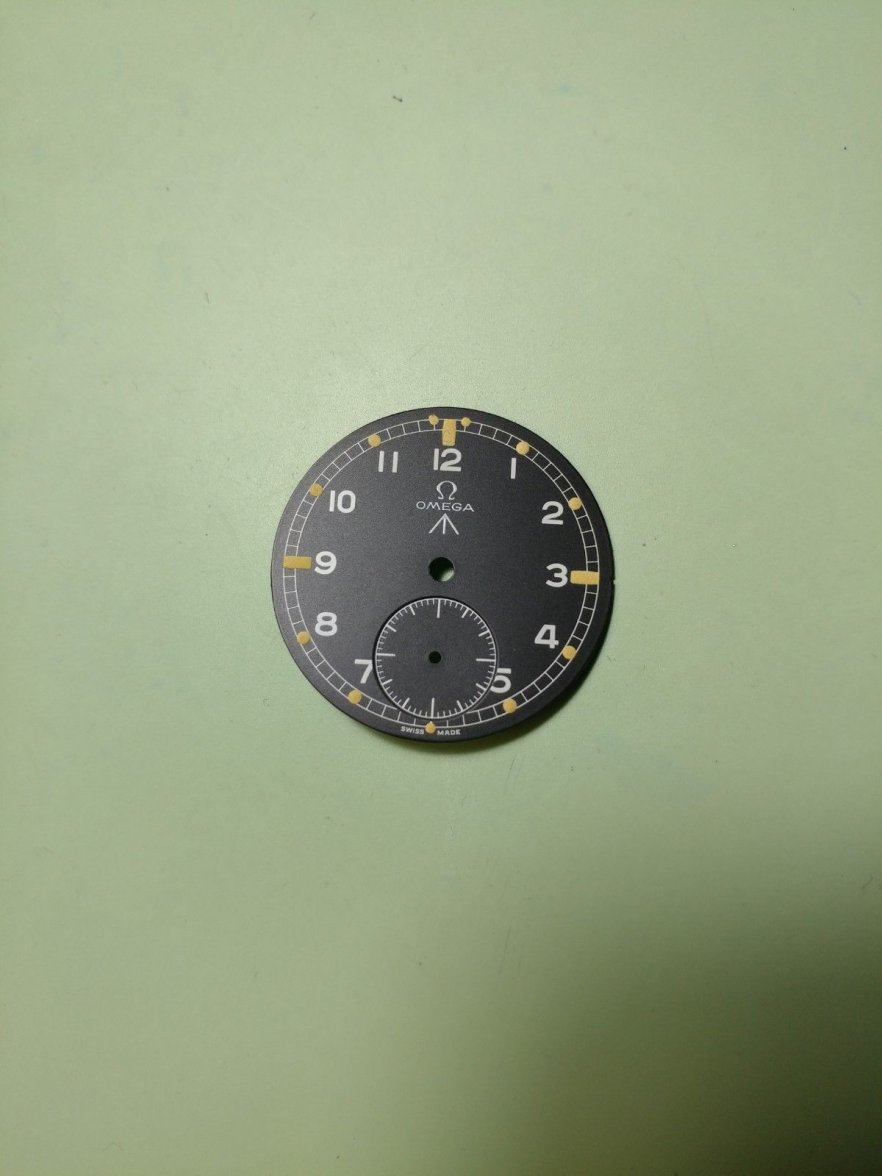

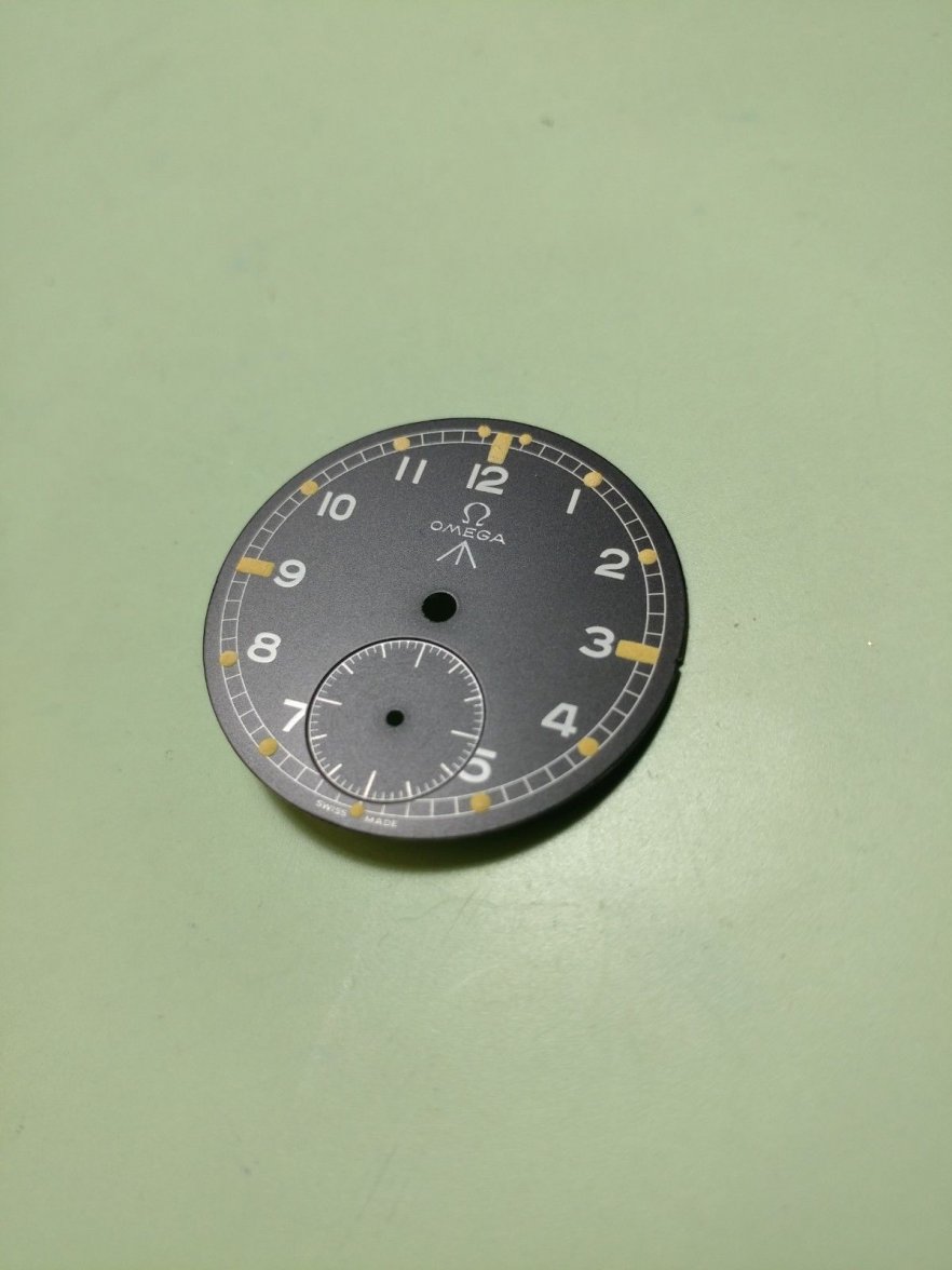

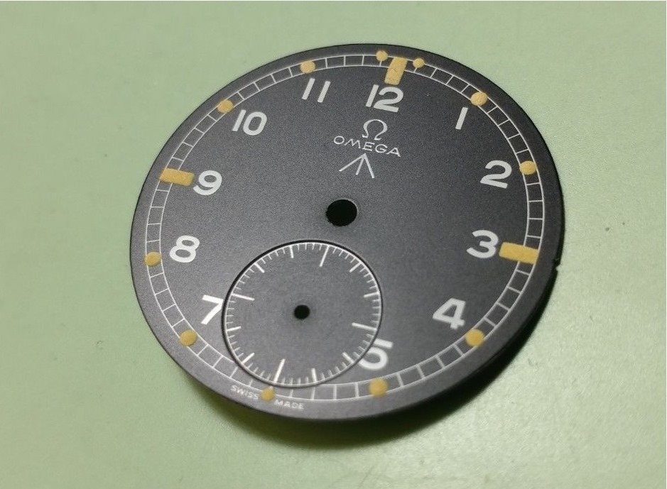

    Dear Respectable Members
    Would be most grateful if you could weigh in on the images below of a 30T2 dial - whether it is factory original or just a very good redial?
    Many thanks

    Color me skeptical of it being original. If it is a redial, that is some immaculate work.

    So good to hear from you. Yes it's been a while! Agree with you... if it is a redial...then definitely excellent work!

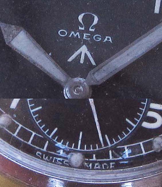

    Don´t know if that helps?
    The positioning of "SWISS MADE" differs and the arrow is thicker.
    rgds - h.u.

    It does help a lot...thank you! Also noticed the "A" in OMEGA should have a flatter top.

    Seems to me like a lot of redials change flat top A's to pointy top A's - but this dial certainly looks very nice, as opposed to the bad ones that get the A's wrong.

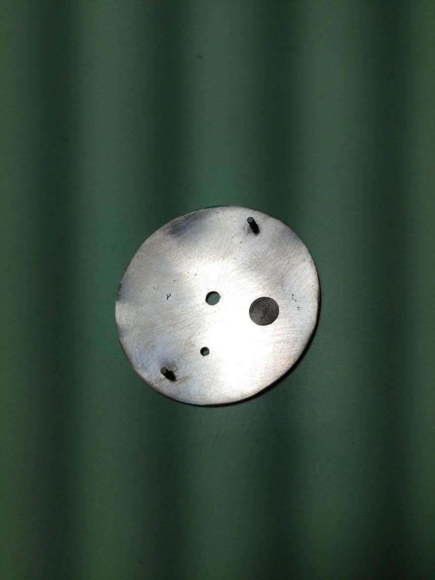

    The remnants of black paint on the back of the dial (at 12 o'clock) indicate that the dial was repainted. Excellent redial!
