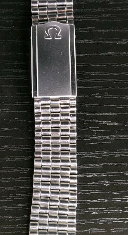

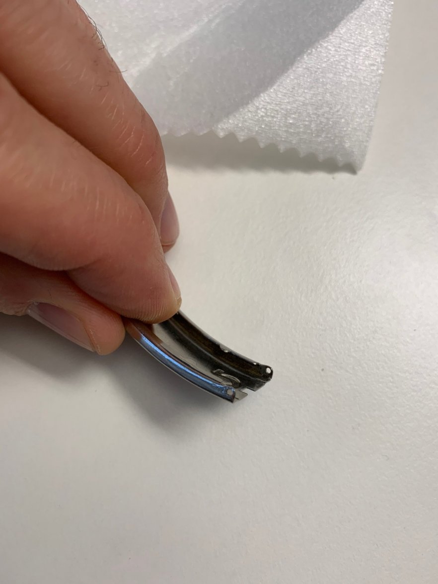

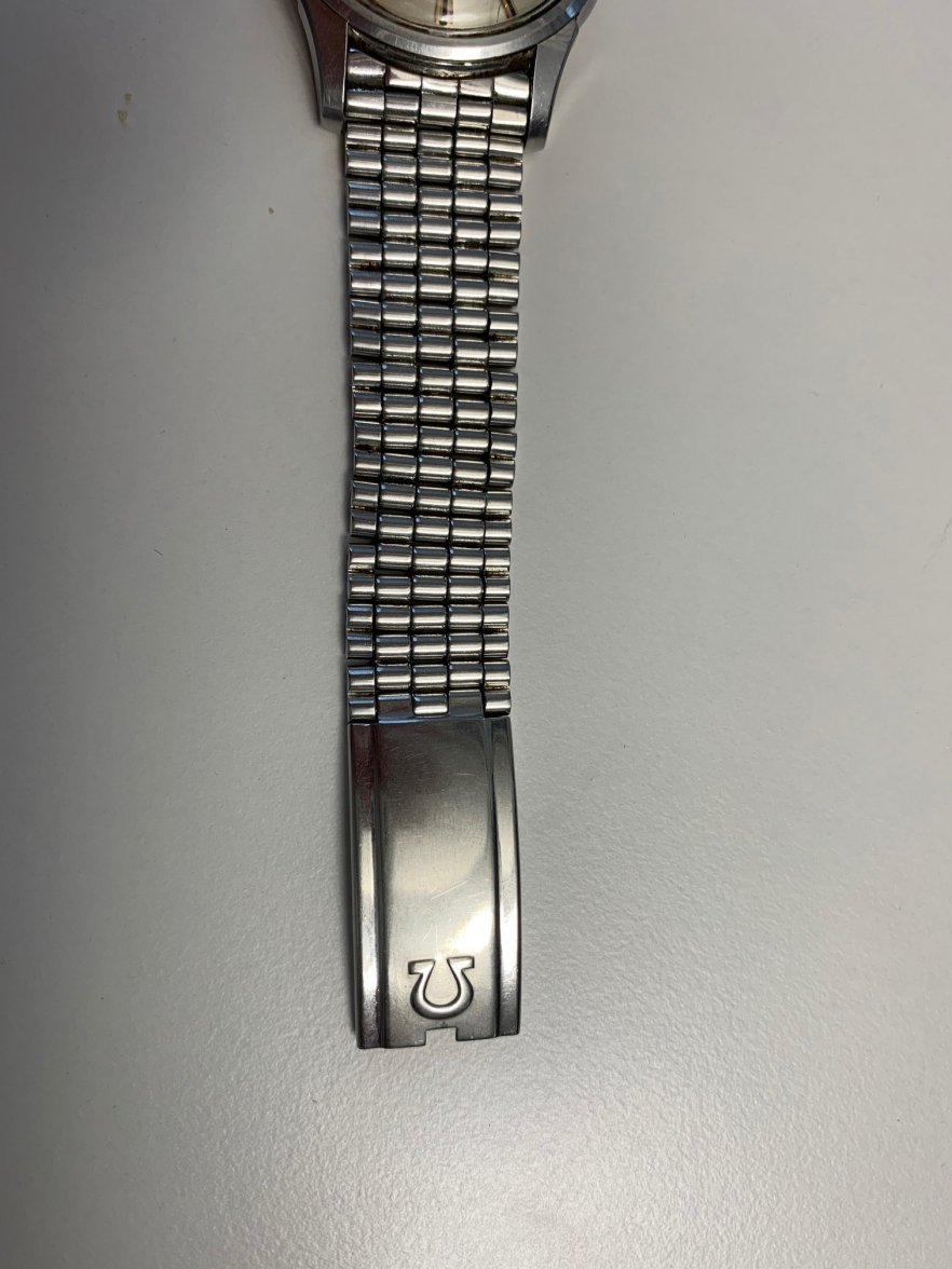

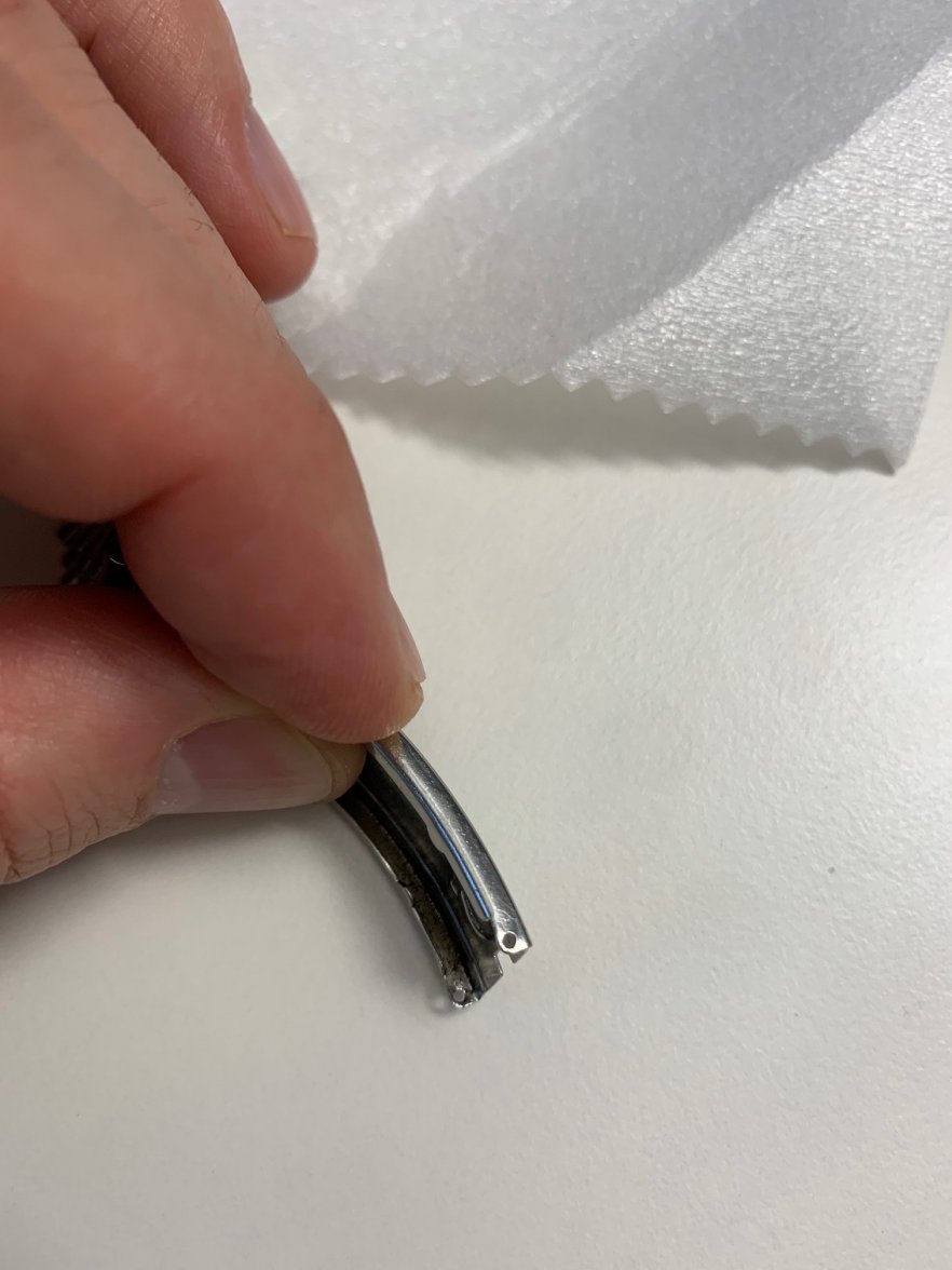

Hello,
I recently received an Omega 14393 with parts of a period bracelet still attached. Only one part of the clasp was still present. The other one with the bracelet number was missing. From the looks I'd say it's a 8260 bracelet. However, the clasp with the Omega logo has a strange cut-off end. The second photo with a black background is a reference photo of a complete 8260 bracelet.
Is this a variation of the 8260, a different bracelet or was it cut off (the edges don't look straight and smooth)?

Can you take some more pictures of the actual clasp and where the notch is, with some from the back also. Does it look like a home made job?
625
1,000
It is possible that someone has cobbled together the bracelet with an incorrect clasp, possibly the reason why it has fallen appart. Keep an eye on the for sale section here/ebay and a correct bracelet/bracelet parts should come up. This being said, the clasp does fit very snug with the bracelet, which makes me doubt that it was swapped.

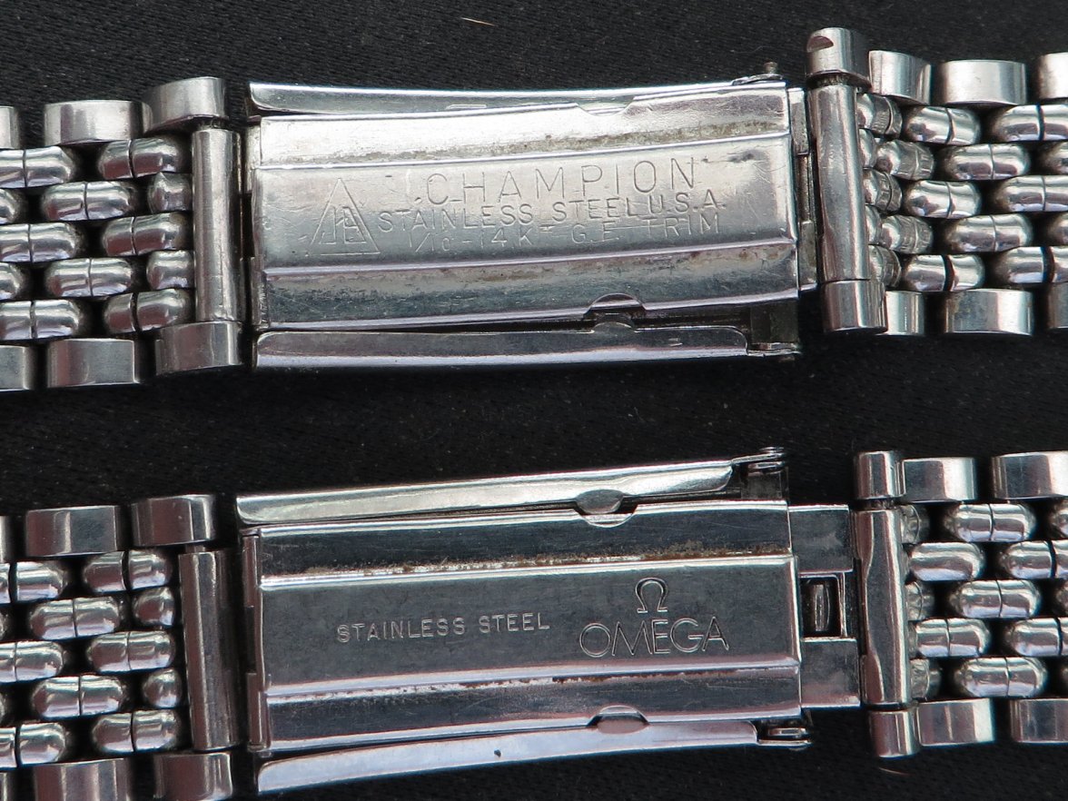

I think I found the answer with the help of an eBay seller (who may very well be a member here). It's a 8220, but with an adjustable clasp like this one here (on a 5 row BOR):
https://omegaforums.net/threads/ome...re-adjustable-clasp-wet-suit-extension.90516/
But one question though: why did the thread above say 'wet suit extension' in the title? Was this adjustable clasp only used for special purposes?
I was being facetious, that was how the seller had described the bracelet. No, it's not a wet-suit extension.
13,493
31,814
This type of clasp is most commonly associated with the 5-row BOR.

Do you think that the clasp from a 5-row BOR was added to the 8260? The side of the clasp on my bracelet towards the bracelet has a different shape than the ones in your photo for the BOR bracelet. It looks as if mine was really made for the 8260. Or am I wrong?

I might have inadvertently confused you.
Omega bracelets are mostly made by contractors and many in the country in which the watch is sold.
Jacoby Bender was a huge bracelet and strap manufacturer in the US. This is why I suggest your lug size might be 11/16" instead of 18mm.
These are genuine Omega bracelets, just not made in Switzerland. Aside from the end links, they are utterly interchangeable.
Your bracelet shows signs that it was made by Jacoby Bender. Whether you can find pieces to put it together, I don't know. A worthy endeavour but it might take years.
