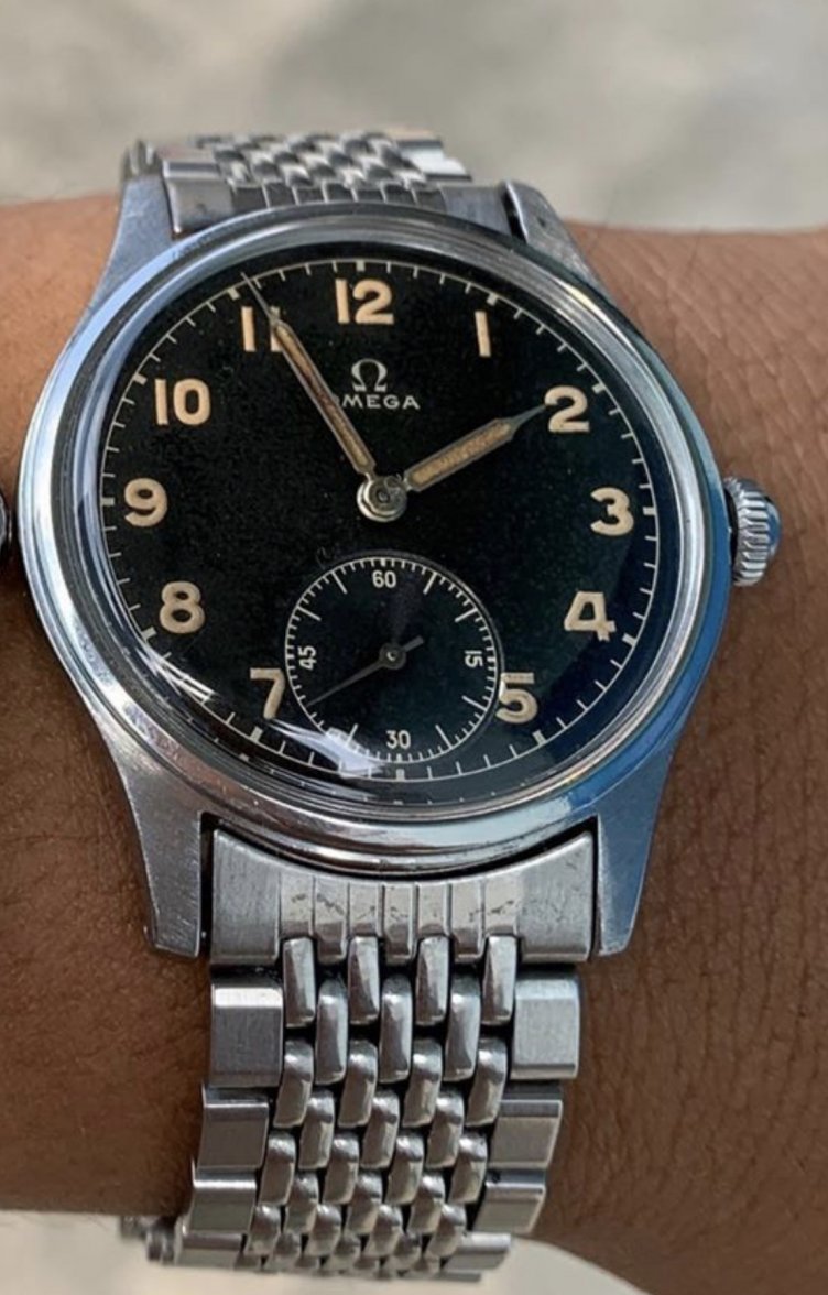

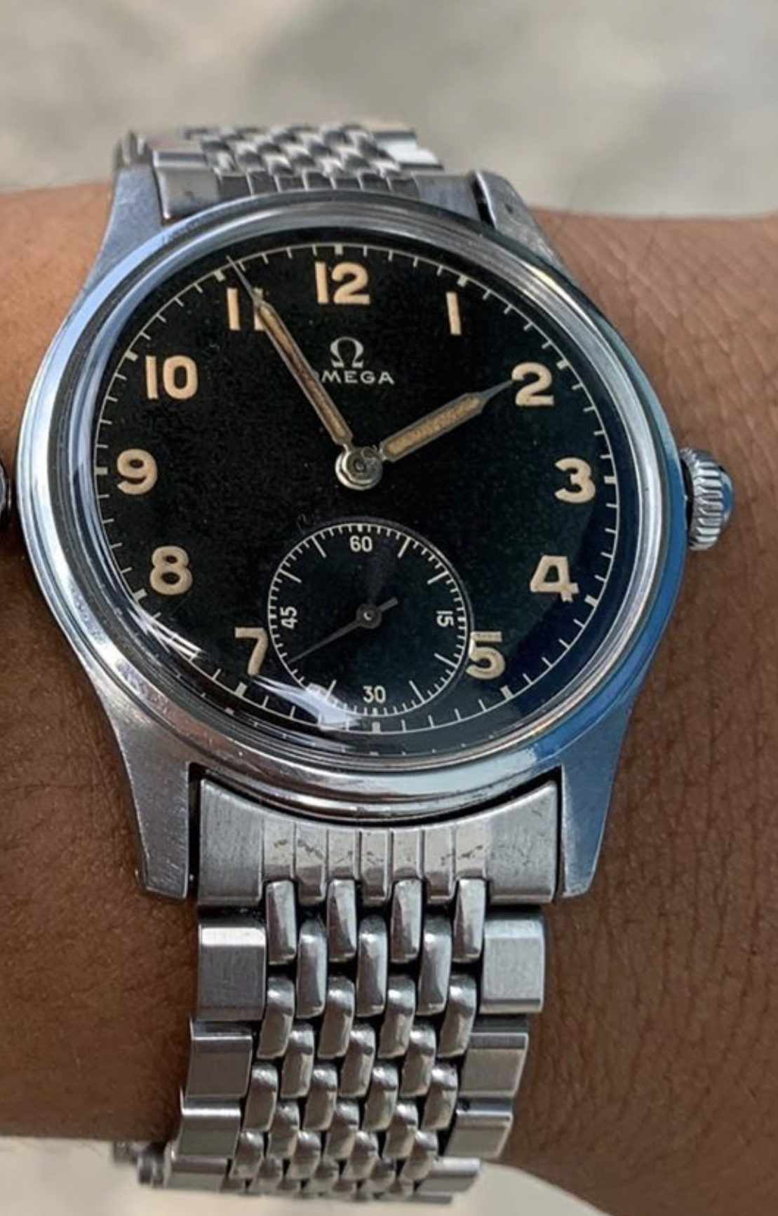

Hi all,
I found this Omega Suverän with BoR bracelet on the web. I think it looks nice with the bracelet and i would like to find a similar bracelet for mine also. I know watches from the 40 never came with BoR bracelets originally. My issue is that i dont have a clue on what ref and number on end pieces is going to fit because of this. What should i search for? Anyone that has any knowledge and advice on the matter? (Picture is borrowed from other social media)

1503. 70.
This is correct, however, the 1503/70 is a 9 row BOR, not suited to this model aulthough is the bracelet pictured.
The more stylistically correct 7 row BOR are the following models: 1502, 8220 and 1036, and mix and match with the following end links: 11, 12, 14, 514, 511 or 512

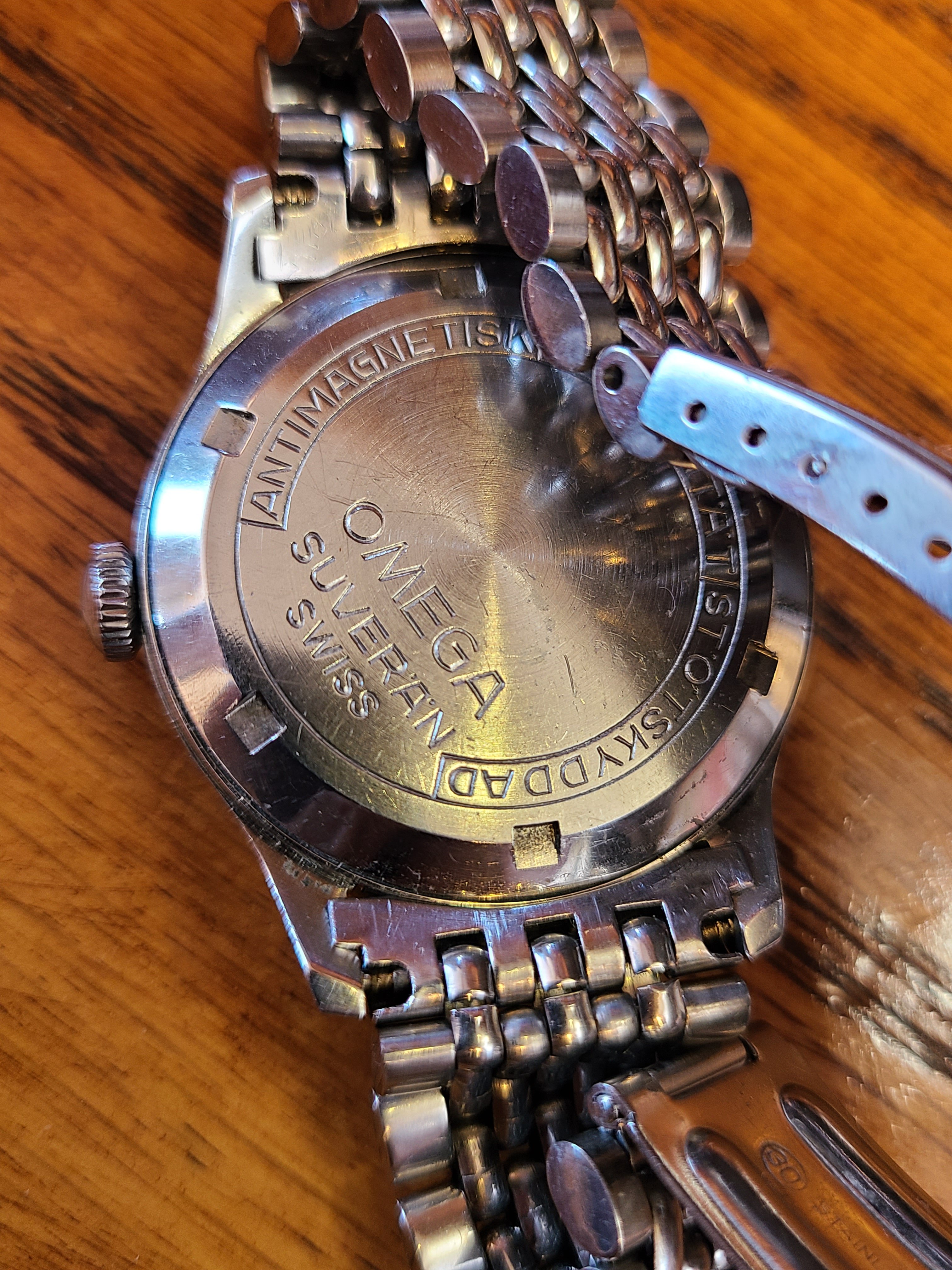

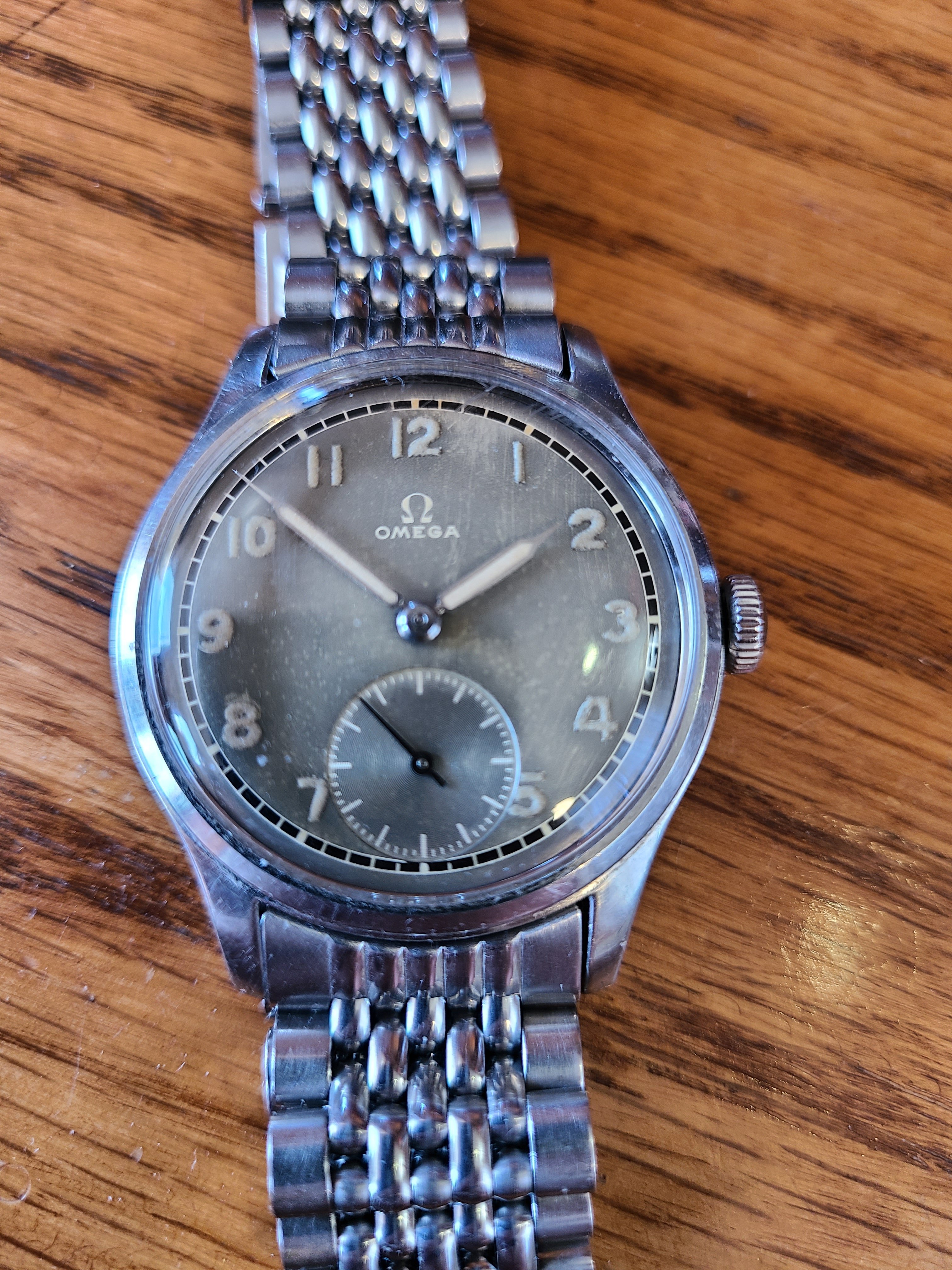

I think the 1036 and plain endlinks (from Japan) fit best on a Suveran.
Looks quite good on your Suverän i must say! Very instructive info delivered by you good sir
