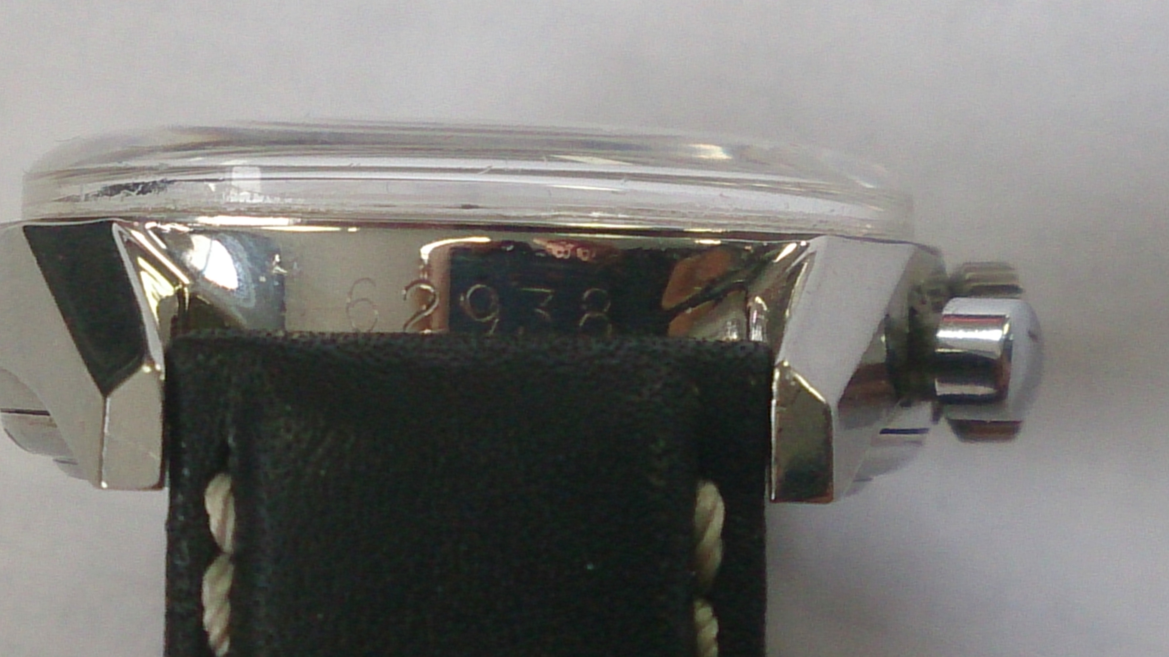

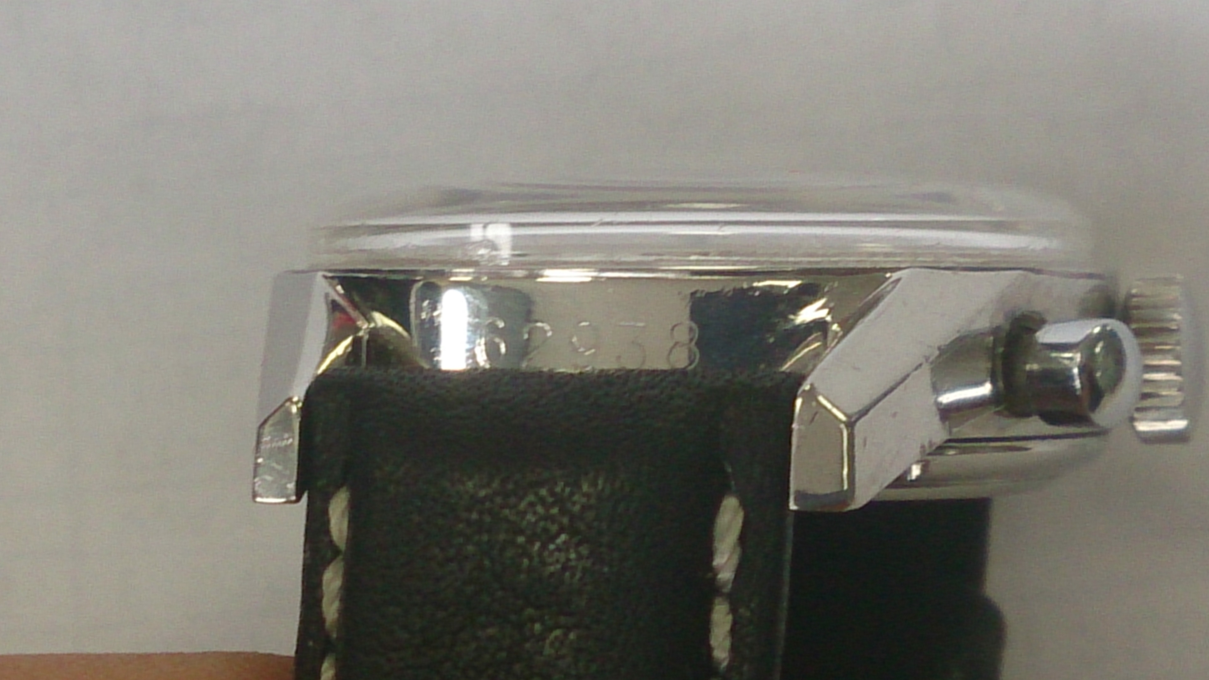

    Hi all, I came to work this morning and I had the pleasure to see this nice timepiece
    Long story short, a co-worker's father passed away and he wants to acquire his father's watch from the estate. To buy from the estate, the watch has to be appraised (for benefit of my co-worker's siblings). As he is not a WIS, he asked my help to find out more about this watch. As I am not a vintage Heuer expert (nor expert in any brand), I managed to gather the following from the web:
    Model Reference: 2447s (likely early edition, given the hexback and unsigned crown)
    Year: 1964 (est.)
    Watch Serial: 56xxx (last 3 digit left out for privacy purposes)
    Movement: Valjoux 72
    Dial and Hands: First Edition dial and hands
    Caseback: Polygonal Caseback (aka hexback)
    Crown: Unsigned (very early edition had unsigned crown, but slightly larger than the one on this watch… however, I’ve also seen some examples with this type of unsigned crown… my guess this is original)
    Can Heuer experts out there confirm if what I have gathered is accurate?
    Valuation/Appraisal: The watch is great condition, unpolished, very clean dial, slightly oxidized hands and clean crystal. Case is in great condition. Band is not original.
    Based on what I can find, the watch is worth somewhere between $15k to $20k CAD... again, I'm interested to hear from some Heuer collectors here.
    Lastly, given the sentimental and monetary value of this watch, I hope someone more knowledgeable can suggest the best and safest way to have this appraised.
    To summarize my questions
    1. Is the watch info above accurate? If not, please share your thoughts
    2. Is the watch worth around $15-20k CAD?
    3. What is the best and safest option to have this appraised?
    I really appreciate feedback from the community.
    Thanks all

    Pretty good evaluation. It is indeed a very early one, and the dial looks good to my eye. If you want to get an accurate price then you’ll need movement shots too. Your current estimate feels a little high, but perhaps a top-end dealer would be asking in that range. I guess a private sale would be fractionally under your lower estimate.

    Beautiful example! It looks correct to me, I can't be 100% sure about the crown but yes this model would have had a large, unsigned crown. I'm not at home to compare to mine, but the size looks right.
    I'd say that if the movement is in good shape (no rust, all parts are present and the chronograph starts, stops, and resets properly) then yes, 15-20k CAD (11-15k US at current exchange rates) is about what it's worth IMO.
    Best option for appraisal is probably an auction house.

    Thank you, I have been told that a movement shot is needed for a more accurate evaluation. I'm not sure if the case back require more specialized tool to open, so not to get damaged or scratch during the process.

    Thanks for the feedback. Given that I have no information on the state of the movement, I only did a few gentle wind, and the chronograph functions correctly. I did not perform further tests as I do not want to incur any damage to the movement.

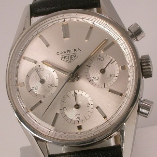

    Your friend’s 2447 S is an early one as you have mentioned.
    Serial number sits nicely in the poly back range and most importantly,
    it has the correct eggshell color dial. Don’t worry about the crown, the early ones
    unsigned were 6.7-6.8mm and it looks about right.
    My estimate is this is a $12000-16000 Carrera.
    I suggest you contact Eric Wind. He used to work for Christie’s and You can trust Eric!!
    He has gone out on his own in the Watch world and should be able to give a written estimate.
    A lot of watch pedigree with him and an early Heuer fan. [email protected]

    As others have said, this looks correct in all major respects and in very nice condition, to boot. These eggshell dials are very rarely seen, and typically don't have the attractiveness of this one's patina. He should go "all in" for this one.

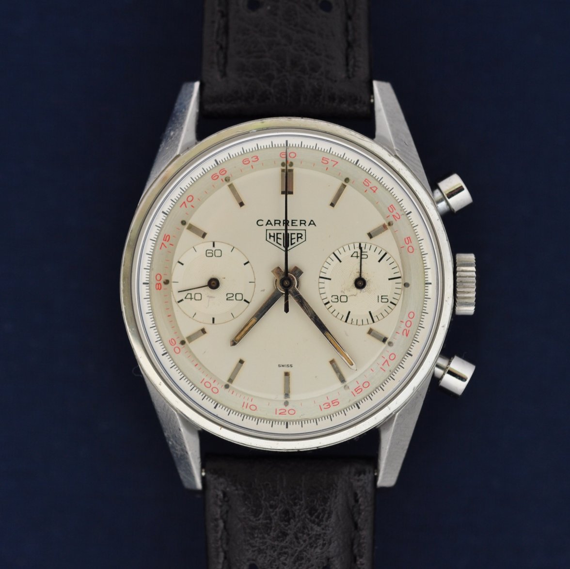

    Its looks like a great example of an 1st execution, I used to own the same example & still have some old pictures of it ,& it also had an unsigned crown & serial no was 6.2 as in the picture posted below .If you can buy it then I would highly recommend you do . Like a fool I sold it for a song & boy do I miss it .
