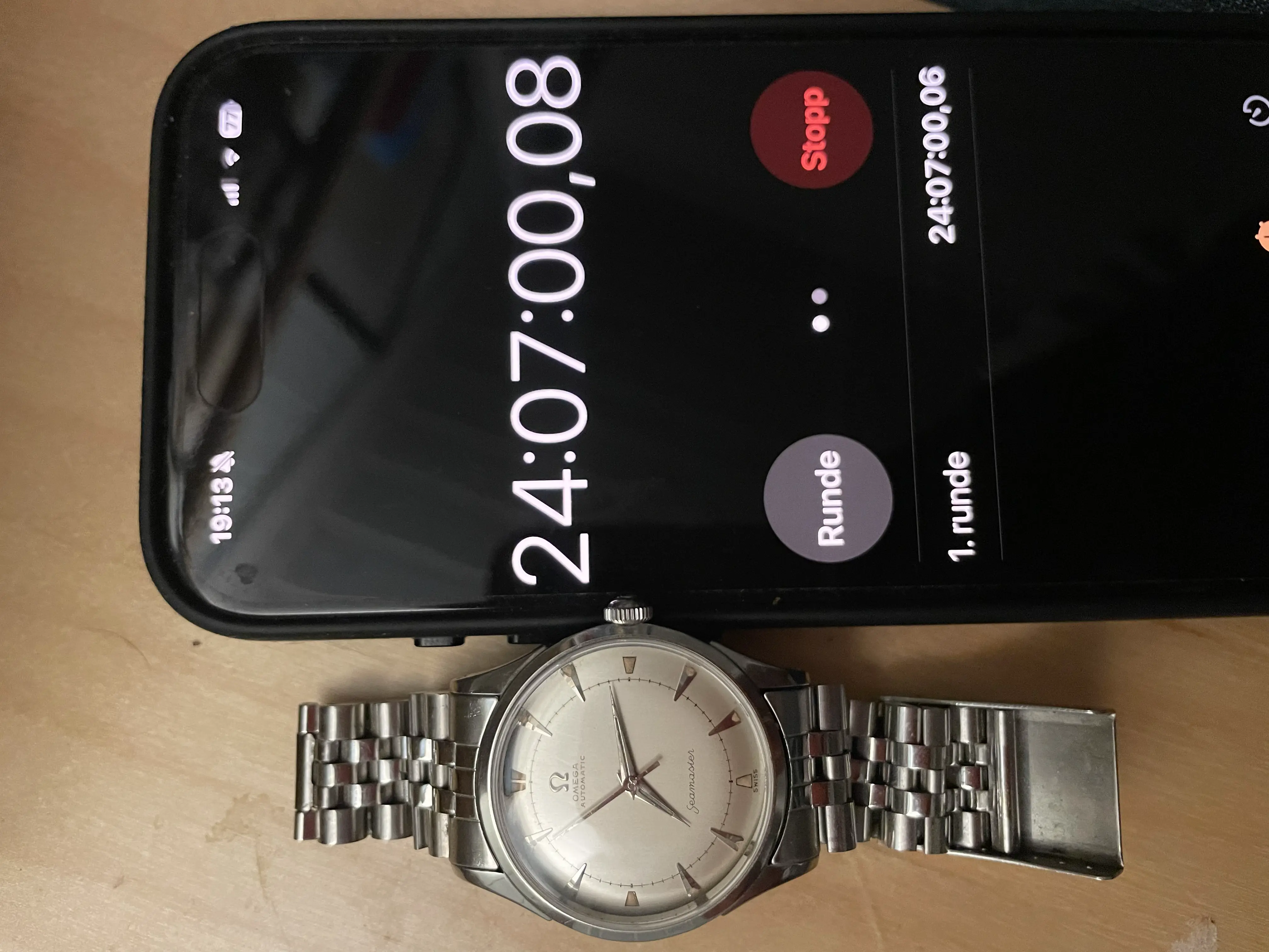

The results are in
After 24h and 7minutes it has lost 6seconds.
So it lost more during the day with office activities etc, than at night (as to be expected I guess).
An impressive old watch😀

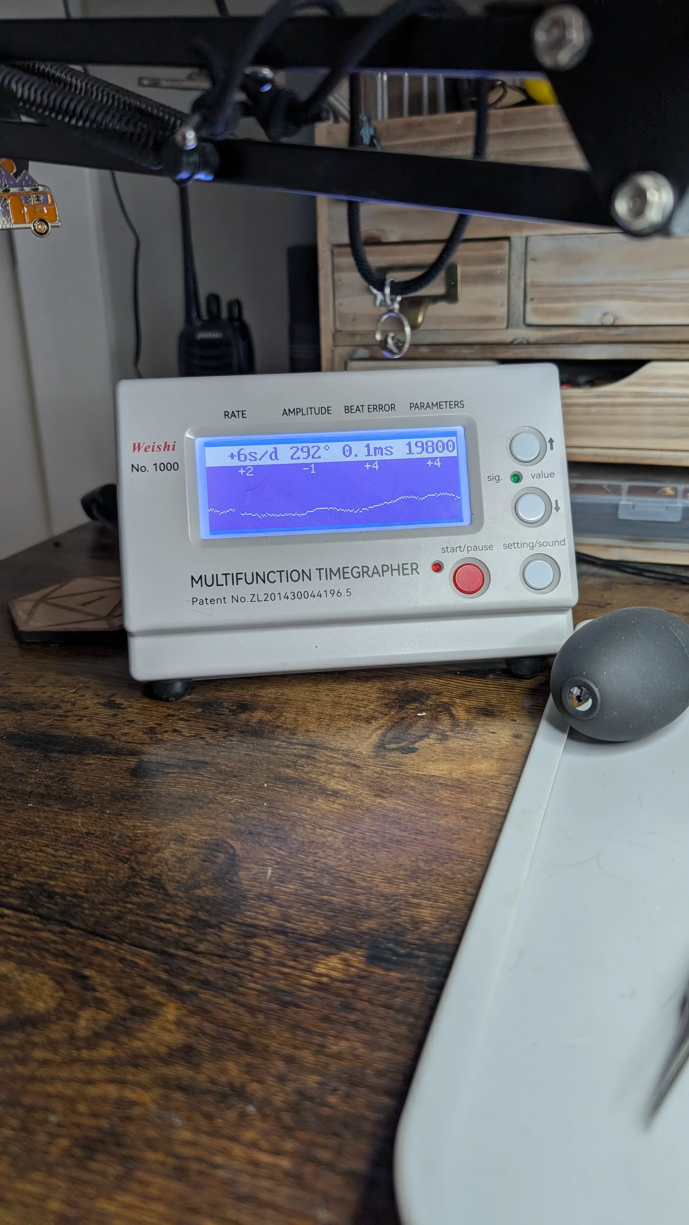

I have a 1960s speedmaster and it's +/- 4-6 SPD with around 292 amp and .1 beat error. So it's possible to get a fairly accurate read after a service. To get the best possible, you'd need a timegrapher and patience, and then there are (I believe) 3 positions you should measure and adjust for for the best possible. However, just the 1 is good enough to wear if you dont mind losing or gaining a min or two each day. I'm not speaking to your watch or service, I just know that it is possible to get a good SPD on an old quality watch.
