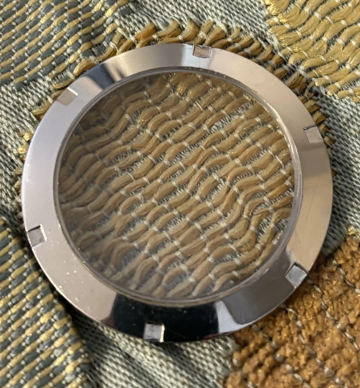

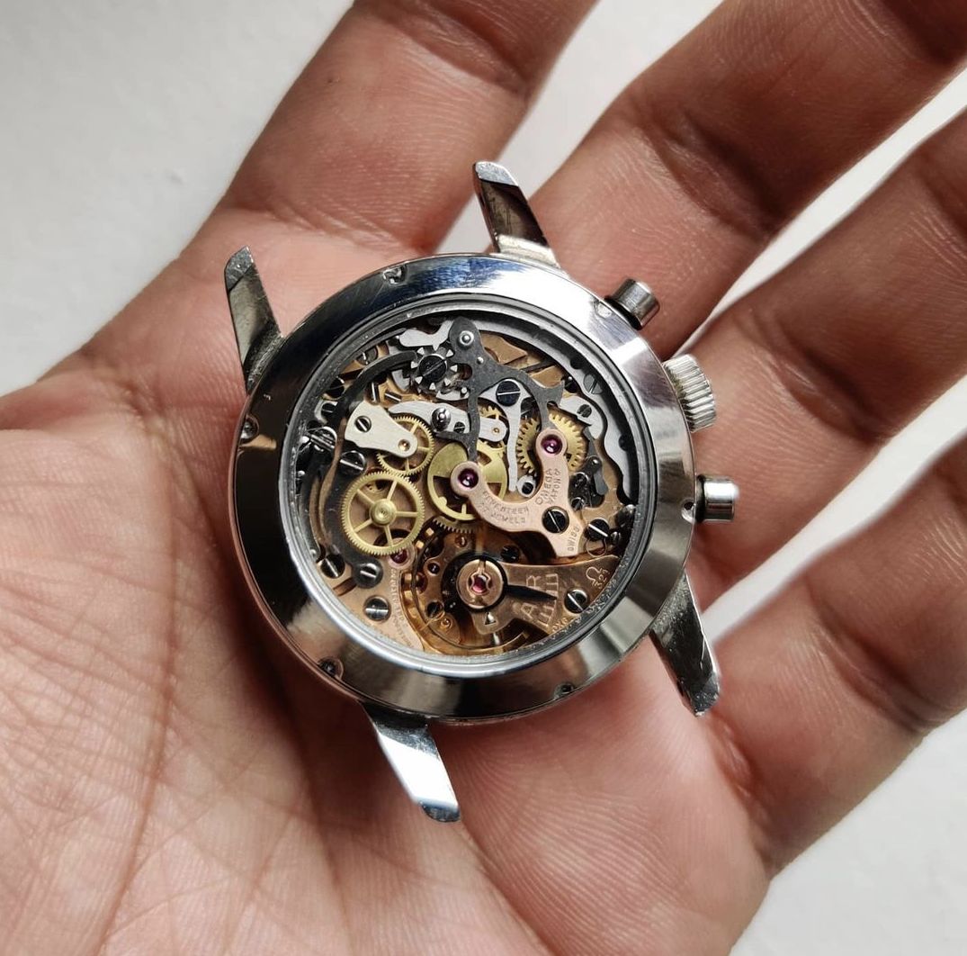

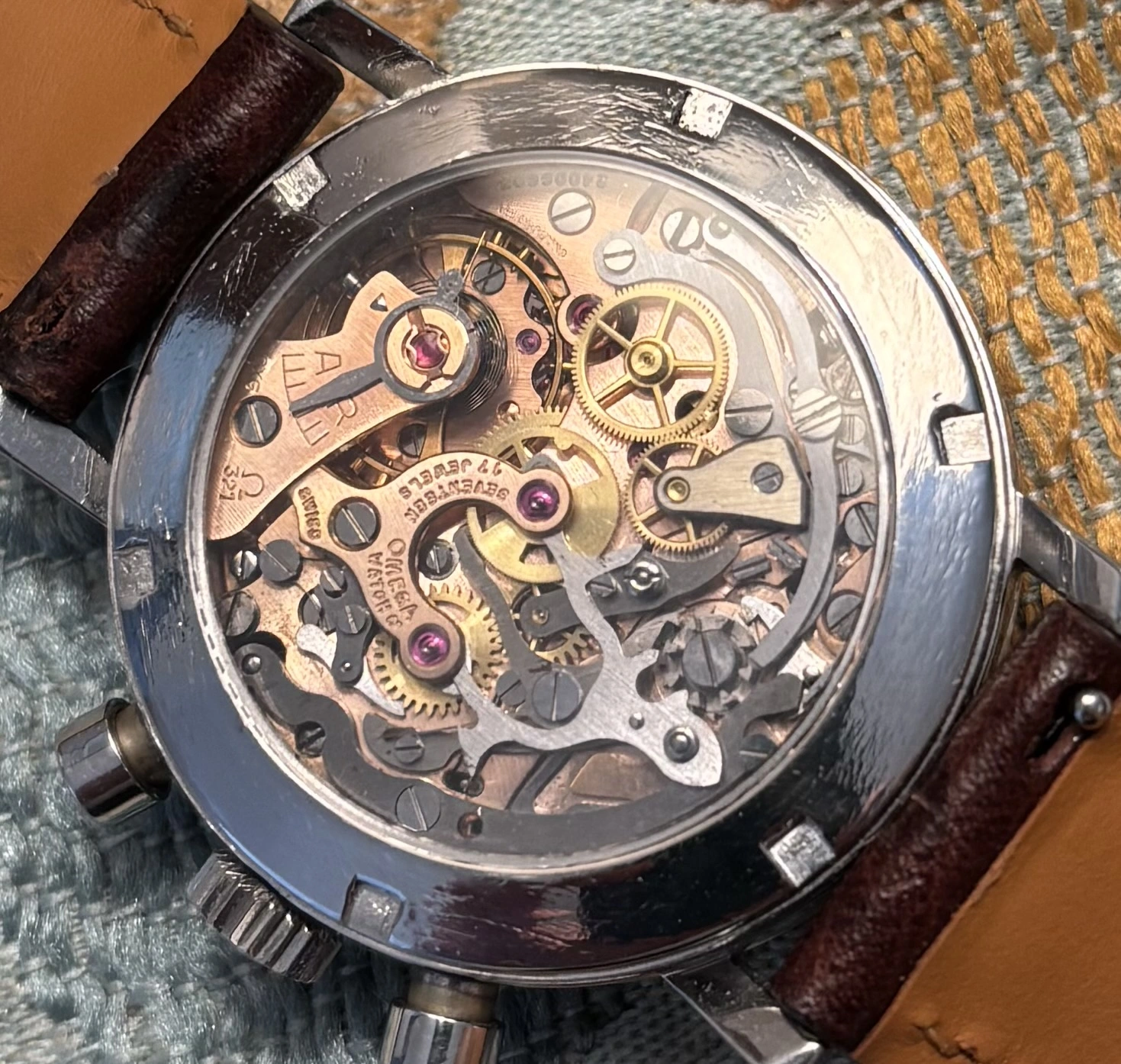

I don't think the Constellation or Bumper caseback will work as the screwback Seamaster 321s have larger diameter caseback - I have the constellation one and it did not fit from my memory. The caseback also has to clear some of the chronograph components, otherwise it will hit the inside of the caseback. In the end I had one custom made.

Oh my it looks really great, I want one even more now!! 👍
Thanks for the input! Would you mind giving me some pointers as to how you got one custom made??

i just created two custom casebacks for the omega 105-005 sea master chronograph. One of them is on my watch and the other is on eBay for sale. It took a lot of effort to do this, but the result is outstanding.
