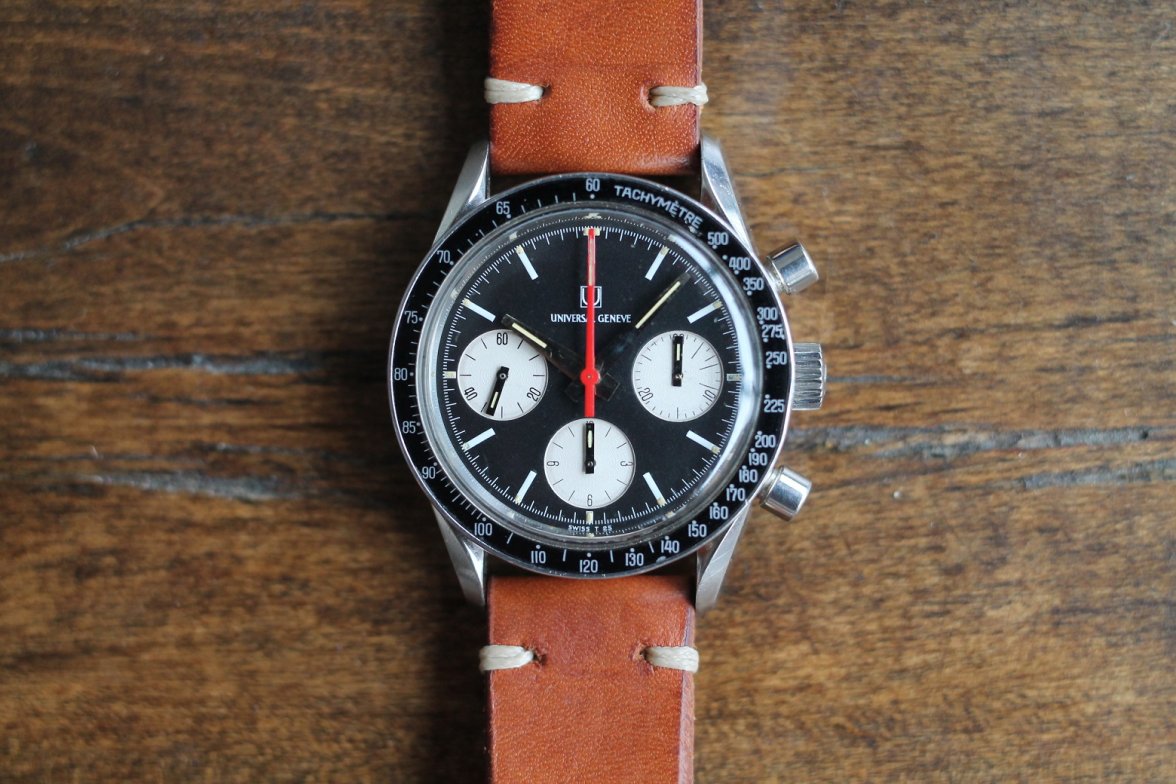

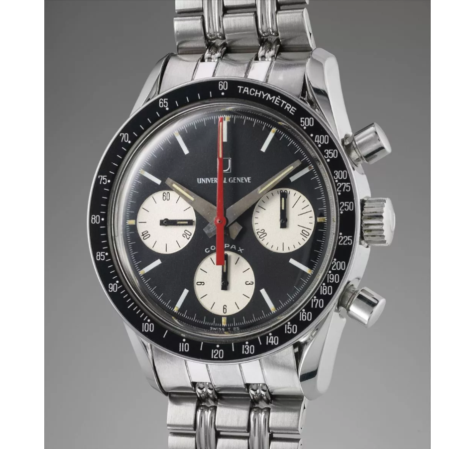

    This minty evil nina sold at phillips last fall
    What do people here think about the chrono hand ? I have seen versions where the chrono hand does not extend into the lower middle subdial. I was told perhaps this was a replacement chrono hand from a space compax or the like, but others have said this chrono hand is original and correct. I cannot find examples of the longer chrono hand on a regular Nina.
    Thoughts ?
    I would also note on the Phillips one it says "compax" but on the Fratello one it does not. Is one an earlier version?
    https://www.phillips.com/detail/UNIVERSAL/CH080217/151

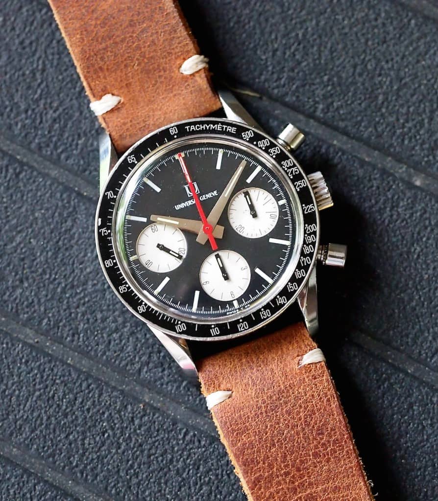

    "regular" chrono
    https://www.fratellowatches.com/tbt-universal-geneve-compax-evil-nina/

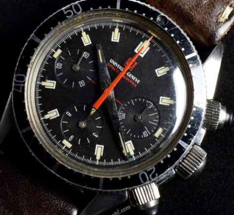

    I have always regarded that super long chrono hand as a Space Compax hand. it is true one sees it often on Ninas, but that's my opinion FWIW

    I've seen it enough times now that I have just come to accept it as kosher. That said, it looks very out of place compared to the right-sized chrono hands.

    That hand is correct for the compax. Earliner nina and evil ninas have shorter hands. I have seen three three different versions of chrono runner hand.
    Long with lume
    Longer with lume (as shown)
    Medico compax which is longer but has no lume.

    there is no absolute proof. what we see is space compax references with long and short runner hands
    and compax references with long chrono runners ...
    Service replacements maybe ? perhaps a change of supplier or just a straight forward design change. They both look good on both ....
    Unfortunately documentation on later references is scarce.
    Another subject to research ...
