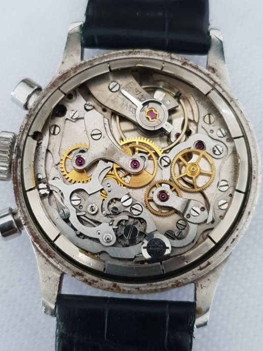

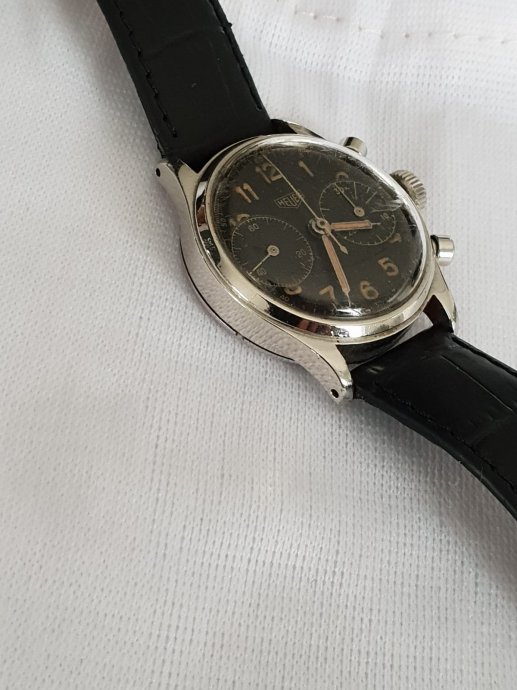

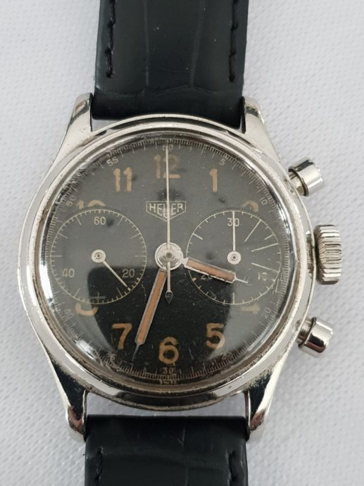

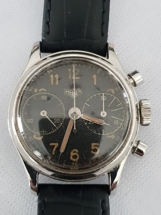

I've found one locally from a brand i cherish almost as i do Omegas. I've found a Heuer pre-Carrera. I'm loving the design, the big eye subdials and the black dial with patinad hands and indices but the watch looks wonky to say the least in comparison with some other images I've googled.
So I'm once again turning to this forum in search of knowledge and advice, can you take a look at the photographs and give me your honest opinion on the watch, whats good whats not good etc etc... I'm liking the big crown and the pushers and thing those are correct but the hands and the luminous look out of place. Is it a sad piece or something i should jump if means allow?

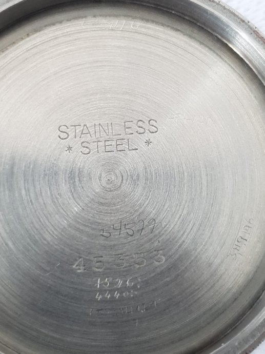

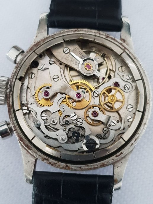

Can you post the exterior caseback as well, if it's accessible? And tell us what the seller's description is and what they are asking? Right off the bat, you can see the case has been aggressively polished, though that's hardly a deal-breaker. Is that Radium lume? That looks like a 400158 movement, though it's not Heuer signed. The numerals and hands look right for a 433 NT from the 1940s, but the only reference dial I could find has a very different tachy and subdial arrangement. https://shop.hodinkee.com/products/1940s-heuer-chronograph-reference-433-nt?variant=12288138838091
What bugs me the most is the lack of signing. Heuer seems to plaster their name wherever they can, but here it's entirely absent except for the dial. I couldn't definitively say franken, but I'm getting that vibe. Also, the mushroom pushers rather than rectangular ones seems unusual for a watch from that period.
The caseback is polished, I'm more or less inclined to do a trade for items in market value of around 1500€-2000€ that I'm having a hard time of getting rid by selling. Dunno if I'll be asked to spice up the deal by cash or not.

If that watch on CG has an original dial, I'm the Queen of Sheeba. More likely that yours is original than that one is! You should wait until the Heuer experts weight in. I'd say, given the circumstances, it sounds like not a bad option. If you're happy with the watch , then it's a win!

There is just no way the movement shown in OP pics is correct for the watch
I'd steer very very clear of this franken

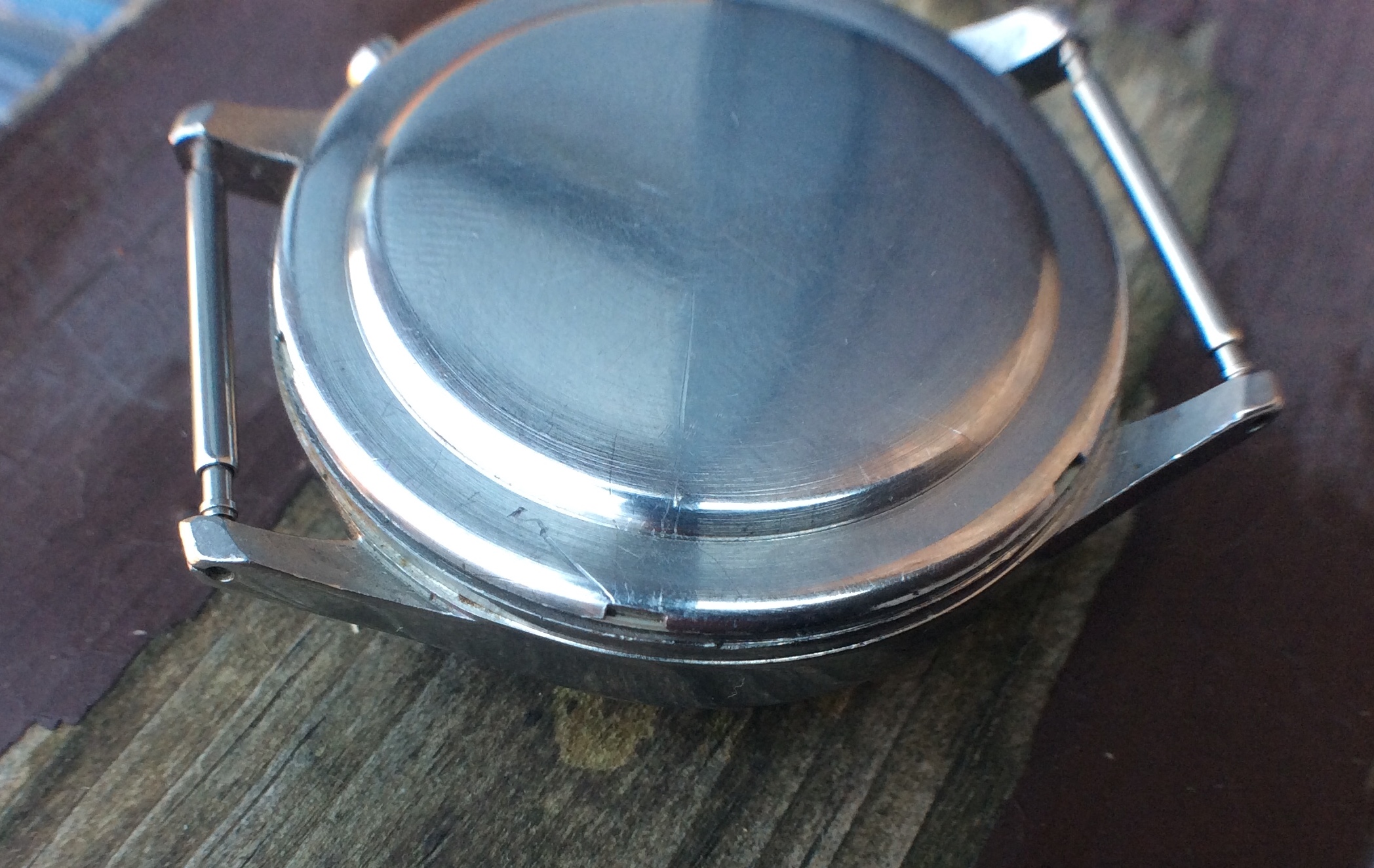

Early Heuers from late 30s to early 40s are only signed on dial, this case is a screwback from this era whitch is unusual for Heuer that normaly came whit snapback.
The Landeron movement whit incablock was used by Heuer at this time.
The dial looks to be a late 40s or 50s dial,

It's a snapback, I've found similar watches on Chrono24... Is there a reference that i could further explore or another name for the watch the pre-carrera brings up all sorts of things while searching.

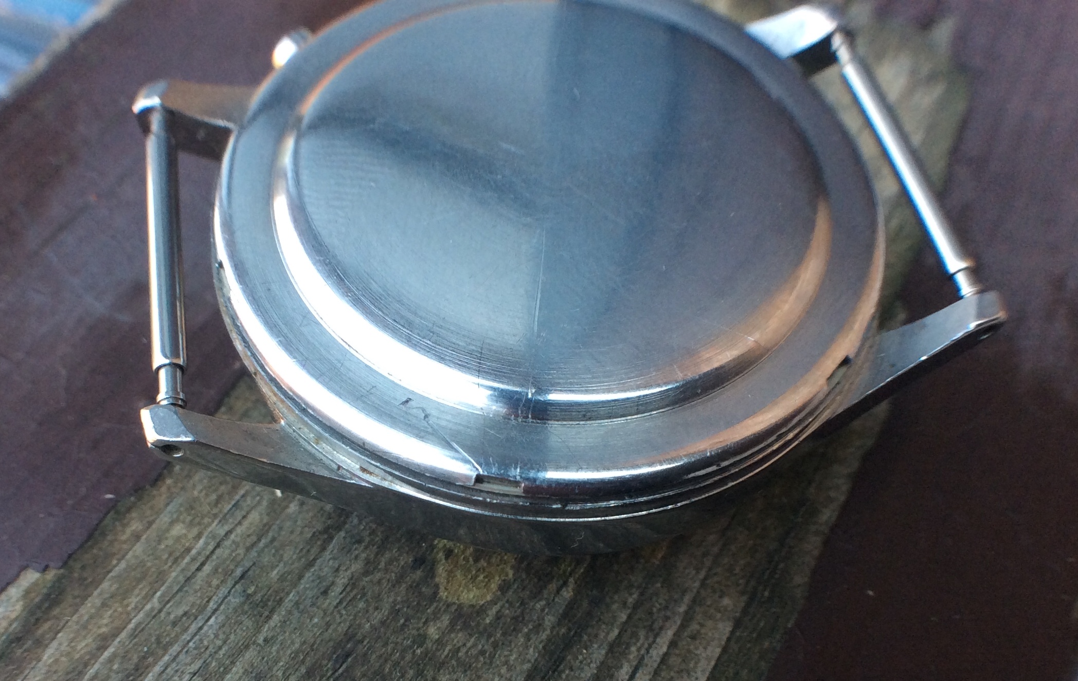

If you check the 3 photo you can se the smal square that early sqrewback cases have, if a snapback the case is broken.

I belive you have the same case as the link in a collected man
Correct, the seller said it's a snap back - could be he just doesn't know how to open it properly...
Since there is a movement photo he opend it, if he used force and a knife the case is probaly damage.
U should make shore case is ok before doing something else. Good casemakers are harder to find then good watchmakers and normaly expensive.
Crossed my mind, I'll take a look at the watch in person this Tuesday and report from there. Thank you for your keen eye and input and to everyone else that contributed to this thread.
