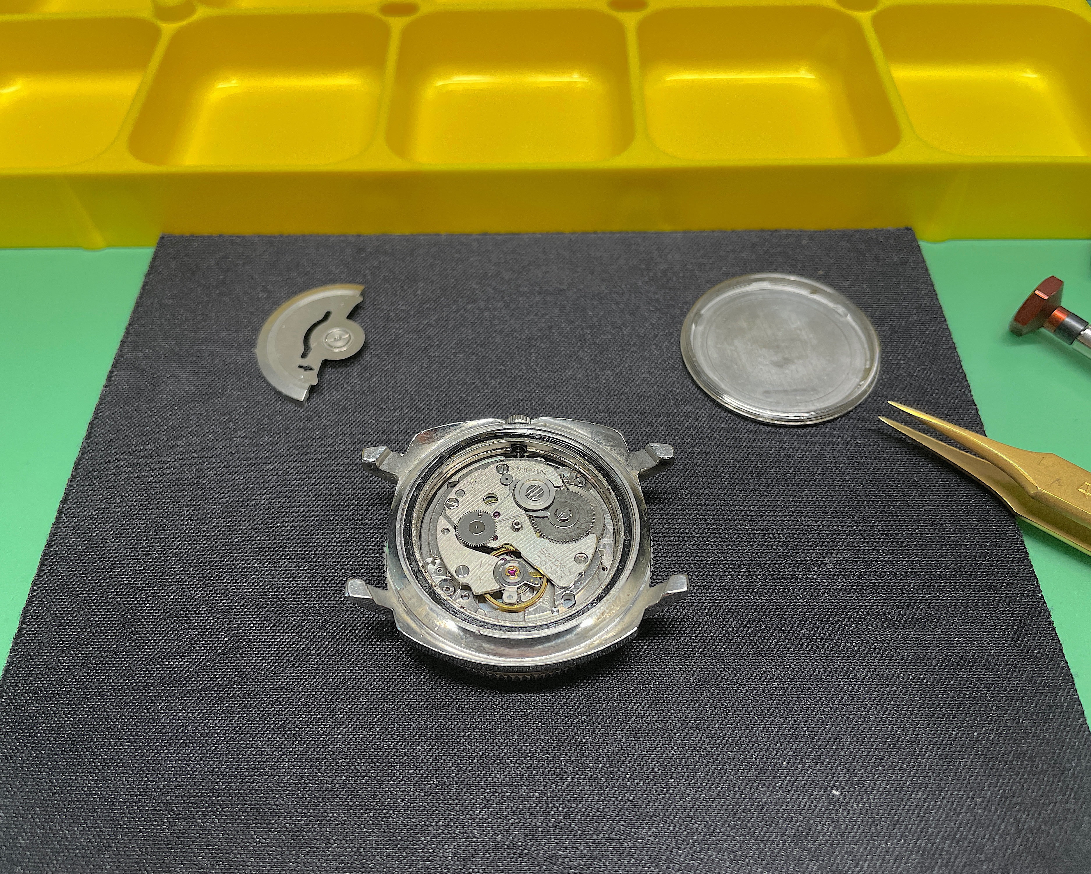

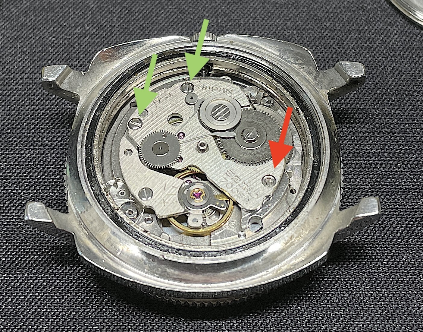

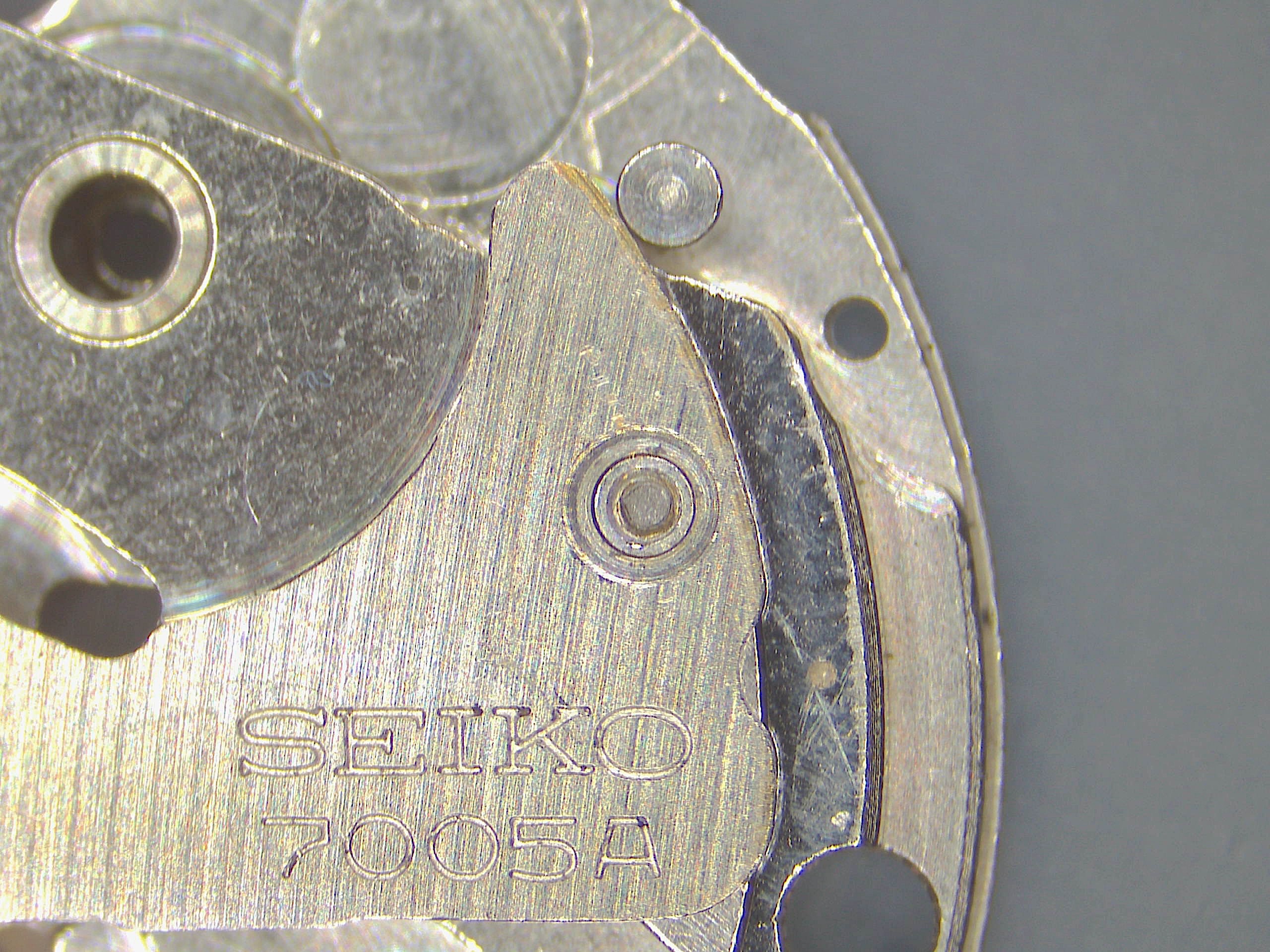

.......and thought "That's funny, looks like they've lost a bridge screw".
There should be three of them!

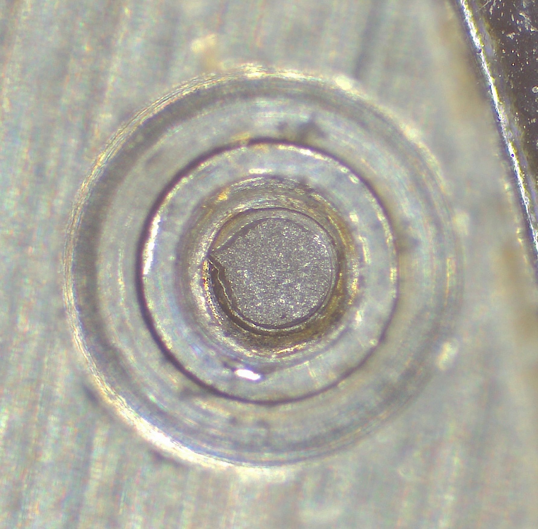

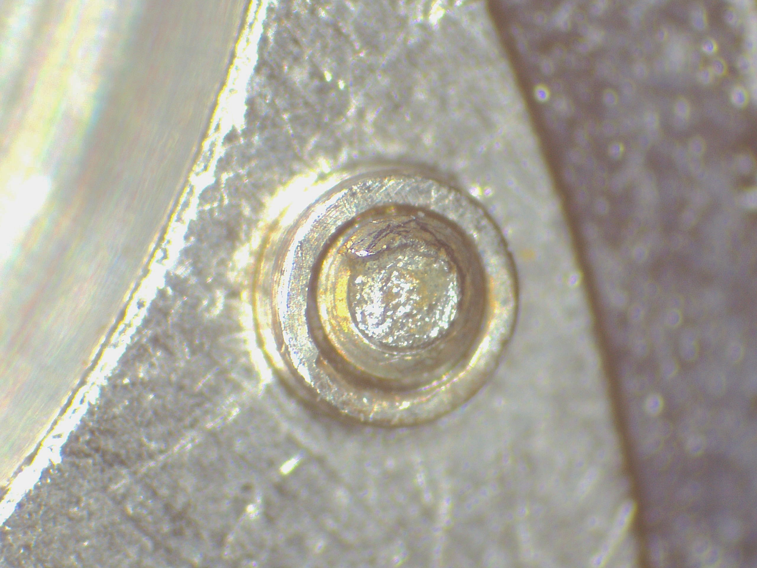

Closer inspection reveals the truth 😬.
The screw head has been sheared off and I don't have a screw extractor 🤬!

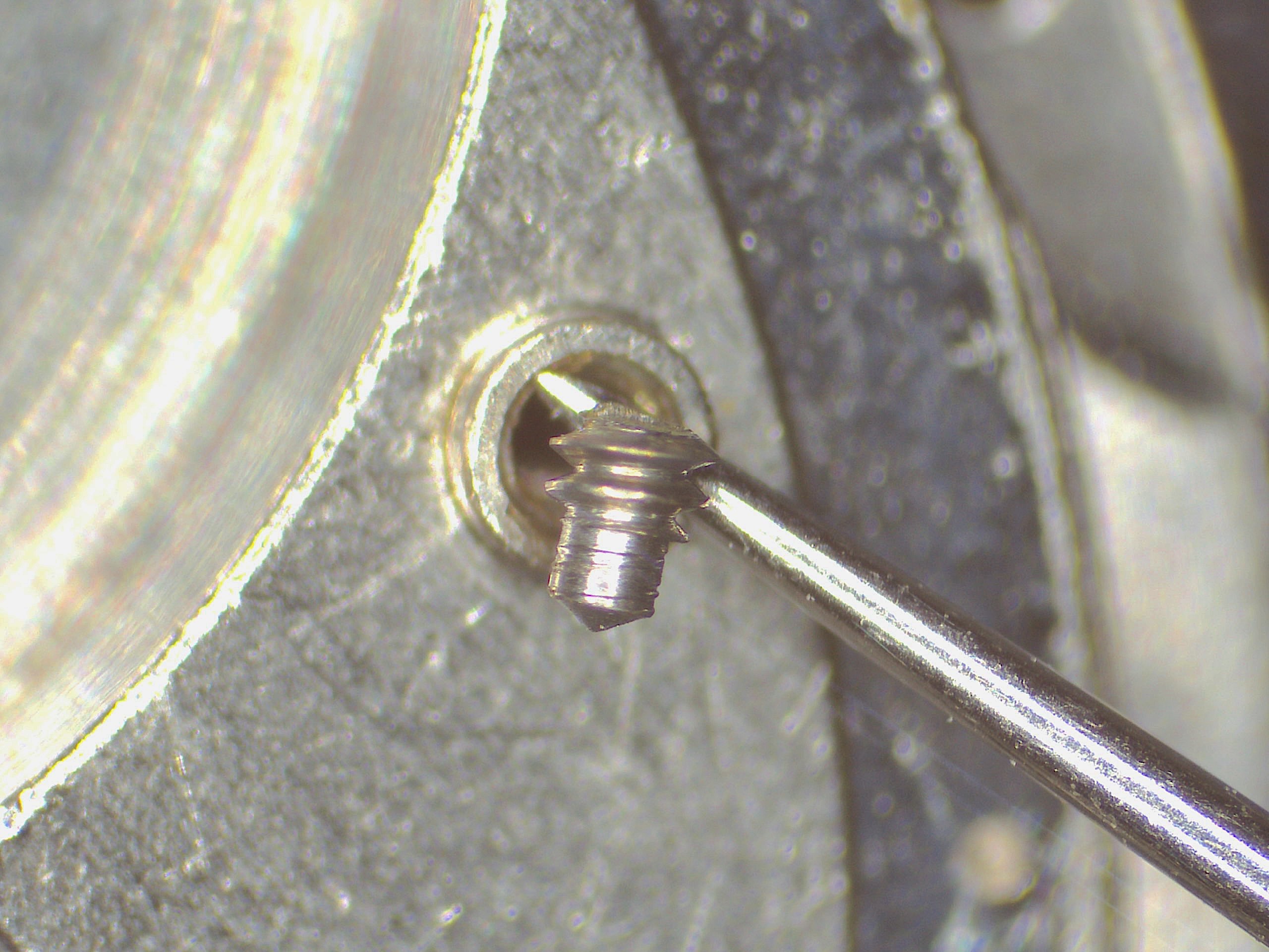

So after trying to tease the thread out, without much success, I decided to chuck it in the ultrasonic for 10 minutes at 80ºC with the plate facing up in the hope that temperature, vibrations and gravity would help.
You can imagine how happy I was to see this little bugger when I got it out of the US!
A few minutes with a magnetised needle and Bingo!
After that success I left everything on the bench and retired for a well earned beer.
