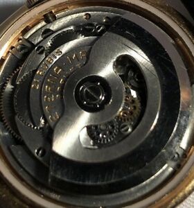

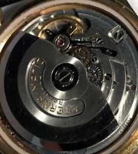

Although I like them I am not a technical expert so wondered if anyone could confirm the movement in a watch I am looking at:
there is a number there which seems to place it in the fifties but no ref.Also as it is a chronometer can you see micro regulator?
On Ranfft database the watch number seems to put it somewhere early fifties but would expect it to be movement 1424 movement roughly. But no movement ref no. there and usually there is.
any help appreciated.

I think at this stage you just need better pictures - the movement ref should be under the balance wheel, but I'm afraid I can't see well enough in your photo whether it is or isn't. I think this could be from c.1957, and perhaps a cal 1422, but more info. is needed. I do hope you end up with a nice acquisition!

Unfortunately, I think it's very hard to judge the watch based on those photos.

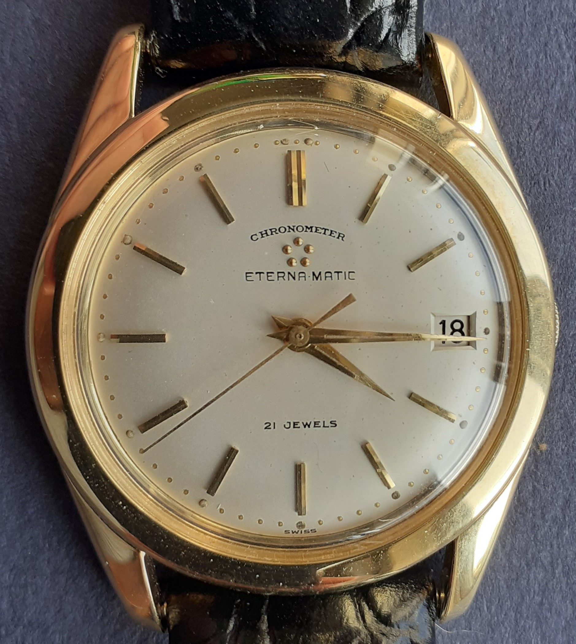

Although you can see more detail using the online platform's magnifier, you really need a straight-on shot, and properly lit in-focus photos of the movement. The seller is a UK brick-and-mortar store, so you might do well to just call them and ask. Here's an example for comparison: although it's yellow and without the waffle texture, it might help you looking at the fonts. Good luck!

Definitely need better photos. Remember that waffle dials often distort the printing to some extent; don’t expect it to be as crisp as on a flat dial.

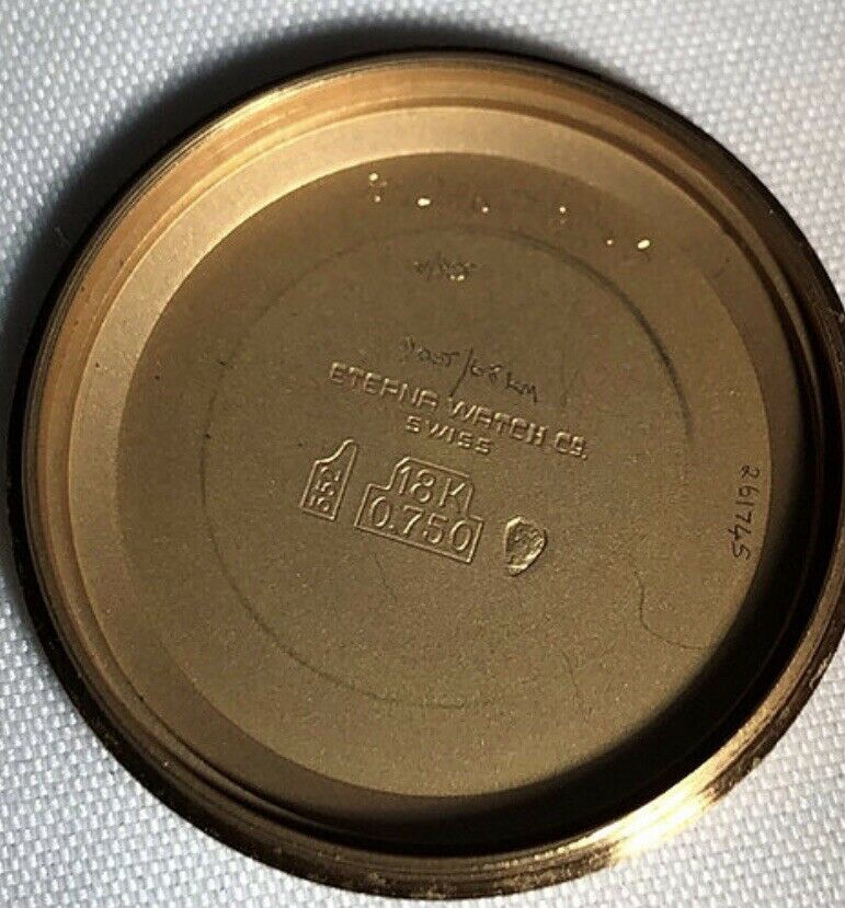

Not mentioned - hadn’t thought about that. it’s on the bay: Eterna Matic 18ct Rose Gold Automatic Chronometer Men’s Watch
1,869
5,448
Yes, screw back case.

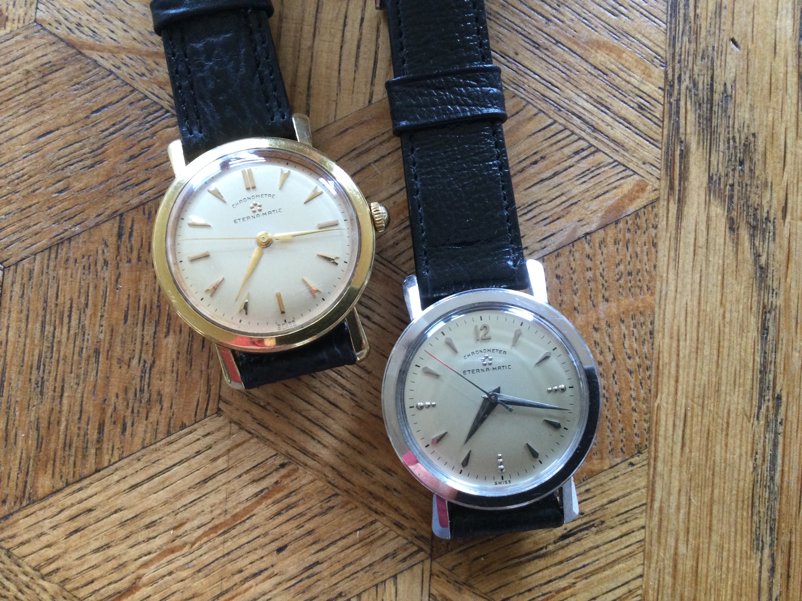

I like better this case design :
I have got a week spot for these as well (it is not only Omega which makes my heart sing).
Got one in SS and one in pink gold...
513
339
I like my Eterna to 😀
I hunted two years for this one untill this specific modell come to my knowledge.
