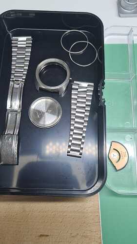

hello i have end links 162 , for witch bracelet do they fit?
thx for all help

yes correct so i look for a correct clasp for the 1162 with end links Or a 1170 compleet bracelet , its for this watch the 176.007

Looks like a little mash-up to me. 162 end links should be 24 mm, 176.007 has 22 mm lugs. One correct bracelet I know for this reference would be 1170/653.
1162/162 fits a Ploprof, maybe the 162 are filed down to 22 mm?

Yes it a mash up now, thats why i look as you tell me for a 1170 ; thx very much for your help
greetings
Roel

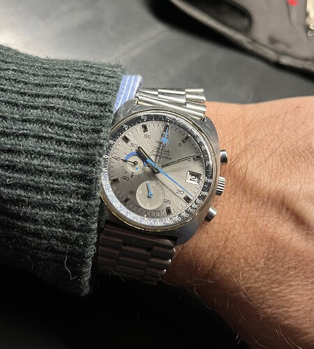

Hi,
1162 bracelet is much more easy to source, and the difference is hardly visible when around your wrist.
Game changer is the end link … change the straight 162/172 for 653 or 625.
picture shows my 007 with a 1162/625 combination
Edit. Just recognized it is a 1170 bracelet … I should know better, what I am wearing ::facepalm1::
