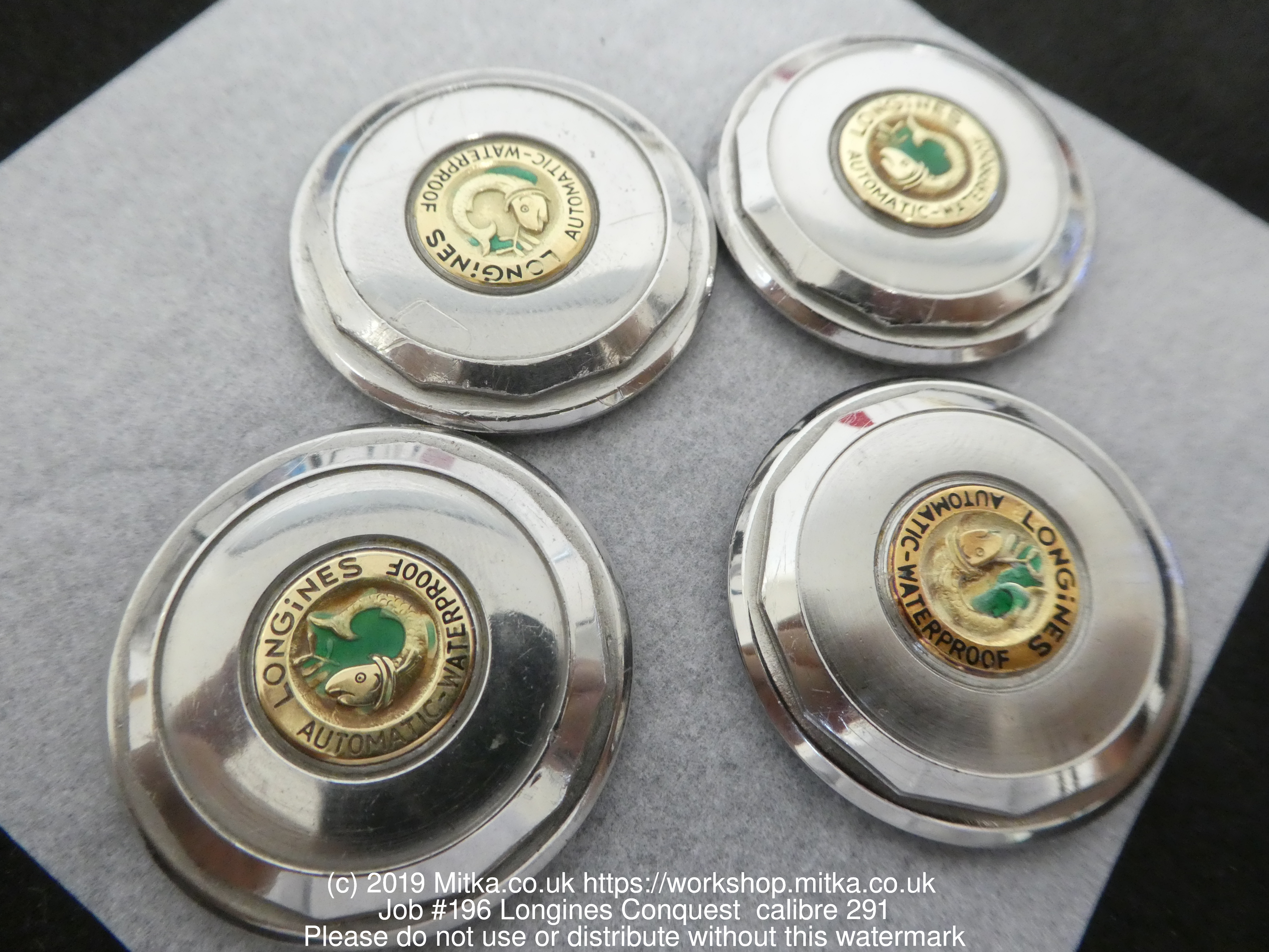

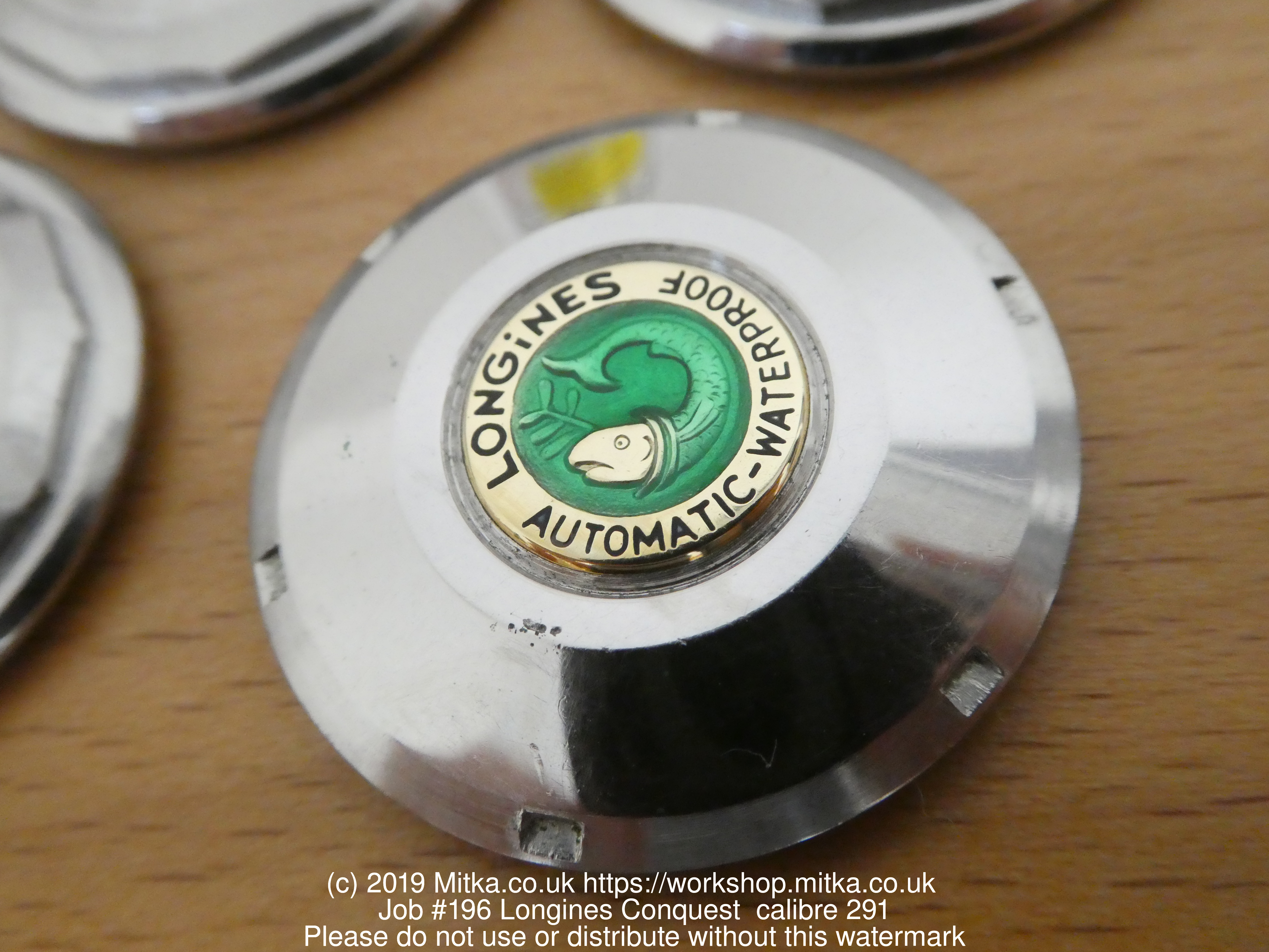

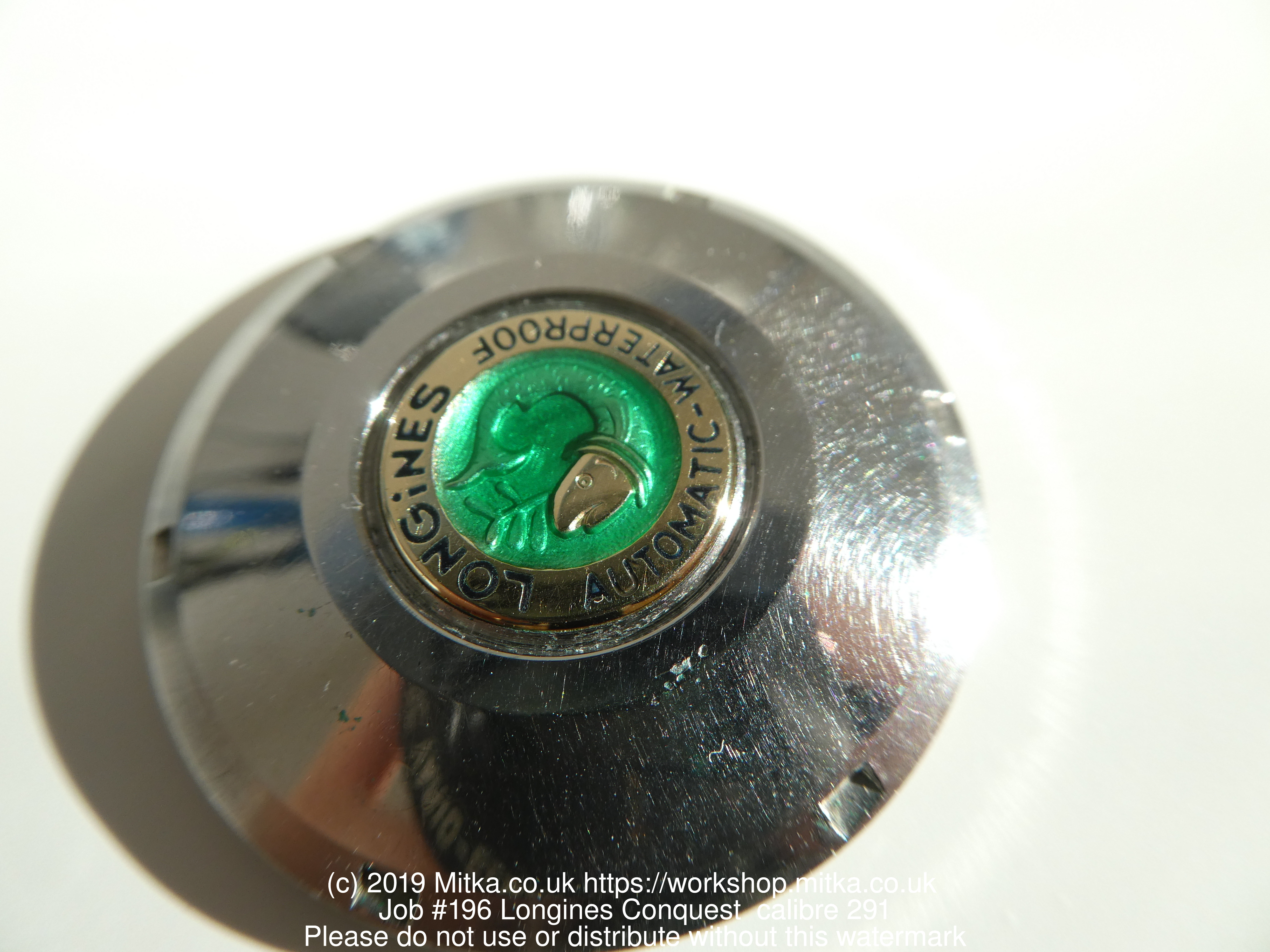

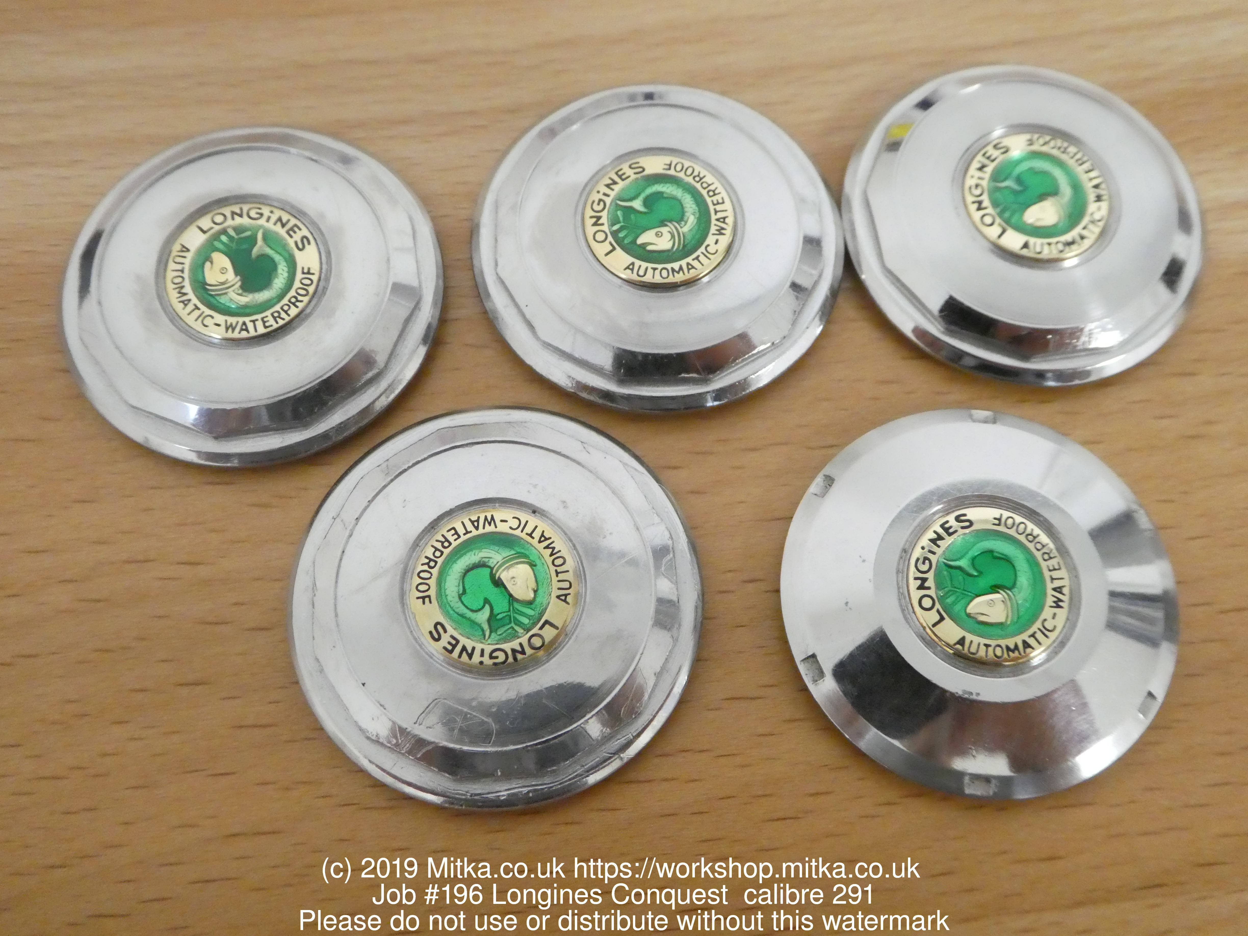

For those who where wondering how the Conquest case backs turn out... Note I have also filled in missing black lettering🙄

@Mitka Any idea on the longevity of the enamel? The one used by Longines rubs off over years with use. Any idea if your enamel will hold up with time? (not saying it won't, just curious)

This stuff is for jewellery so I expect it will at least as long as the original stuff, but then again I have just started testing it out so I can't give any 100 year warranty🍿. Also the original stuff does not rub of it cracks and crumbles.
