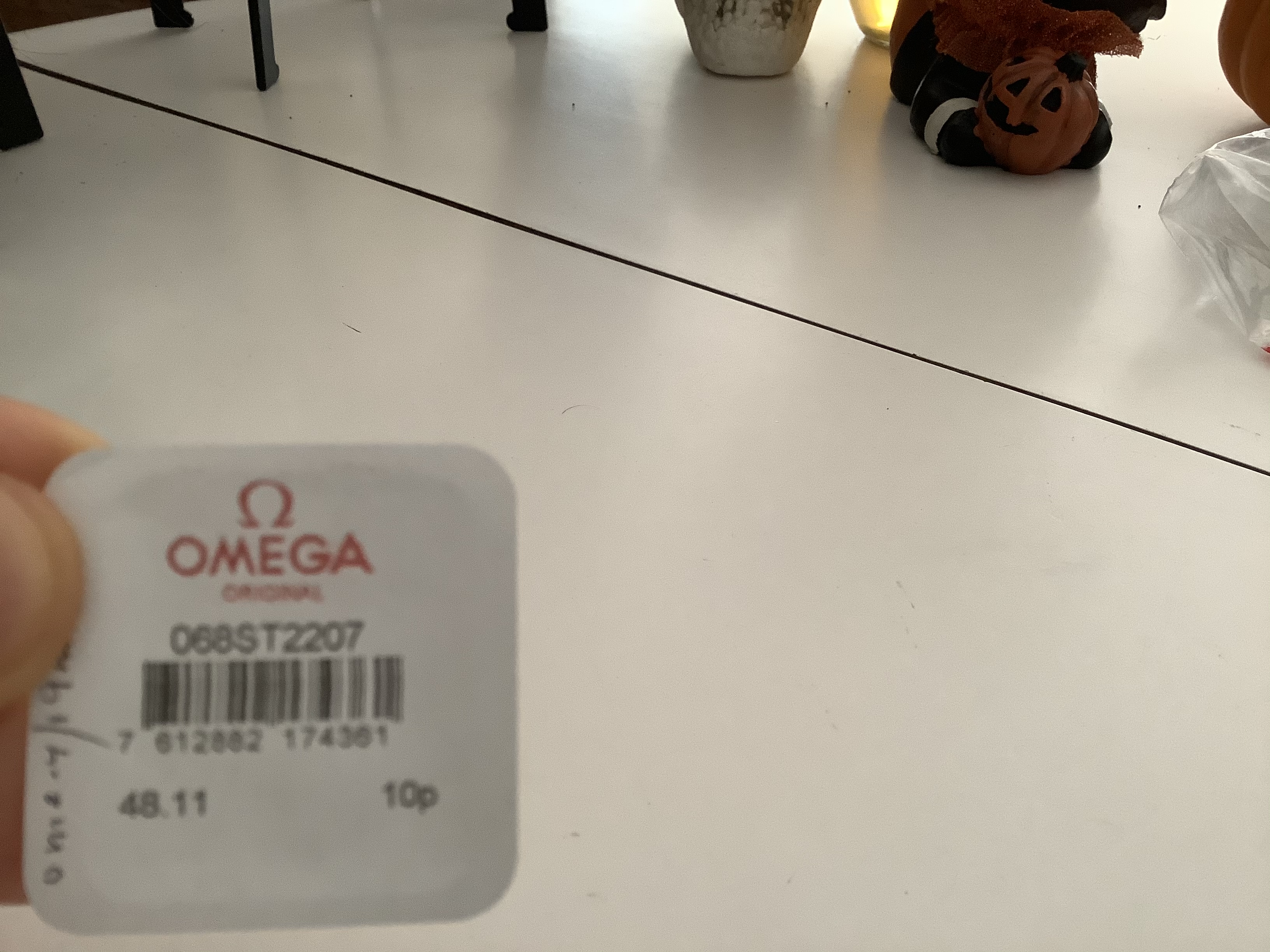

Depends on what bracelet. For a 20mm bracelet, you won't want to use this one, you will want a 068ST2207. The 068ST2208 is for a 20 mm strap, not a bracelet. It would be fine for a 21mm bracelet though...
7,382
23,844
okay, so the part number for the 19mm bracelet has not been covered yet, correct?
30,270
78,121
Right - the 2207's would be for a 19 mm strap, and a 19 mm bracelet would be a 2206. If you have ever tried to remove a bracelet with too long spring bars attached, it's not fun.
Now with vintage bracelets, these tend to have a much larger slot in them to compress the bars than say the modern bracelets do, so there may be some leeway on vintage that simply isn't there for modern bracelets.
This is apparently true. Been using these 2207鈥檚 with the original flat-links on Ed Whites without any issues.
