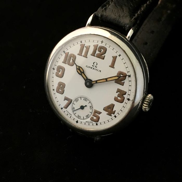

I think I have seen it before but cant remember where. However there is a very similar Omega. Here it goes.
Nice catch!

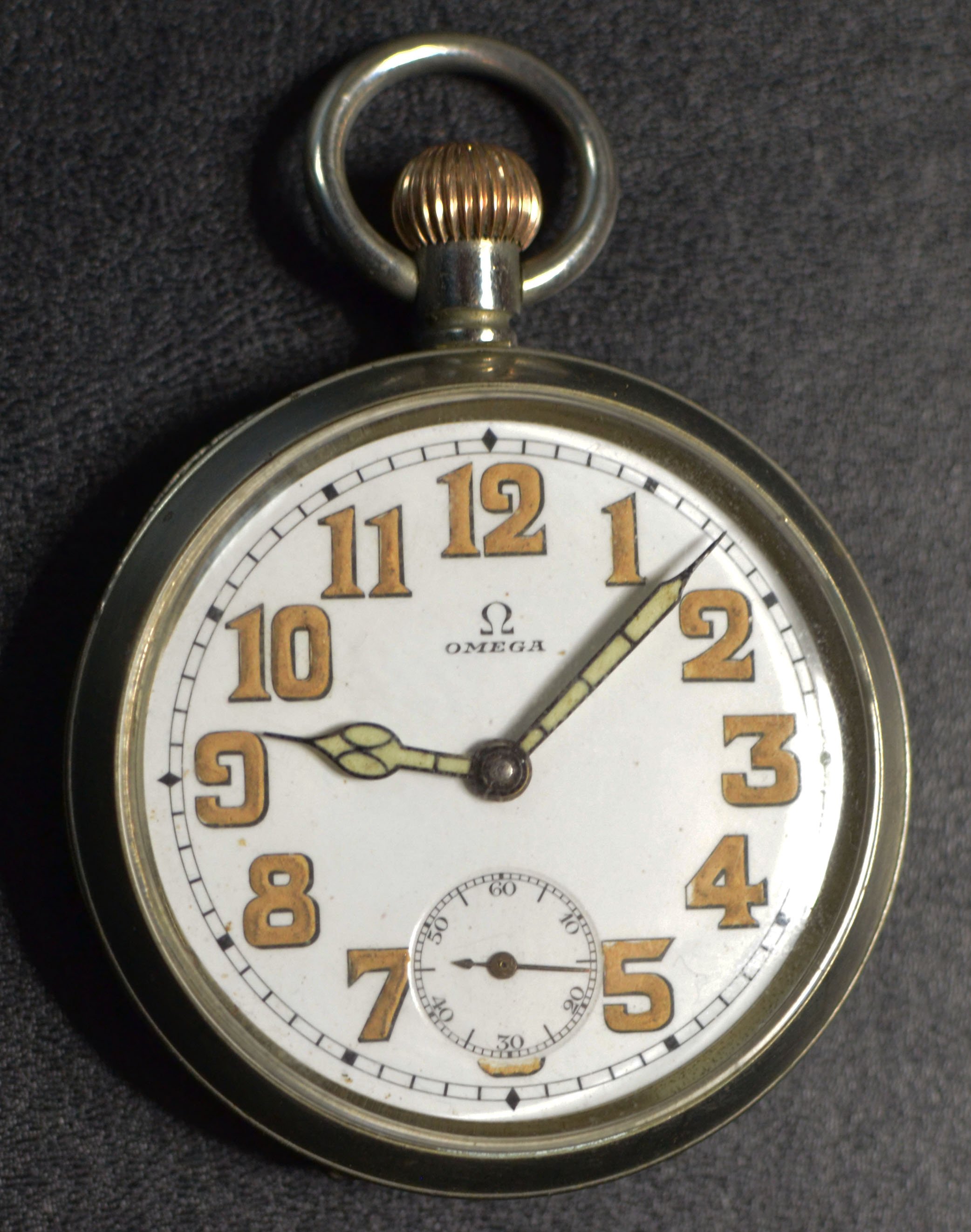

My pocket watch from 1921 says hello:

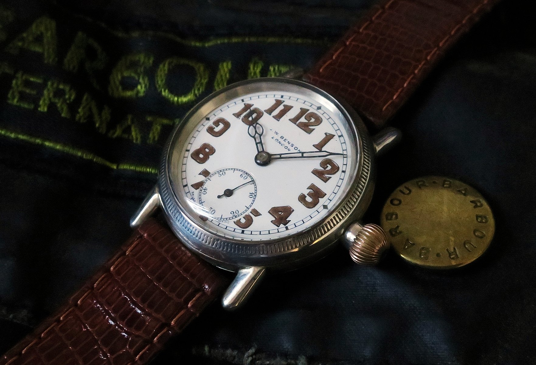

My BENSON says:
PLEASE don´t destroy this rare watch !
