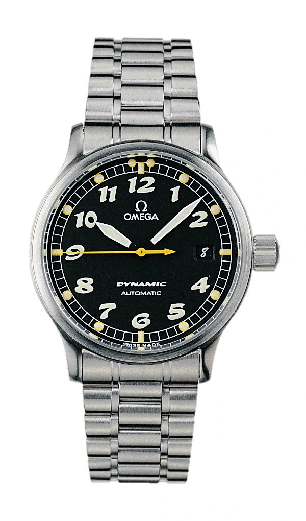

So does it look like this?
It would be 36 mm without the crown. If so it would be a ref. 52005000.
The crown for that is 069ST42146M.
The case tube is 090ST1230.
