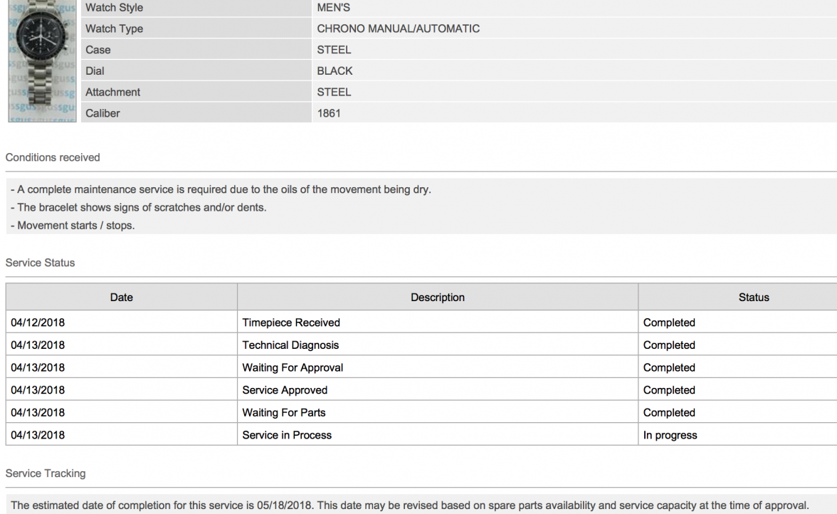

    Hello! Longtime lurker, first-time poster, and owner of a new Speedmaster Professional. I bought the watch last month from an authorized dealer overseas, and noticed shortly thereafter that it would rarely go more than a day without stopping. Moreover, it would *always* stop in the same position: with the hour hand above the continuously-running seconds sub-dial at around 8:30 or 9:00. Poking around on this forum, I saw Archer's suggestion that this sometimes happens when the hands interfere with each other. I sent the watch in for warranty service last week (to SGUS), with a long note explaining the problem. Today, when logging into the Swatch customer information system (screenshot below), I read the following update:
    "- A complete maintenance service is required due to the oils of the movement being dry."
    I would not second guess the master watchmakers at Omega's Secaucus facility, but I was surprised to read this. The watch is brand new, after all. Omega seems to be making it right, so I have nothing to complain about, except for being without my watch for a month (they say service will be completed on 5/18). But I wonder if anyone has any experience with this kind of problem on a brand new watch?

  2. repoman Apr 16, 2018
    2,248
    4,274
    Can't say I've seen this exact scenario before. Suggests to me the watch may not have been that "new" after all. Serial number could be used to verify the date of manufacture. I'm assuming the "signs of scratches" was just minor wear from the short time you were wearing it?

  3. Newt43 Apr 16, 2018
    7
    Thanks for the reply, Repoman. The "signs of scratches" had me (no pun intended) scratching my head, because the thing was flawless. The watch was definitely new-- I bought it from an AD and got it in the little clear plastic case they ship them in. (I got the presentation case, of course, too.)

  6. Canuck Apr 16, 2018
    13,478
    38,030
    That sort of diagnosis is pretty well standard in the industry. They all do it. I think they have a form letter that they use. When you send a chronograph for service, they don’t spend two hours dismantling and re-assembling the watch in order to do a point by point report on what they find. So they broad brush the diagnosis.

  7. Foo2rama Keeps his worms in a ball instead of a can. Apr 17, 2018
    17,107
    25,353
    Scratches is put on all worn watches. That way you can’t come back and blame them for anything small.

  8. Archer Omega Qualified Watchmaker Apr 17, 2018
    26,470
    65,628
    Just because you bought it new doesn't mean it hasn't been sitting at a dealer for a few years. Is it the newest model with the screwed bracelet links?

  12. Archer Omega Qualified Watchmaker Apr 17, 2018
    26,470
    65,628
    Not sure what you are looking for exactly in the way of a date. You know when it was sold by the AD since you bought it, so is the relevant date the date that the AD received the watch? Or is it the date that the country distributor received the watch from Omega? Or the date that Omega actually assembled the watch? Or the date that movement was completed?
    All of those are very likely different dates, and in some cases they could be very different. So when people talk about dating a watch, I'm not sure exactly what date it is they are looking for, and how useful that information is really going to be other than just out of curiosity. I don't think there is a way just out there on the internet to date the watch, other than the serial number lists that are widely published. You could always call Omega and ask - I don't think they will be able to tell you a whole lot, but if they do give you some information on a date, ask what specifically that date means and let us know what they said.
    I have access to the Omega Extranet, but the date of production is not really relevant there as it's used for ordering spare parts and for technical information.
    The bottom line is that Omega is repairing the watch as they should under warranty, so going forward you should be fine.

  13. Newt43 Apr 17, 2018
    7
    Thanks for your reply, sir. What brought me to this forum was the (admittedly not pressing) mystery of how the oils could have dried out in a brand new watch. Your reply ("Just because you bought it new doesn't mean it hasn't been sitting at a dealer for a few years") raised the possibility that the watch was in fact a few years old, which would have explained the trouble I was having with it. That's what got me asking about production dates. And you are correct--since Omega is making it right, I have nothing to complain about. I just want to figure out whether the problem I have is because something slipped by Omega QC (my original hypothesis), or is the normal consequence of having a watch sit unsold for several years (your hypothesis).

  16. Archer Omega Qualified Watchmaker Apr 17, 2018
    26,470
    65,628
    Not sure you will really ever know what the answer is. Even if you know the dates of production and shipping it would still not necessarily lead to any certainty.
    Sometimes you just have to accept not knowing the reasons for things - trust me I know where you are coming from though.

  18. BlackTalon This Space for Rent Apr 17, 2018
    5,181
    8,388
    I guess it is possible they applied dried out oil to the movement when it was assembled at the factory, and it slipped past QC.
    j/k. Dried out oil means a bit of time has elapsed since the oil was applied. Good chance the movement was assembled a while ago. Honestly, I do not think you will get any info better then what Archer has provided for you.

  19. thatonewatchdude Apr 17, 2018
    333
    203
    Could most likely be that it sat in there stock for quite some time and may have possibly been running simultaneously throughout its shelf life, because it will continue to run with the crown pulled out. Thankfully the warranty is still there to assist with the issue.
  20. VetPsychWars Wants to be in the club! Apr 17, 2018
    2,326
    1,862
    That serial doesn't mean squat. My '96 "57 Replica" had a serial that started with 77,xxx,xxx. Speedmasters never followed the expected order.
    I'm with Archer. It sat somewhere for a year or three.
