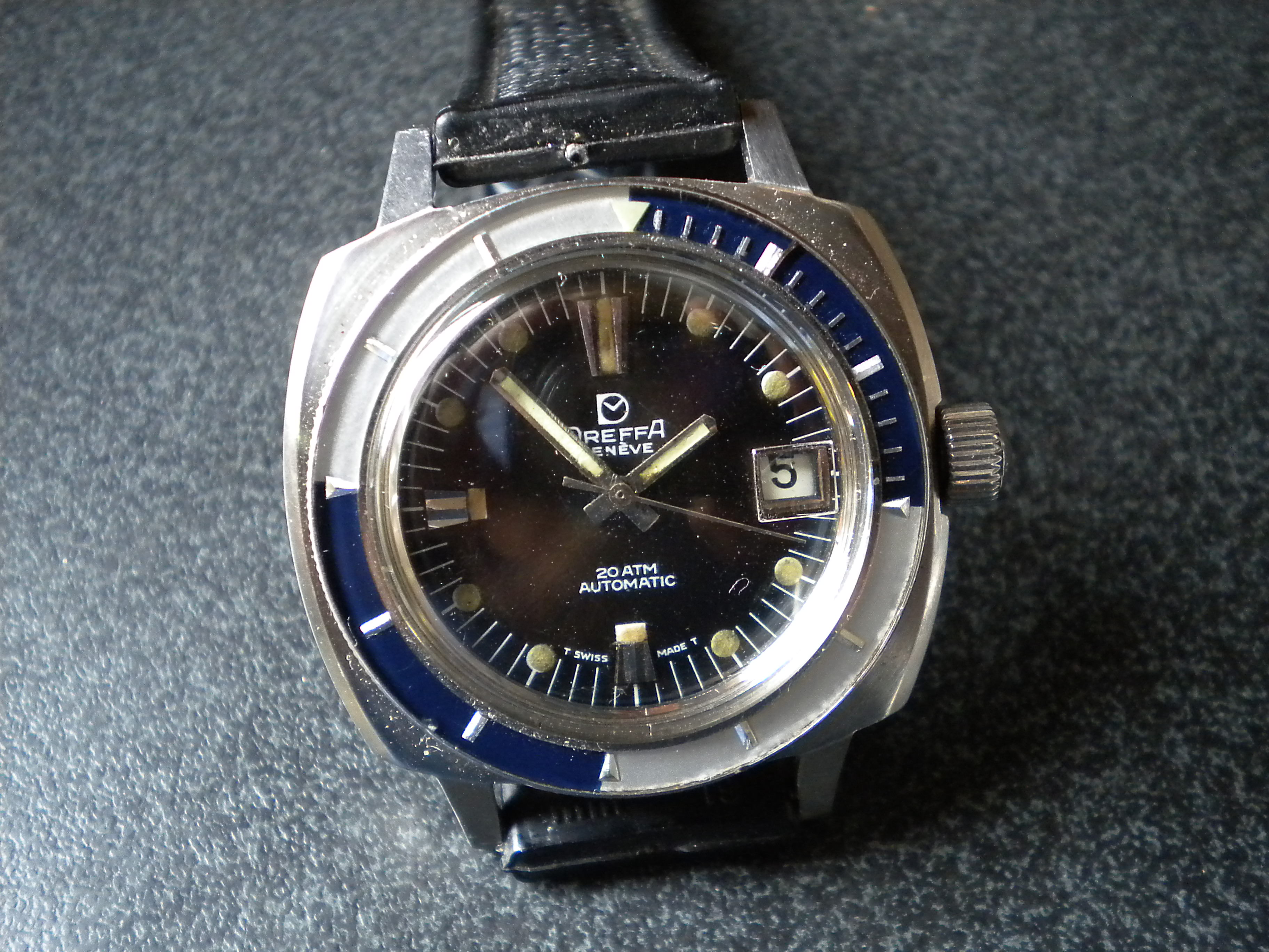

I had this same model Dreffa for a while. Mine had a gun metal gray dial and dark blue and white bezel. There are many iterations of this watch from different makers. The bezel looks good to me. The lume, not so.

I had the same for a while, it's a nice watch to wear, with a lot of character and wrist presence:
Very nice! Yeah definitely different to most of my collection. On the fence about whether to sell on or not, I envision it won't get much wrist time especially as I just got in an Avia Marino diver that I'd been trying to find a good deal on for a while!

Nice color scheme on the bezel, that looks good to me.
