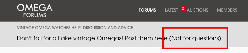

See your other post.
This thread is only for obvious/validated fakes to provide guidance for others.

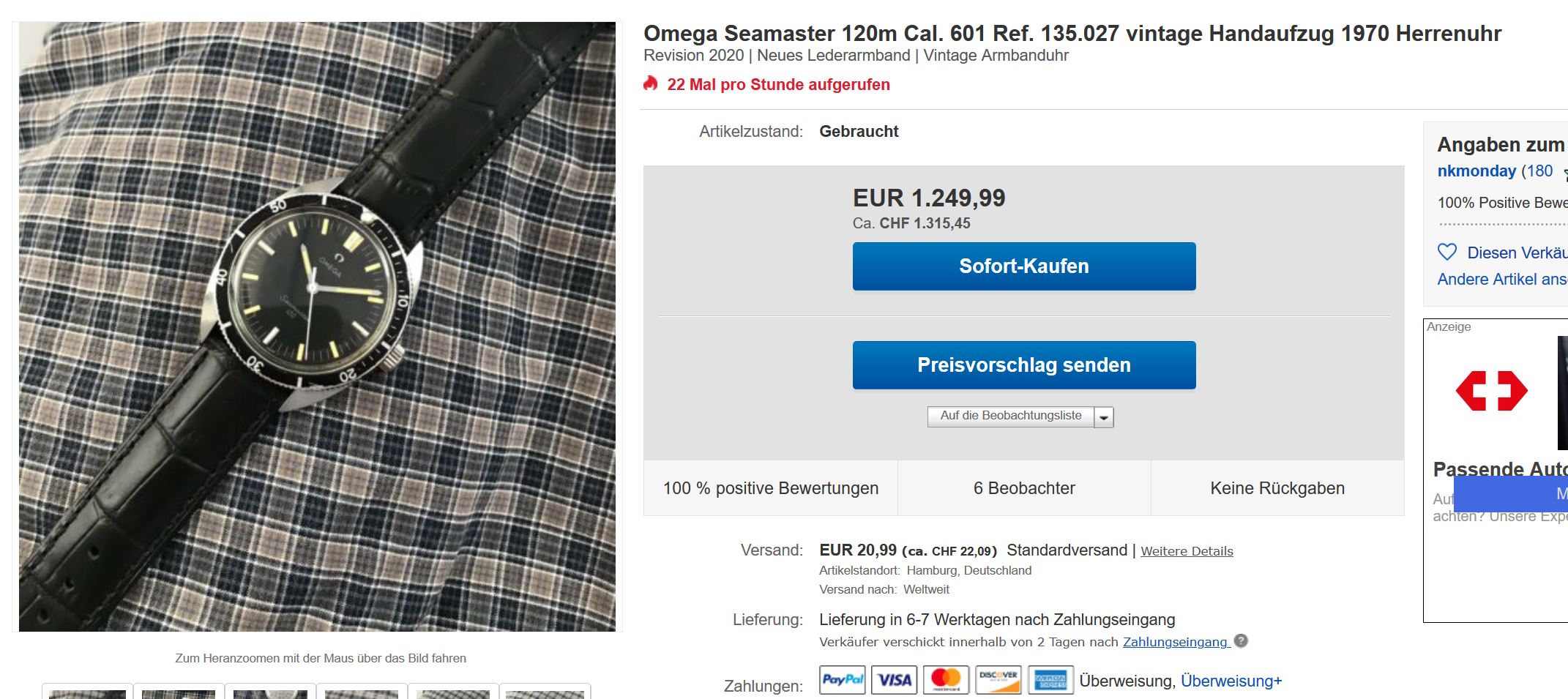

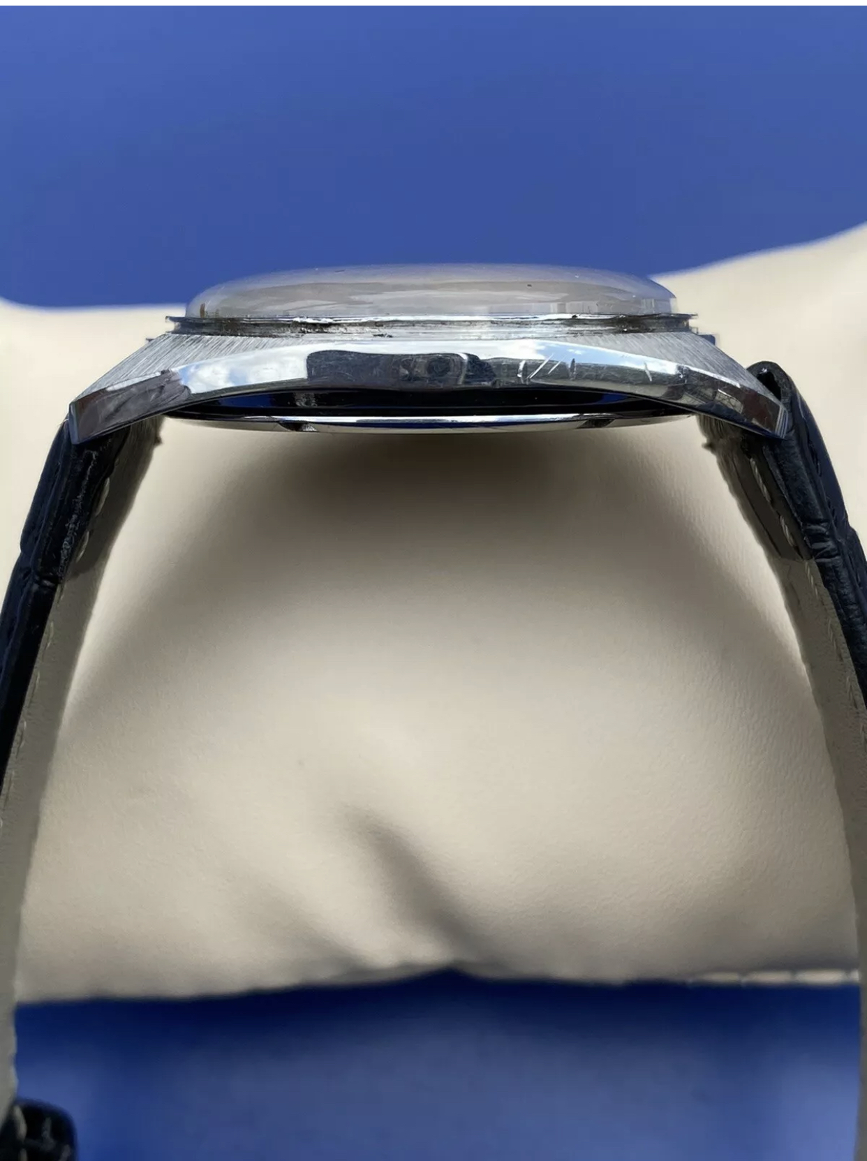

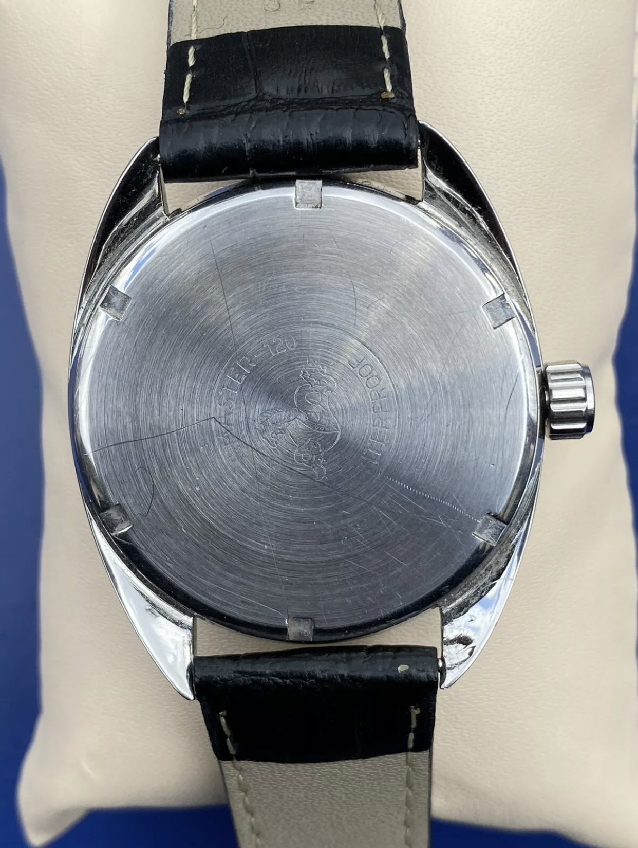

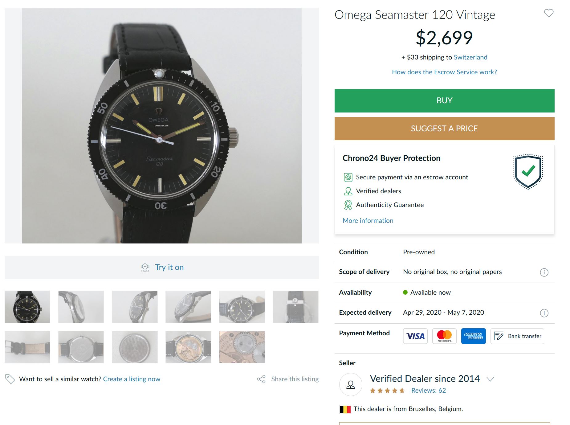

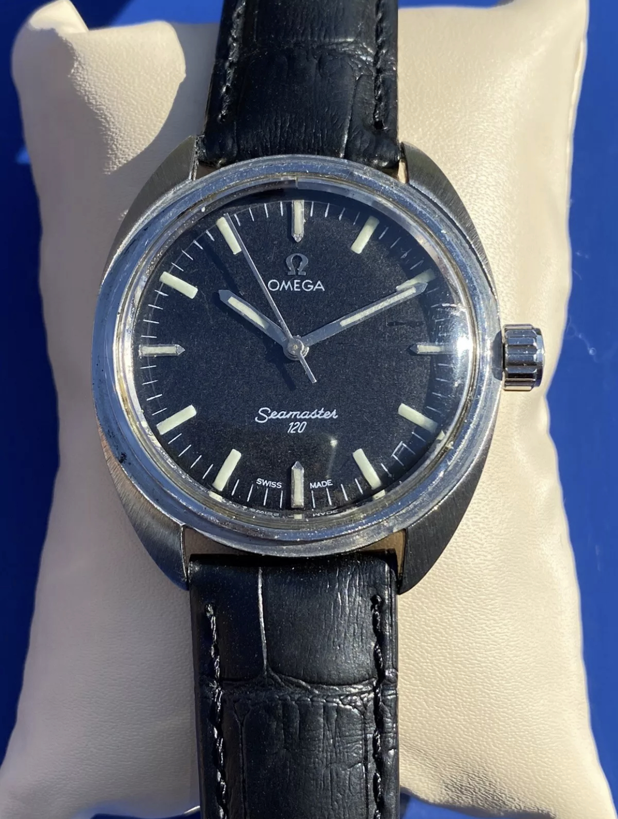

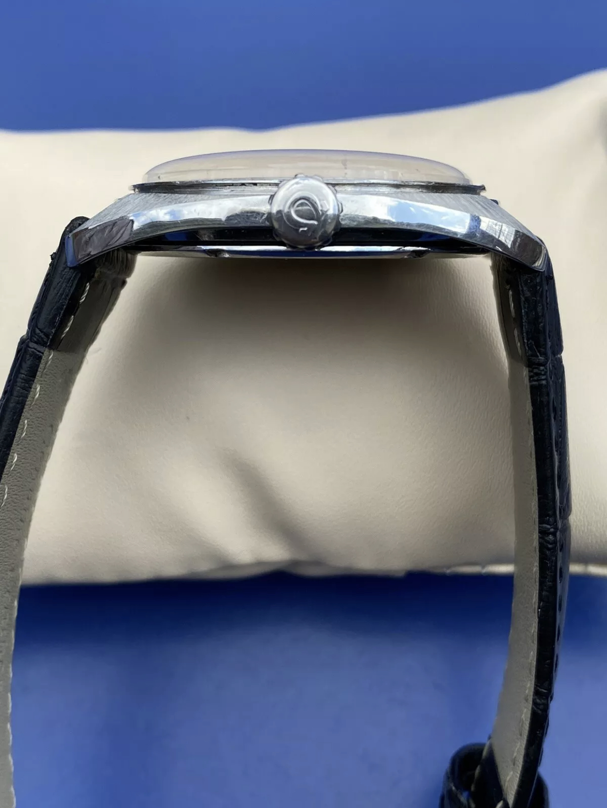

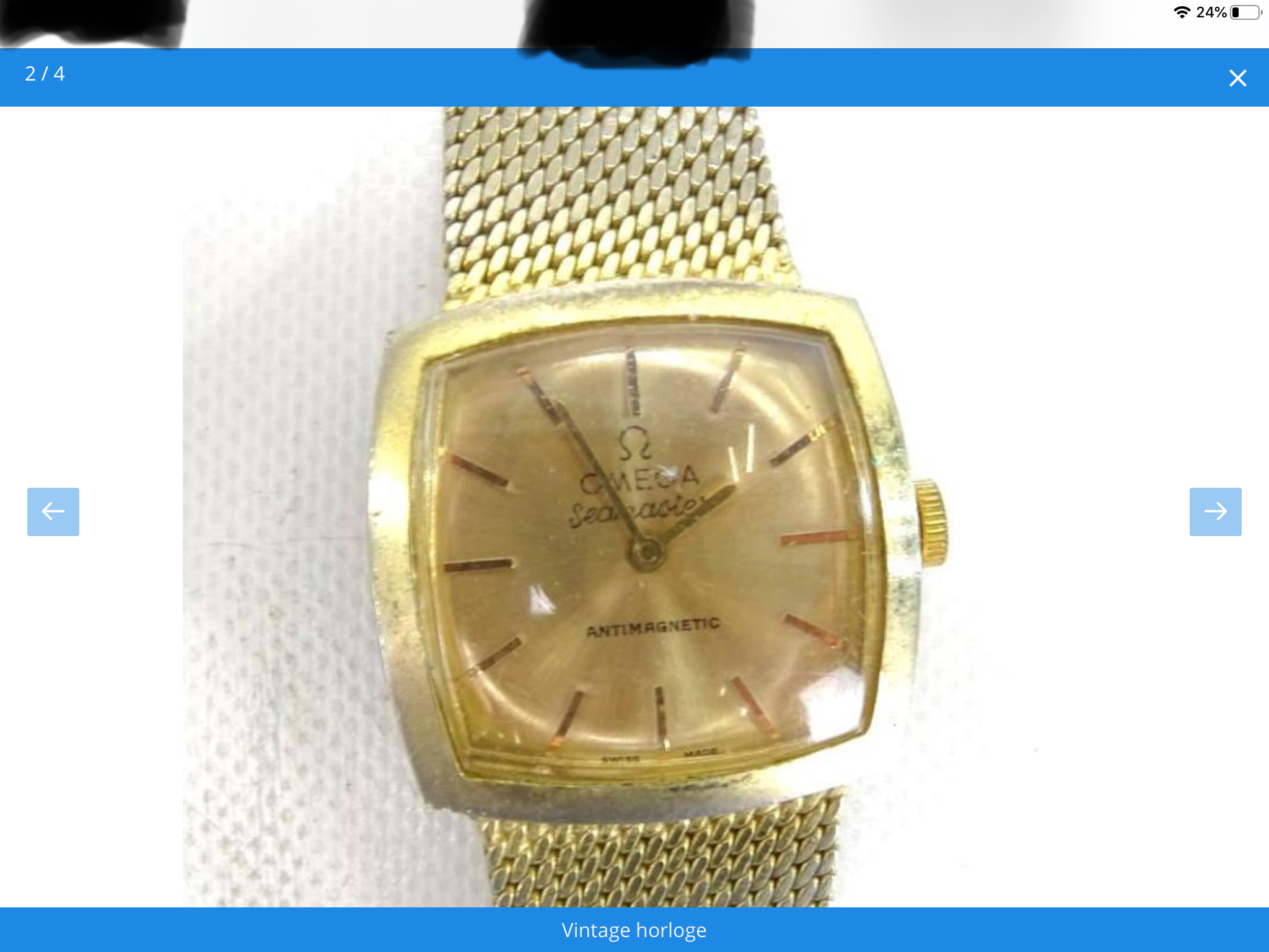

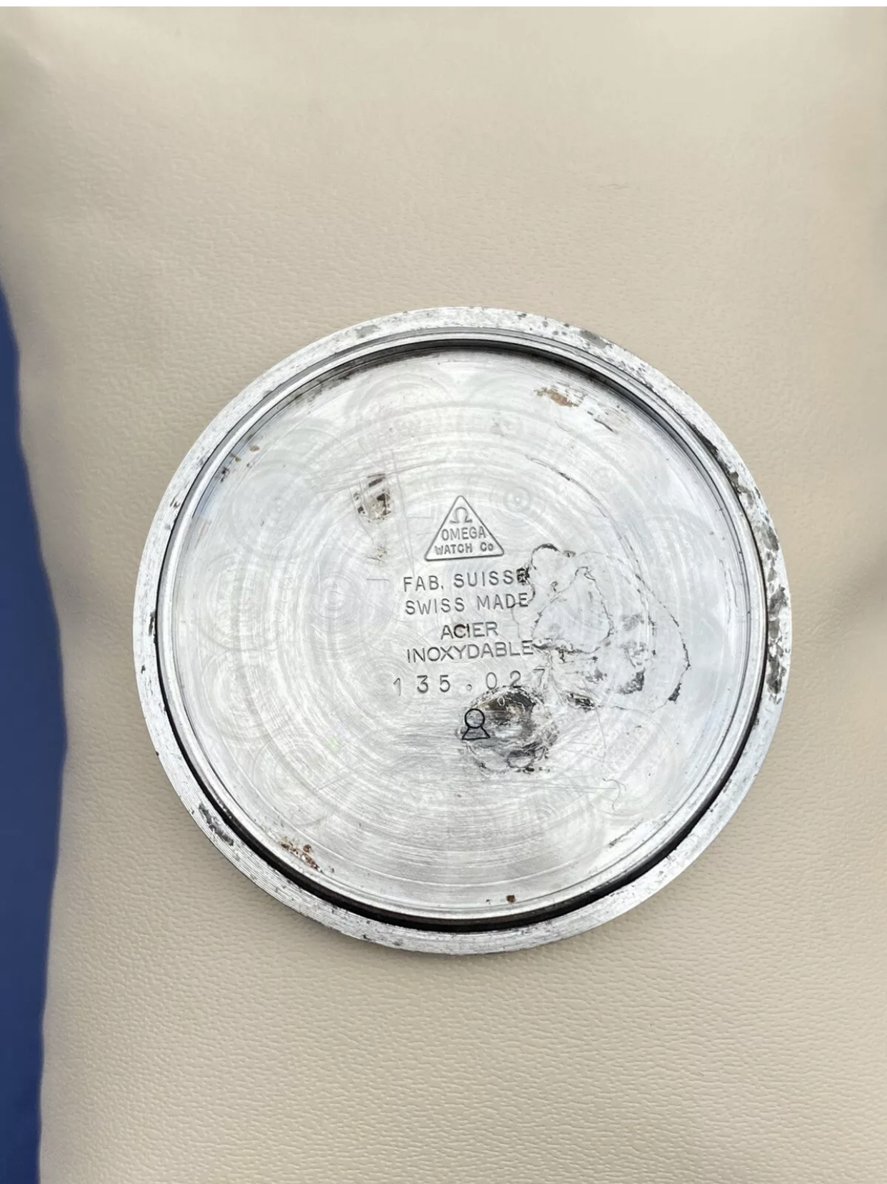

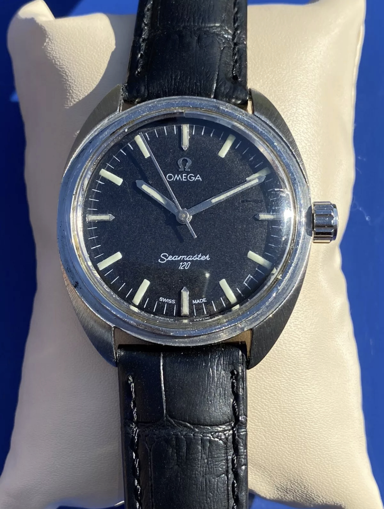

Are you saying this watch is a fake?
Yes, the markers on the refinished dial do not match those from a 135.027 dial, and the mid case seems to be from another watch entirely. Crown and second hand are also incorrect. Looks like a complete franken to me.
I think the movement dates to 1970, which seems like it would be wrong for this reference as well, but I don't feel confident enough to say for sure on that point.
Edit: If I've missed the mark on this one, I will humbly paddle back to the shallow end of the pool.

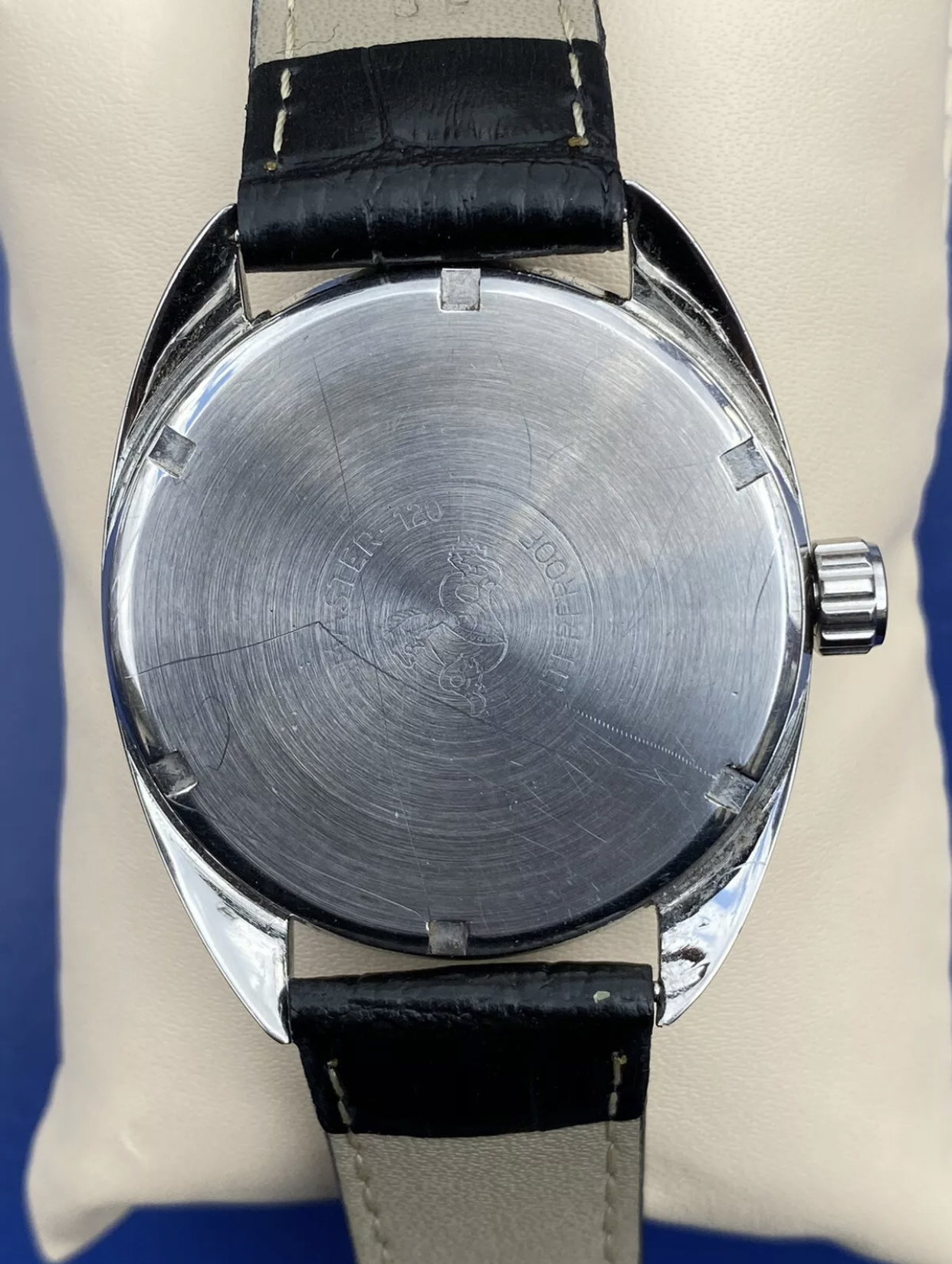

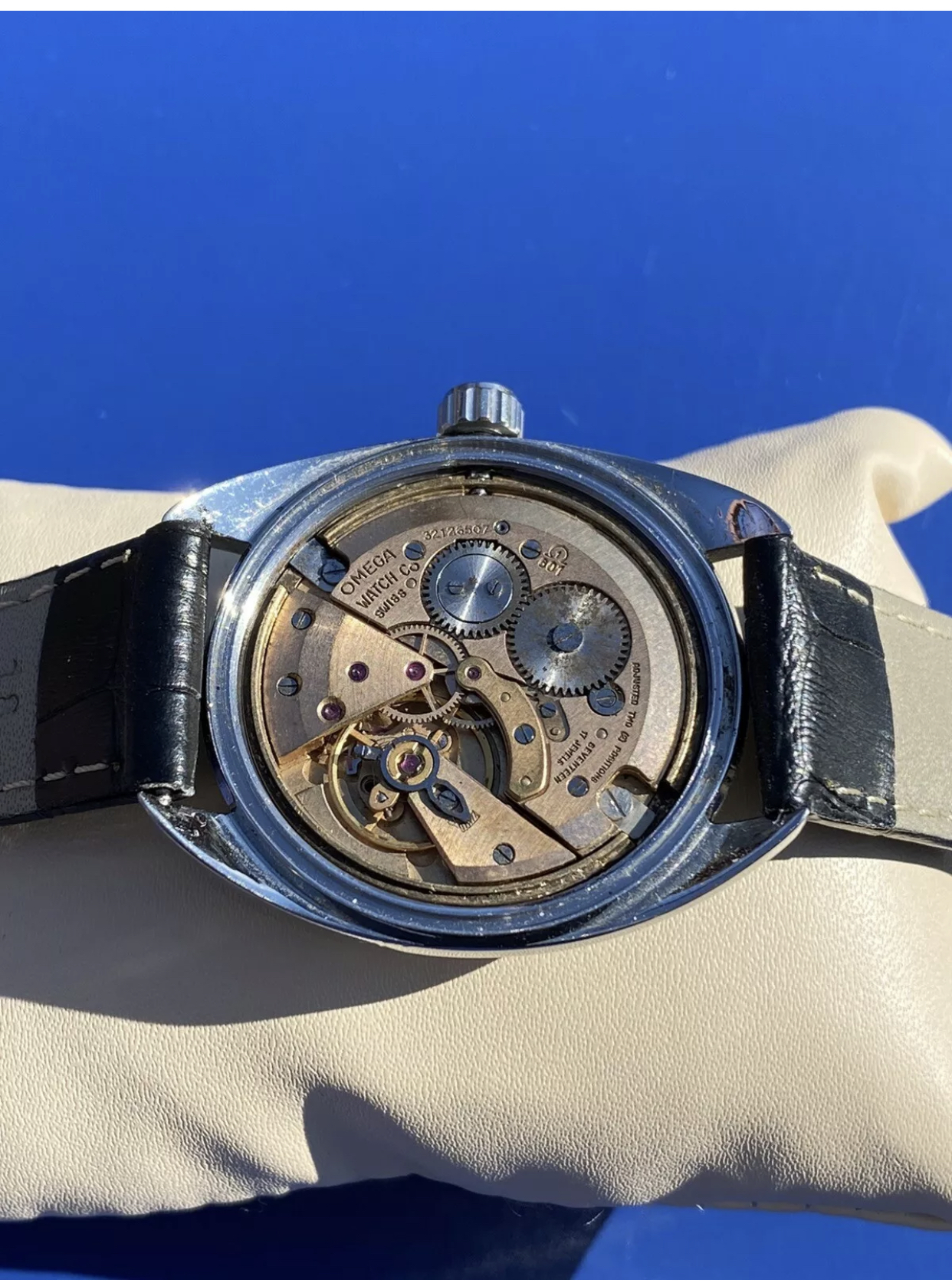

1,060
1,634
I agree, maybe an artificially aged fake, or a kind of franken
never seen a dial with such a "swiss made" (and ugly markers and relume)
overpolished case (can't say if fake)
possibly a fake caseback (artificially aged)
wrong (fake?) hands
wrong crown
correct movements are 25M to 27M, not 32M (although often swapped during service)
not worth a penny anyway

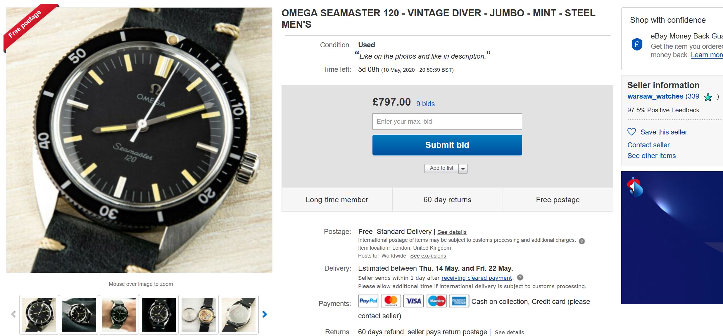

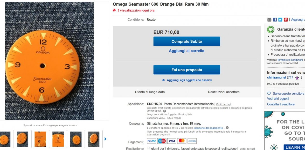

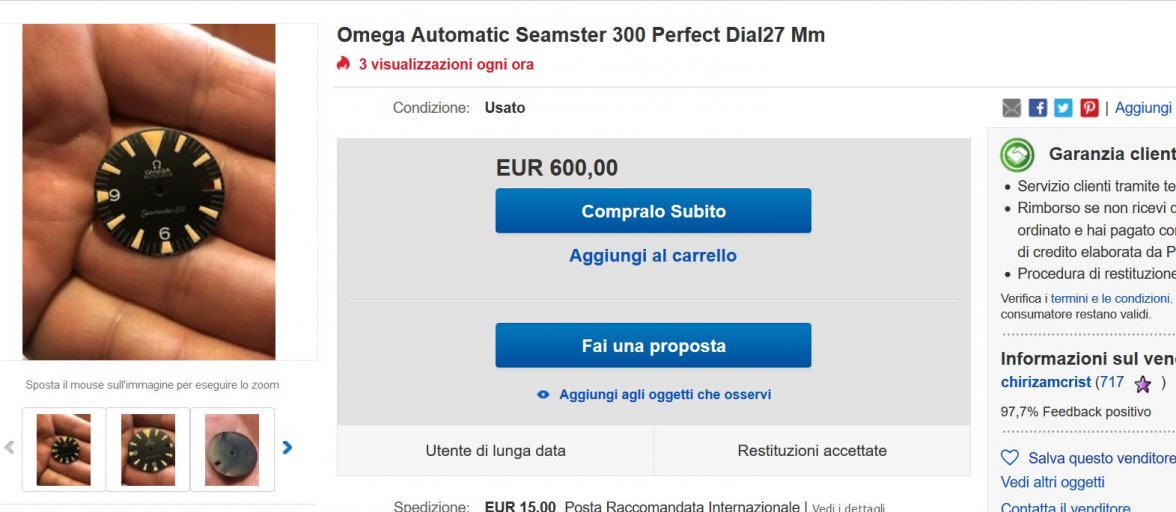

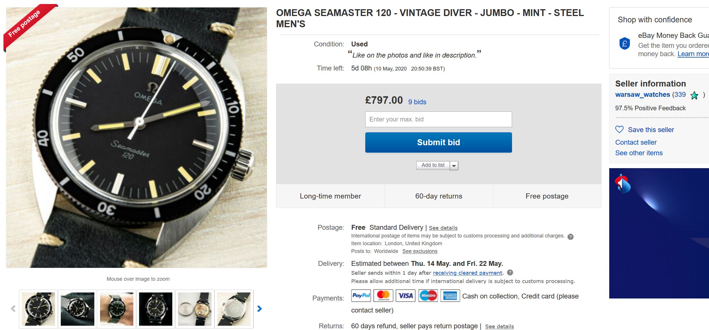

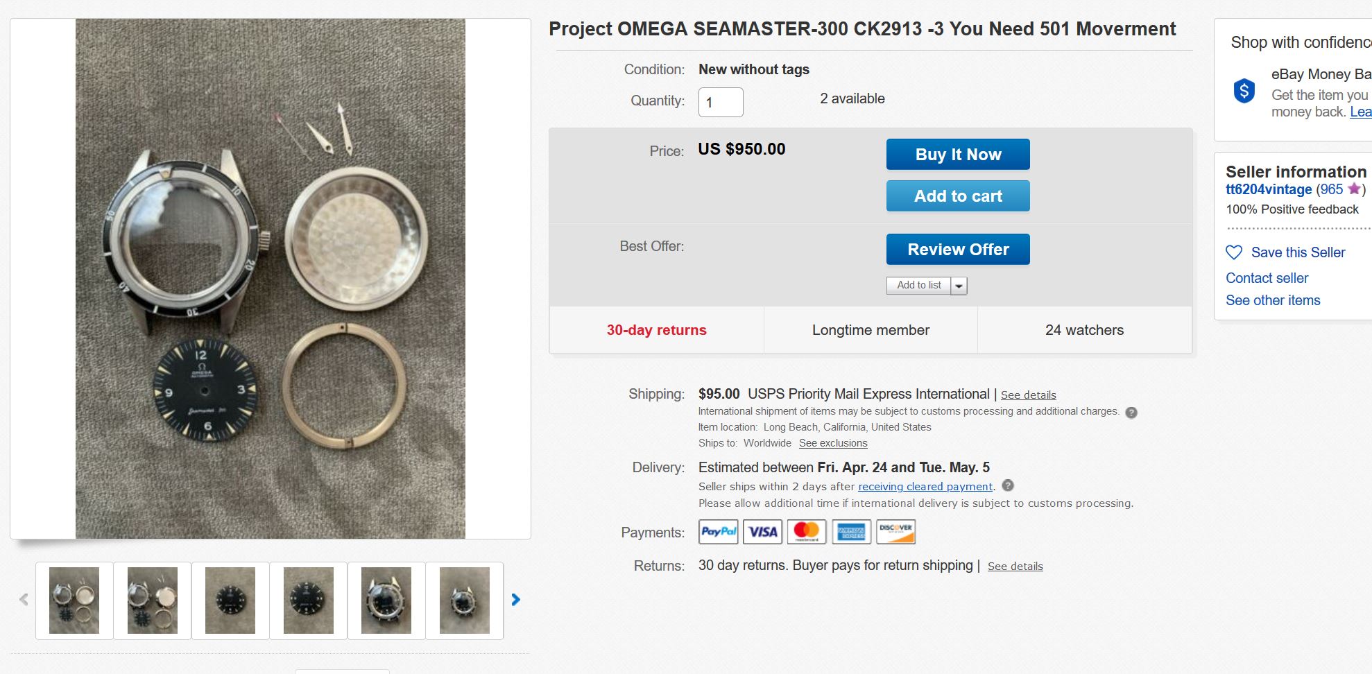

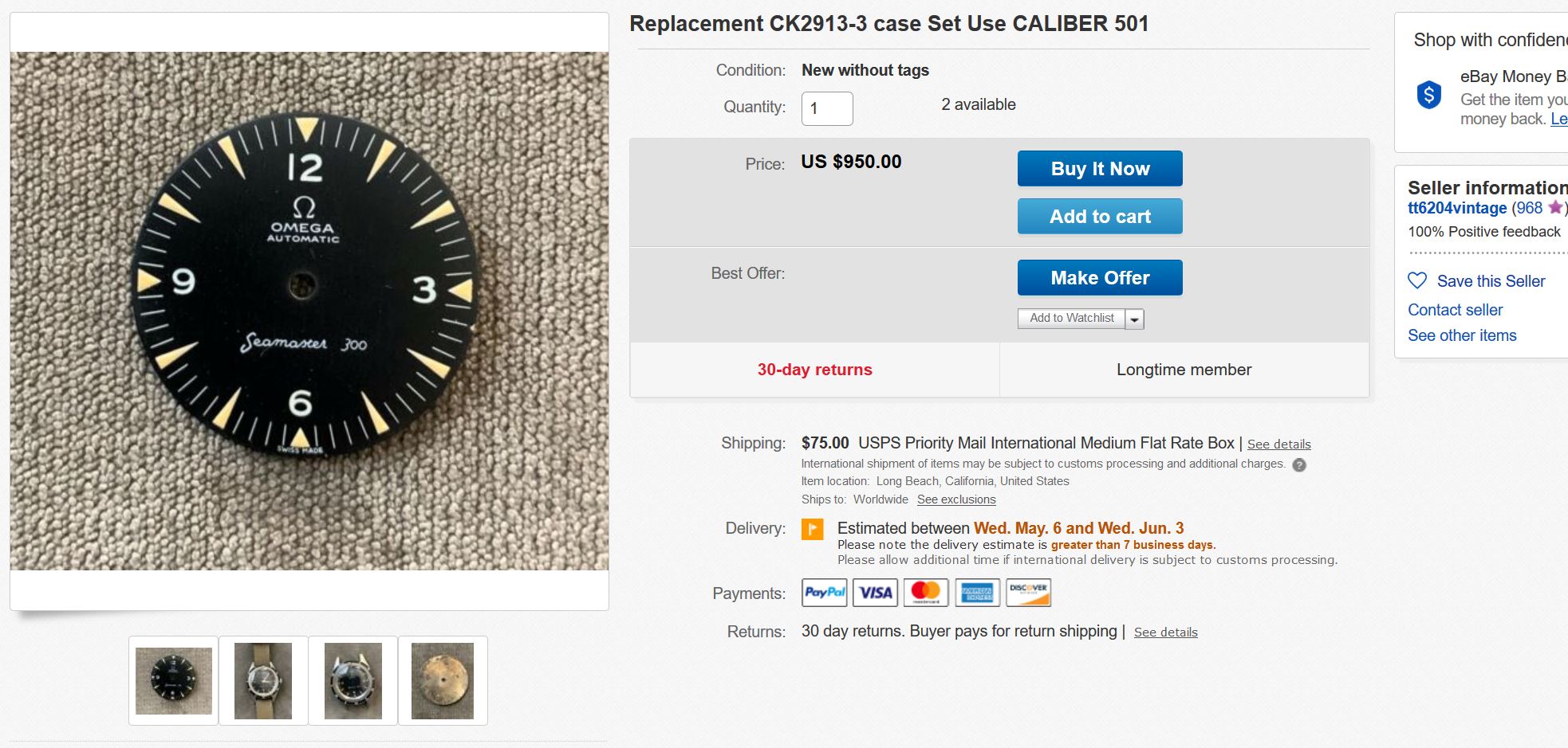

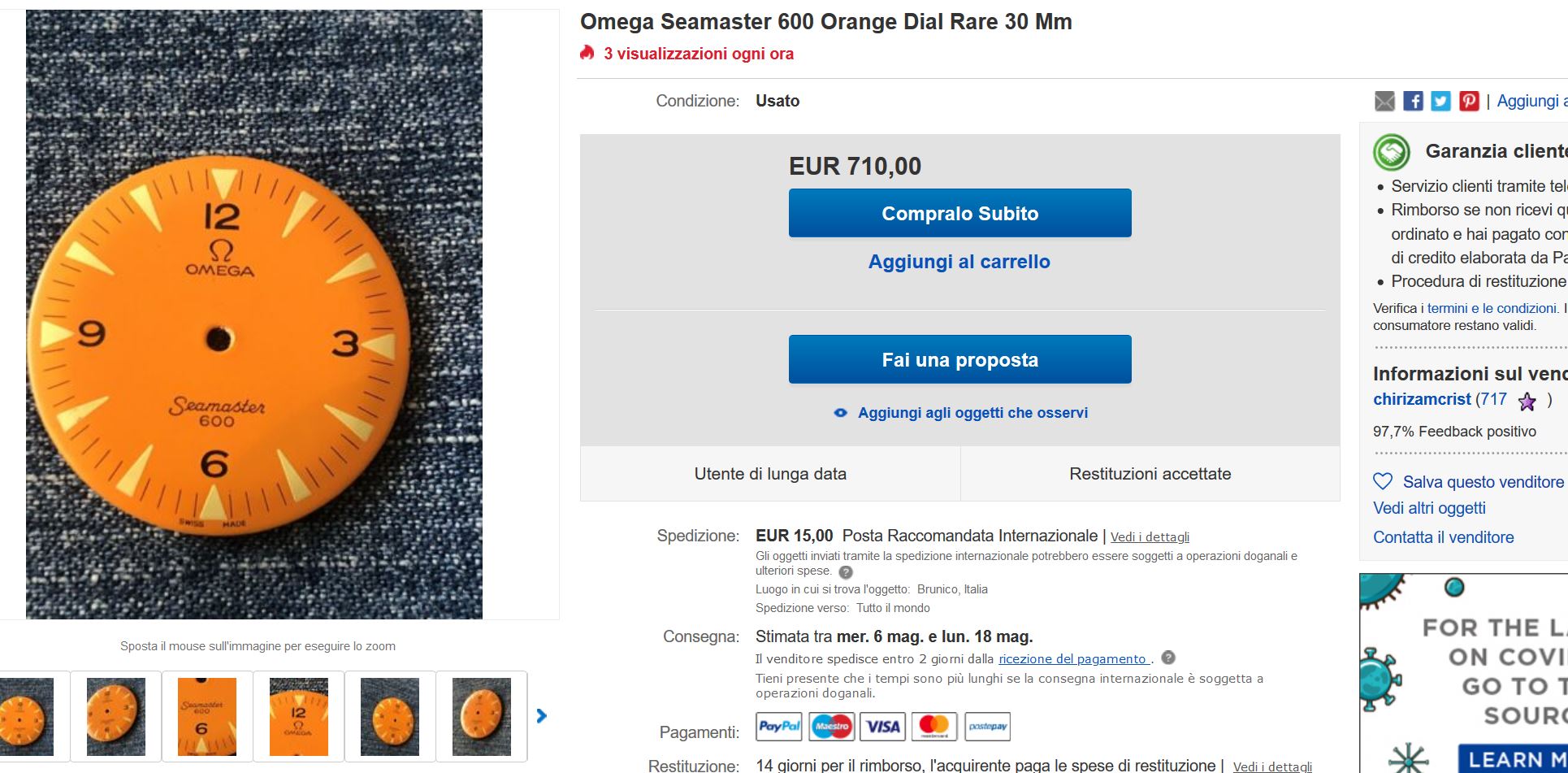

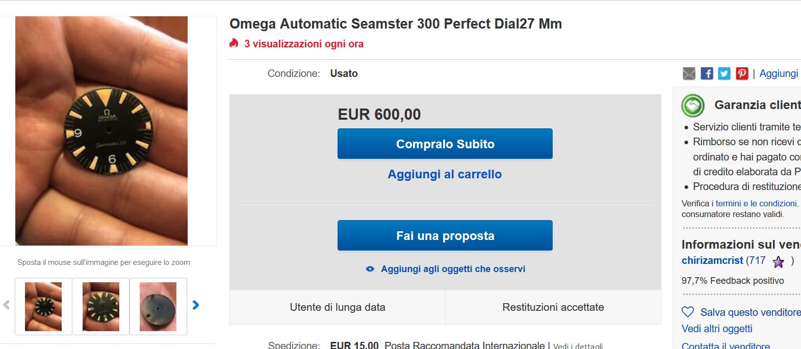

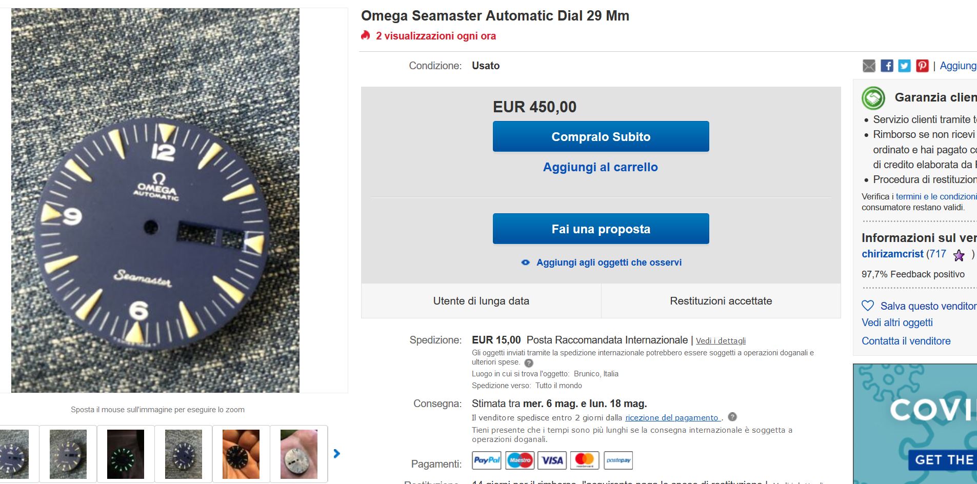

A new arrival of fake dials
Seller: chirizamcrist (717 iconPurpleStar_25x25.gif ) from Brunico Italia
https://www.ebay.it/itm/Omega-Automatic-Seamster-300-Perfect-Dial27-Mm/264713491017
https://www.ebay.it/itm/Omega-Seamaster-Automatic-Dial-29-Mm/264713486852
https://www.ebay.it/itm/Omega-Seamaster-600-Orange-Dial-Rare-30-Mm/264713471382

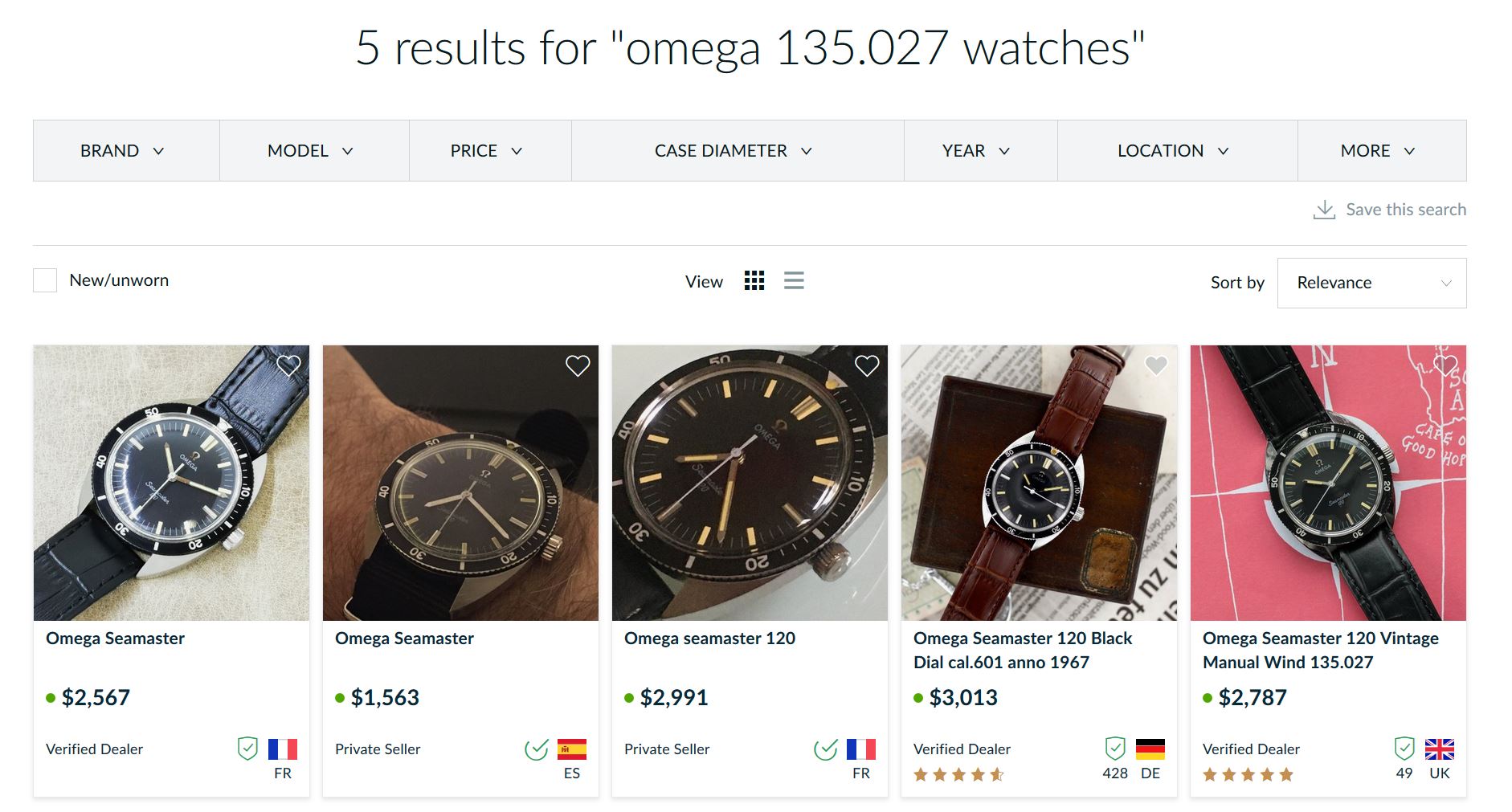

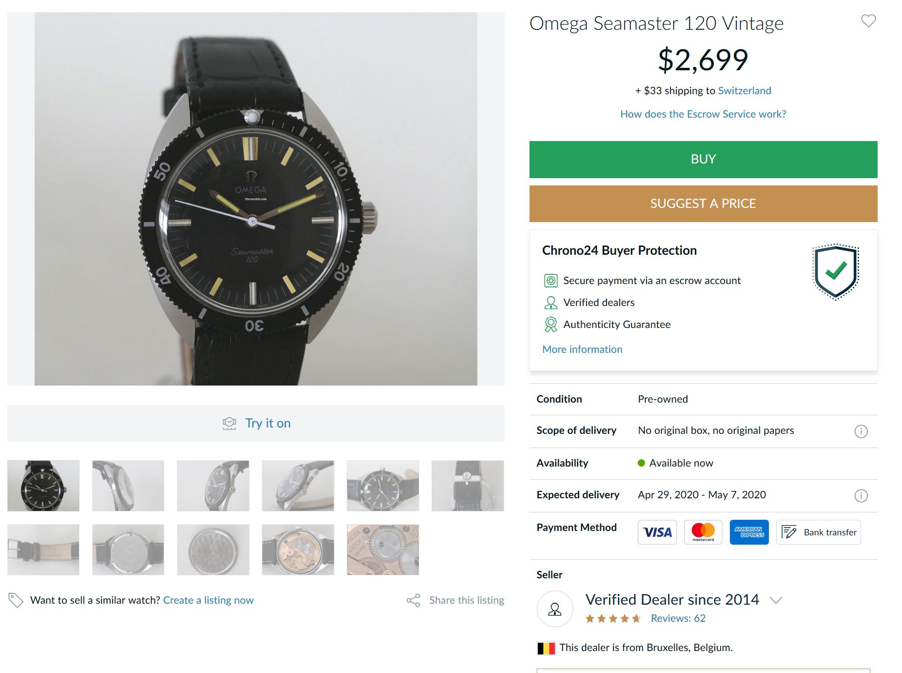

Chrono24 obviously does not care about selling fakes

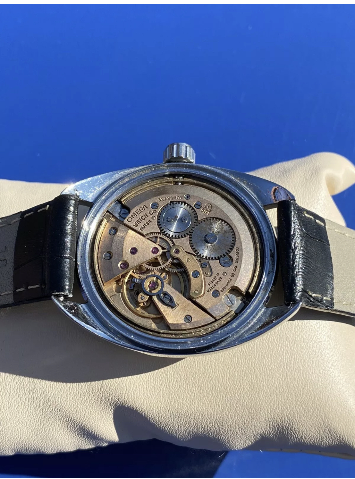

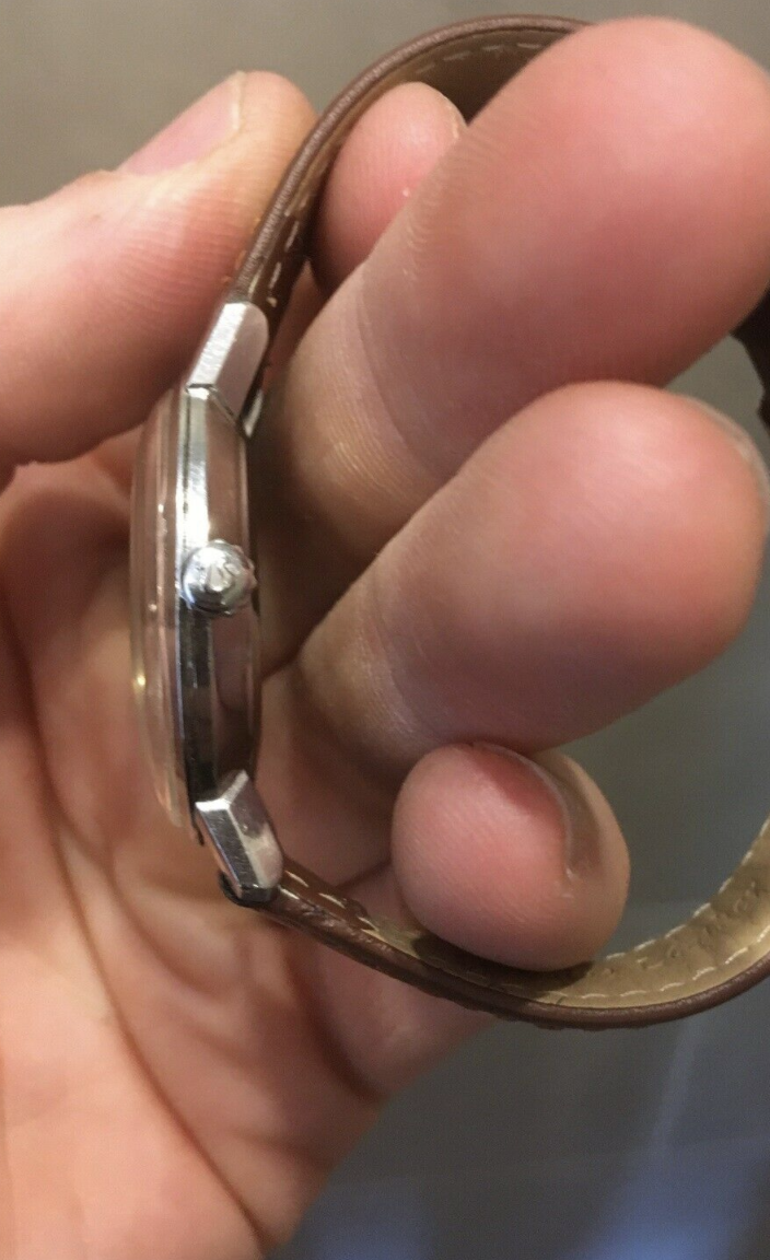

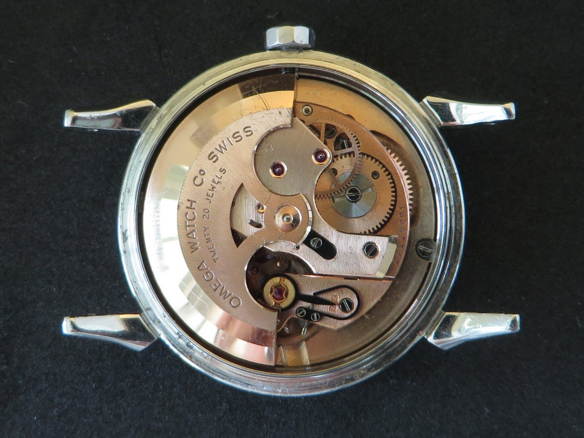

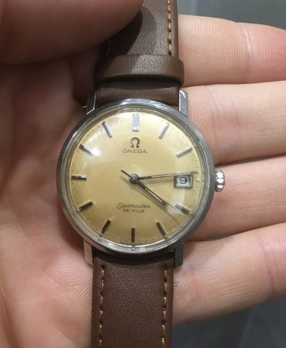

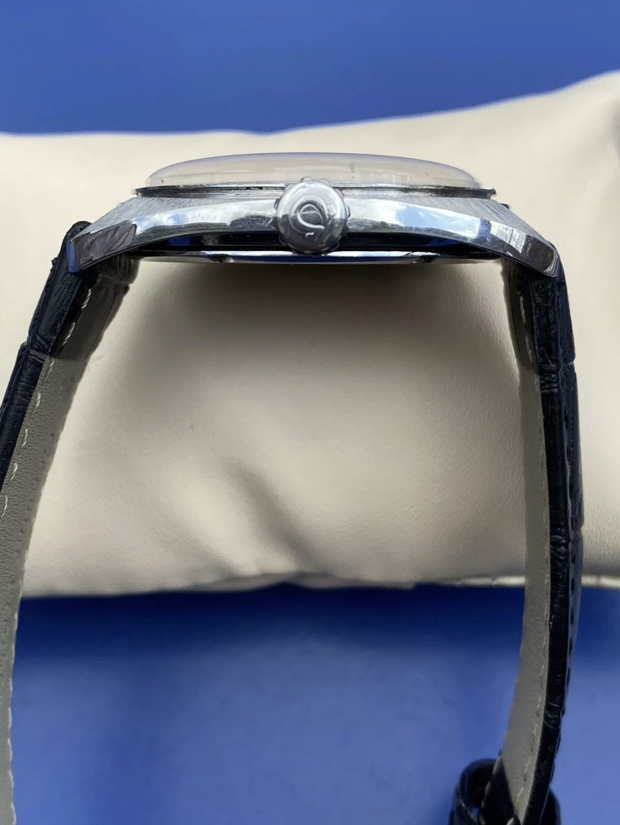

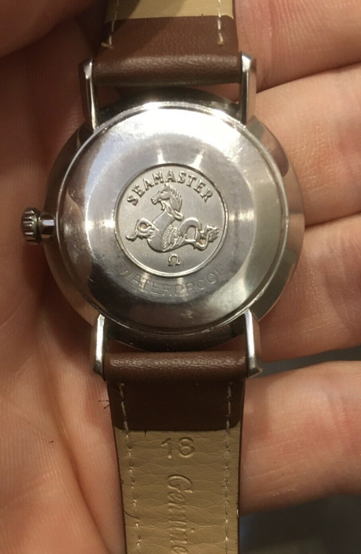

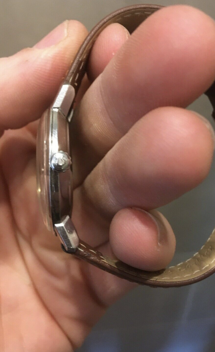

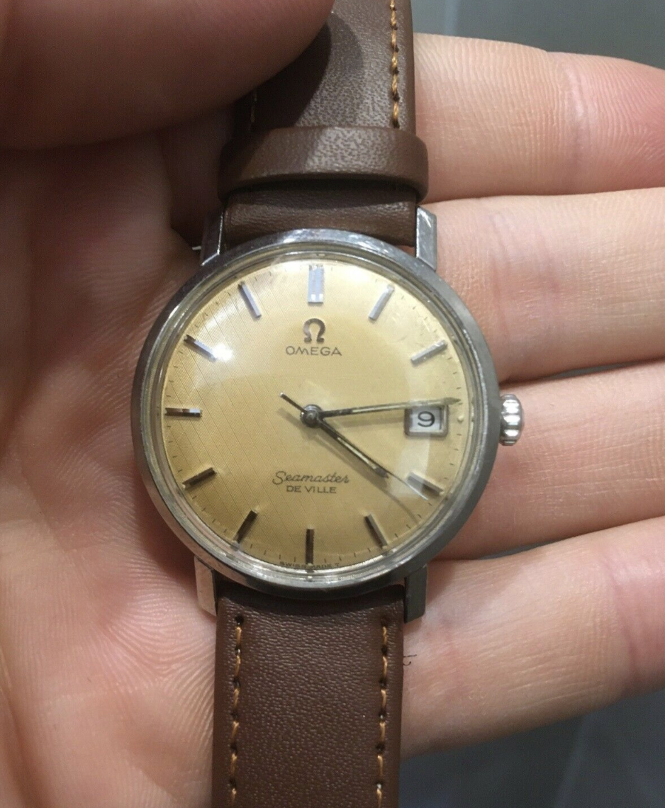

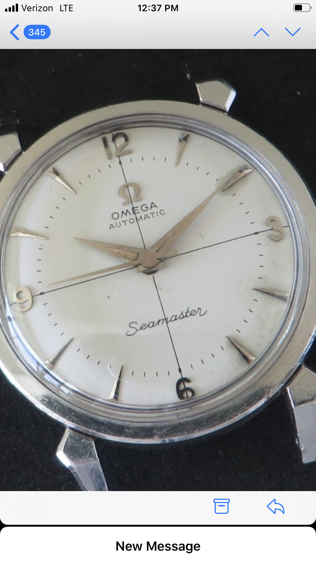

Can someone please help me with this?
1964 Omega De Ville
Ref: 136.020
Caliber: 611
Original Omega glass
Original Omega crown.
Is it real?
1964 Omega De Ville
Ref: 136.020
Caliber: 611
Is it real?
