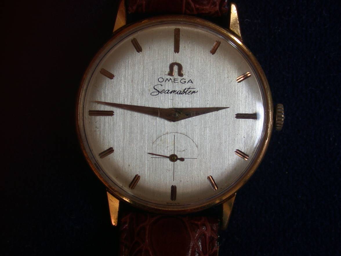

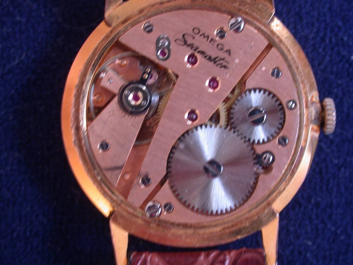

It does look like it is smiling though and that EB movement is crap and hard to service.
35,791
40,069
Lost for words!
http://www.ebay.co.uk/itm/Reloj-UNI...?pt=ES_Relojes_de_pulsera&hash=item5b05dd1380
77147
77148
I'm not even sure what to say about that other than that the lemon who made that deserves a bayonetting

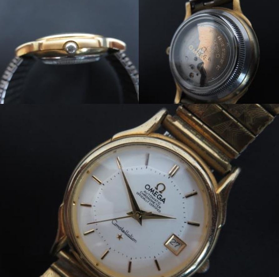

15,046
24,049
But its got 23 Jewels 👍

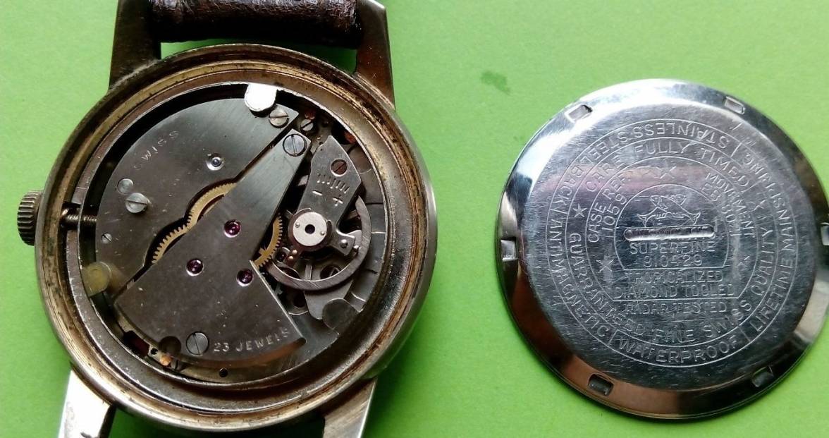

8,192
36,783

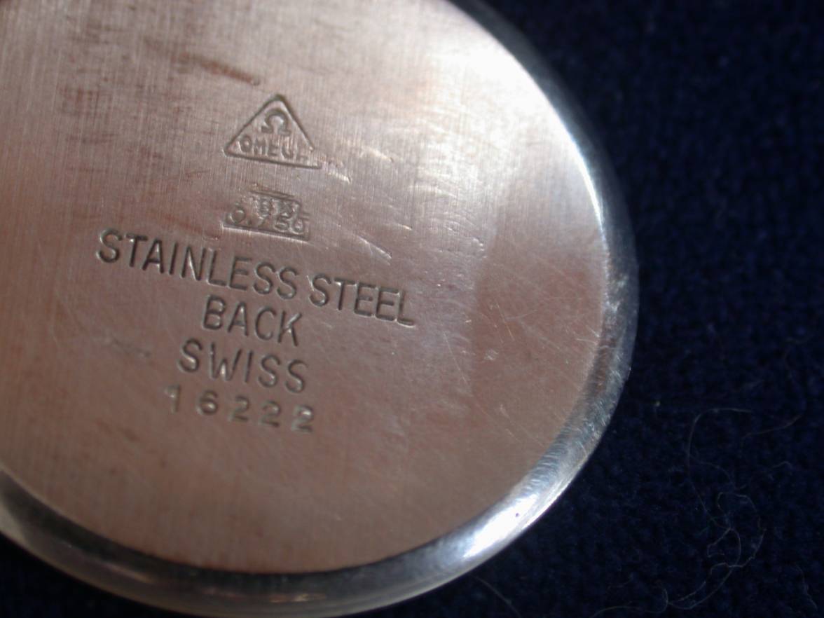

So funny I was just looking and laughing at this one.
Full marks for effort on that back case though, ` Superfine, tropicalized, diamond tooled and radar tested!` 🤦

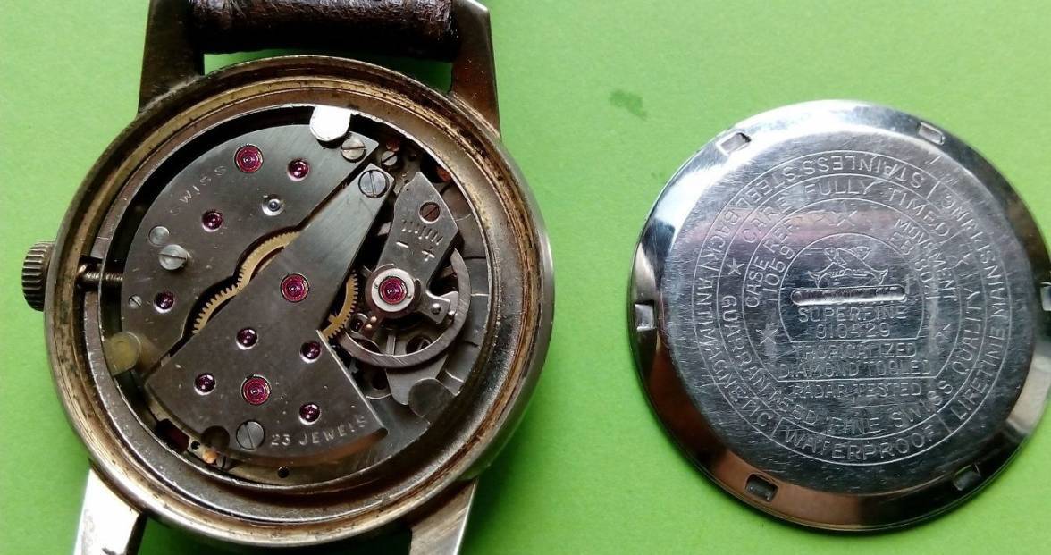

35,791
40,069
"Care Fully Timed" too

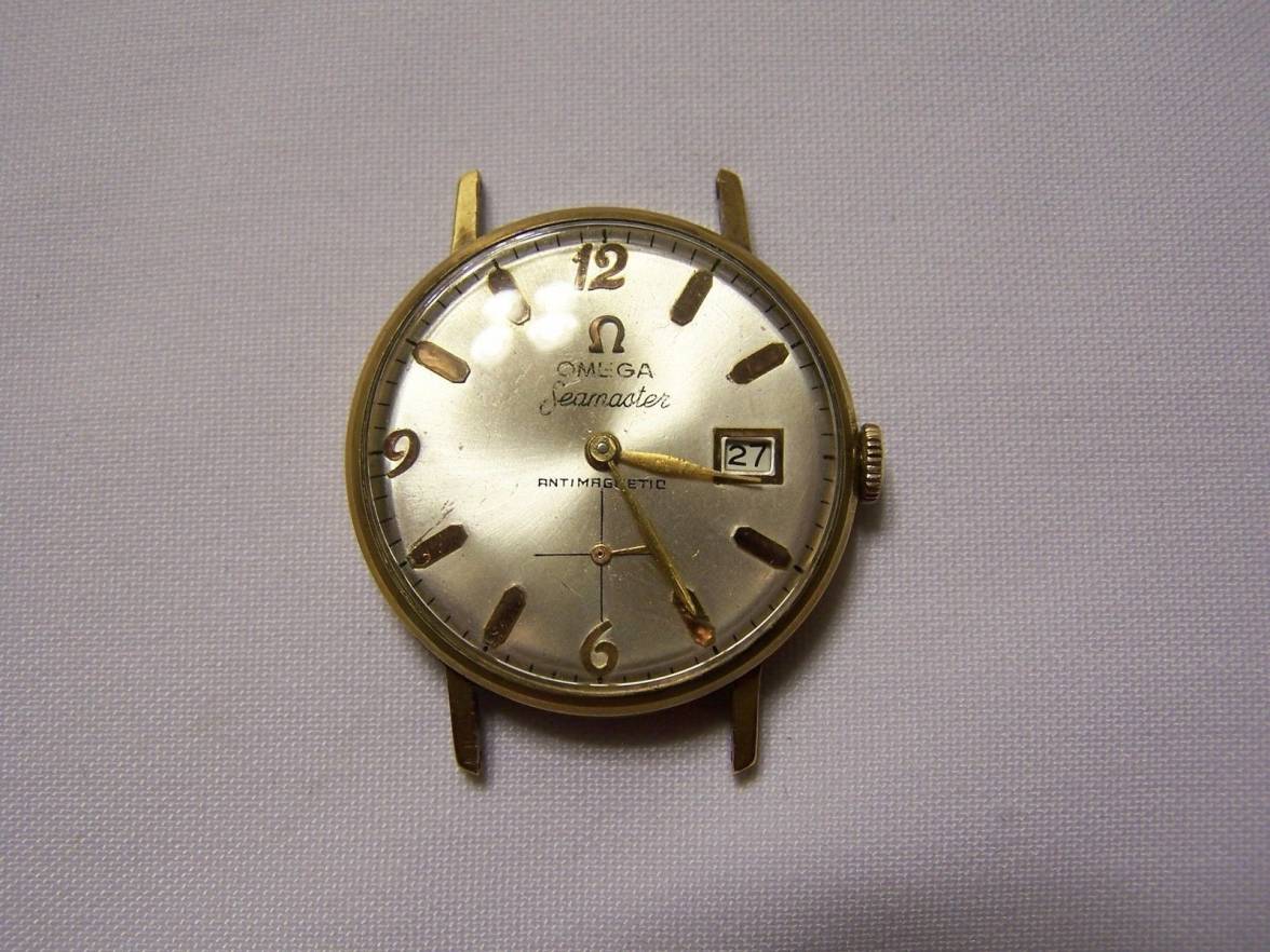

I am a newbie with Omega especial with Vintage. Today, I am searching on the internet and get this one, please help me inquiry this Vintage Omega Seamaster Cal 562. This guy want to sell it for 450$, that's acceptable price for this one?, does it real one or fake? Please help me because this is my first watch. Thanks a lot.
Thank all for everyone.
1,634
1,125
Sairy, is that watch coming from India, by any chance? To me, although real, it's got all the hallmarks of a 'Mumbai special' - repainted dial, a heavily patinated date wheel and a movement that looks like someone's used a chisel on it. I wouldn't.
18,866
39,249
Movement looks like it was serviced by a gorilla on smack using a cold chisel.
You'll be better off looking at our FS forums.
21
16
So that means this not good now? I can make decision, maybe I must move on some watch easy to buy. T.T

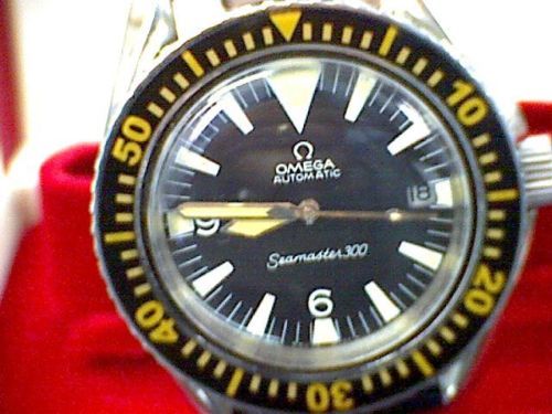

Here is the lesser known cousin of the famous "MISSONS" Speedy, the CERTIFED" Seamaster: Fortunately, I can't save the picture at a larger size:
http://www.ebay.co.uk/itm/Gents-Omega-Seamaster-300-Watch-/121451815138?&_trksid=p2056016.l4276
78231
Note also the lovely lemon bezel - fitting because this certainly is a lemon.
78232
All Original Except Strap
Original counterfeit parts...

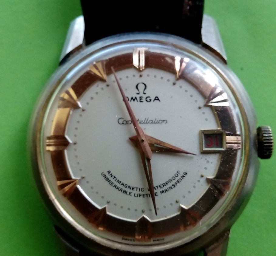

I'm new to vintage watches. I just bough this assuming it was real. Any ideas?
These are the eBay photos. Watch hasn't arrived yet.
Thanks.
Thanks.
This is a genuine watch.
