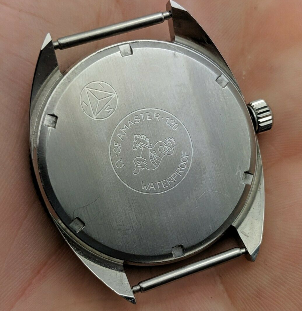

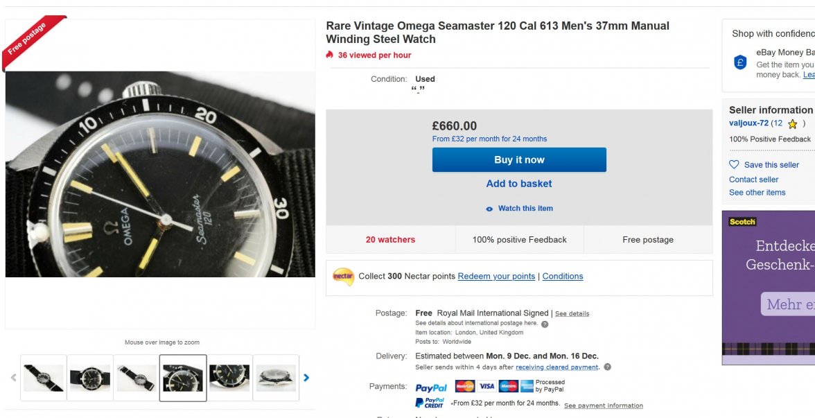

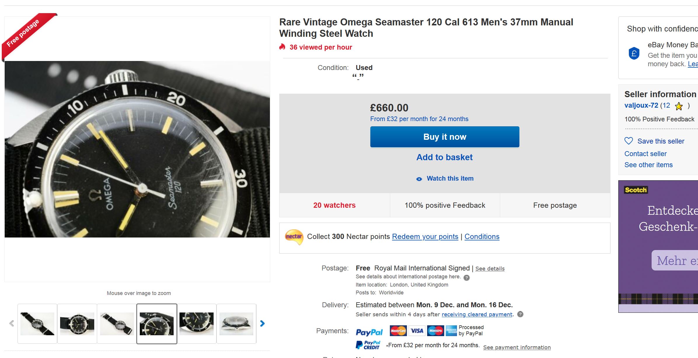

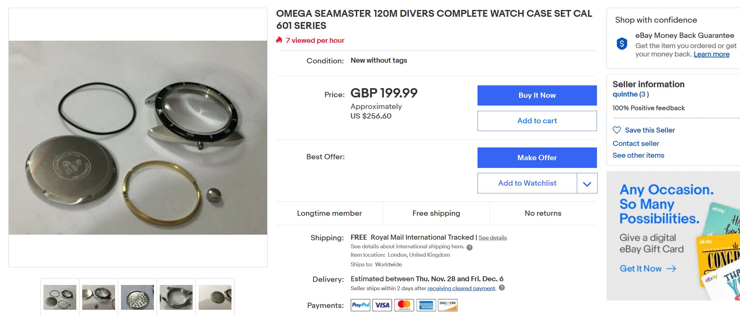

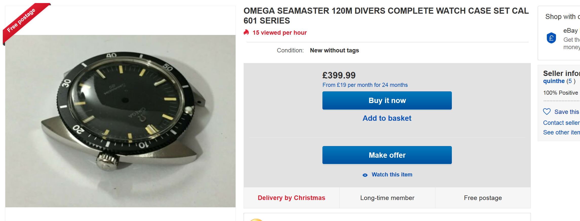

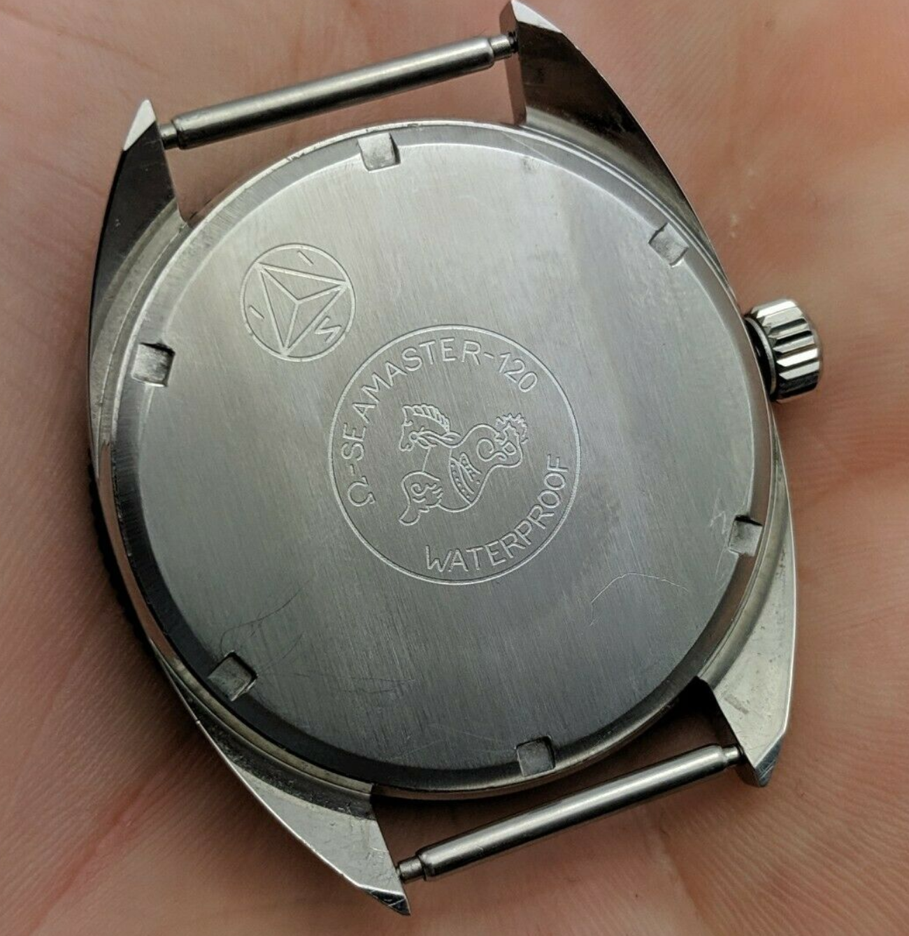

Artificially aged fake seamaster 120 for black friday !
valjoux-72 (12 iconYellowStar_25x25.gif )
https://www.ebay.co.uk/itm/Rare-Vin...480203?hash=item5228c77b8b:g:WVYAAOSw9KBd4K6h

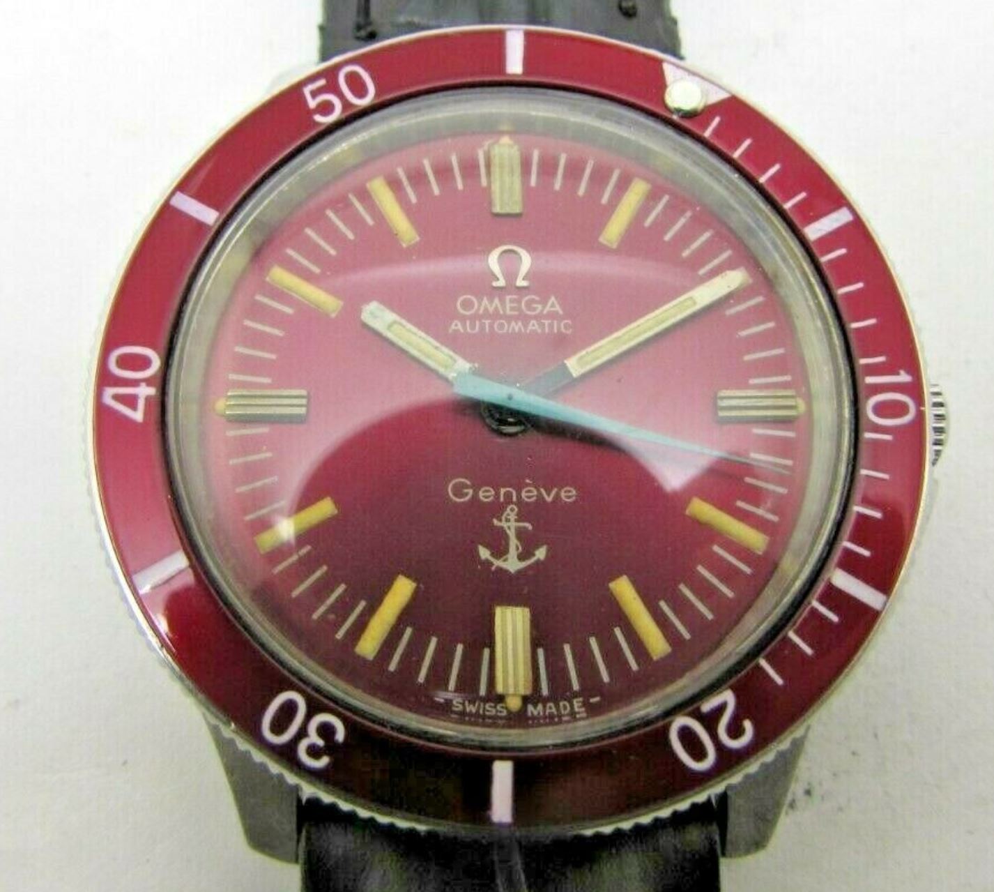

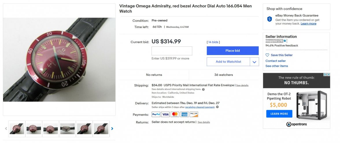

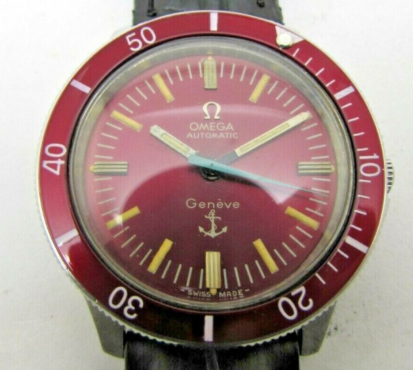

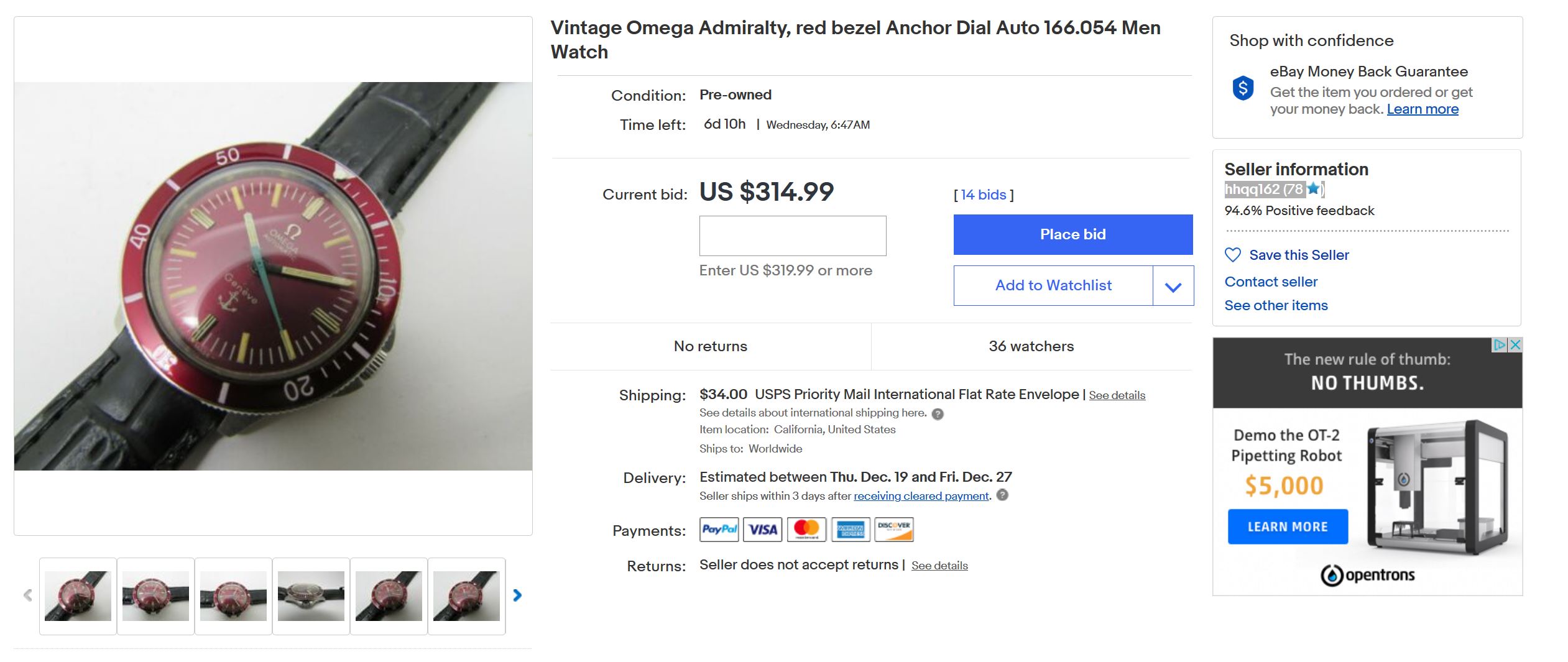

Fake&franken specialist xtime99 (72 ) from South California is back with a fake admiralty red ancoretta that was never produced by Omega!!
https://www.ebay.com/itm/274087097342
he sold similar ones with blue dial in the past
Bezel is fake
Case, caseback, crown are fake (not even similar to real one)
Hands are fake
DIAL DOESN'T EVEN EXIST FOR REAL: the automatic no date "ancoretta" does not exist (would be the 165.054), it does exist as automatic+date 166.054 with 565 caliber or manual+nodate 135.042 with 601 caliber (all serial range is 29M to 30M 1970-1971)
That watch is automatic NO date 550 caliber 18M (1961) with date 166.054 case reference... a model never produced by Omega
it's back, see above
Same fake seller, other account !! hhqq162 (78 )
https://www.ebay.com/itm/Vintage-Omega-Admiralty-red-bezel-Anchor-Dial-Auto-166-054-Men-Watch/184069303694?ssPageName=STRK:MEBIDX:IT&_trksid=p2060353.m1438.l2649

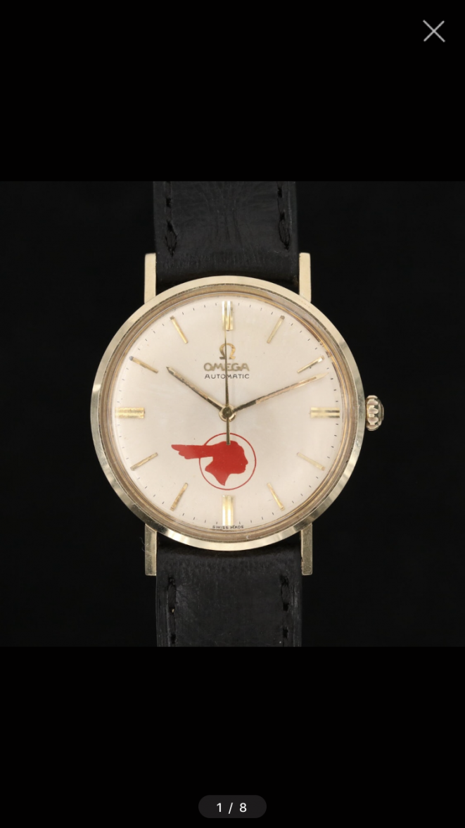

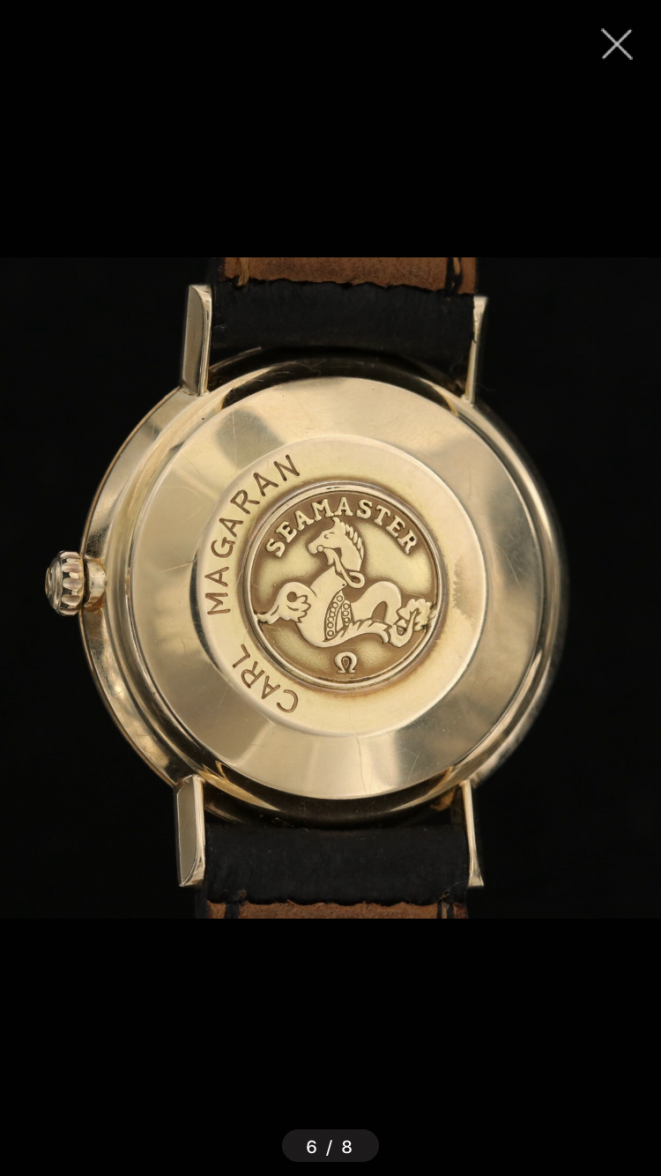

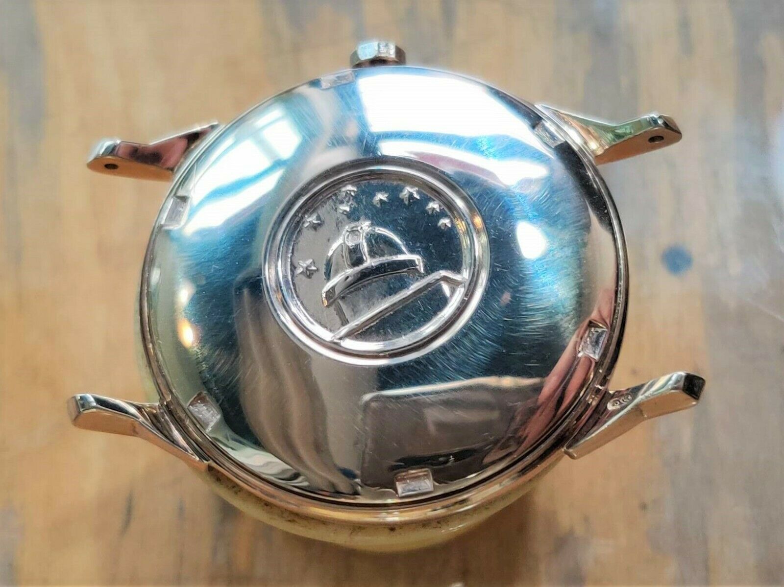

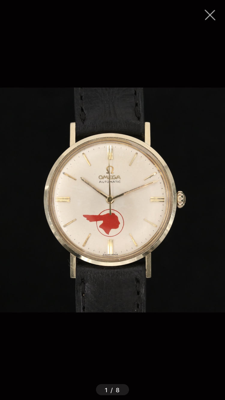

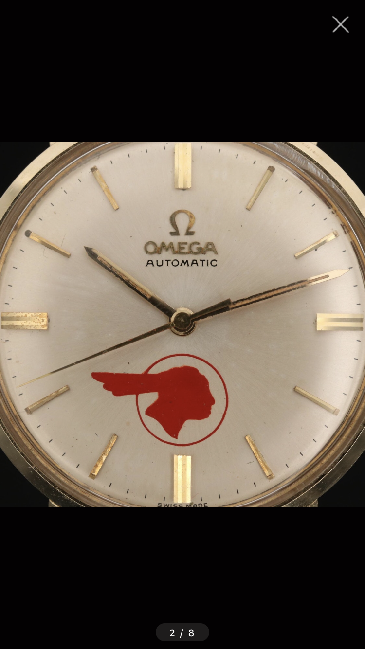

Hi all,
looking at an early-mid 60’s Seamaster Deville
Looks like it probably was a Pontiac dealer issued watch. No pictures of movement. I think this one is front loaded. Thanks!
