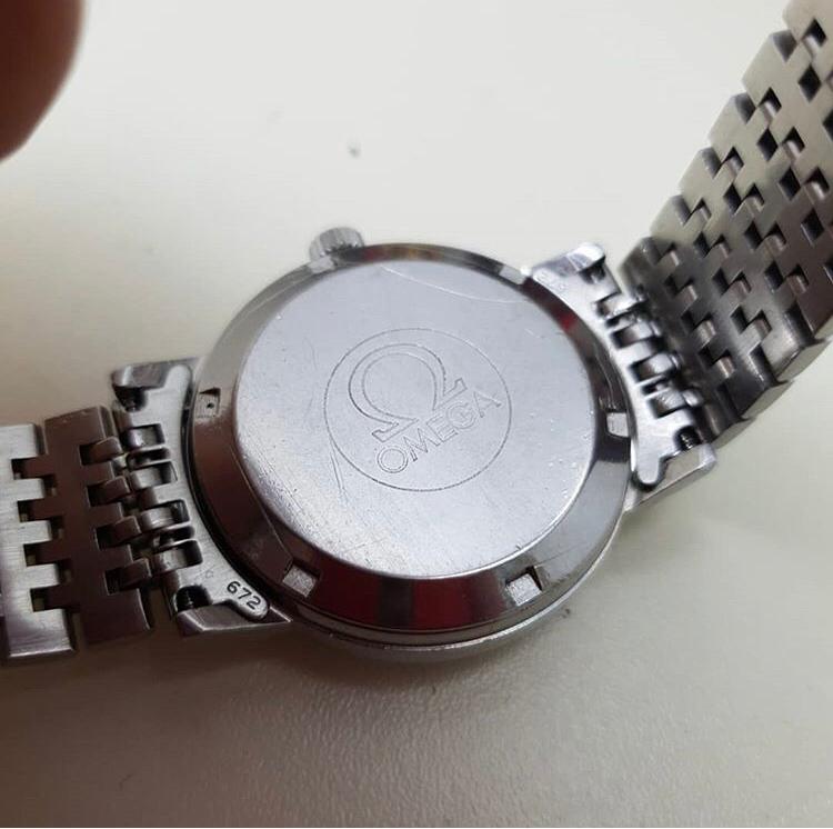

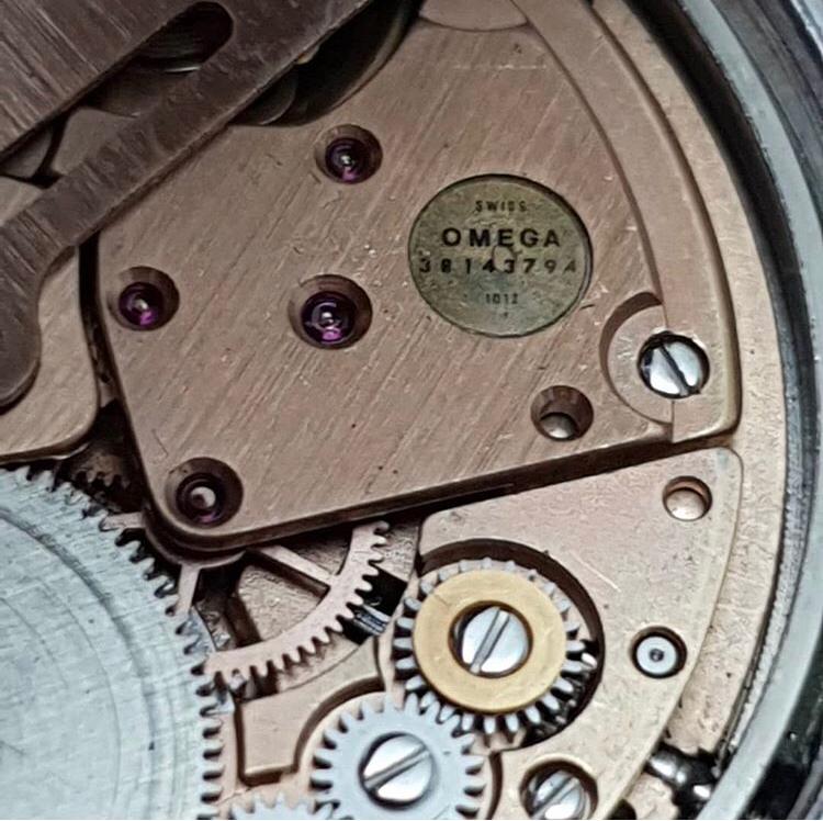

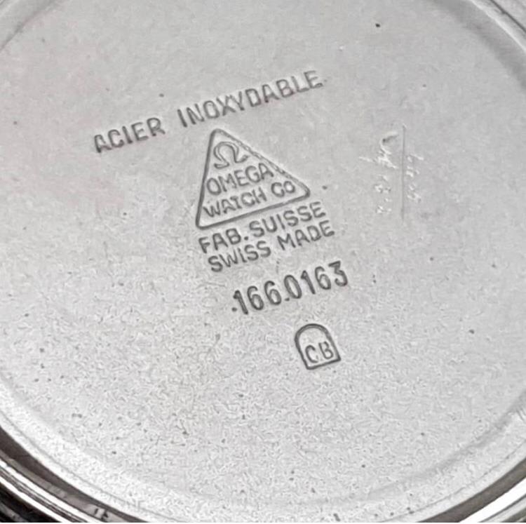

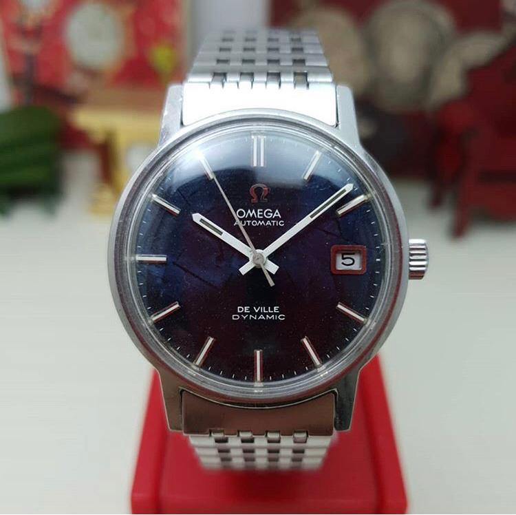

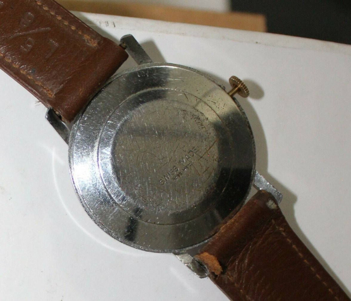

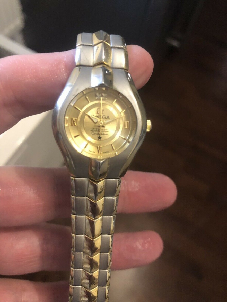

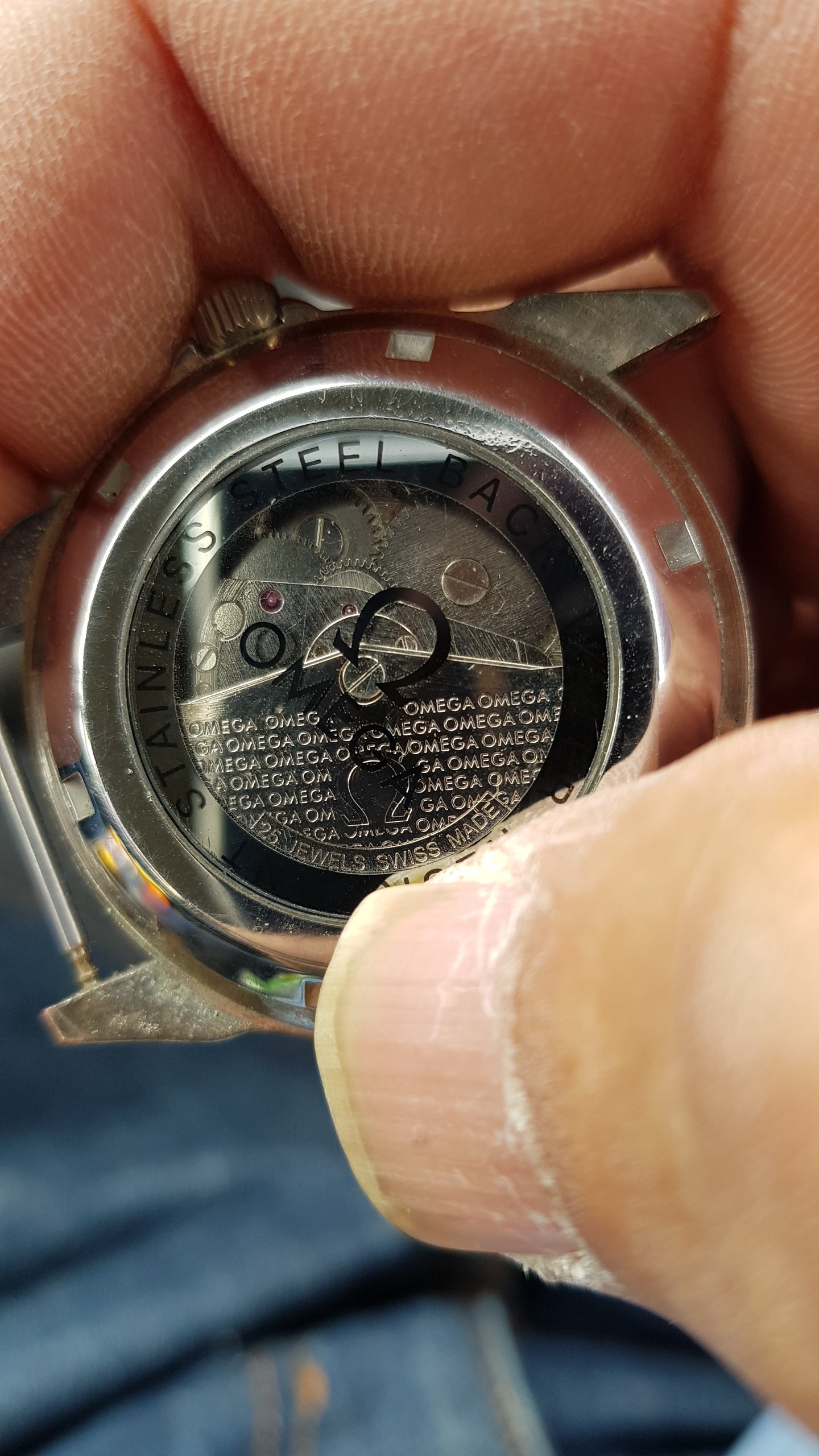

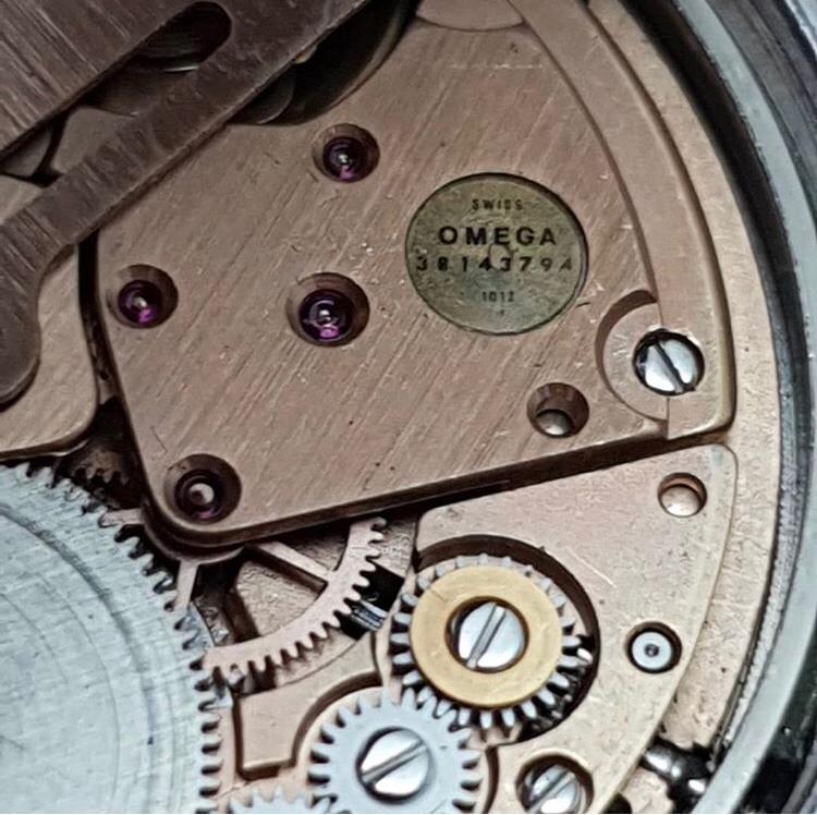

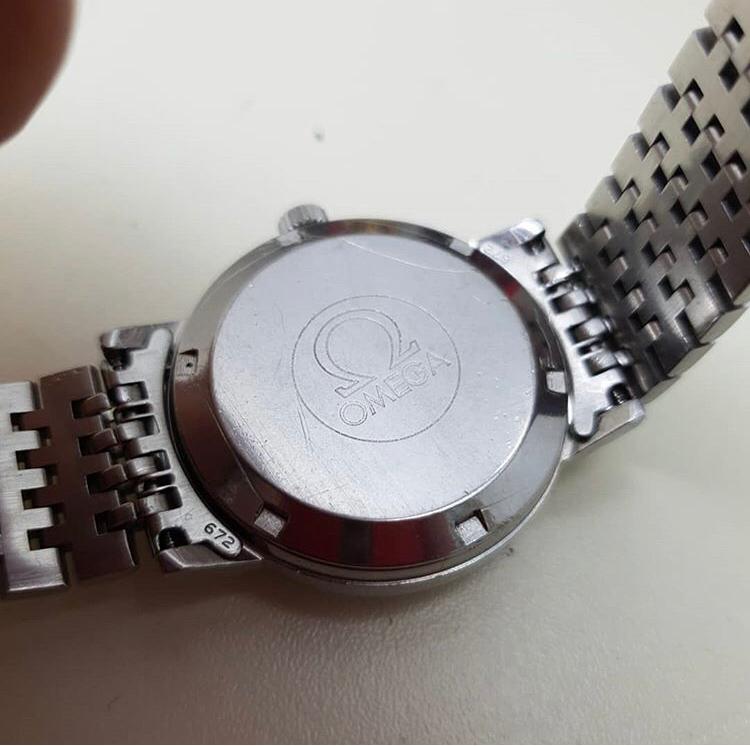

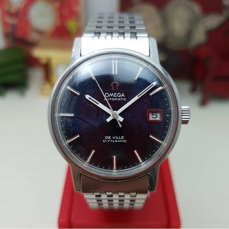

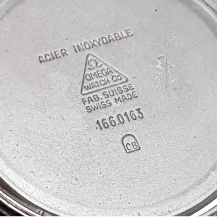

I have Omega De Ville Dynamic but when I search reference number 166.0163 it looks like Omega Geneve What do you think is this watch real or fake ? You can see picture of the watch

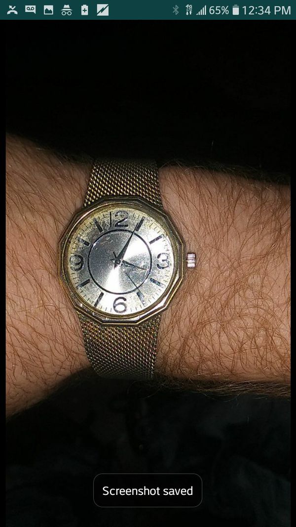

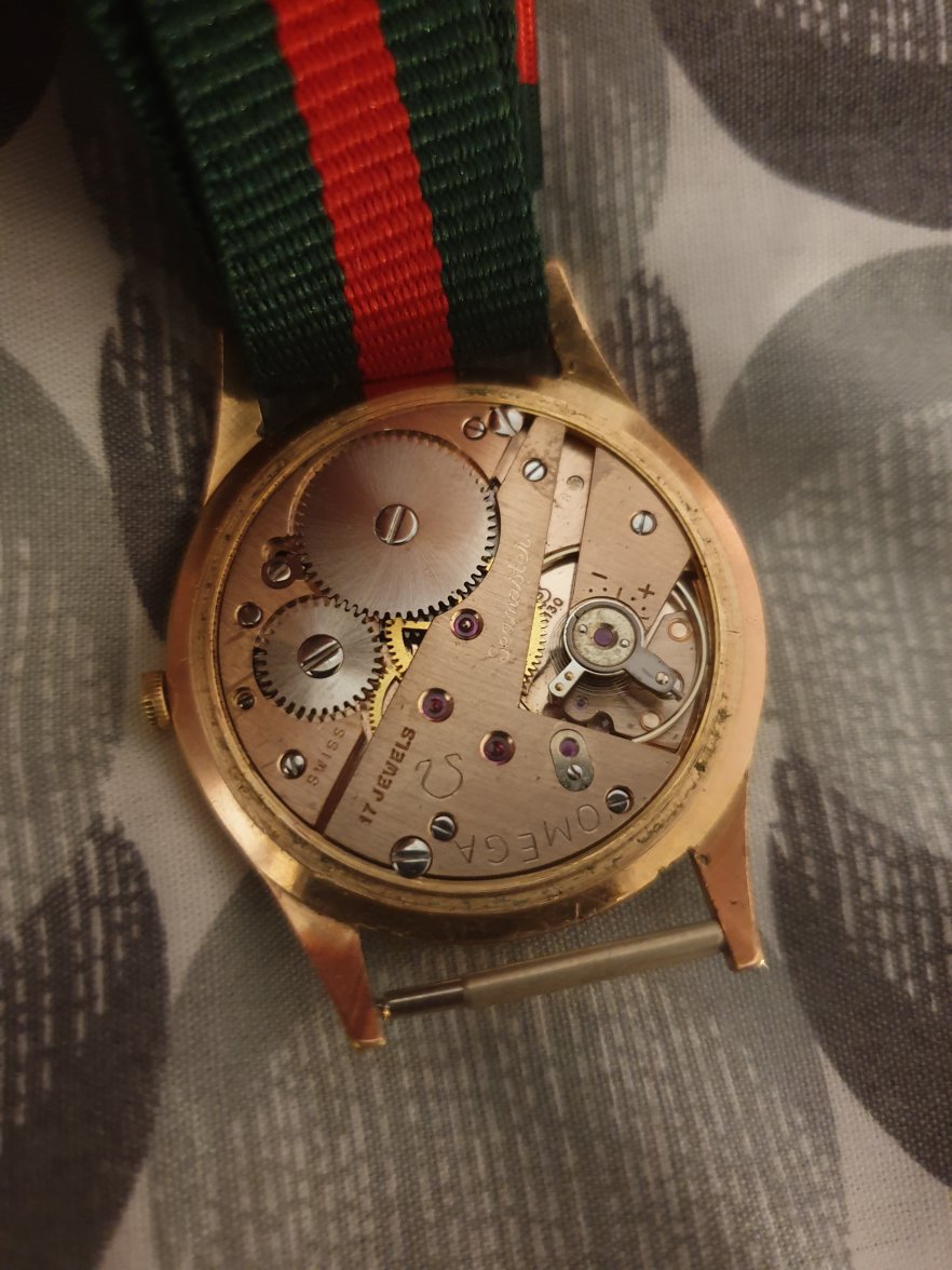

Offecially Certified. On LiveAuctioneers.com. Bidding is already up to $200 with 4 days left to go.

It's quite genuine, just a horribly refinished dial.

Go it, I posted in the wrong thread then. Thx 👍

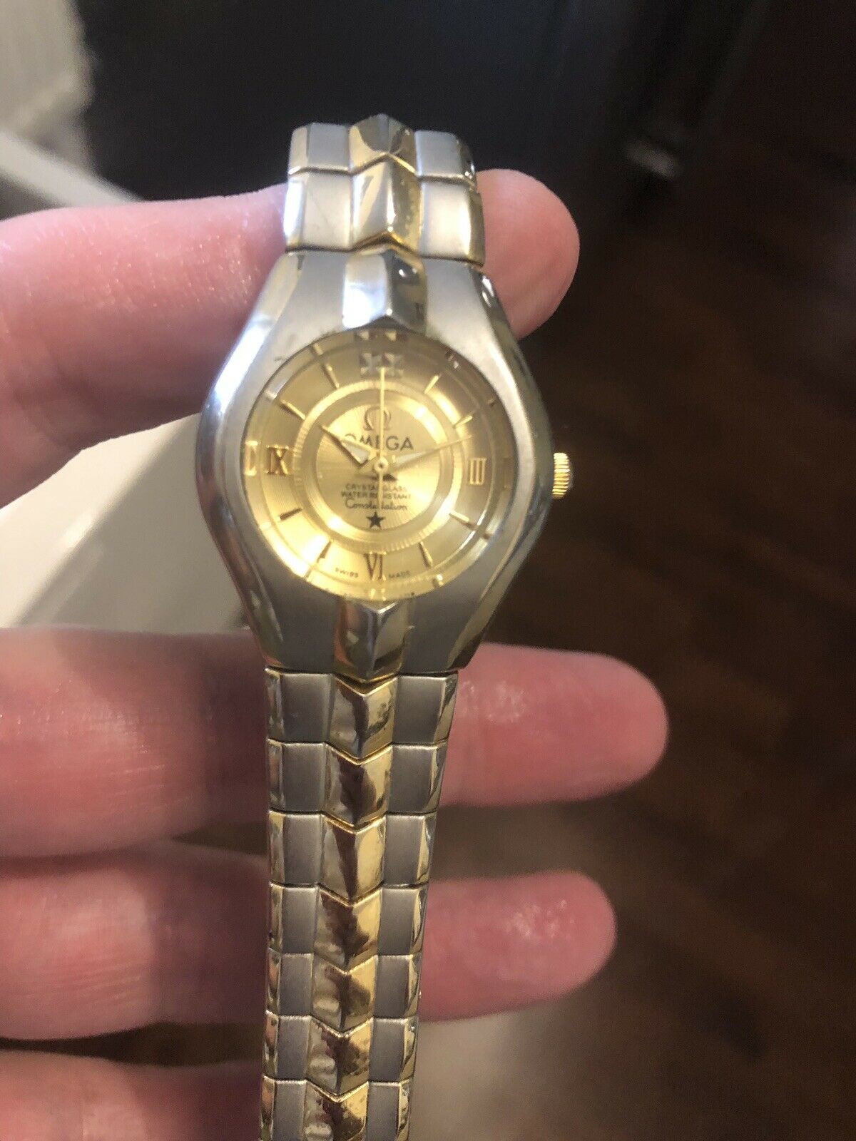

i would bet money the script constellation was written by a female. that's how i remember all girls writing in grade school.

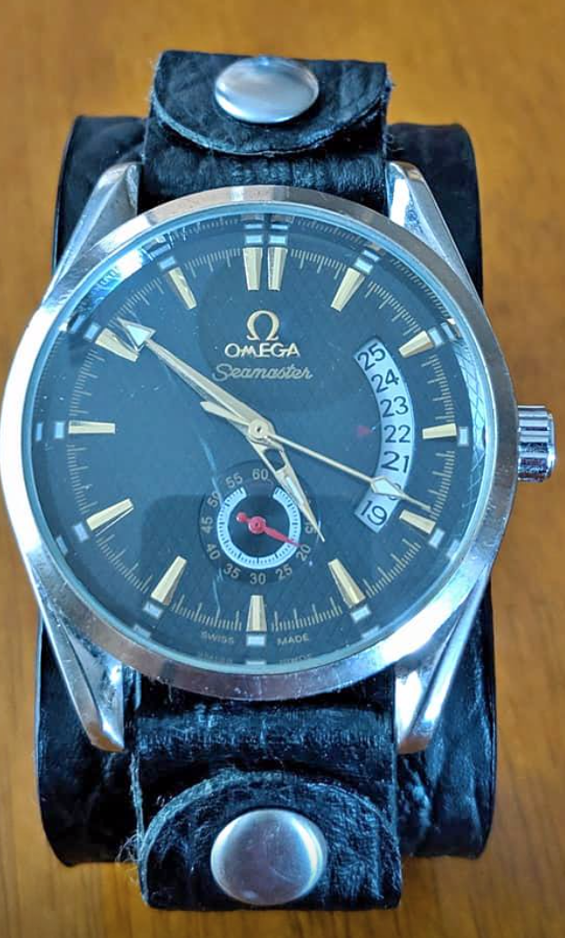

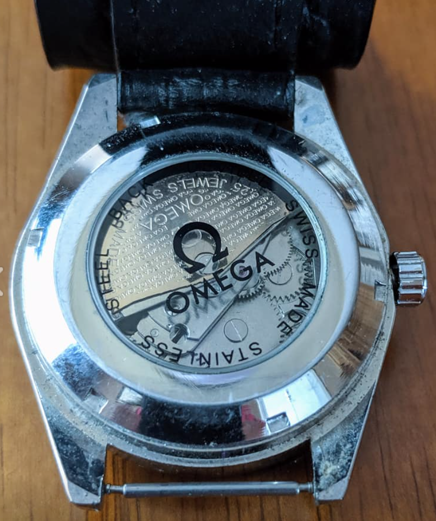

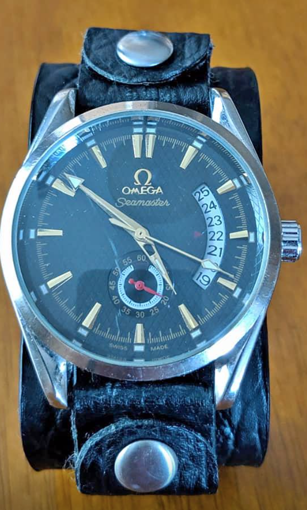

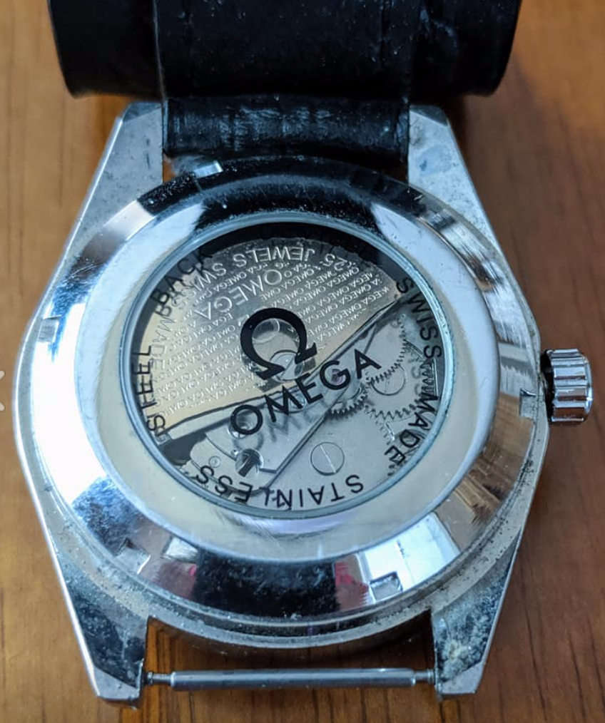

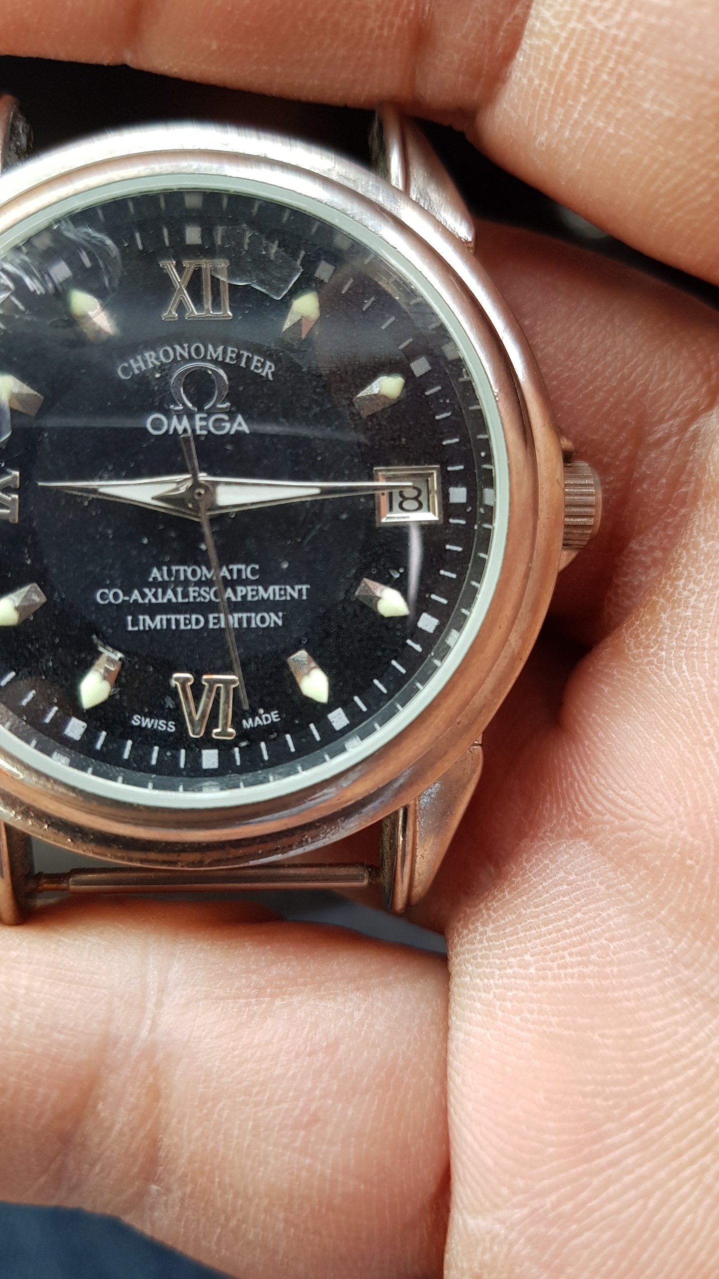

An amusing description to go with it too:
Works perfect,got this watch for 5 years
Hardly used.strapnotleather,much better
Paid £70 4months , likenewvery flexible.
I’m sealing because needs lots of money fordentist.onlyonereason.

Font of the “Constellation” is truly remarkable. Made by artist in South Asia perhaps. 😉

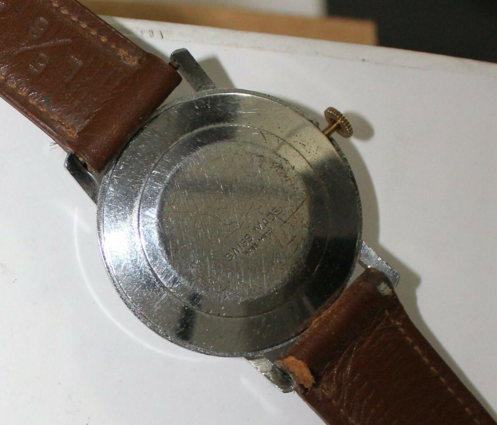

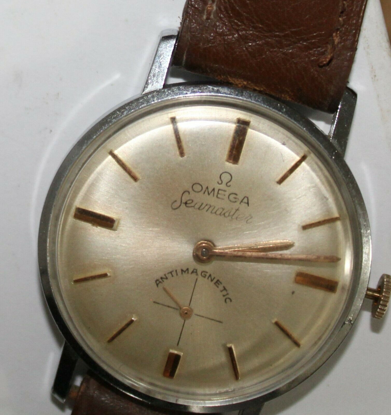

Here are some tips to help you avoid purchasing a fake vintage Omega.

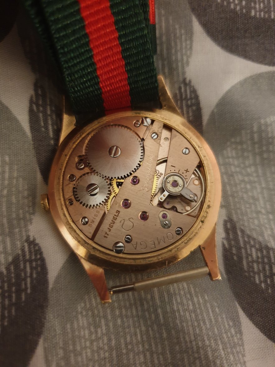

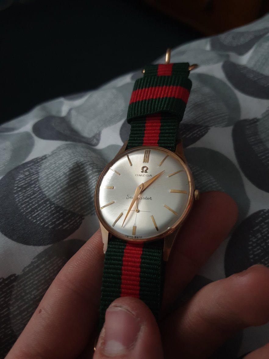

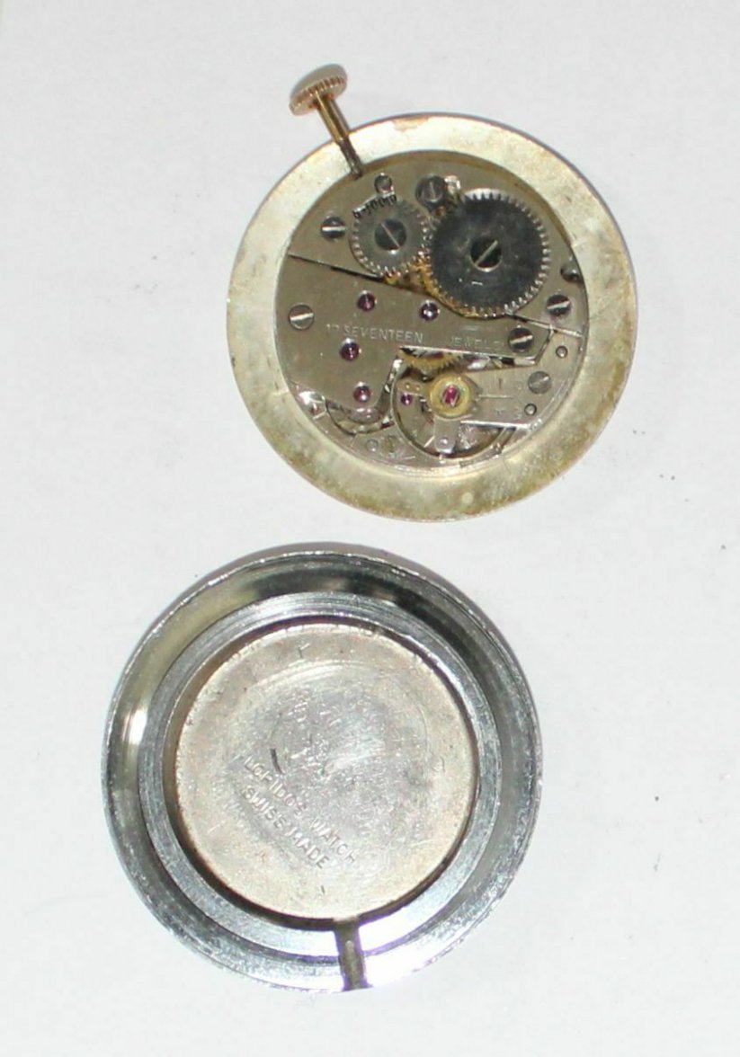

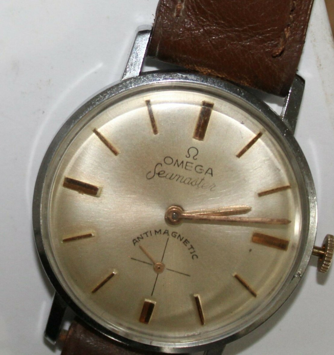

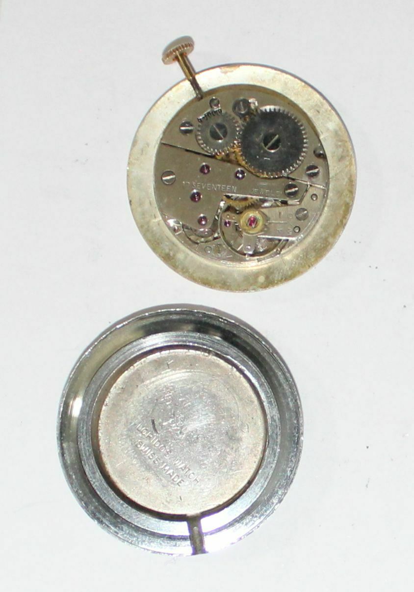

Here's a classic fake Seamaster:

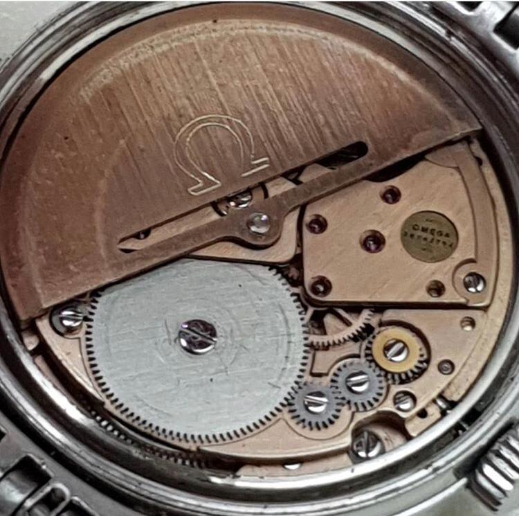

First, you won't find "antimagnetic" or a jewel count on the dial of any Seamaster. Second, that's one crappy movement. Omega copper plated their movements since the word Seamaster has been used on the dial. Third, Omega never put the hallmarks (like the Ω WATCH Co inside the triangle or the 18K 0.750) you see on this watch's caseback on the outside - they were always on the inside.
Thread it came from: http://omegaforums.net/threads/seamaster-elecromagnetic.6234/

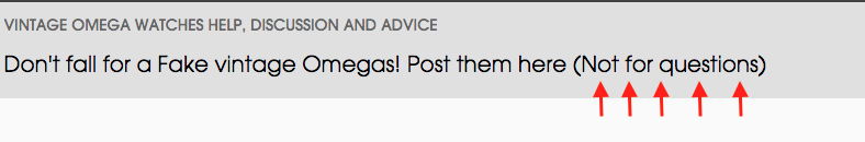

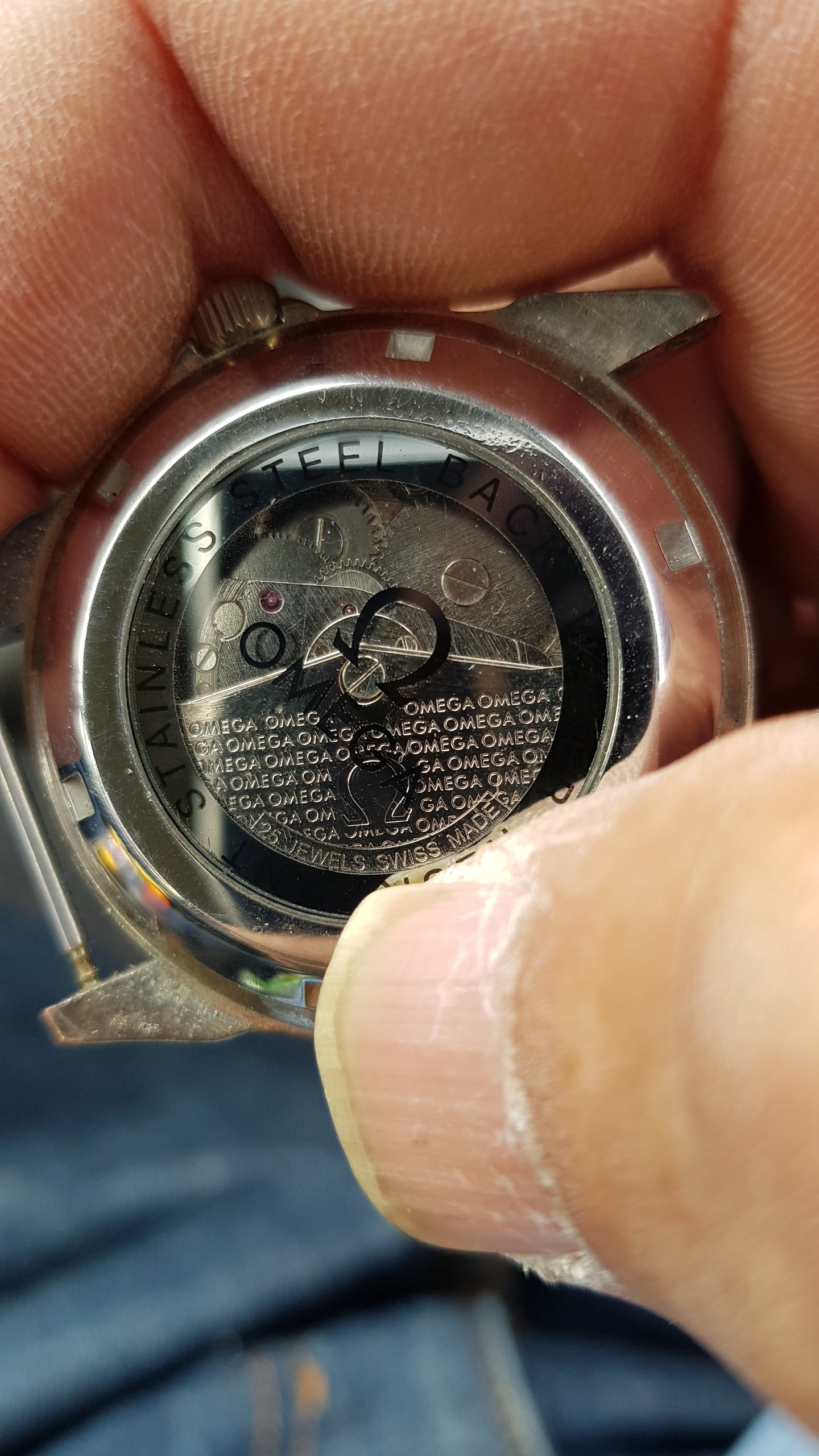

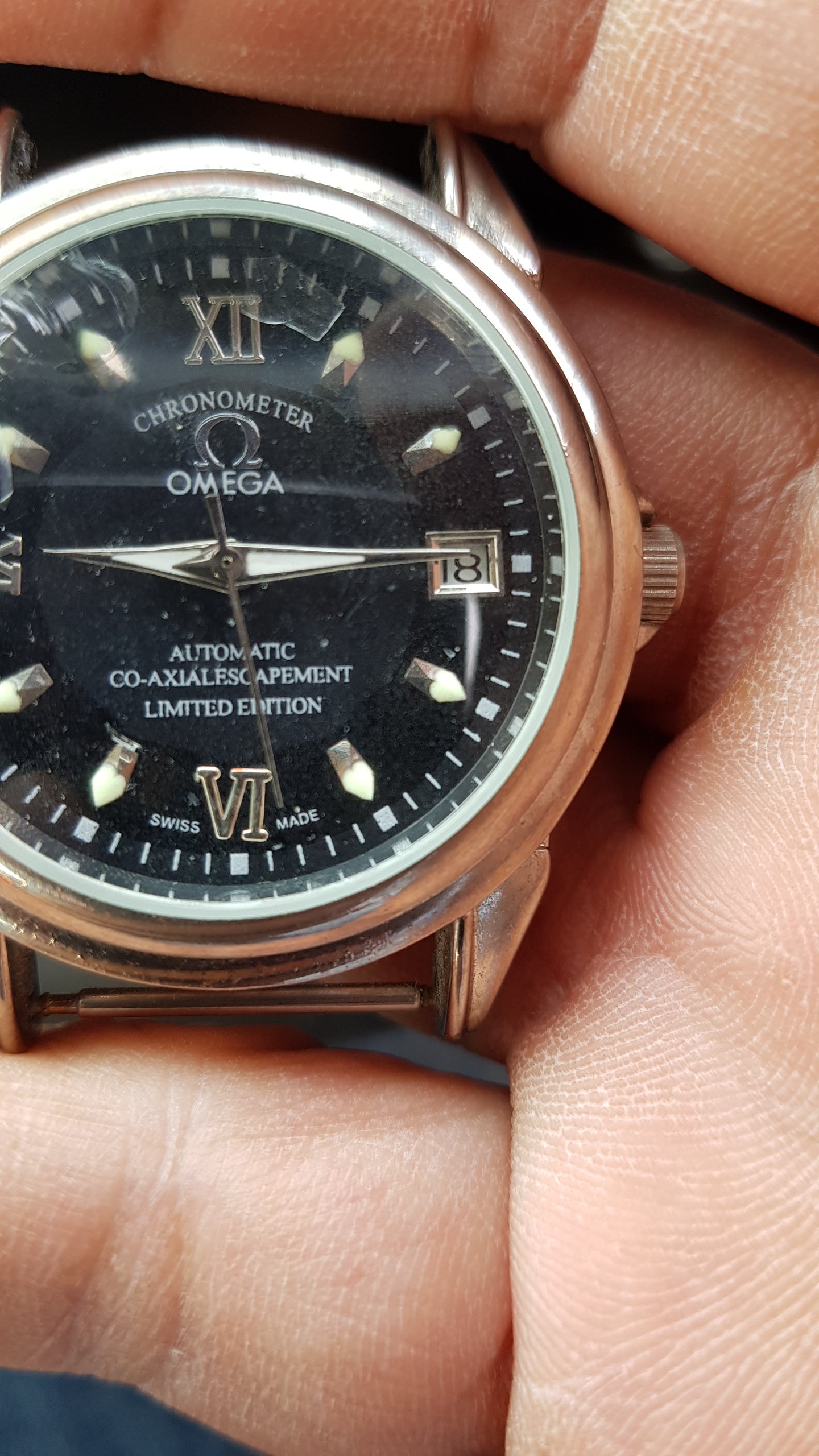

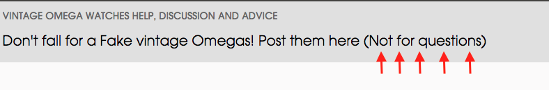

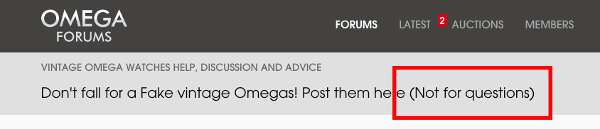

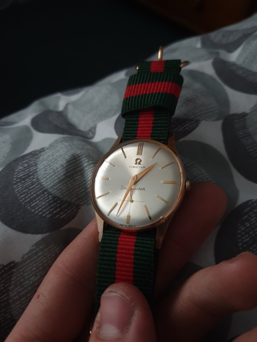

Sorry to say, you have two problems.
1. You don't know where to post, because this thread is for known fakes, as identified in the title:
VINTAGE OMEGA WATCHES HELP, DISCUSSION AND ADVICE
Don't fall for a Fake vintage Omegas! Post them here (Not for questions)
and:
2. Your watch is a disgusting counterfeit.
