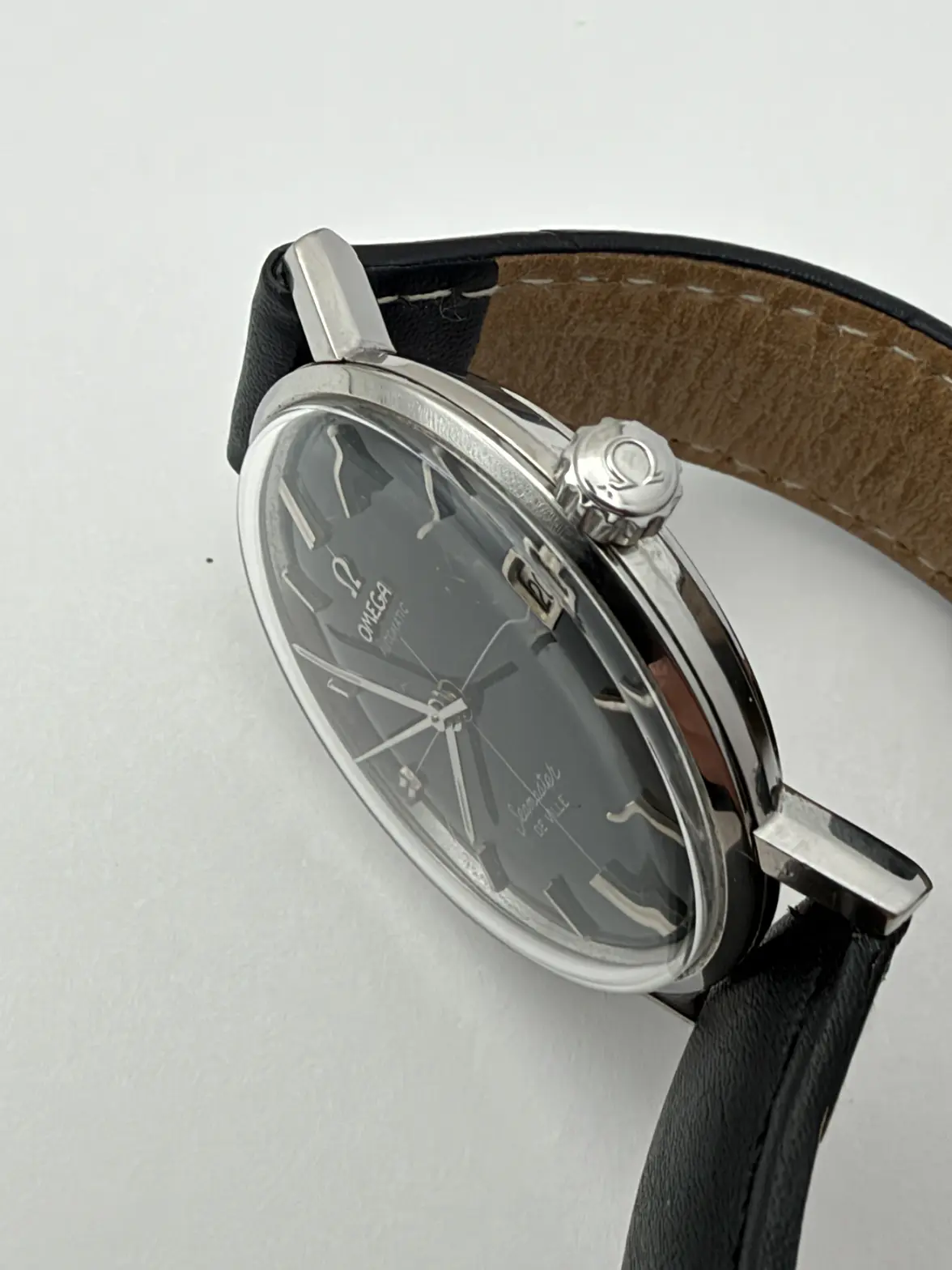

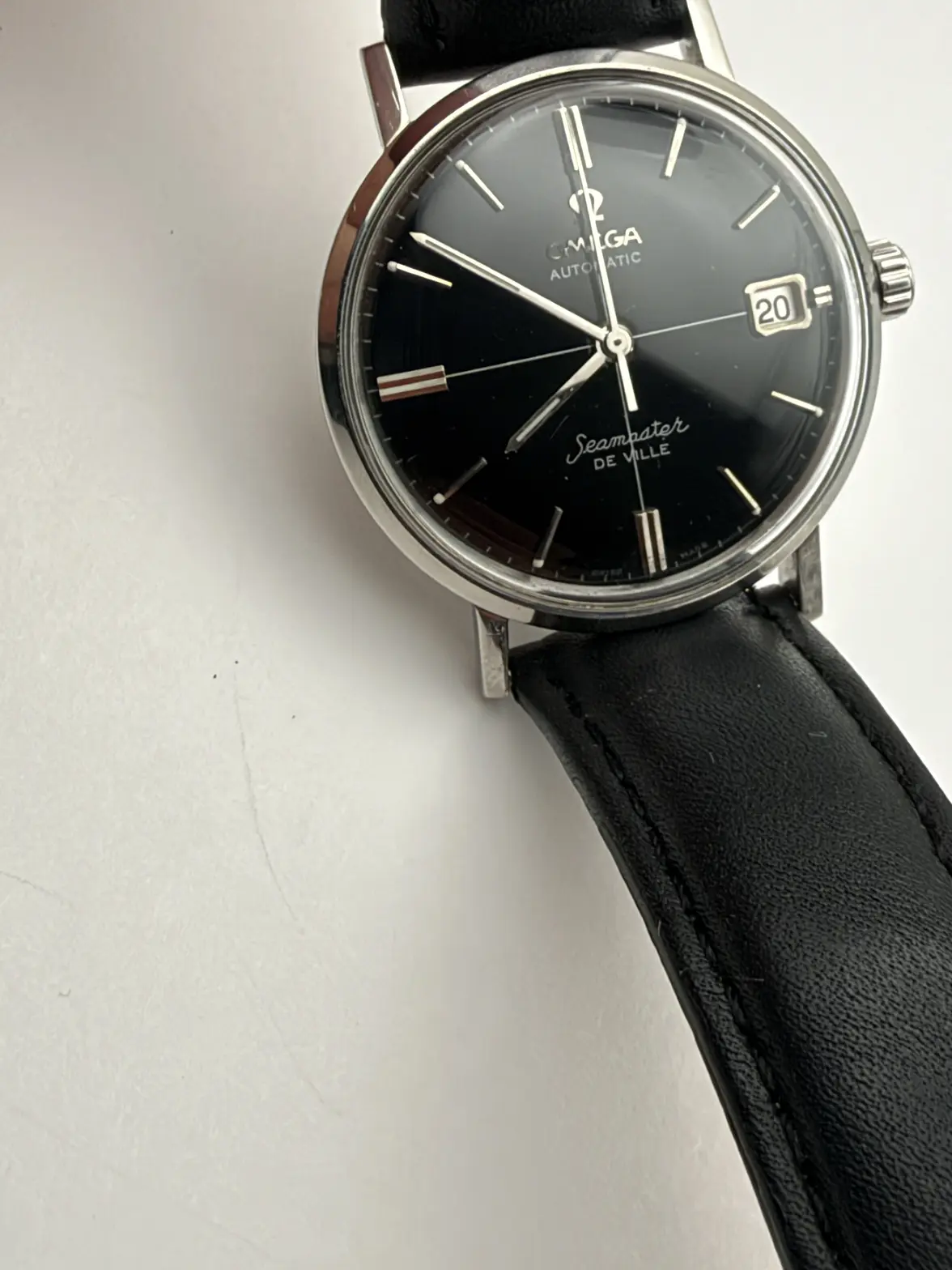

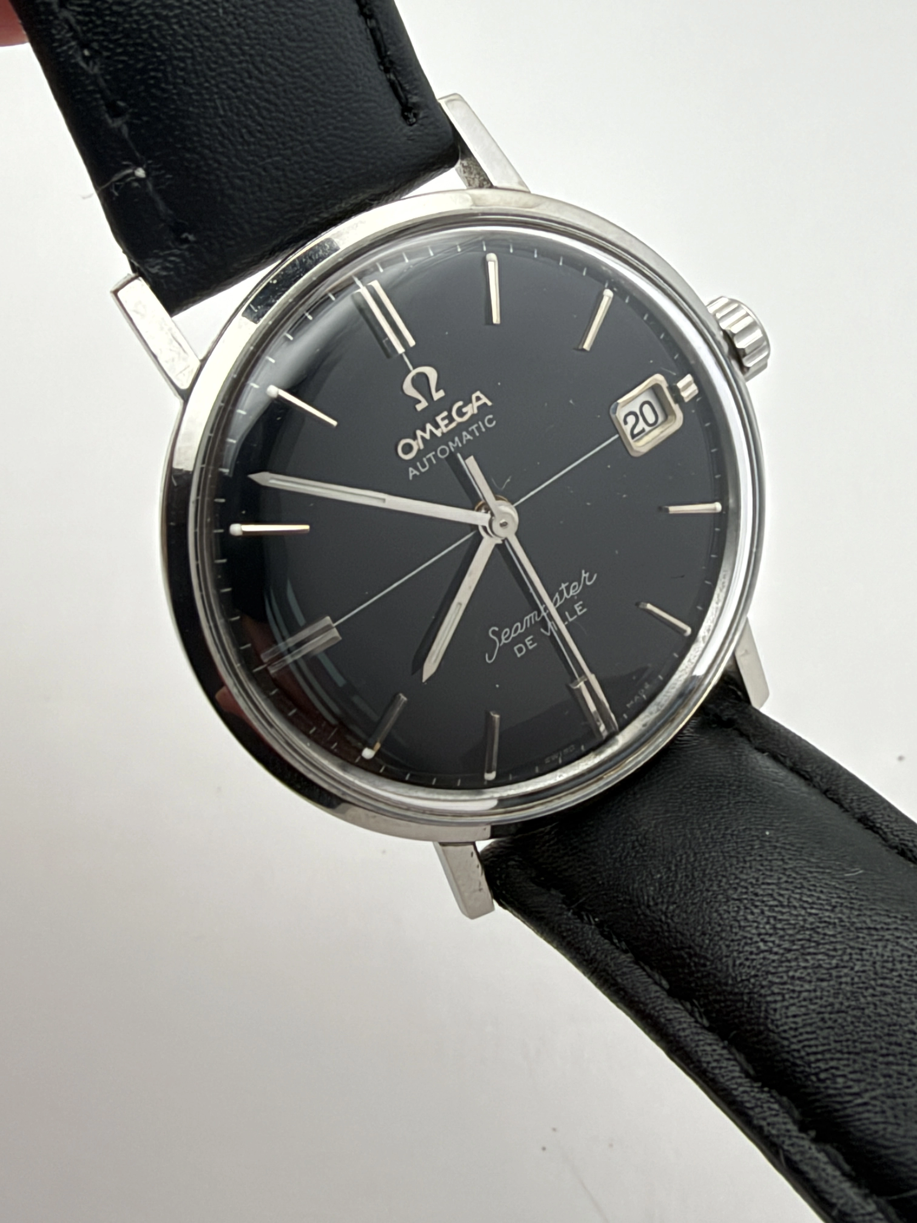

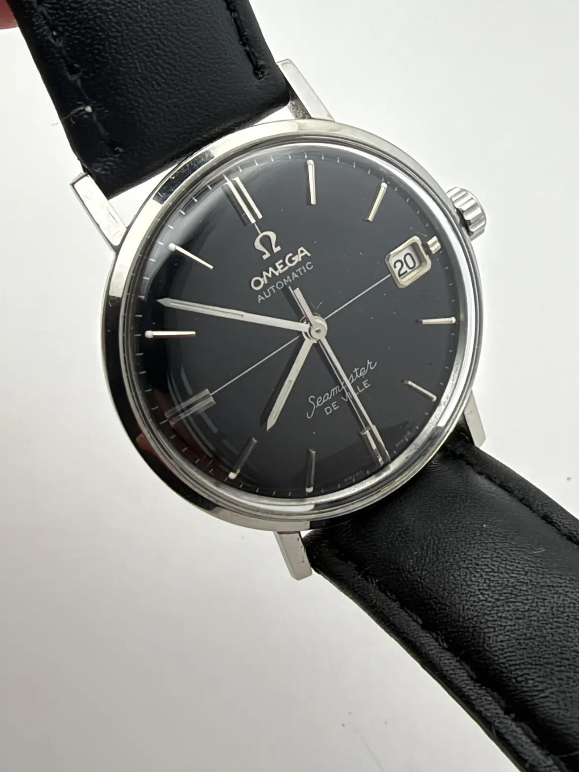

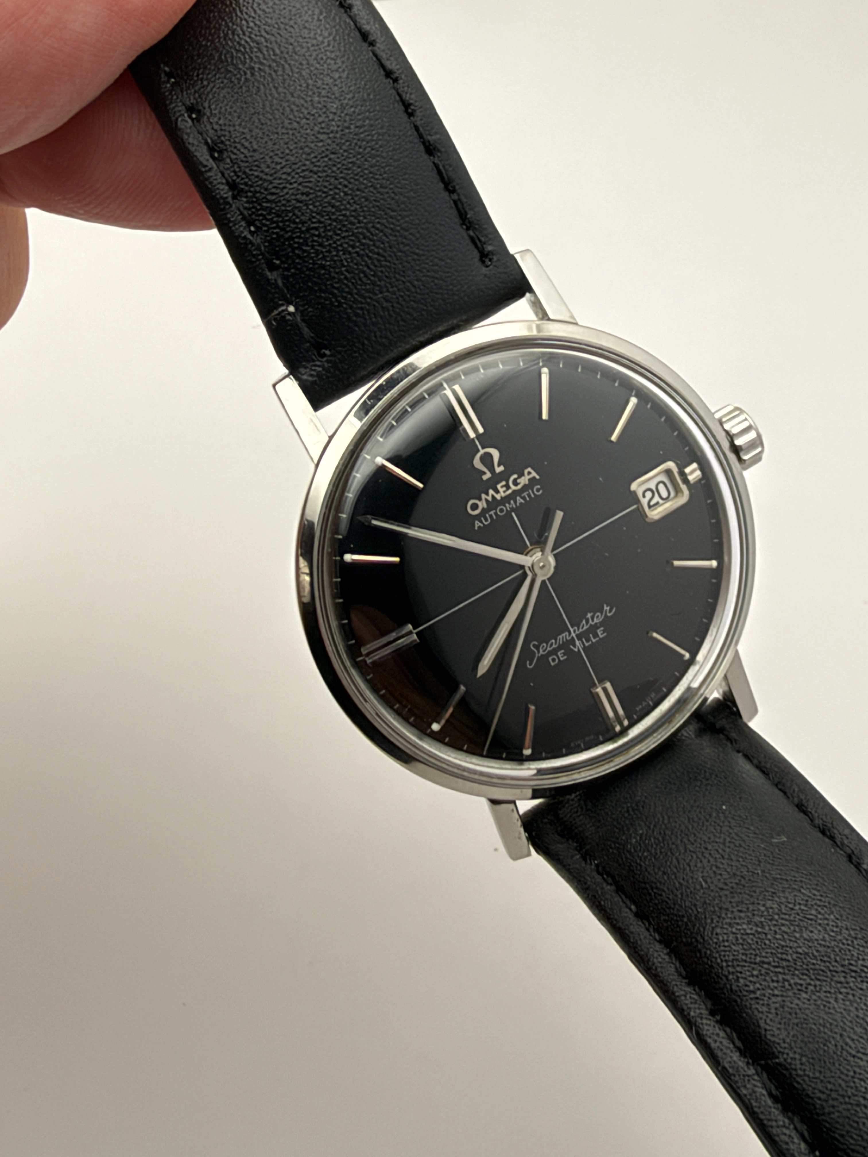

Hi, I'm new to the forum but have been an Omega enthusiast for most of my collecting life. My first high end watch was an Omega Constellation gifted to me by a remarkable friend. I now have a Genta Polaris, an exhibition back Moon Watch among others and I just acquired a pre-Genta Pie Pan. I just received this watch in a trade. When I posted it to a Facebook Omega group some were convinced it was a redial so I thought I'd come to the experts. I have found Black Dial Seamster De Villes with variants which mimic mine - the Swiss Made being separated further apart; the cross line not going through the Omega Logo. I'm taking it to my watchmaker tomorrow but I would welcome your thoughts please....

In my opinion, this seems like a re-dial : both 'S's look rather off to me.

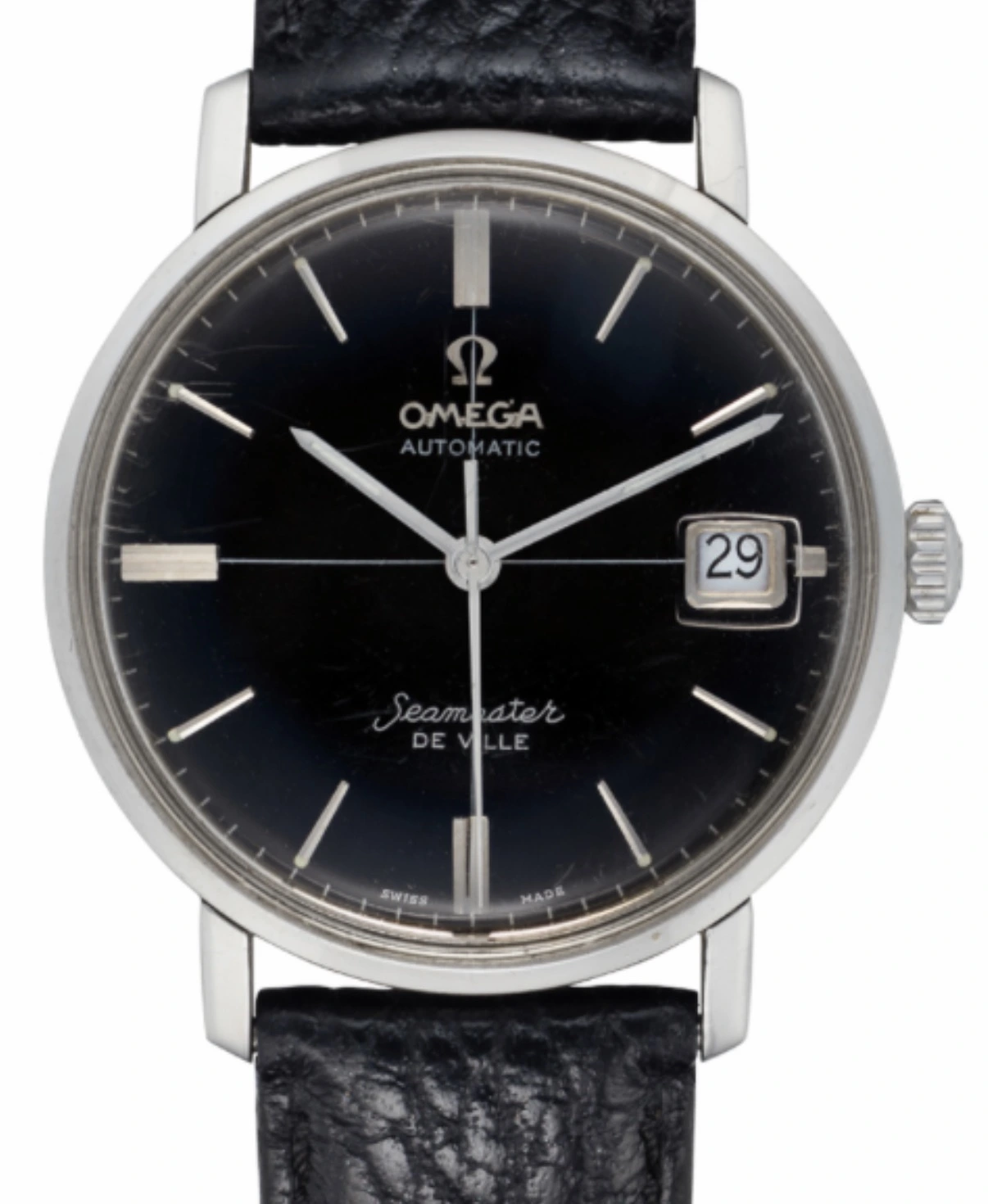

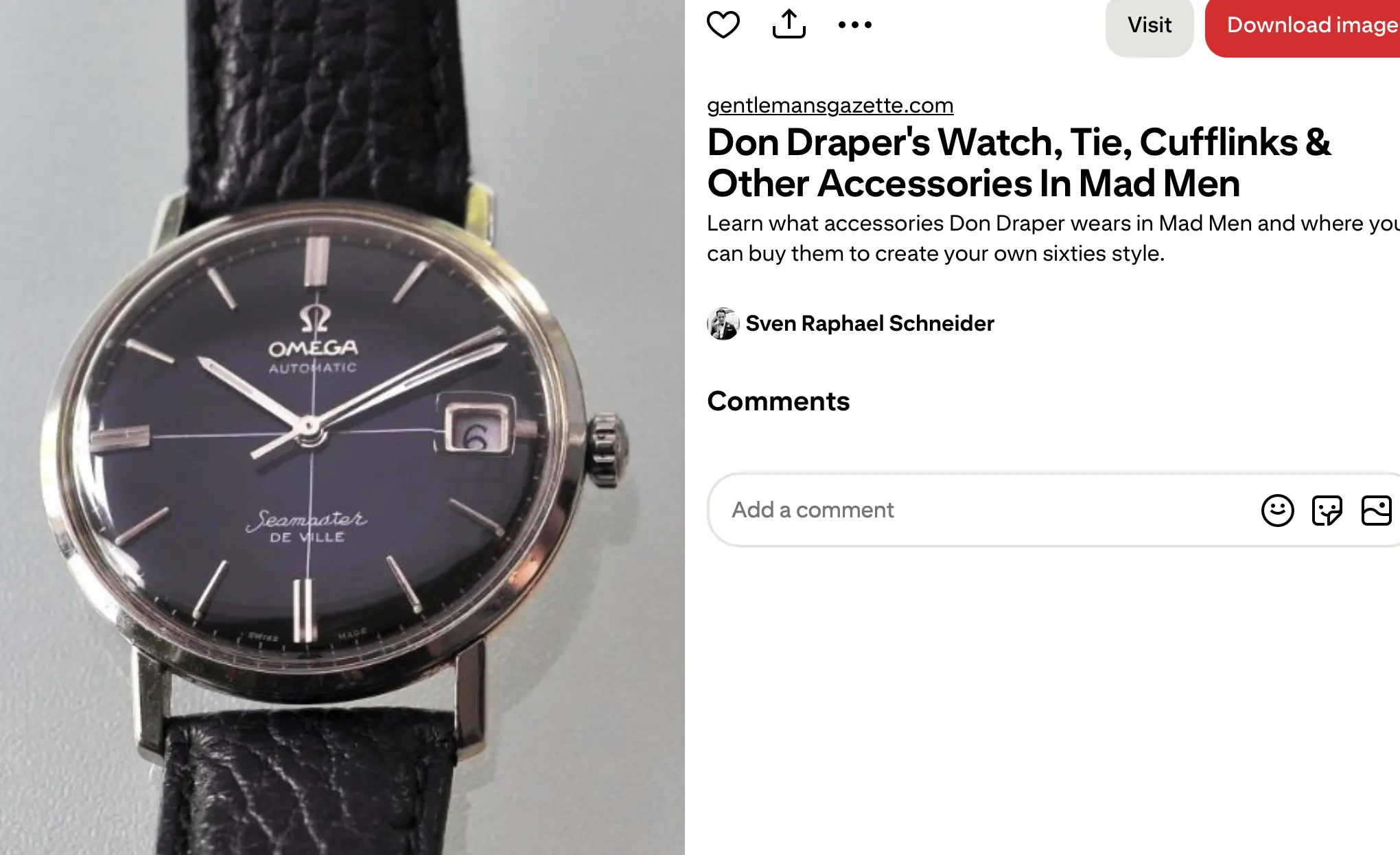

I thought that at first but here's a variant I found on Hodinkee that has the same s.

They’re also not the same. Yours has a broken crosshair.

I know they're not the same. I've found broken crosshairs too. I mean it's possible that there are just lots of redials because of the popularity of the watch. But is it also possible that there are variations?

I know you want it to be original, but it isn’t.
There are more redialed black SMDV’s than original ones.

No, I'm cool either way. I just want to know for certain. I acquired it in a trade and if it's not what I thought it was then I might return it. If I go back to the guy then I really want to be sure. Make sense?

I assure you it’s a redial. Can you find another original SMDV where the M in automatic has vertical sides?
That’s just one tell. There are several.

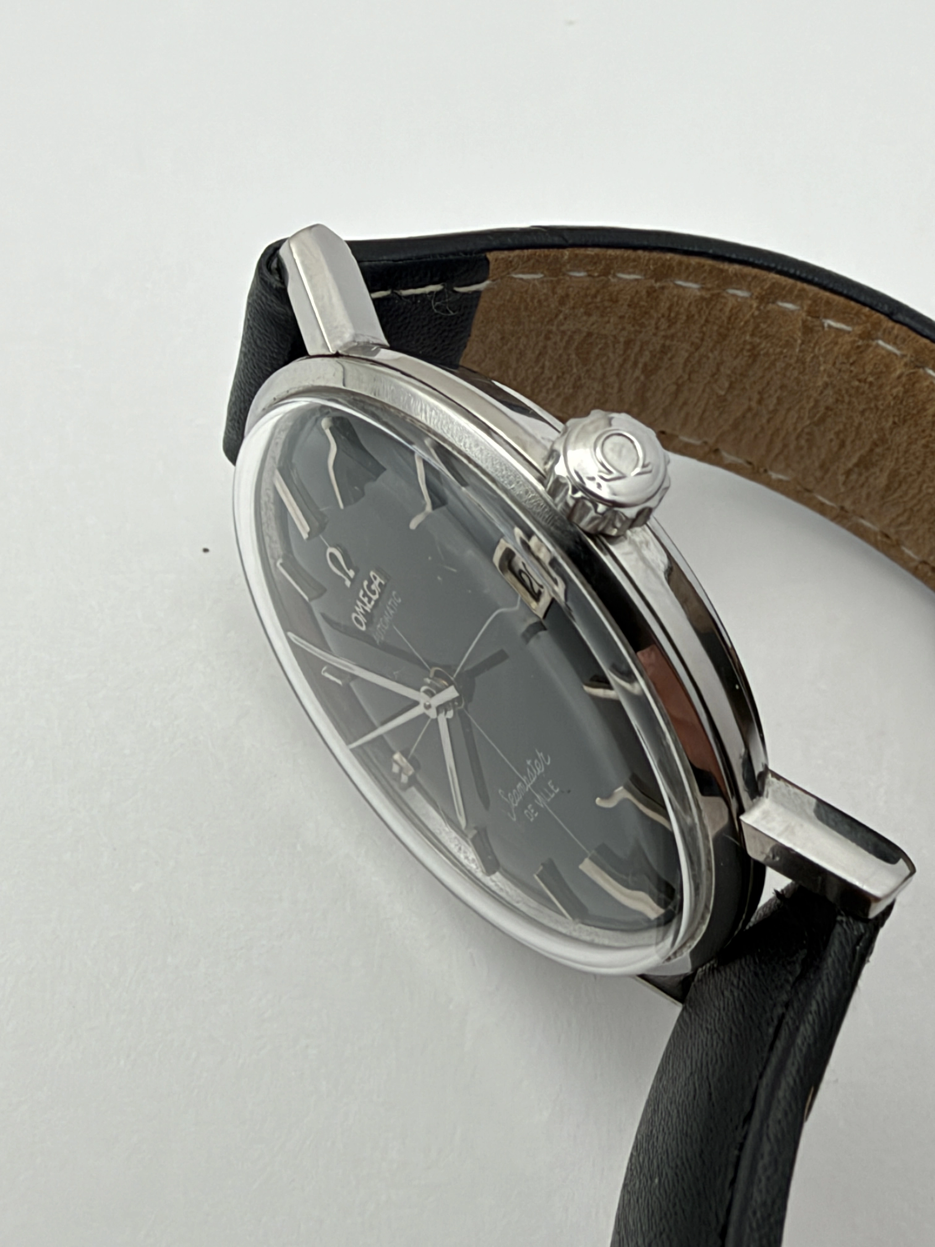

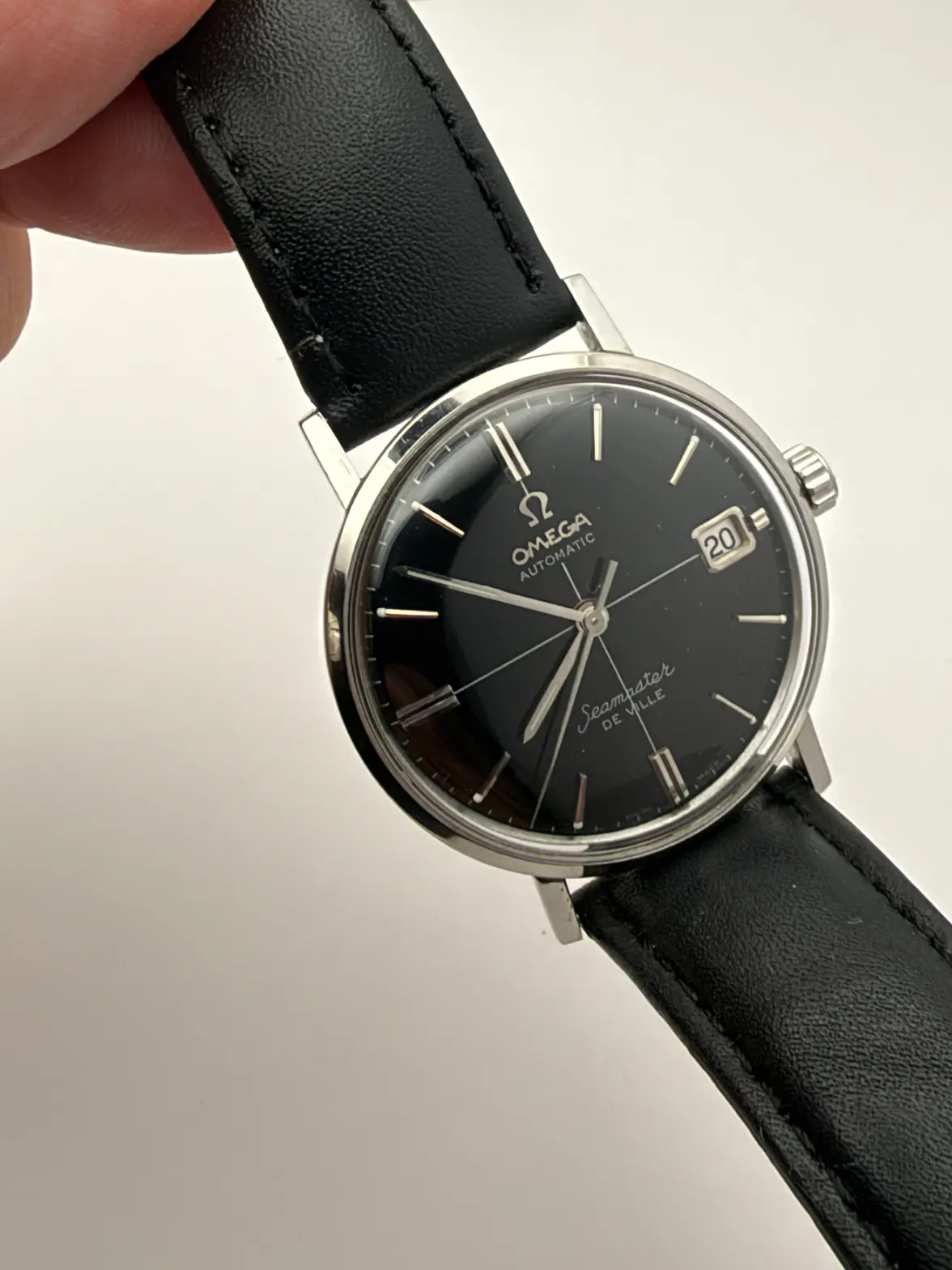

I believe you. Here's one which is, I assume, also a redial. lol.

Wasn’t the actual watch used in Mad Men a redial too? From one POV all these freshly painted SMDVs above and on eBay are a closer homage to that show than an original watch. Not for me but there clearly is a market for them.

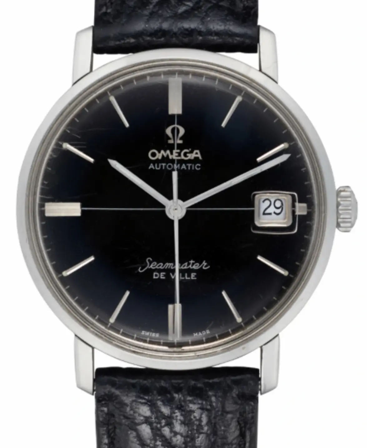

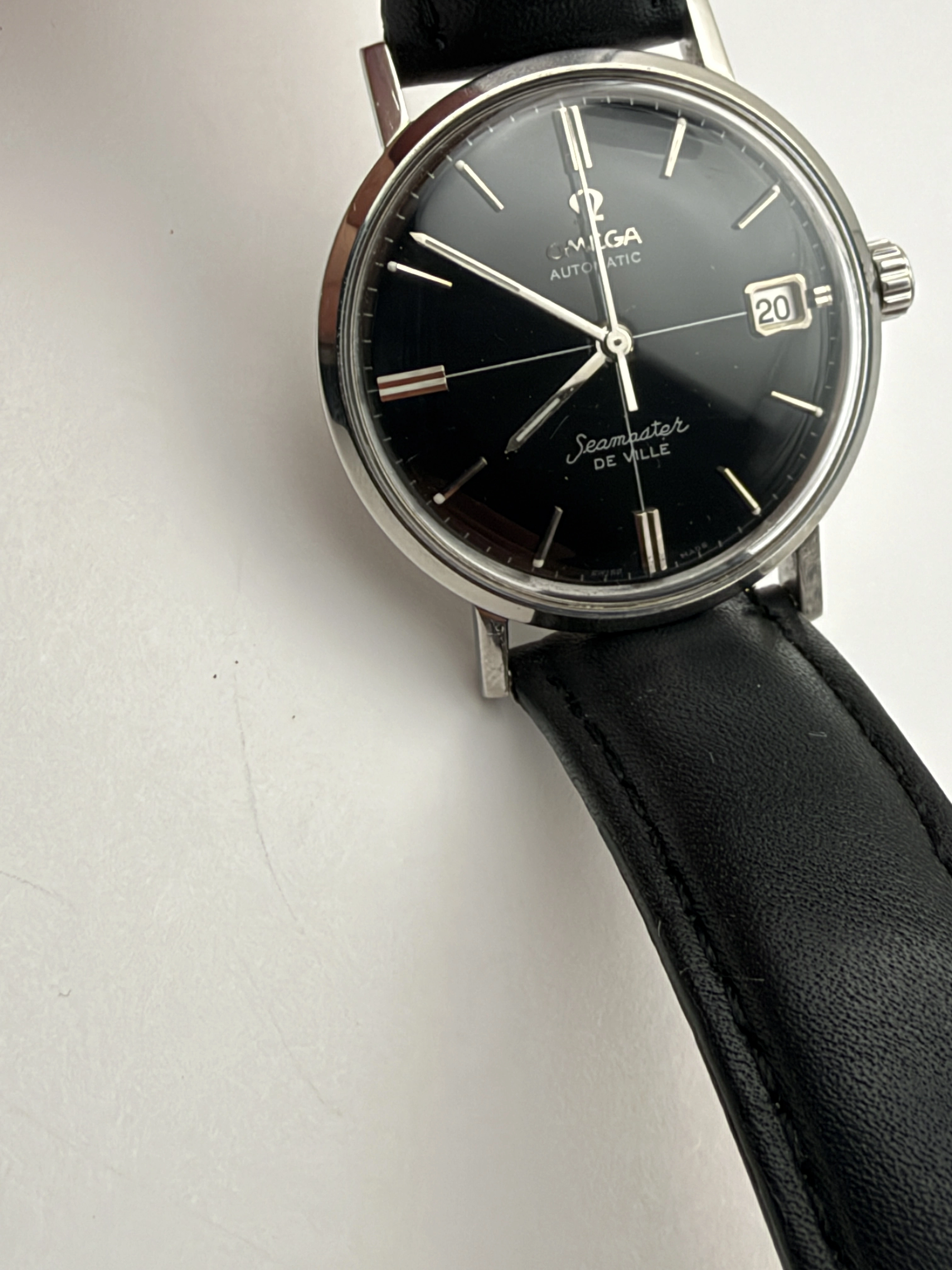

I think this old For Sale ad from @nanjingcigaretes (helpfully appearing as a 'similar thread' below) with an original example is really informative here:
You can see clearly how the coat-hanger 'S' should look on an original, as opposed to how it looks on the re-dials (and similarly for the 'M' in 'automatic')
