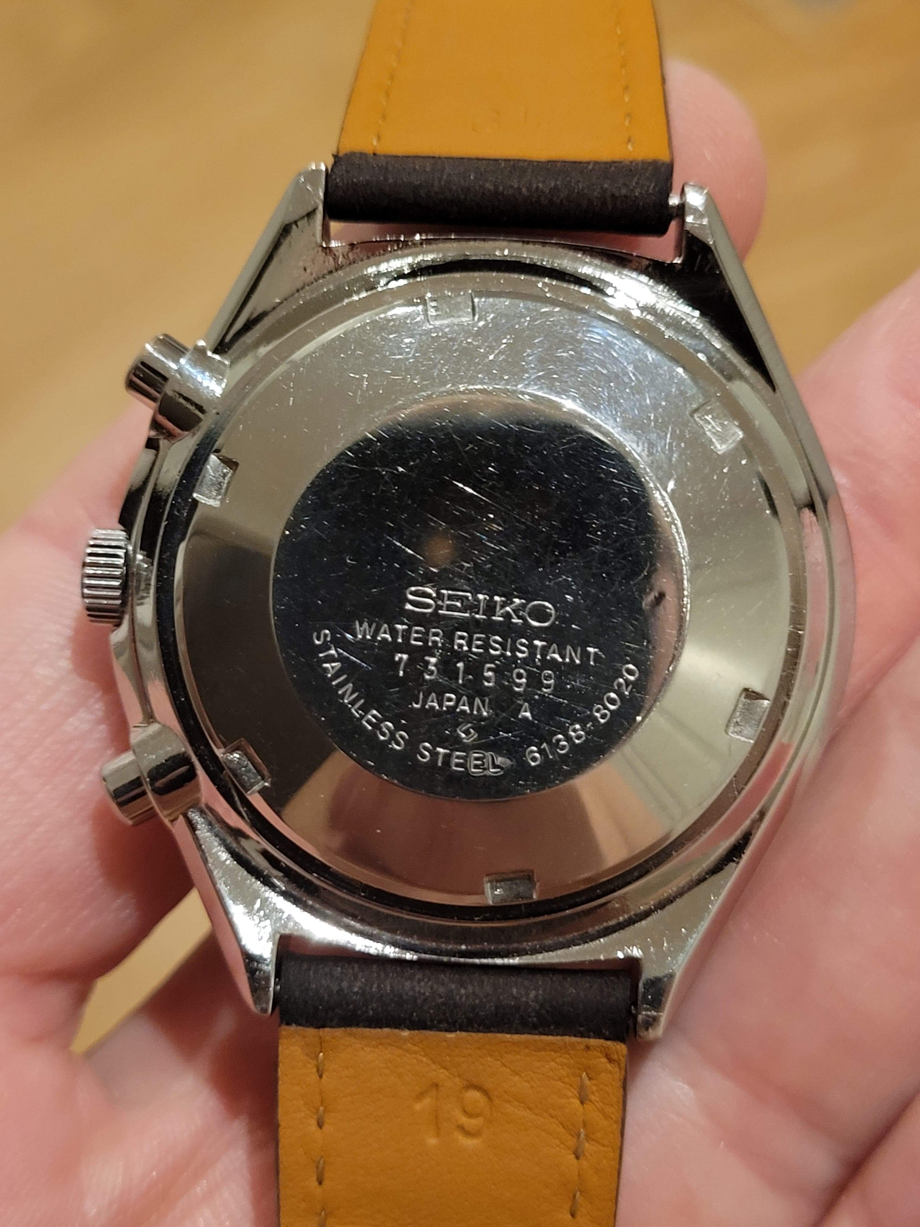

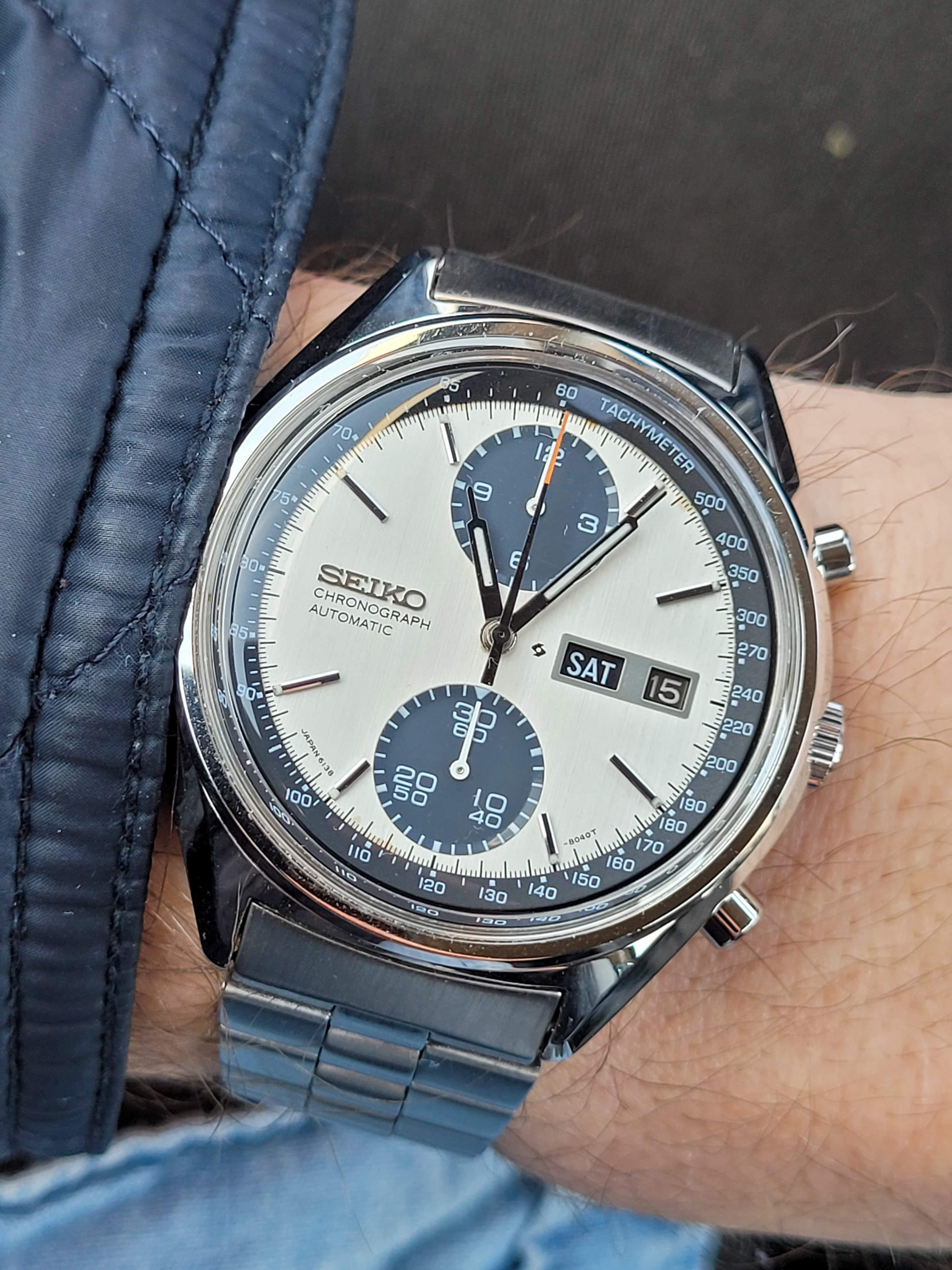

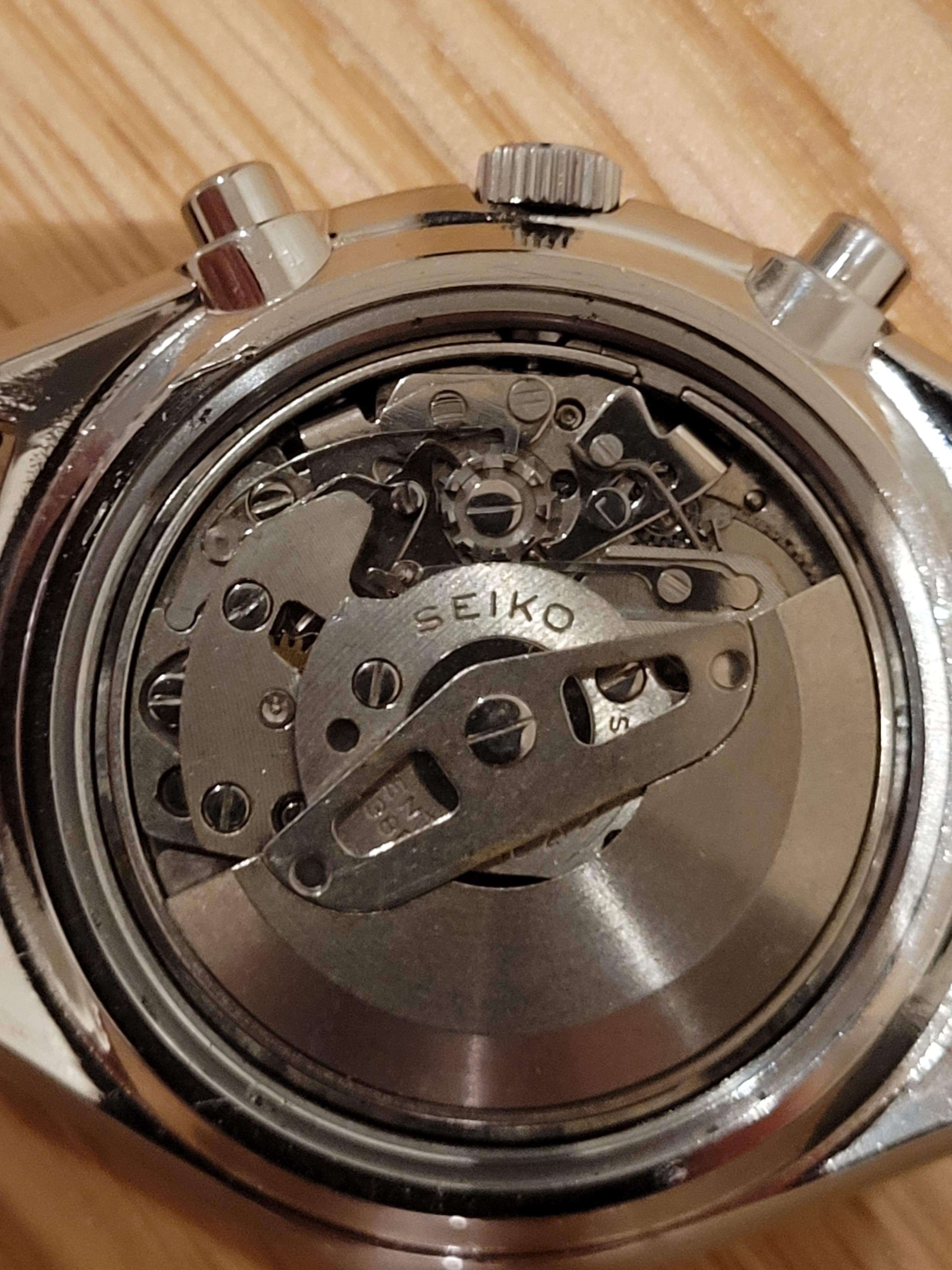

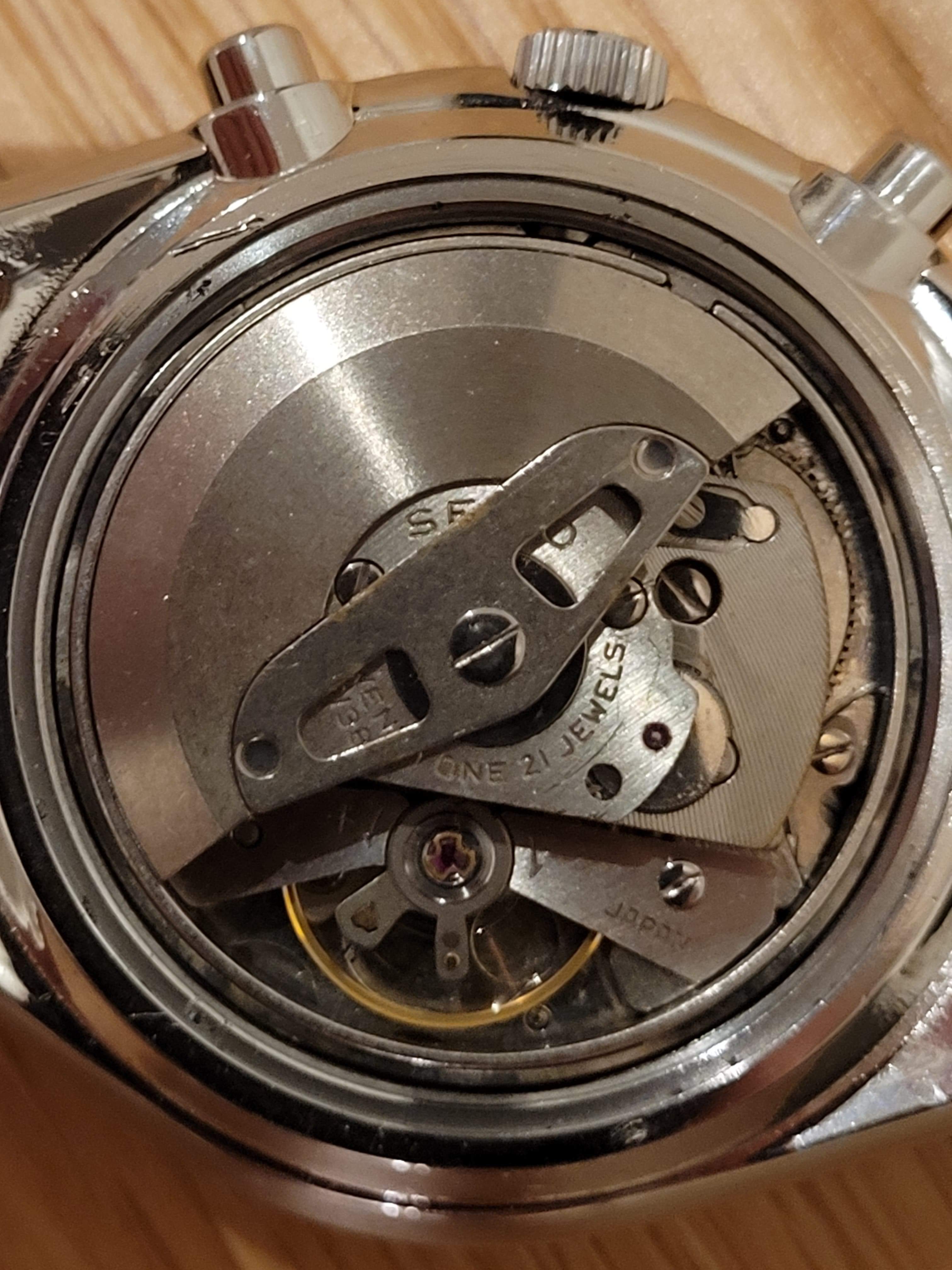

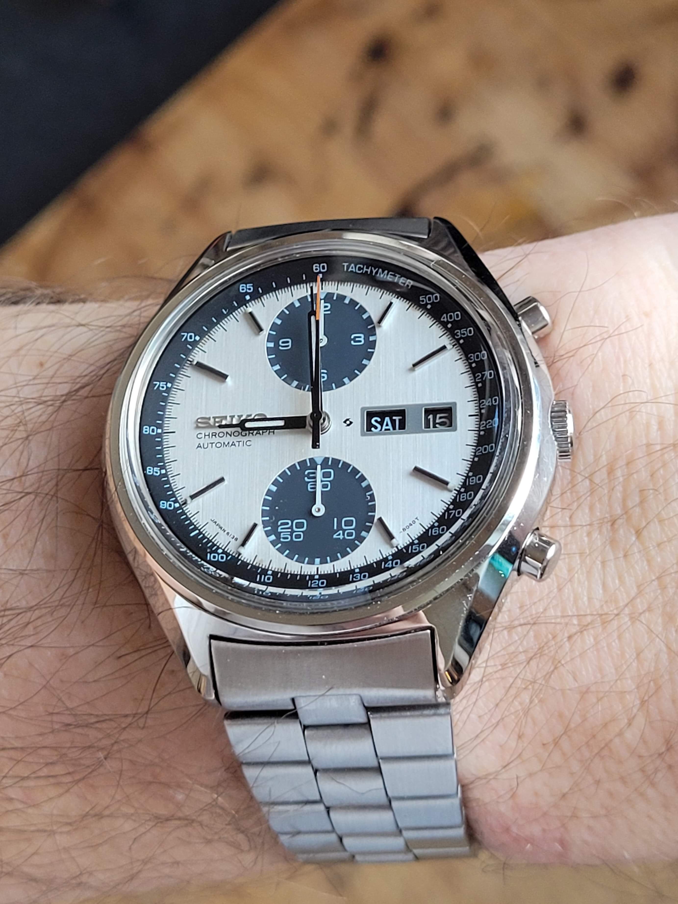

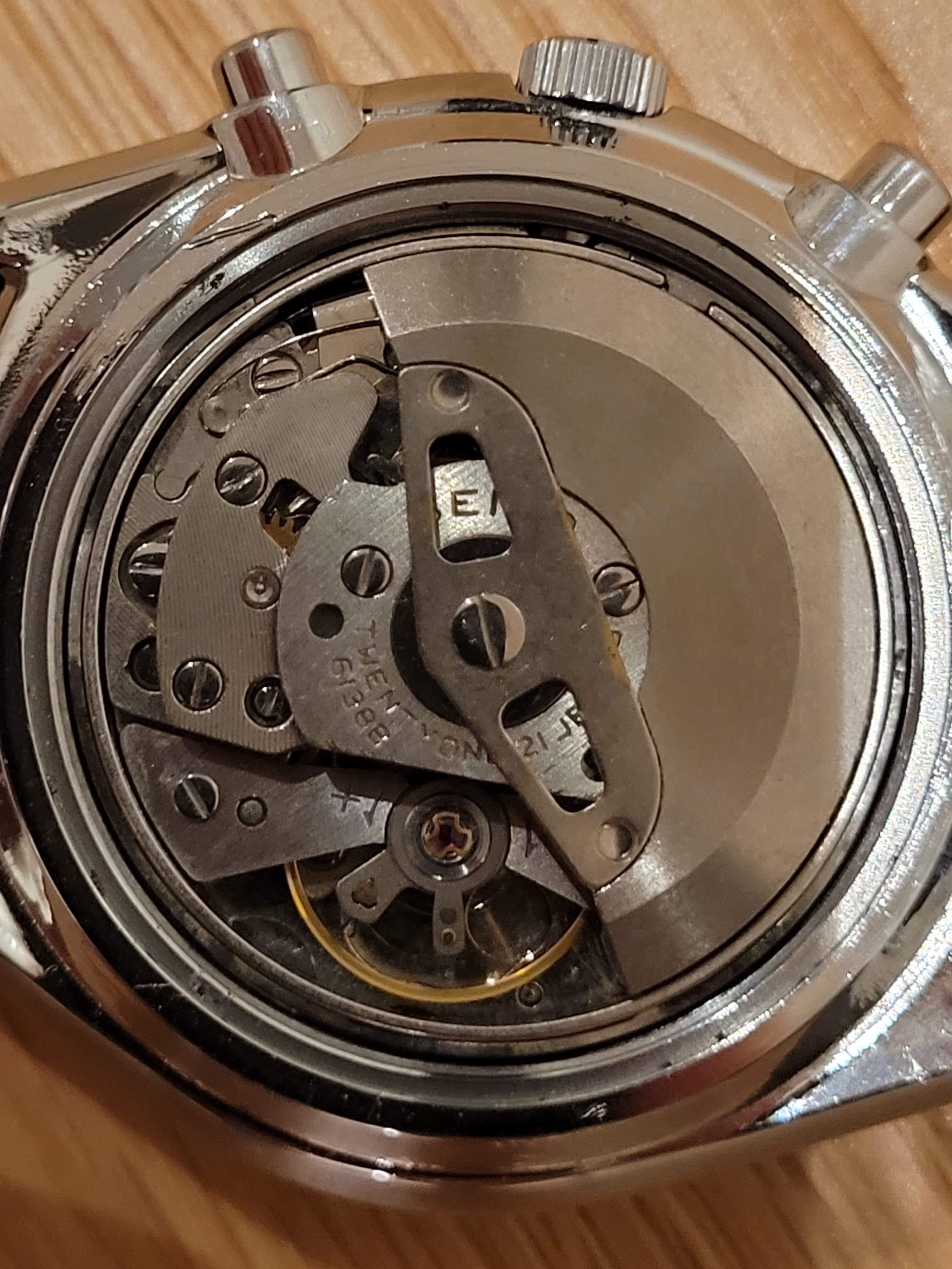

Hey!
Just found a panda 6138-8020 for sale. It’s all original and recently serviced according to the owner.
I really don’t know what to look for when it comes to seiko watches and would gladly take som help from you guys that know more!
here’s some pictures I got!
326
1,245
Looks right to me and super snazzy on that bracelet.
Yeah, really nice on that bracelet, although it’s aftermarket. What’s your take on the case? Probably polished?
4,593
10,813
Yea looks it but who cares? Most stuff from that vintage got hit with polish at some point.
326
1,245
True! What’s reasonable to pay for this piece in your opinion?
4,593
10,813
I can't really help ya there. Too many variables at play. However if I seen it at an as-is where-is tag sale or flea market I would have no problem paying up to $350 for it as long as everything was working. 👍

Critically, the dial has none of the usual signs of a fake. As noted above, the bracelet is AM and the case may have been polished. You'll not get a nice one for $350 unless you're very lucky. I'd say if you got it for $500 you'd feel like you had got a pretty good deal.

Case is probably overpolished but note that the case finish on these has to be fully polished, not satin.
Don’t really know about the difference between the polishing techniques. Is this piece correctly polished then?
581
1,831
What @bardamu is pointing out is that these watches shipped with a simple mirror finish, not satin or brushed. That means that the finish on the pictured watch is consistent with the original finish. Not saying that this means it is the original finish, just that it's not incorrect.
Because the easiest finish is simple mirror (just buff), it's what you're most likely to see on a badly polished watch.
To me this watch looks polished (edges are a little rounded) but not outrageously so (facets are distinct and lug shape is good).
1,623
6,075
Agreed 😉
581
1,831

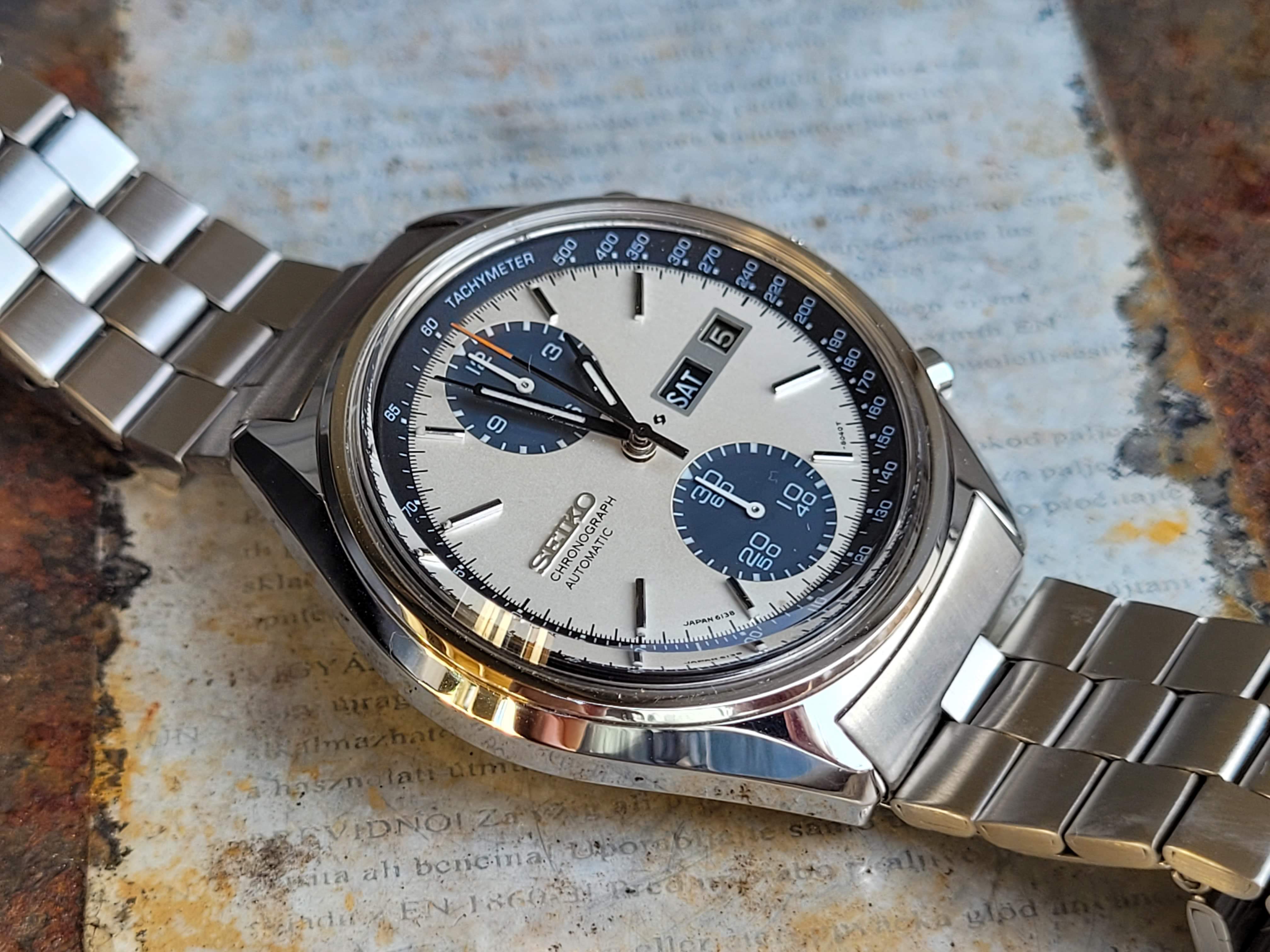

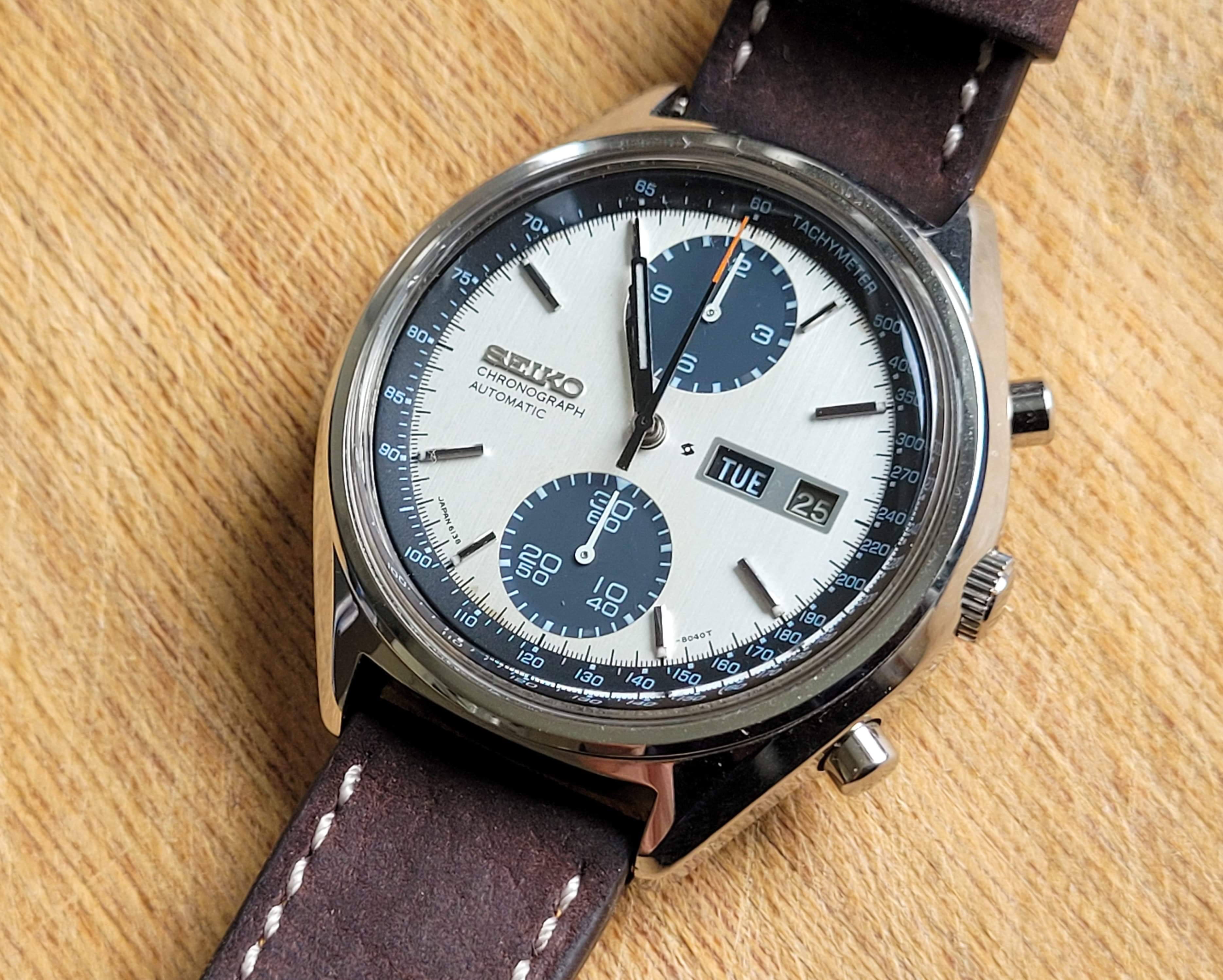

I just did a search for 6138s sold on eBay and there are a number of sales under $400, but ranging up to $800 and above. Seems like the difference is condition rather than specific models. Looks like $350 is a good price for a decent running watch but if you have $500 to spend you have options.

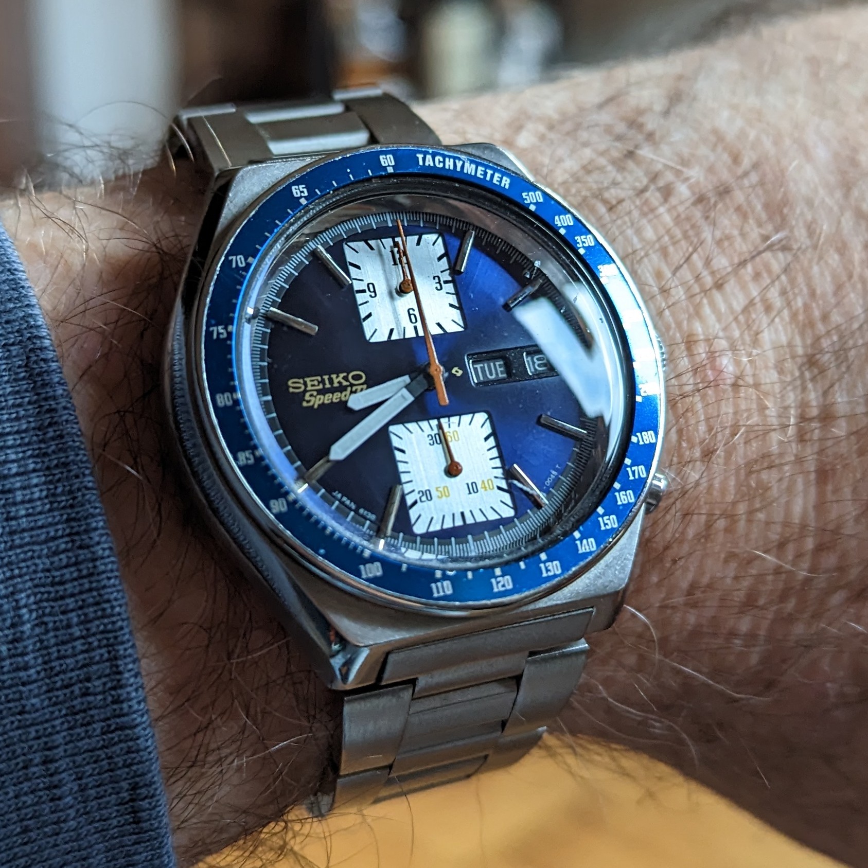

Here is mine
