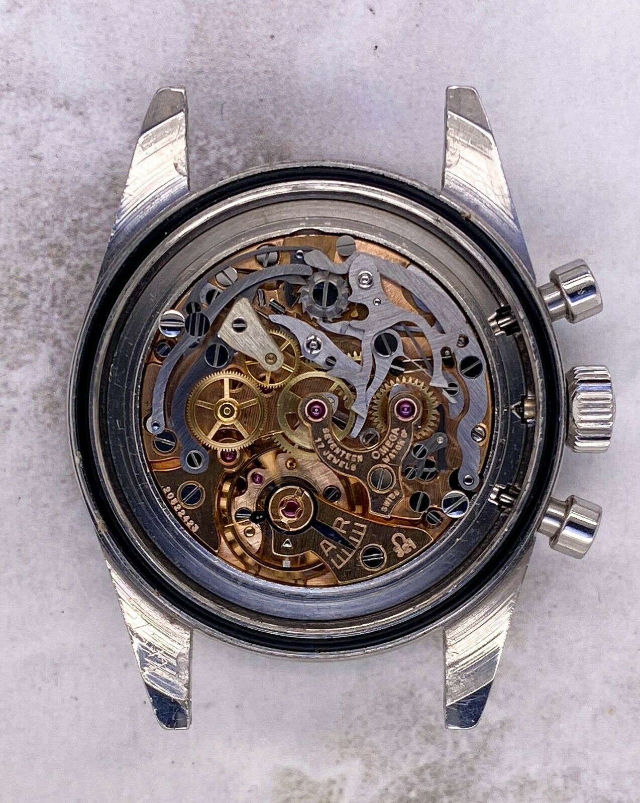

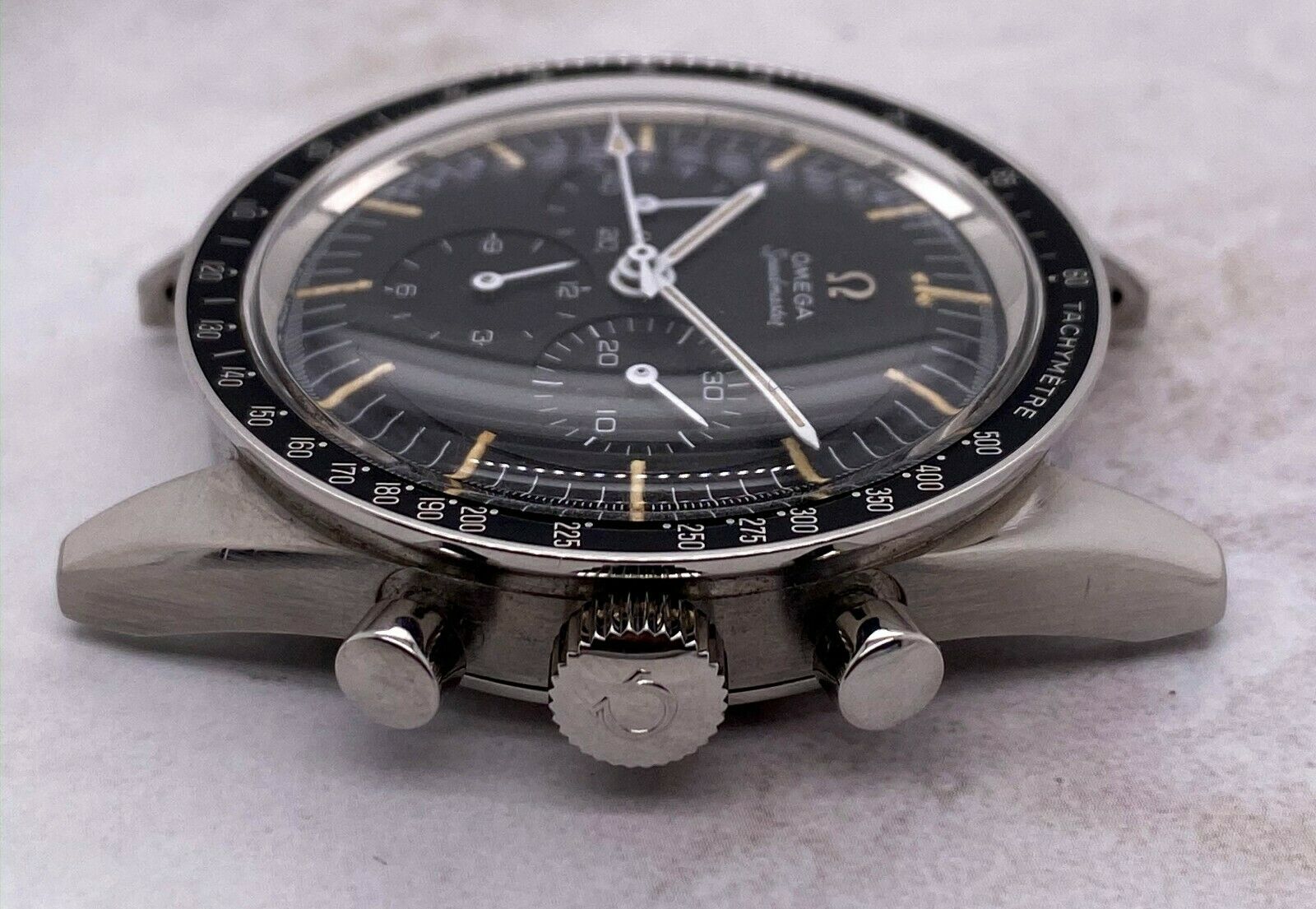

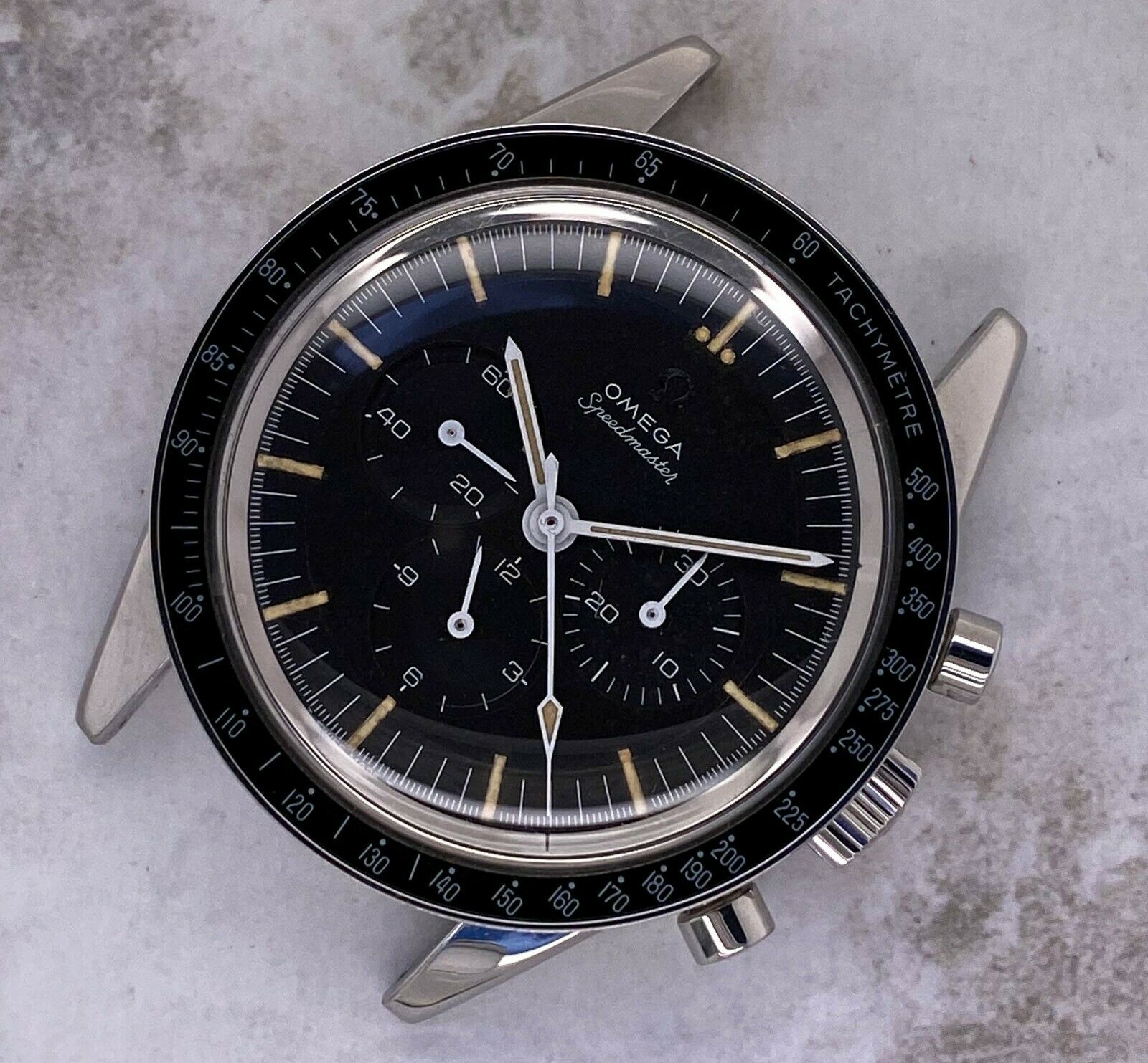

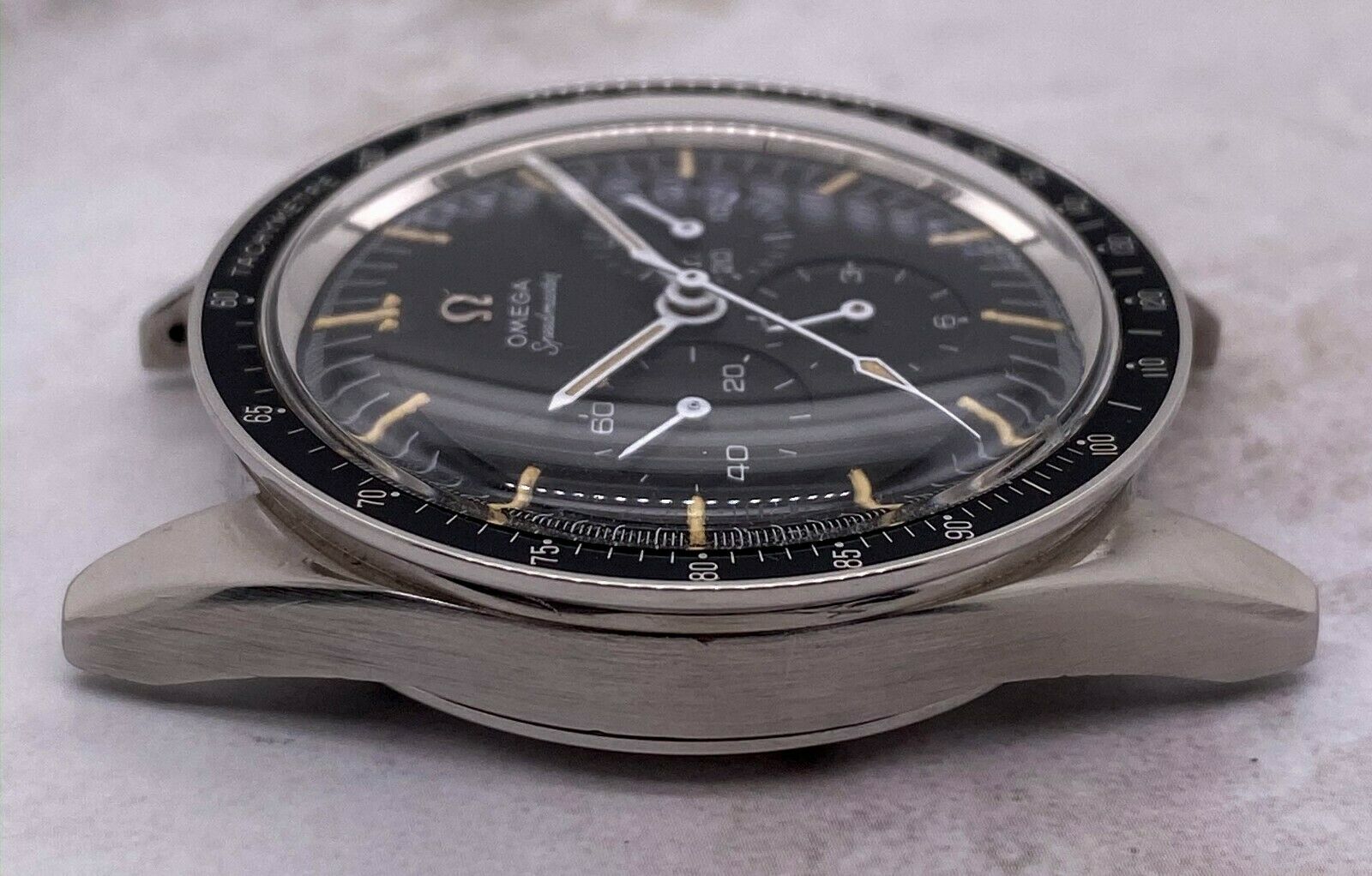

Looking at this piece, seller has been upfront and stated that it was been polished, and my take on this piece is that it has been somewhat aggressively polished due to the rounded lugs. But wanted to get a second opinion on here. Thanks!

I’d also rate it as over polished. I don’t know enough to comment on its provenance but it’s a nice dual and I guess it’s case of balancing out the pros and cons.

Yea agree, provenance looks fine albeit with a replacement bezel (which is fairly common), and the dial is in great condition. I'm not as fussed about the polishing but wanted to sense check what I thought. Hard to find sharp lugs in decent condition with these pieces nowadays.

The question is really, how much does it have to be over polished to pass on the watch and look for another?

My perspective is this one is borderline, and the dial's condition to me probably tips it in its favour.

Wrong pushers, wrong bezel, wrong crown, over polished case and hands that have been redone in an unnatural way (although this could just be the photo).
I do like the dial, the only thing nice about this piece.

It comes down to the price and what you want to pay. Airansun posts, "Wrong pushers, wrong bezel, wrong crown, over polished case and hands that have been redone in an unnatural way (although this could just be the photo)." Too many wrongs in my opinion, and maybe you can do better in the same price range.... but,ultimately, it comes down to your opinion and the price.

Understand the pushers and bezel are wrong, but can you elaborate re the hands? Curious to learn for future reference.

The white color just doesn’t look the correct shade that I’ve ever seen. It’s a subtle thing and could be color tampering of the image post photograph.
The whole watch looks prepared and I don’t like that.
