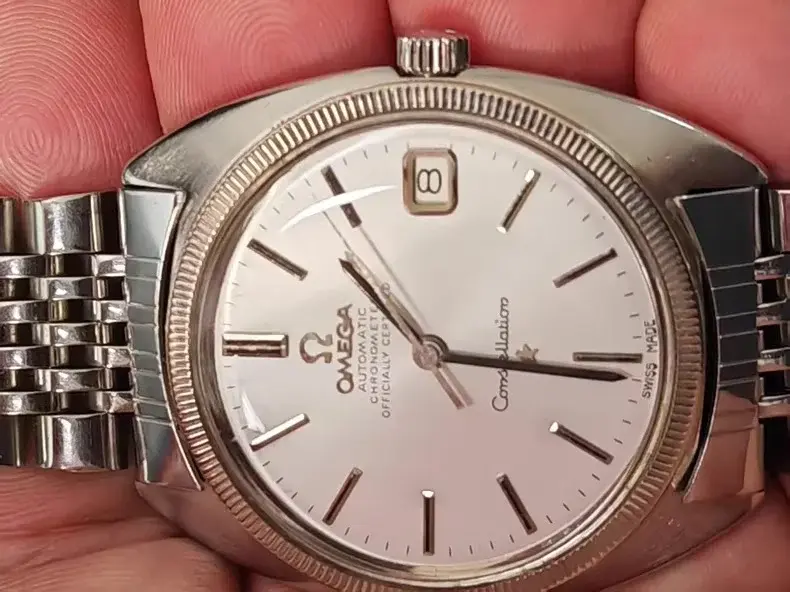

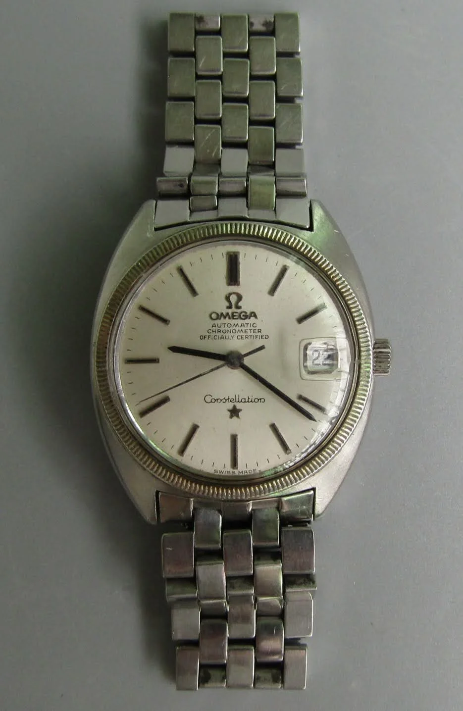

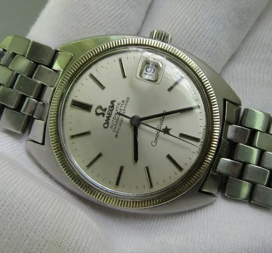

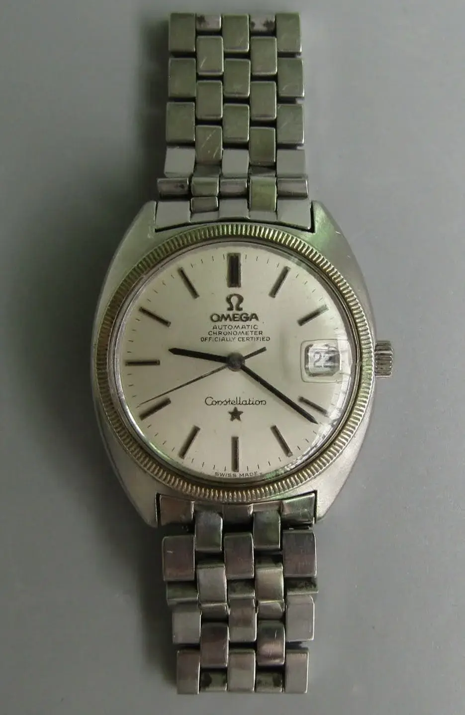

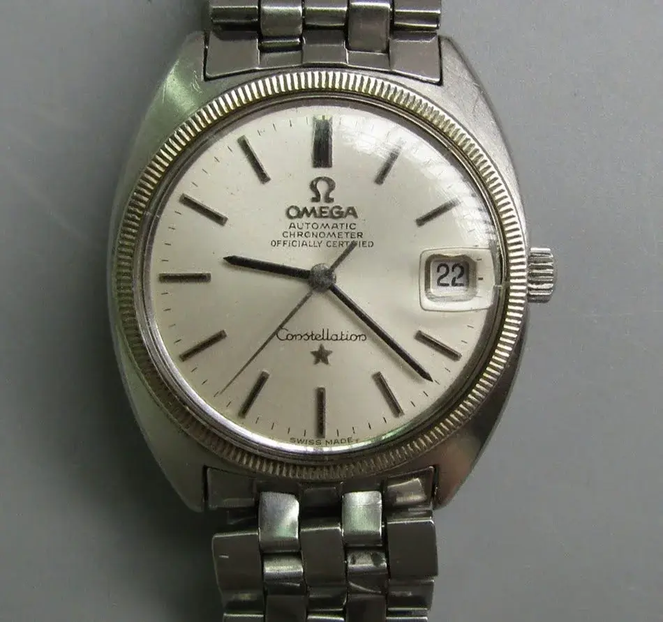

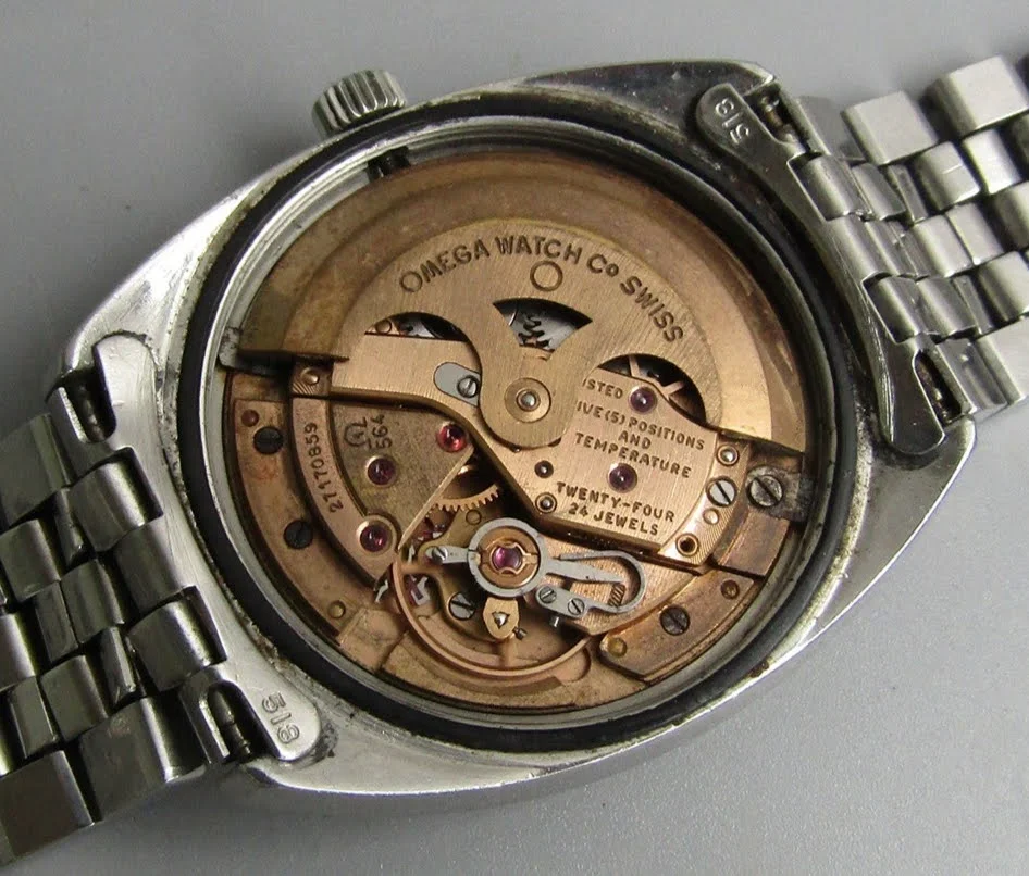

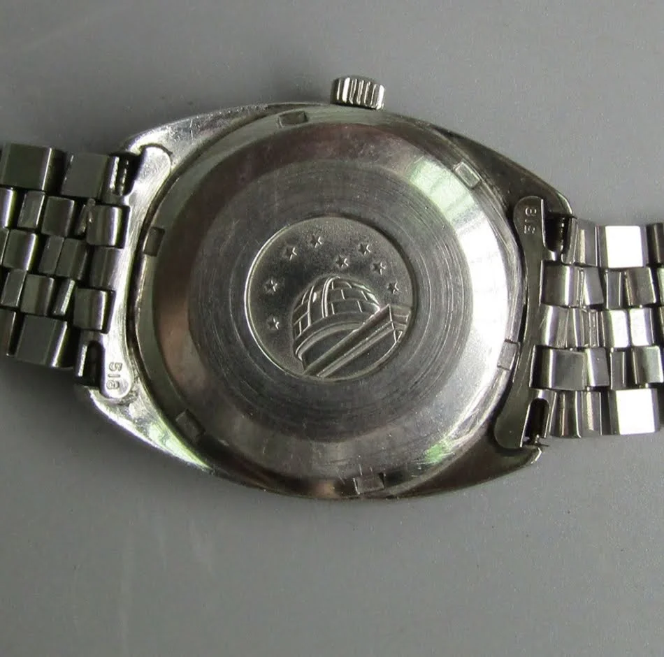

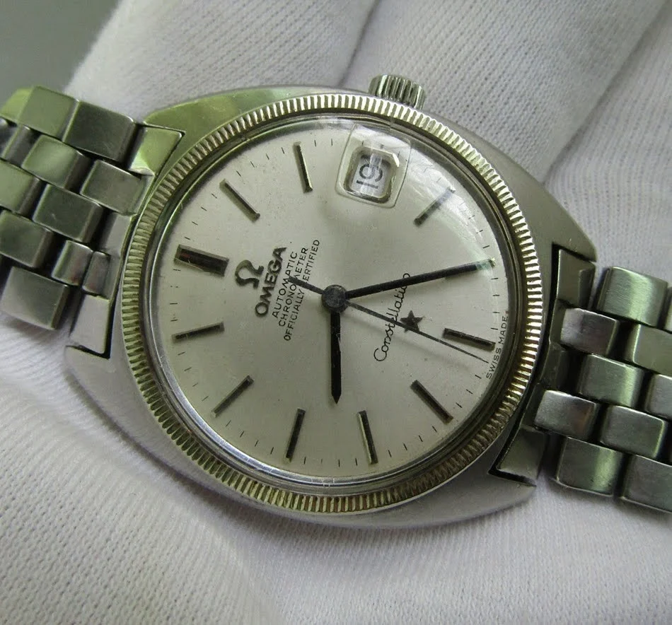

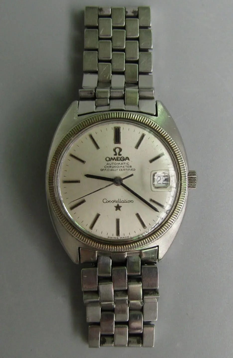

Does this C Case look okay?
121
57

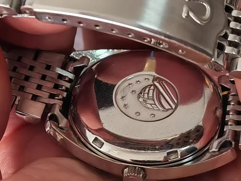

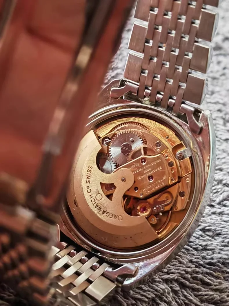

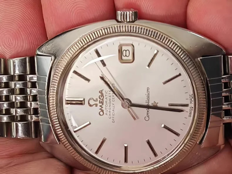

What are your thoughts about this one?
Does it look all original?
24,261
54,029
I'd prefer some good high resolution photos, but nothing is jumping out at me as wrong except for the bracelet which is obviously not for that watch.
24,261
54,029

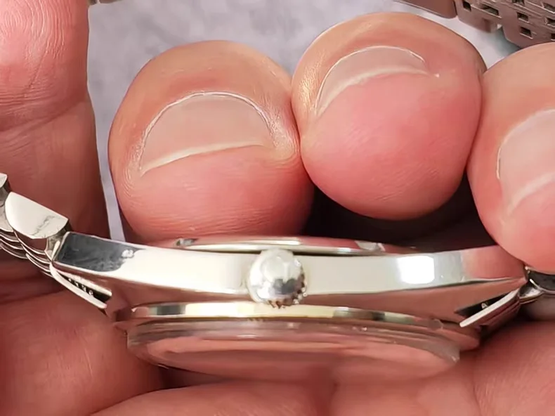

From those photos, I'm concerned about the condition of the case. I am seeing signs of dings that have been heavily polished-over with a buffing wheel. I'd like to see photos of the watch from angles that allow me to see the finish of the top surface, the sharpness of edges, etc. If the seller won't provide them, I'd just move on. I don't generally waste time on watches if I'm not able to judge condition.
121
57
Thank you for spotting this. I'll take your advice and move on.
121
57

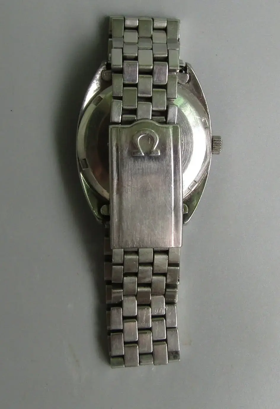

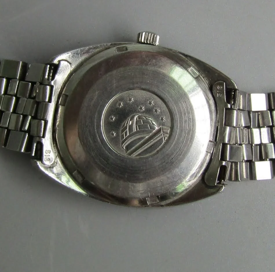

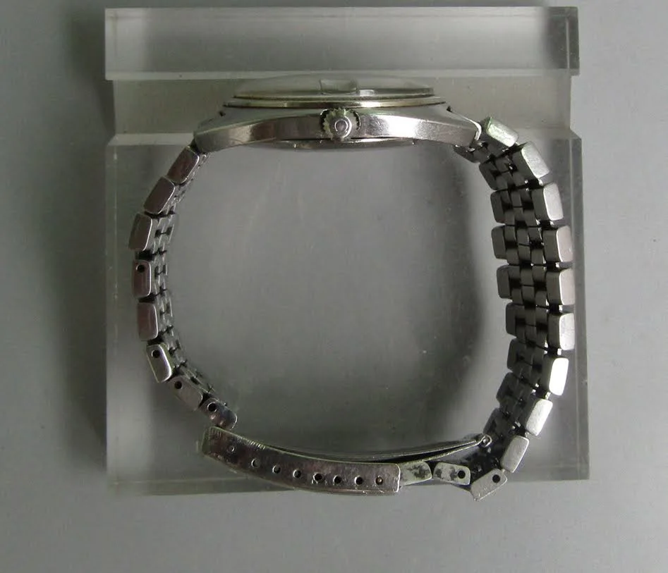

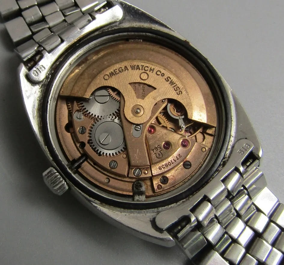

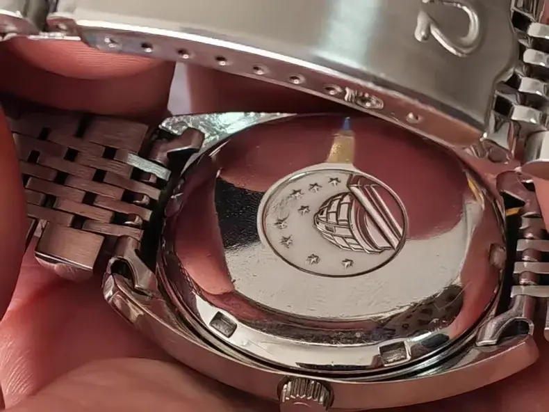

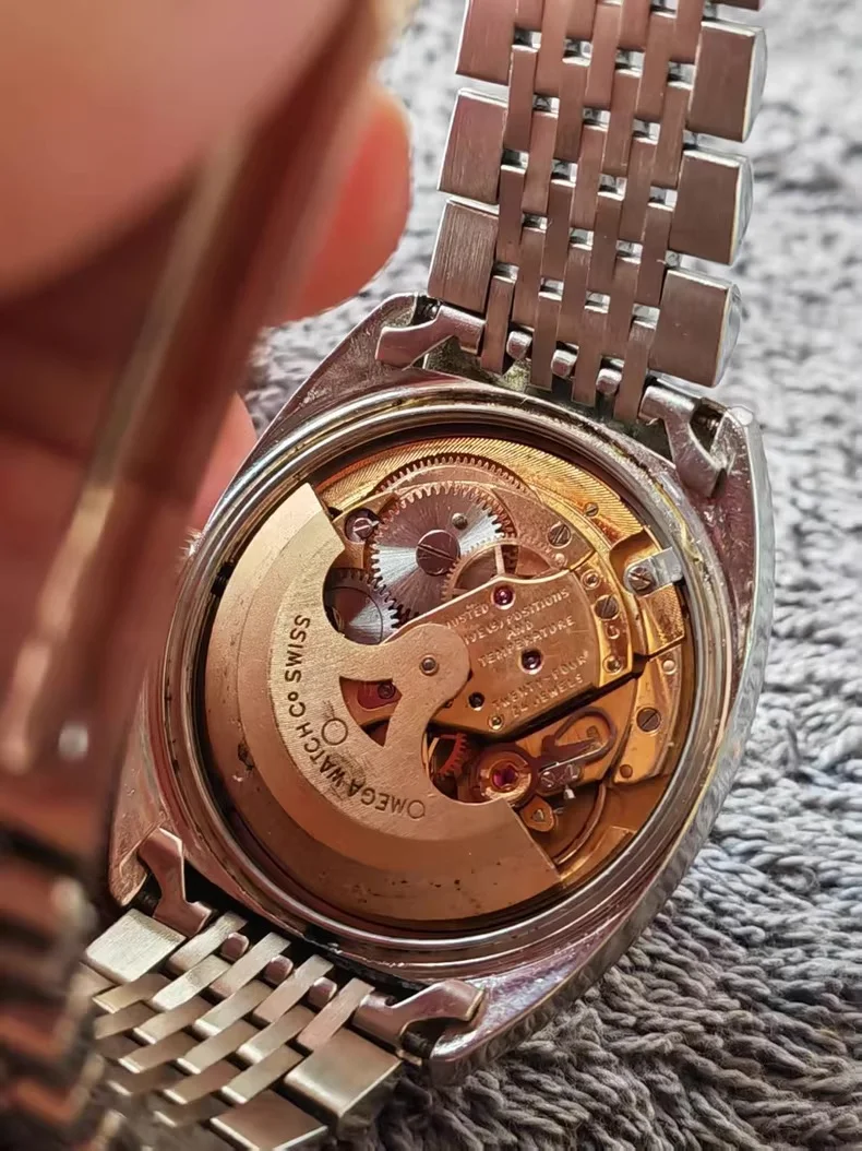

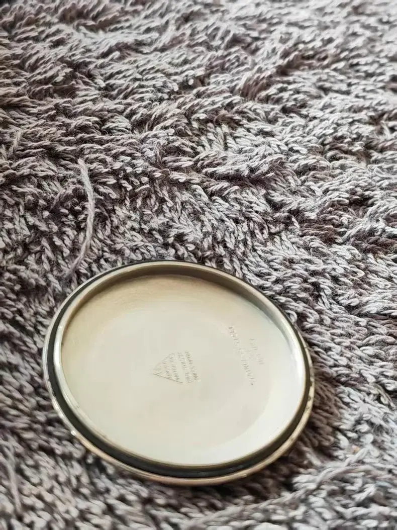

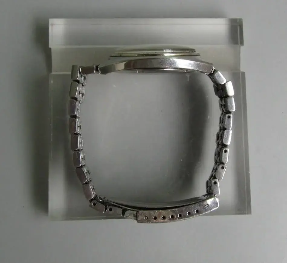

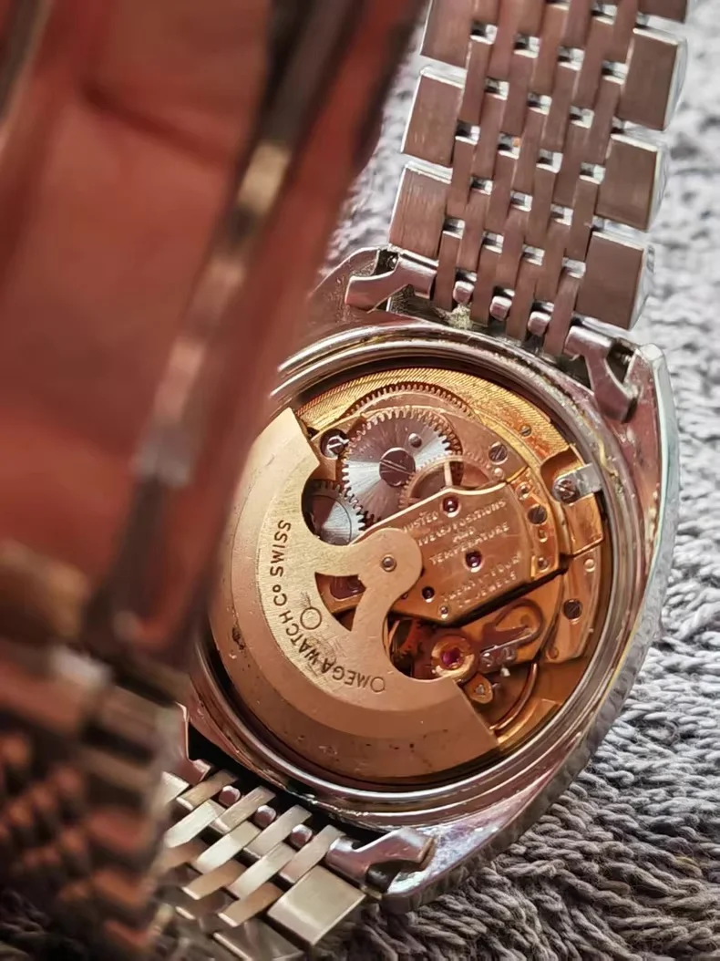

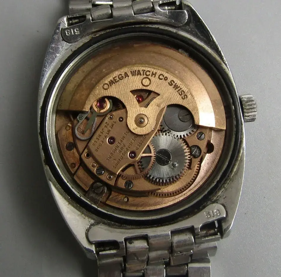

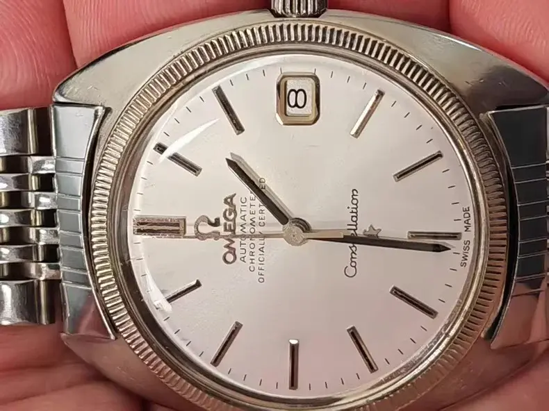

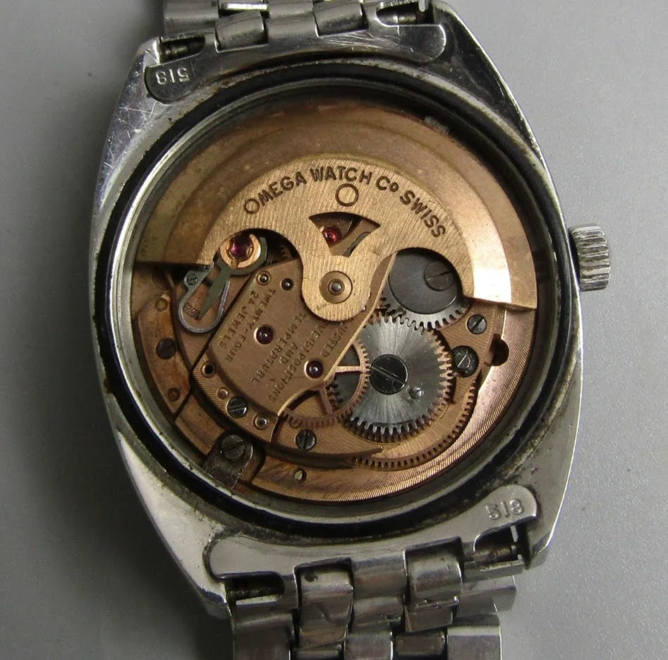

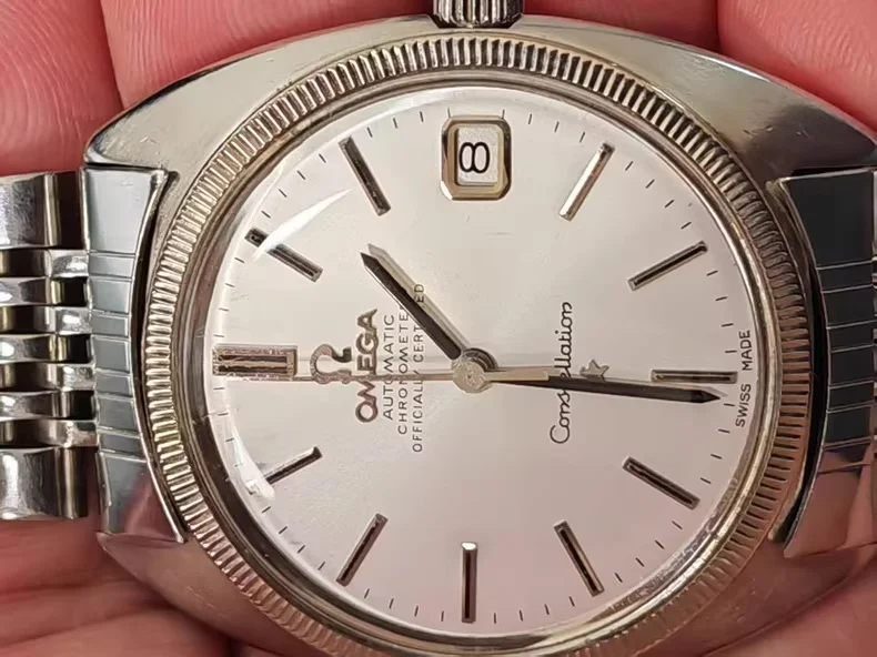

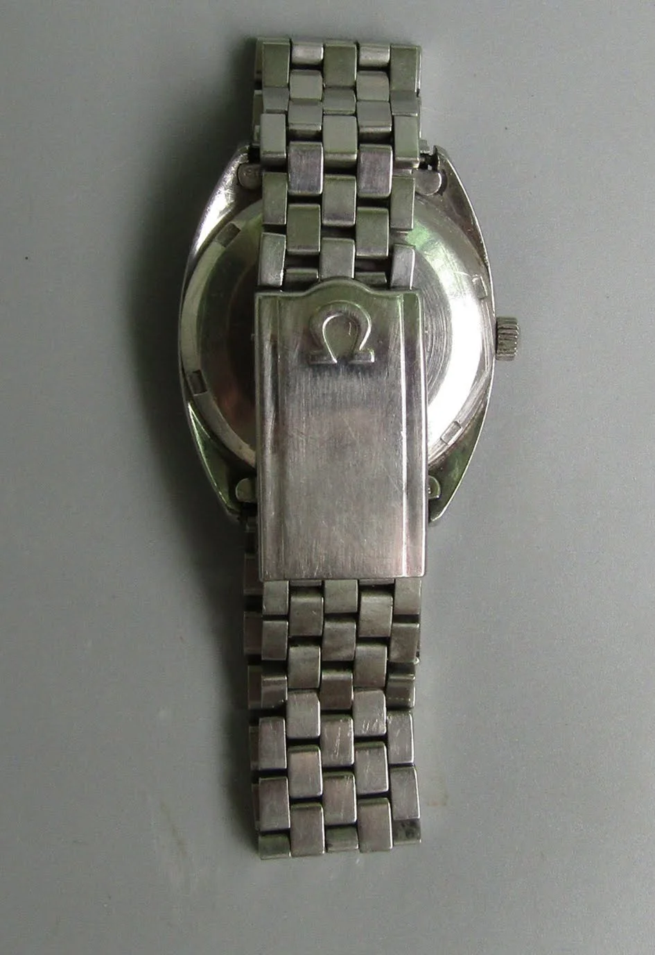

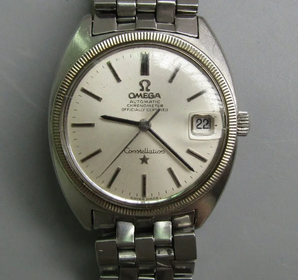

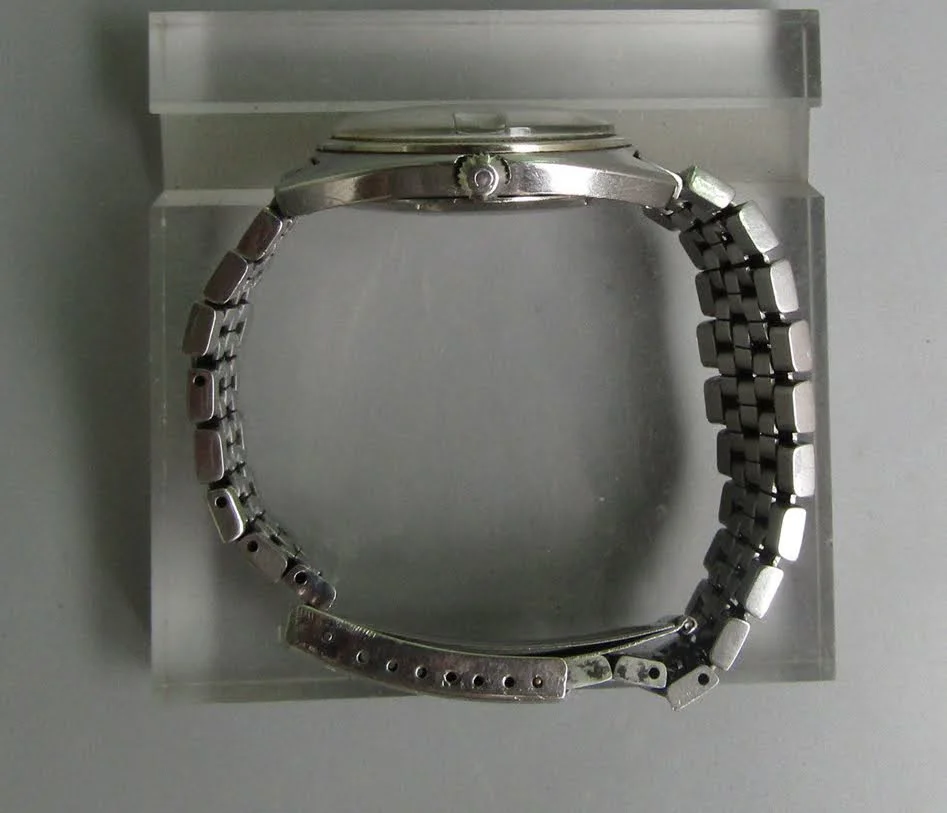

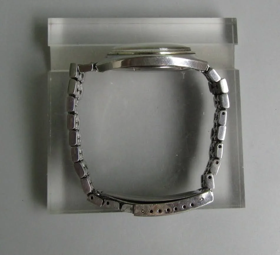

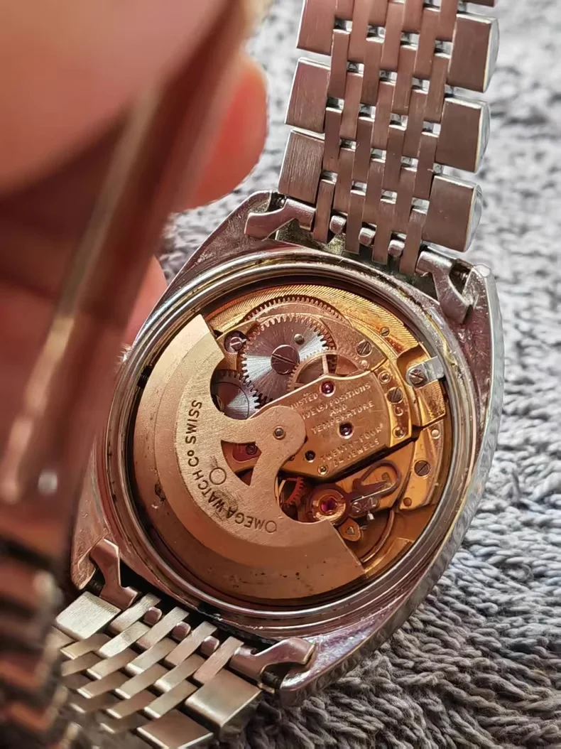

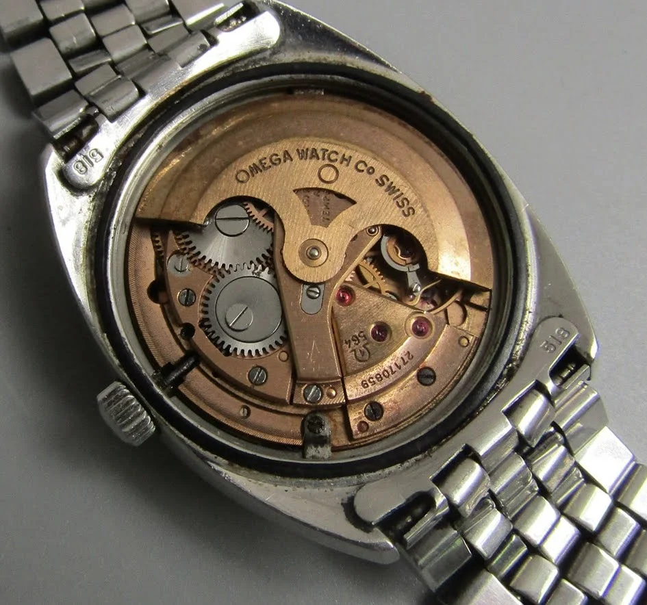

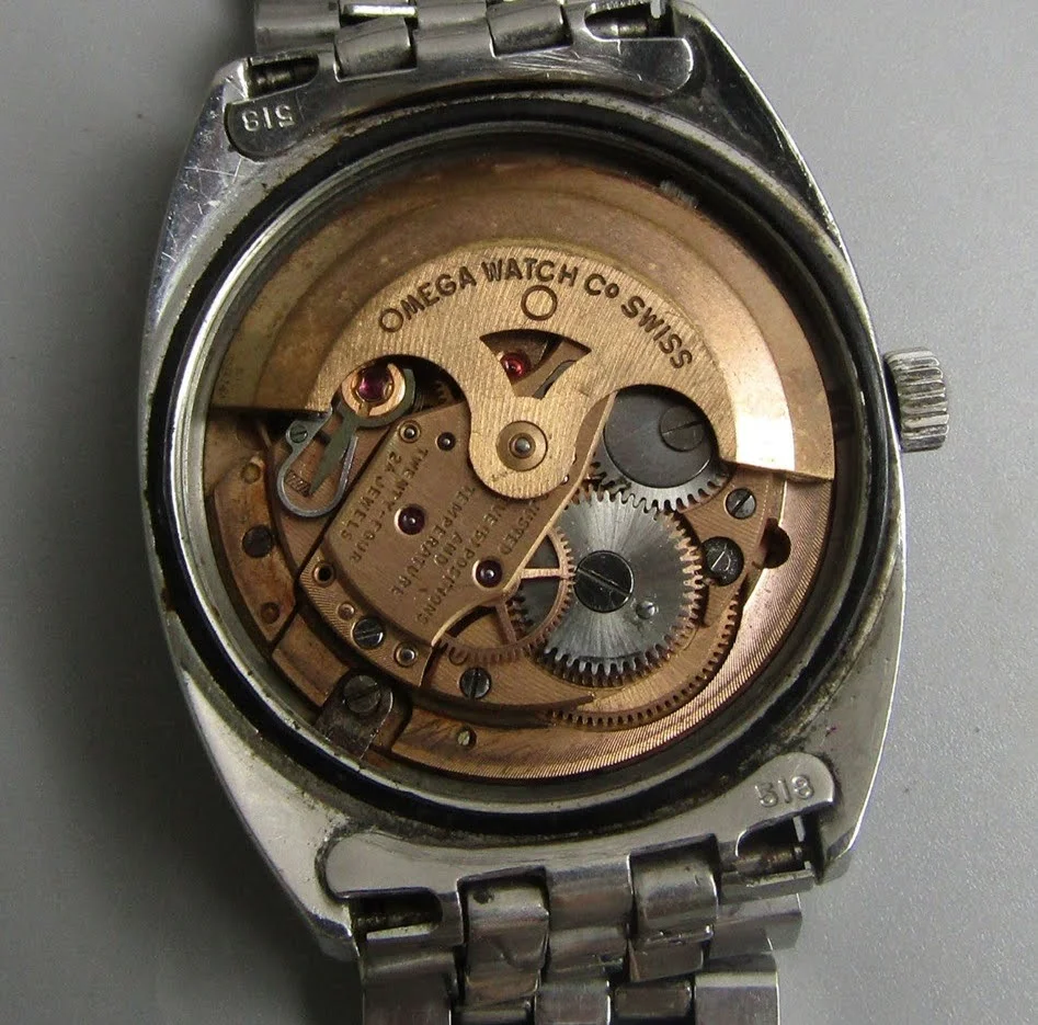

I'm also looking at another one. Any thoughts on this? Are the cyclops original to the watch? Thanks.
24,261
54,029
The case on that one also looks pretty bad, IMO. It's possible that we may have different standards.
8,629
71,364
It’s okay posting photos but you don’t say, and it would help us help you, where you’ve seen the watch, what you’ve been told and what the asking price is - which is relevant.
If it’s $200, then the advice would be quite different than if it’s $1200.
The second one is a tired mess; the movement and case are dirty, clearly not been serviced in living memory, the bracelet looks stretched and one link has been fitted upside down but appears to be genuine.
I’m not convinced by the first bracelet and it may be a cheaper aftermarket model - it looks to be of a different age to the watch.
1,036
2,563
First bracelet struck me as fake as well.
4,340
10,287
Refinished dial on the first one, too.
First one:
Second one:

Second one has correct 1040 brick bracelet and endlinks

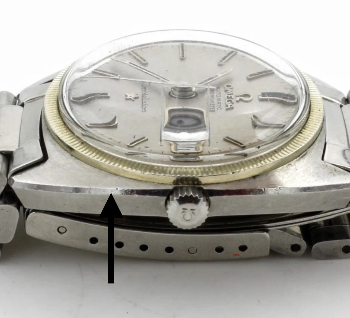

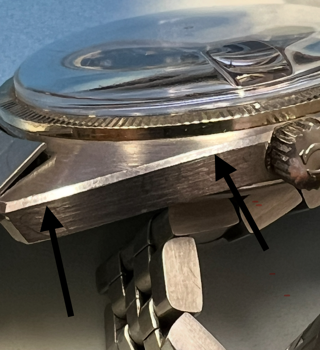

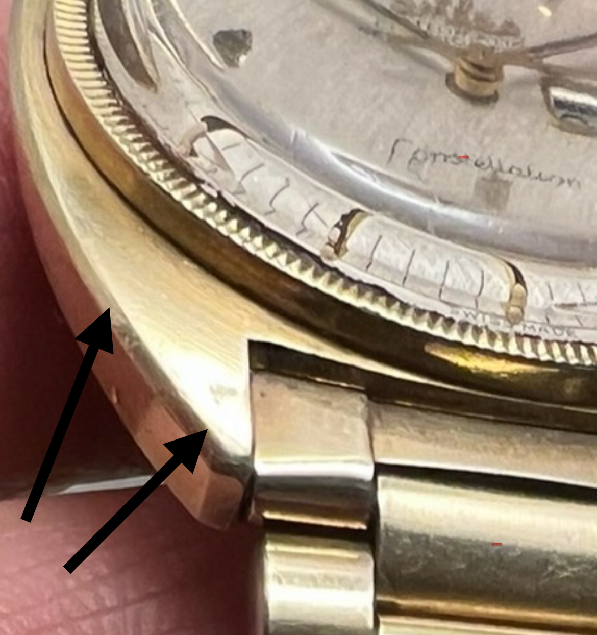

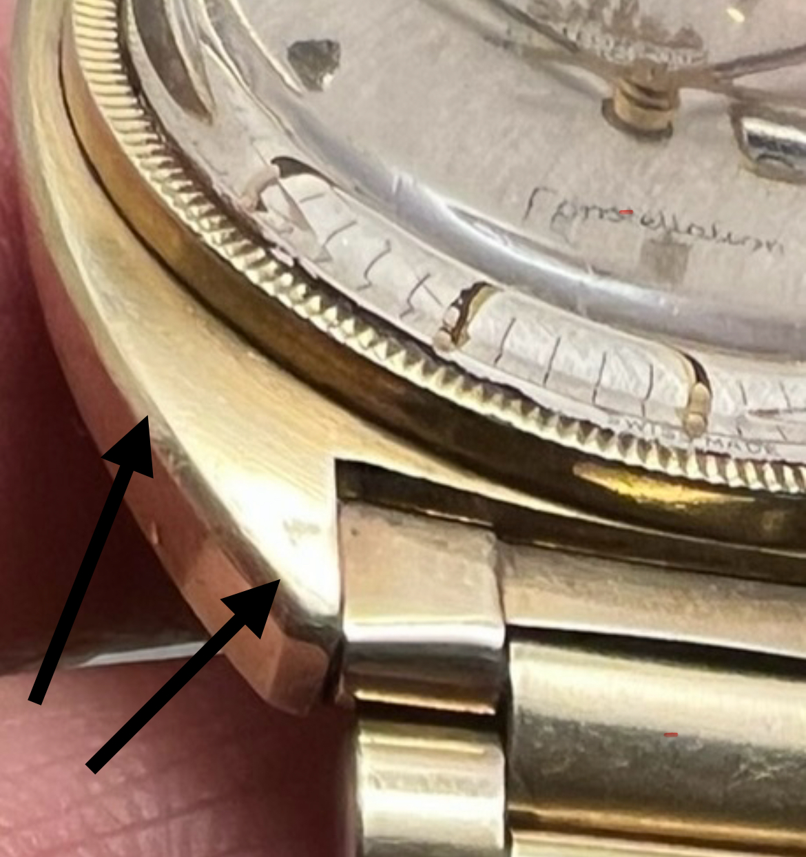

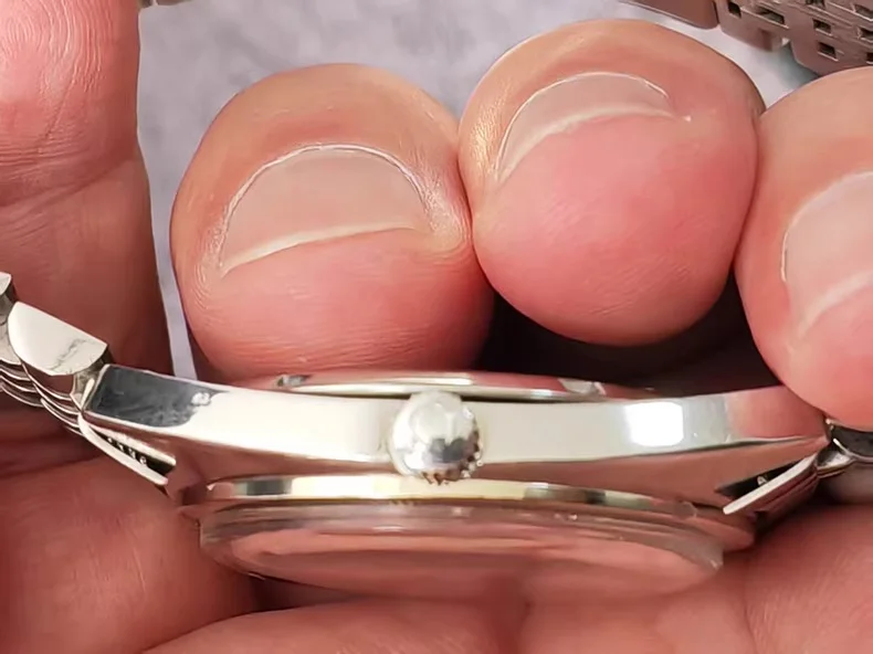

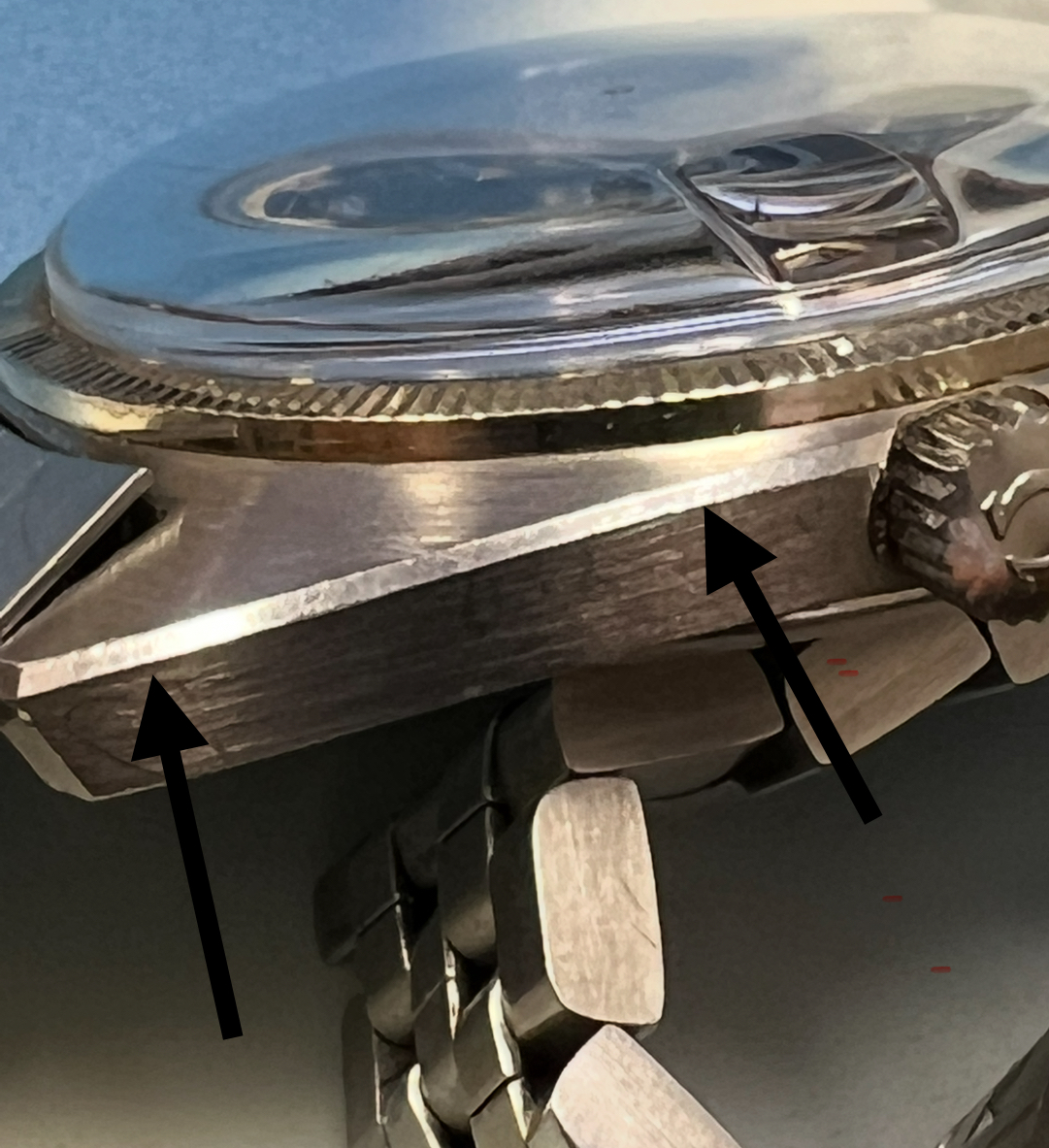

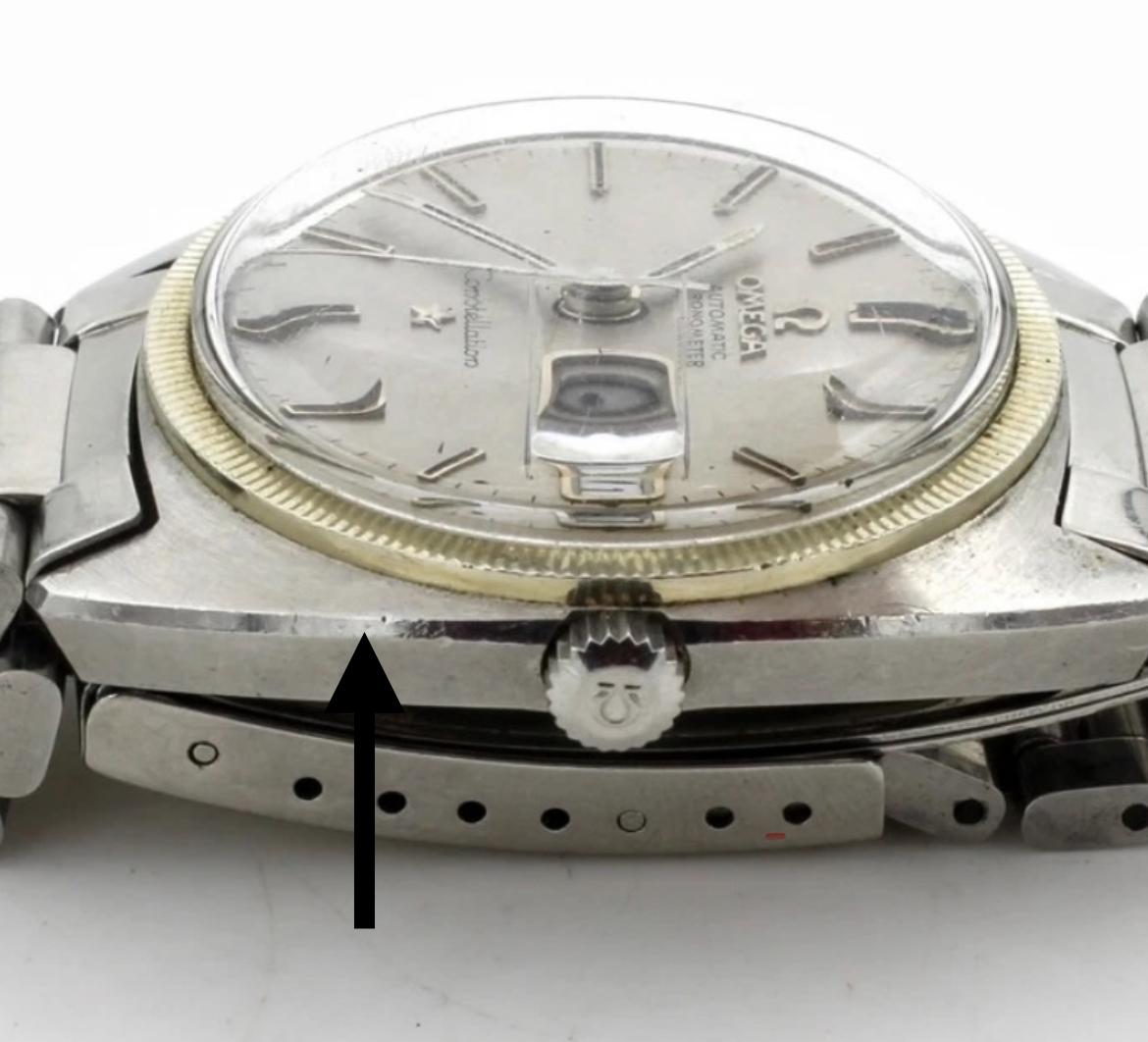

When evaluating case on these need focused views from side to see the sharpness of case with the narrow polished band separating the top and sides of case. It’s not visible from top views. Many selllers don’t provide this view. It’s often gone with polishing. Need to see this to evaluate sharpness of case. Gold or Gold cap cases are usually softer than SS. Some examples see black arrows
Perhaps, but mainly it's because I am familiar enough with what the C shape case contours should look like in the original state.
121
57
I just assume any non 1040 bracelet is an "aftermarket" one and yes I can see the looseness of the second bracelet too. It'd be nice to get it with the right bracelet but I generally prefer straps anyway so that's not a dealbreaker.
121
57
First one:
Second one:
Thanks for spotting this. Is it because the font is different, or it's too far from the edge? Is the SWISS MADE font always consistent?
121
57
That is very helpful. Thank you for the pics of the original bevel so I have a better idea of what an unpolished example should look like. Hmm I'm not sure I can tell with the photos of the two watches above.

When set below the 6 marker, the Swiss Made positioning is generally centred directly below with last last S slightly below the marker.
121
57
Ah, I see. Thank you for the explanation!
Because the rest of the dial of that watch looks okay...
