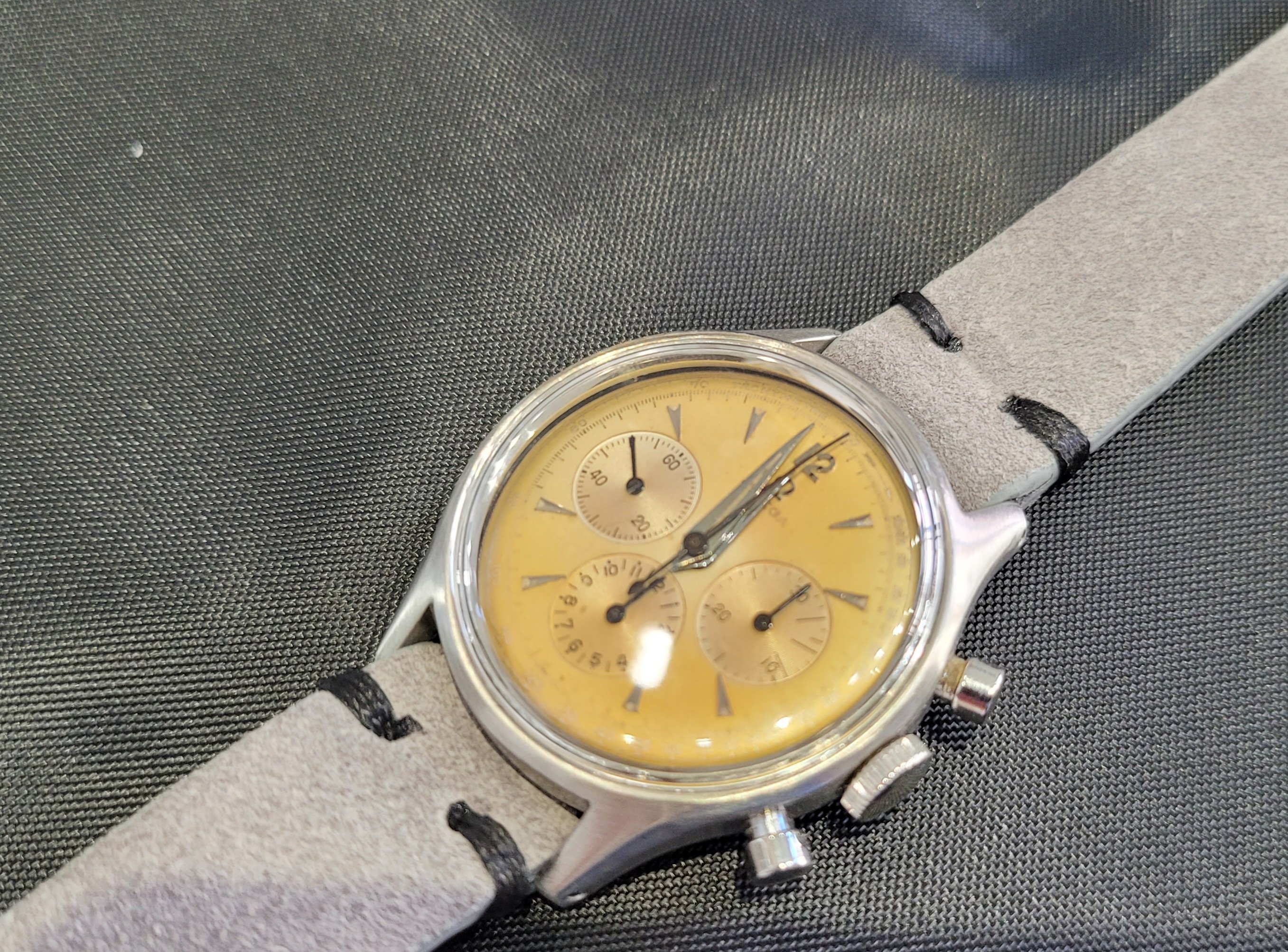

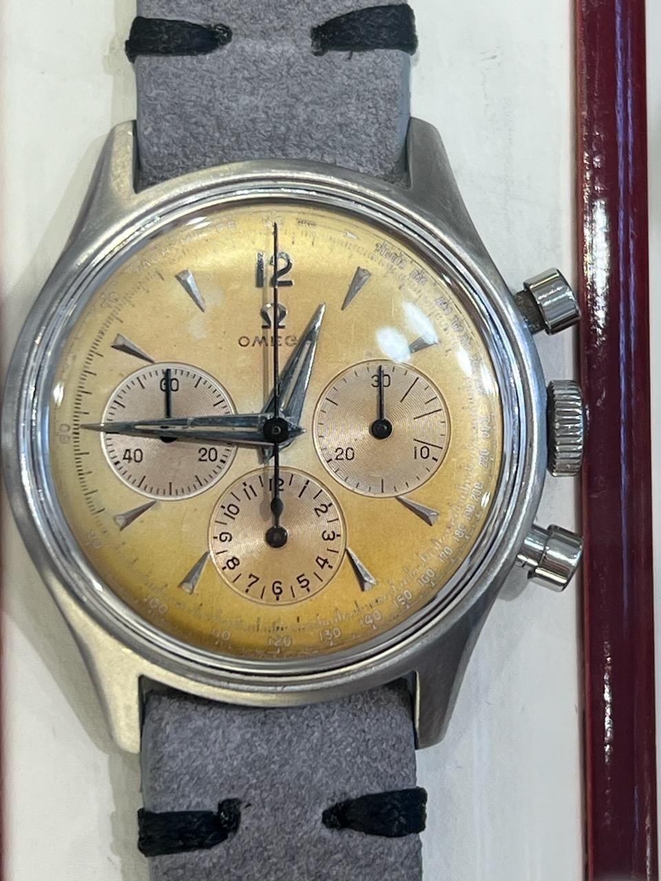

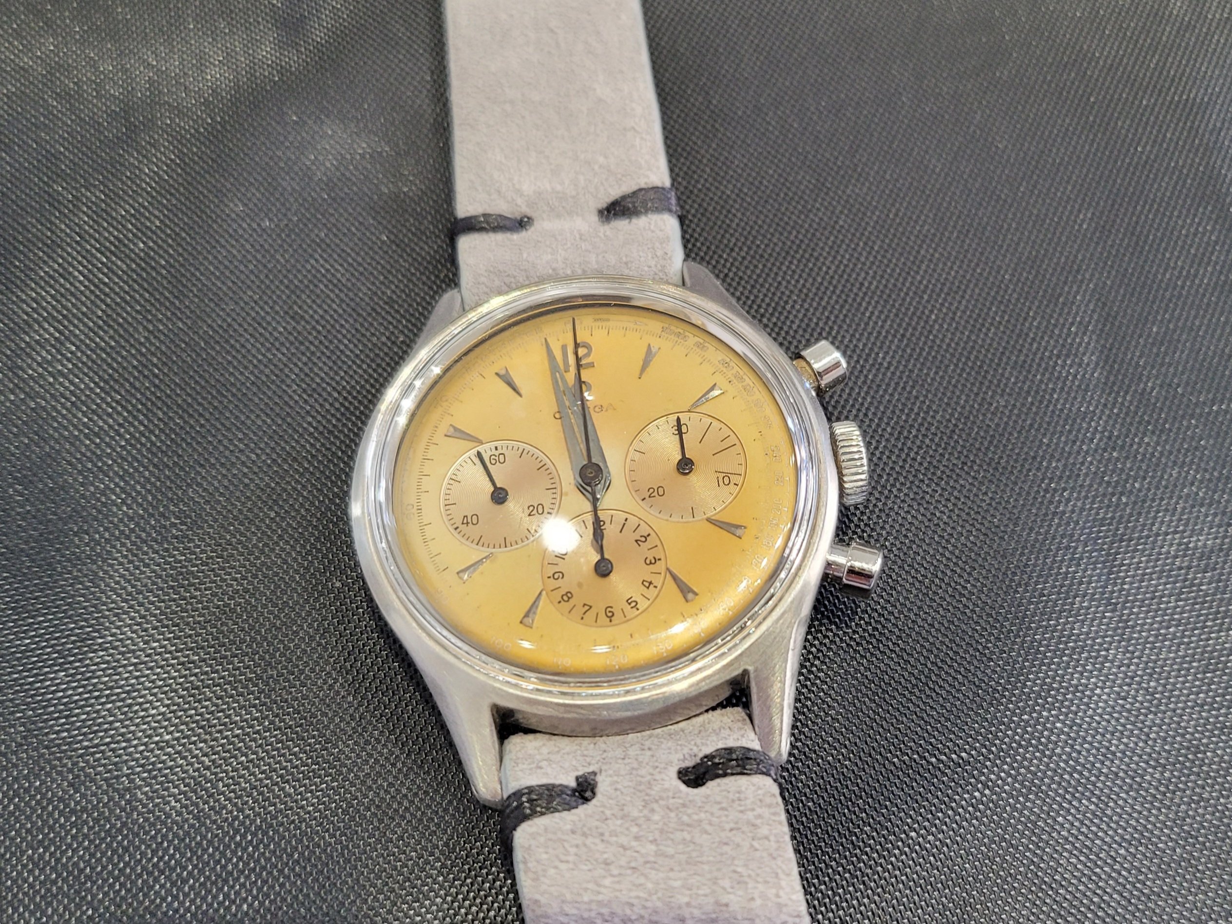

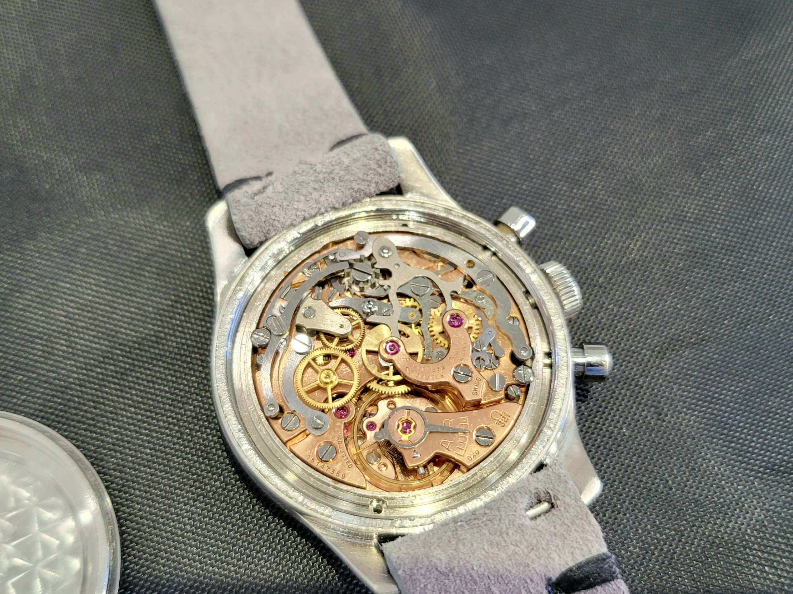

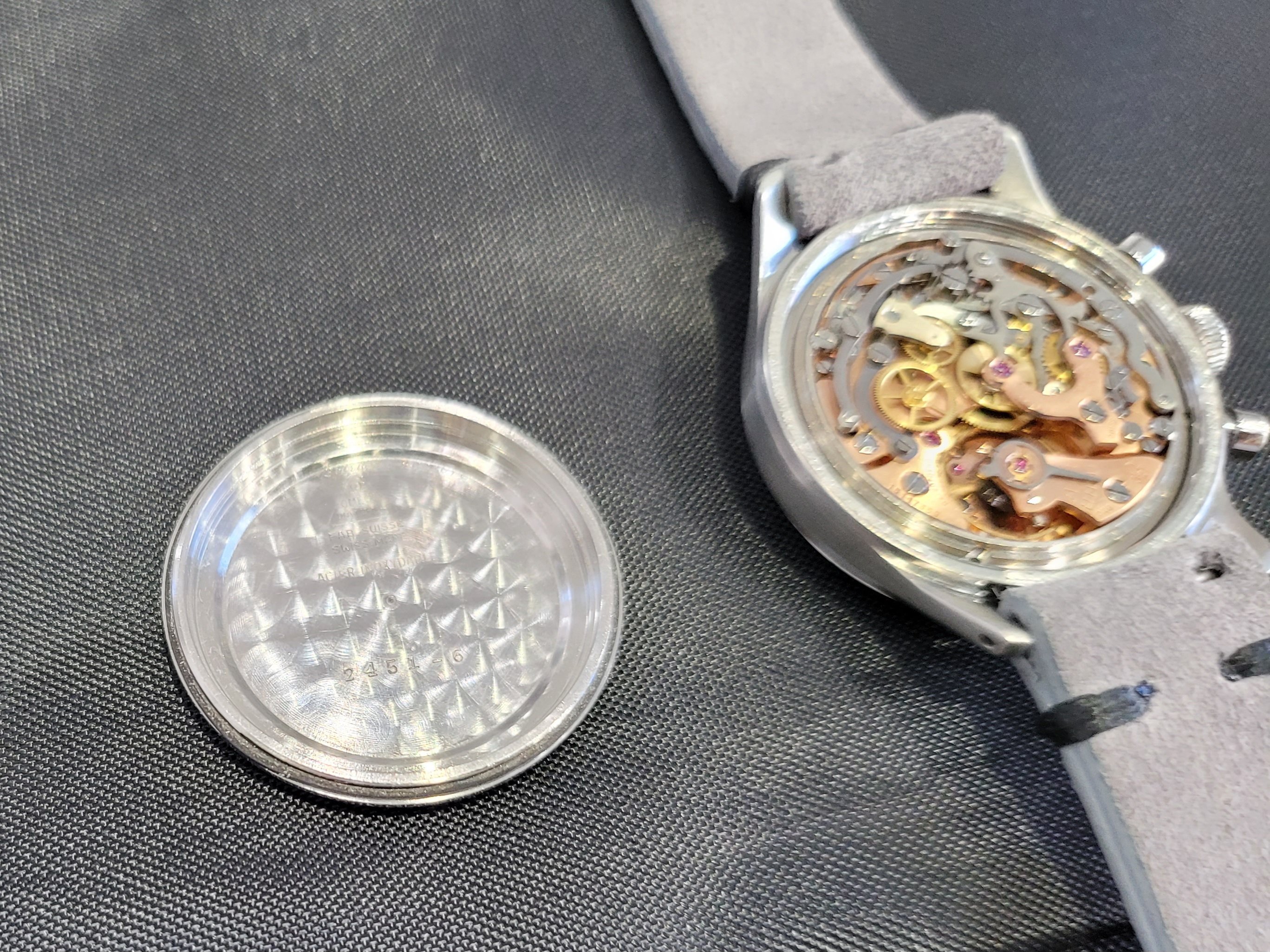

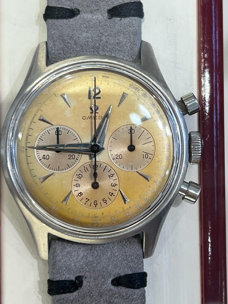

Hi OF. Been more on the lookout for vintage watches lately and instead of restoring an older Cal 321, I was recently offered this one by my local watchmaker with original dial. Sorry my pics isn't the greatest, but hopefully it captures the essence of this Ref. 2451-6 with a serviced Cal. 321. He says he's giving me a great deal because of the beautiful patina on this original dial. It's an attention getter. So how much does patina actually add to value on vintage Omegas?

The big problem with the watch is that the dial is (water) damaged and missing much of the minutes and tachymeter tracks. That will significantly devalue the watch so any talk of increase value due to the patina is misplaced with this one.
13,538
23,482
Nine times out of ten, patina has a neutral or negative impact on value.
Agree it’s certainly not a plus on this one.
2,343
1,469
That would have been a refinishing project.
what great deal is he asking for it?
8,850
62,702
He's asking a straight $4k for it.
Yikes, but baby needs new shoes!
Not patina, DAMAGE, rusted upper pusher shaft, too....water damage
787
6,747
That's damage, not patina. I wouldn't spend $4k for something in that condition.
3,297
23,949
This watch looks like it smoked for about 50 years.
24,815
55,164
In this case, I would say that although the patina has some appeal, overall the condition of the dial detracts from the value because of the non-uniform coloration, badly faded printing, etc. It's the type of watch I'd consider at a bargain price, and then just enjoy it as a curiosity. I think that $4k could probably buy a very good example of this reference. So I can't imagine he will get even $3k for it, and $2k-$2.5k is probably more realistic. The dial is really rough.
