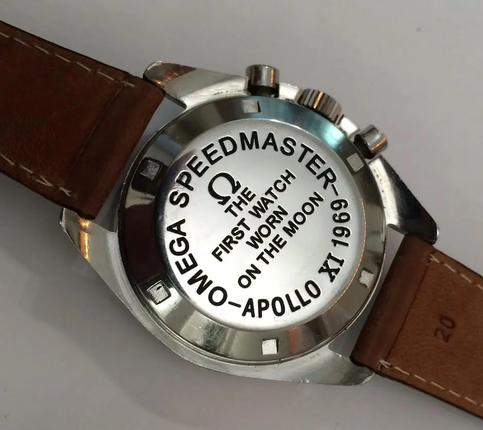

The MK-distinction was my idea, as I did some quite extensive research over the last couple of years and found out that
a) three different font versions of the SWA11 casebacks (as documented in the MWO-book) exist
b) three watches with pointed „A“ casebacks surfaced, all delivered in 1970 (two of them to Argentina, one to Switzerland)
c) all other watches, which were mainly delivered to Japan from 1971 onwards hat flat or semi-flat „A“ fonts
So please, blame me for the MK-1,2,3 classification, I adopted this method from the Rolex vintage world, where this is quite common for models, inlays, dials, casebacks et al and also derives from empirical findings over many many years. It certainly is a probably premature classification, but the good thing is, that it can be a catalysator for further discussions and hopefully more findings where we can all learn from and at some point verify or dismiss a hypothesis.

Just for clarification, and for those who haven‘t seen what I wrote in another thread with a similar topic:
I bought my watch about ten years ago from a well respected dealer who used to live in Argentina and acquired it there. As the watch was produced in October 1970 and subsequently delivered to Argentina, I have every reason to believe that it never left the country before it was exported to Europe in 2015. On top, the serial number fits perfectly into the short period in autumn 1970, where Omega mounted the faulty 220 bezels.
The SWA11 caseback puzzled me, as common knowledge at that time was (and probably still is), that those casebacks were meant for the japanese market and came later (from 1971 onwards). I questioned however, why anybody would swap a caseback in Argentina back in those old days, where basically nobody was interested in such nerdy details and prices for Speedys were nowhere near „interesting“ levels.
My curiosity intensified when I found a couple of very interesting discussions in this forum on this topic and the findings of other pre-1971 SWA11 Speedys, so I posted my watch here. My intention is to help getting more evidence and a clearer picture of what could have happened in those days and find some more pieces to this puzzle.
Besides that, I love my old and well worn Speedy and don‘t bother if the caseback came with it originally or later. 😉

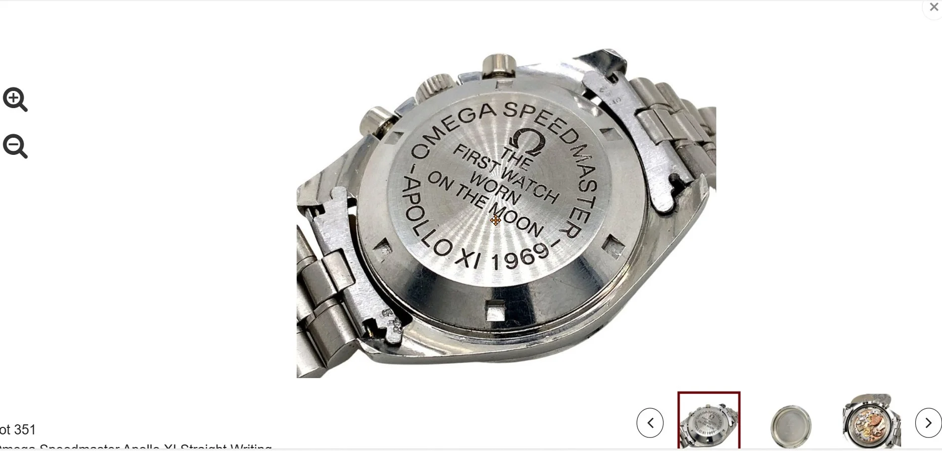

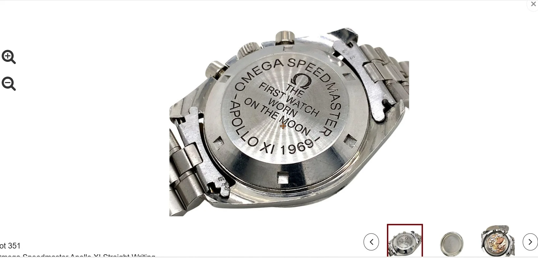

And a very nice A11 with the early number 29'6009xx and a DON bezel. It is scary close to the earlier posted one from dr Crott so it could be the same watch ? With the Wako Japan one it is the 2nd one with DON bezel.
So that‘s another earlier one then? 🤔
1,894
3,637
Correct, but it is the same watch as the one from Dr Crott auction last year if i compare pictures of the bezel damage, but now without the 1116 bracelet and the caseback aged dramatically in the last year. All the black paint is now gone.....

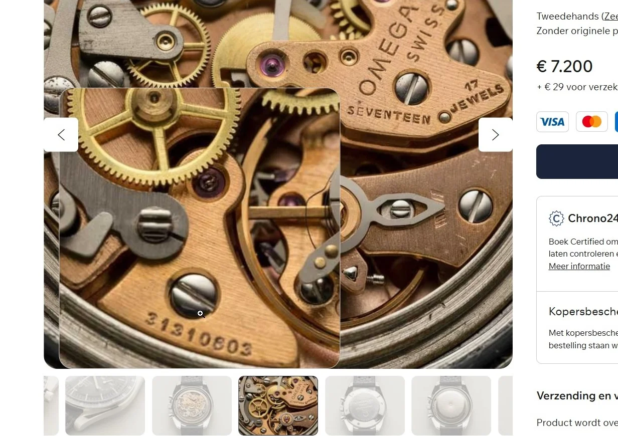

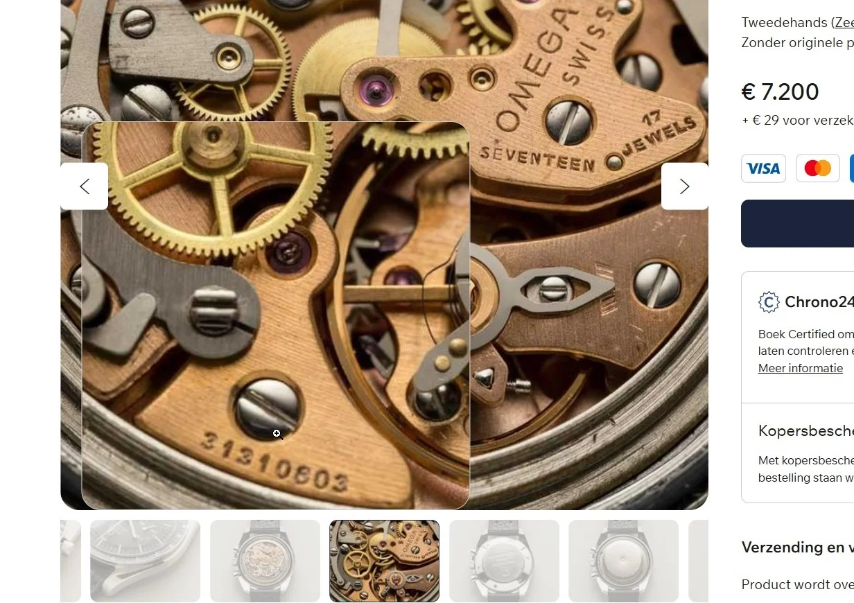

Here is another very early one with mov.nr. 28426774. The guy unfortunately sold it and has no pics of the extract, but told me, that he remembered it being delivered to Spain originally. Didn‘t show it here before as I could not verify it, but probably it pops up somewhere 🤷‍♂️

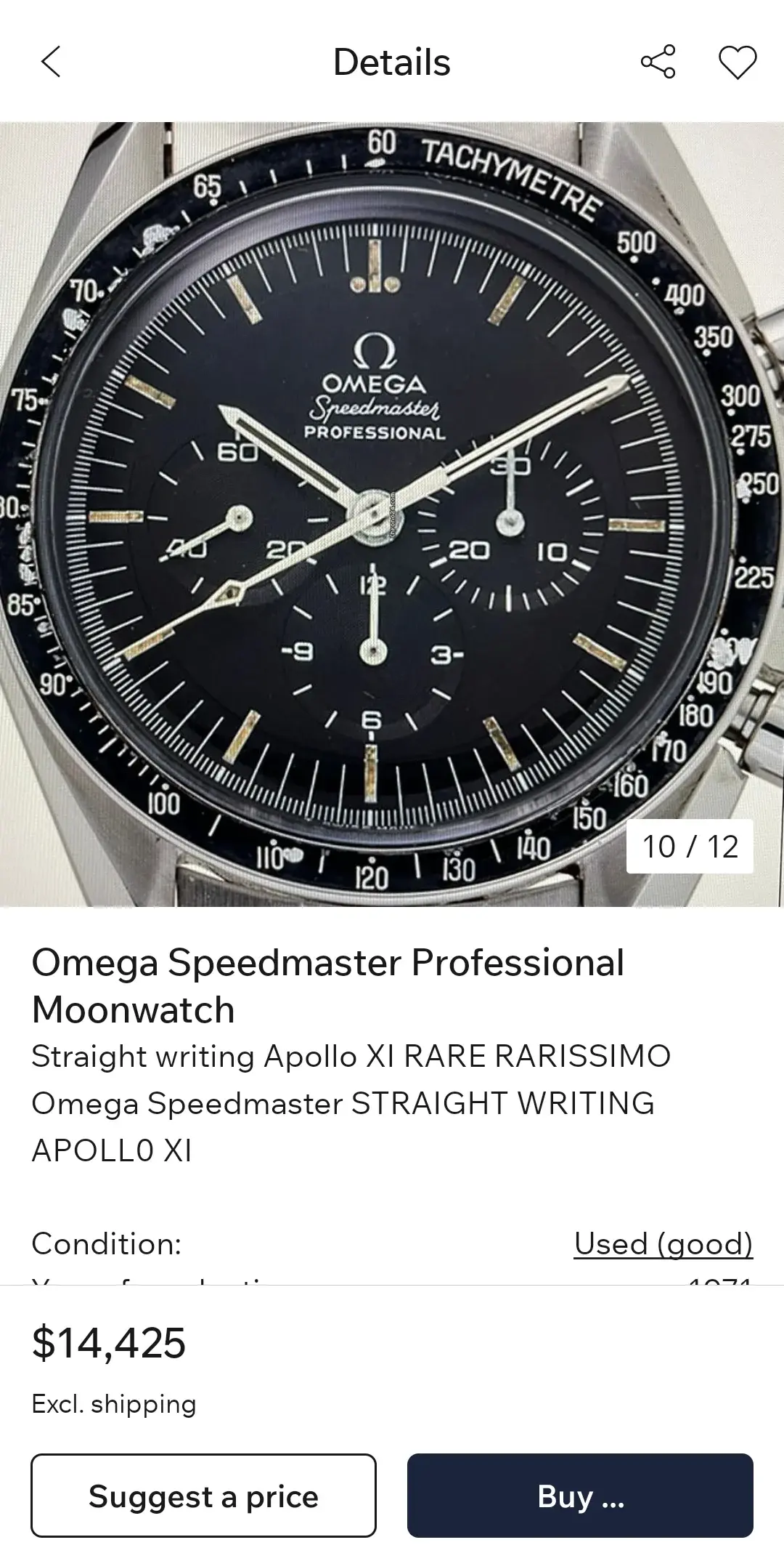

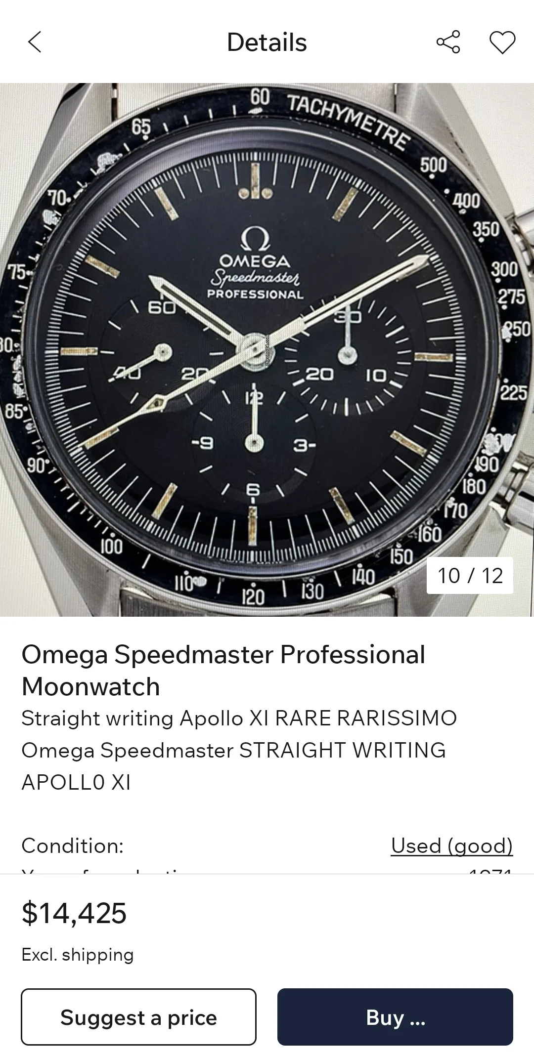

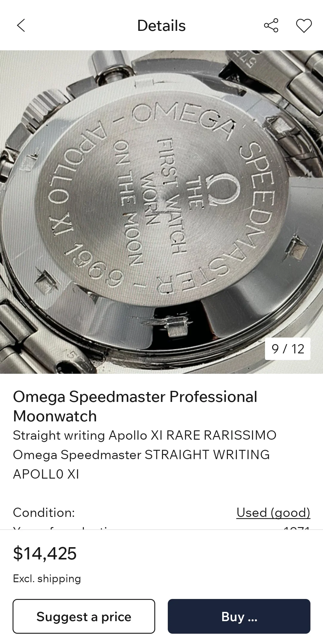

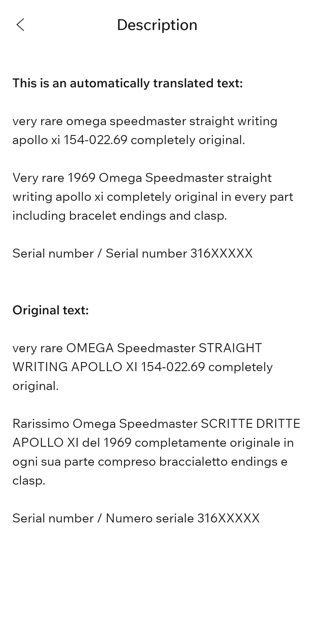

I think thisx316Xxxxxx is new. It appears to be the "most" rare.
1,894
3,637

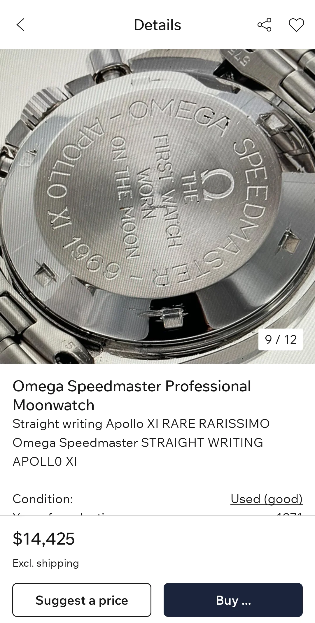

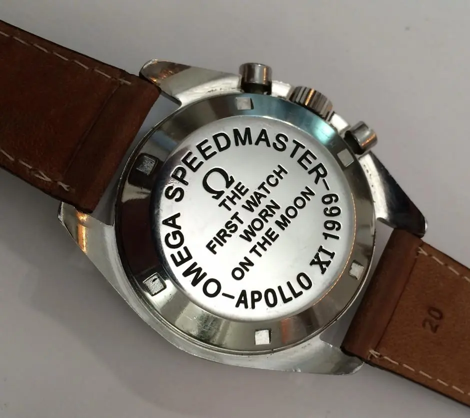

even on the gold versions 145.022-69 BA the engraving is not very refined imo, the other version look like better quality work to me. Maybe they also tried a first run on steel before doing the 18K one s ? The movement nr needs the extract to date it as it is early indeed, so maybe another example of "use what is still in stock".
New to me also, and you mean rare as it is the Japanese version ? I think i have seen less examples of the more rounded/bold letters version above myself, but i havent counted. Going back to the OP original question ; for an estimated 100 - 300 pieces production they sure do show up frequently. And with a 1014 pieces of the gold version wouldnt there be even more in steel ?
6,472
22,002

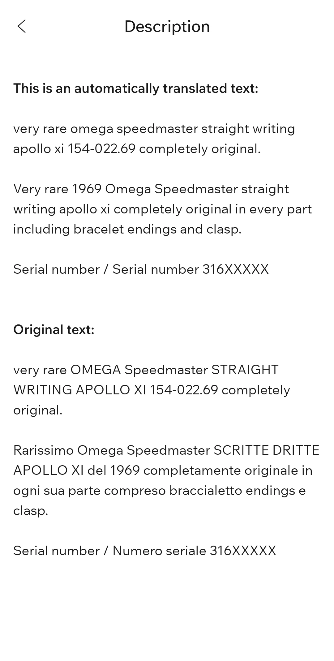

Bad joke. Seller describes it 'very rare (rarissimo)"
Could well be! Interestingly, all of the early numbers (pre 31 mio.) that I have seen so far have the pointed „A“ fonts that look similar to the gold version, so probably they had an early production run for those and changed the design for the later „japanese batch“.
