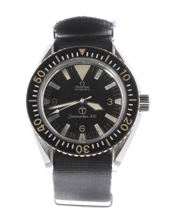

Dodgy Issued SM300
576
1,201

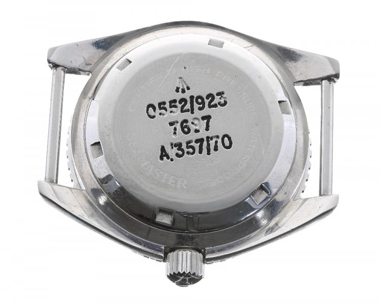

That would need to come with provenance at that price, along with a bit of honesty regarding the replacement hands. Case, crown & bezel look all too tidy for a Military issue piece also. Serial etching on the back looks too bold to me.
825
1,808
What about it jumps out as dodgy? The mismatched lume?
the T on the dial is about 2 times the normal size and a different font than typically used.
792
845
The numbers in the back look odd to me...almost as if they were hand engraved or deepened
