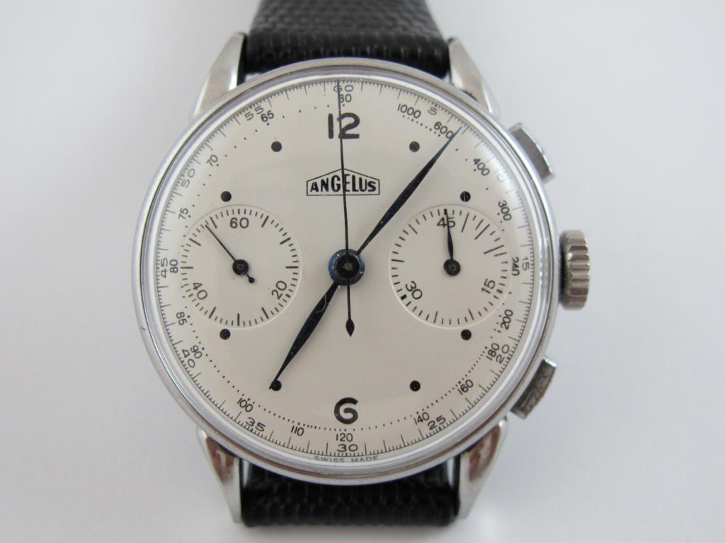

    Hello guys,
    I'm currently deciding if I will buy one Angelus chrono that I'm lurking around for some time.
    I did pretty thorough research, but I'm not a big Angelus expert.
    From what I can see from the pictures, I'm pretty sure that nearly everything is genuine, movement is 100%, the case seems consistent with some of the designs of Angelus, crown and pushers are standard of Angelus from 1940s and even hands seem to be genuine.
    One thing I'm not really sure about is the dial. One problem with Angelus is that they sold their watch, citing from 1940s ad, with an assortment of dials, so you chose setup in means of movement/functions and case, and you could then choose from several dials they had. So it is pretty inconsistent across the range of movements and cases.
    So now to what seems odd to me on the dial. The logo, I just can't find any corresponding watch or reference to this kind of logo design, ale are pretty similar, but it just isn't right. Also, the combination of numbers for 12 and 6 and dots for rest, are standard, but I never saw the same design of the number 6 on any other Angelus watch. The tachymeter seems to be one of the designs Angelus used. So overall, it looks good with few inconsistencies. But they are so small, that I just can't imagine someone put so much effort to make replacement design.
    So what do you guys think? Do you have any similar experience or knowledge I don't have?

  2. DirtyDozen12 Thanks, mystery donor! Jun 13, 2019
    2,686
    4,618
    Dial has been refinished. This greatly impacts value. I would look for another example.

  3. Ilumidam Jun 13, 2019
    13
    Right? I think too. But it is priced so cheaply, just under 1000 euros, that I would be maybe willing to buy them, just for the movement.
  4. DirtyDozen12 Thanks, mystery donor! Jun 13, 2019
    2,686
    4,618
    Examples with original dials can be had for a similar price: https://www.ebay.com/itm/SUPERB-ST-...=true&nordt=true&rt=nc&_trksid=p2047675.l2557Purchases made through these links may earn this site a commission from the eBay Partner Network
    In terms of value retention and usually enjoyment, it pays to spend more for a nice, original watch than to save a bit at the outset for something that is not entirely correct.

  5. Dan S Jun 13, 2019
    18,814
    43,264
    Honestly, that dial is really terrible and the movement is in rough shape. I think the OP should be patient and wait for a better example.

  6. Ilumidam Jun 14, 2019
    13
    Thank you guys, I will be waiting for next one to my liking to show up.

  10. Larry S Color Commentator for the Hyperbole. Jun 15, 2019
    12,539
    49,803
    Junk is junk. Why the heck would you want to spend still significant resource on junk?

  11. Dan S Jun 16, 2019
    18,814
    43,264
    We see this all the time, don't we? Someone asks for advice, and members tell them all the watch's flaws. And then they ask what it's worth with the flaws? ::screwloose::

  12. Luxostore Jun 24, 2019
    12
    33
    The Dial is a re-dial not a refinished. Its look terrible!
    imho, the best things here , is run away as fast as you can.
