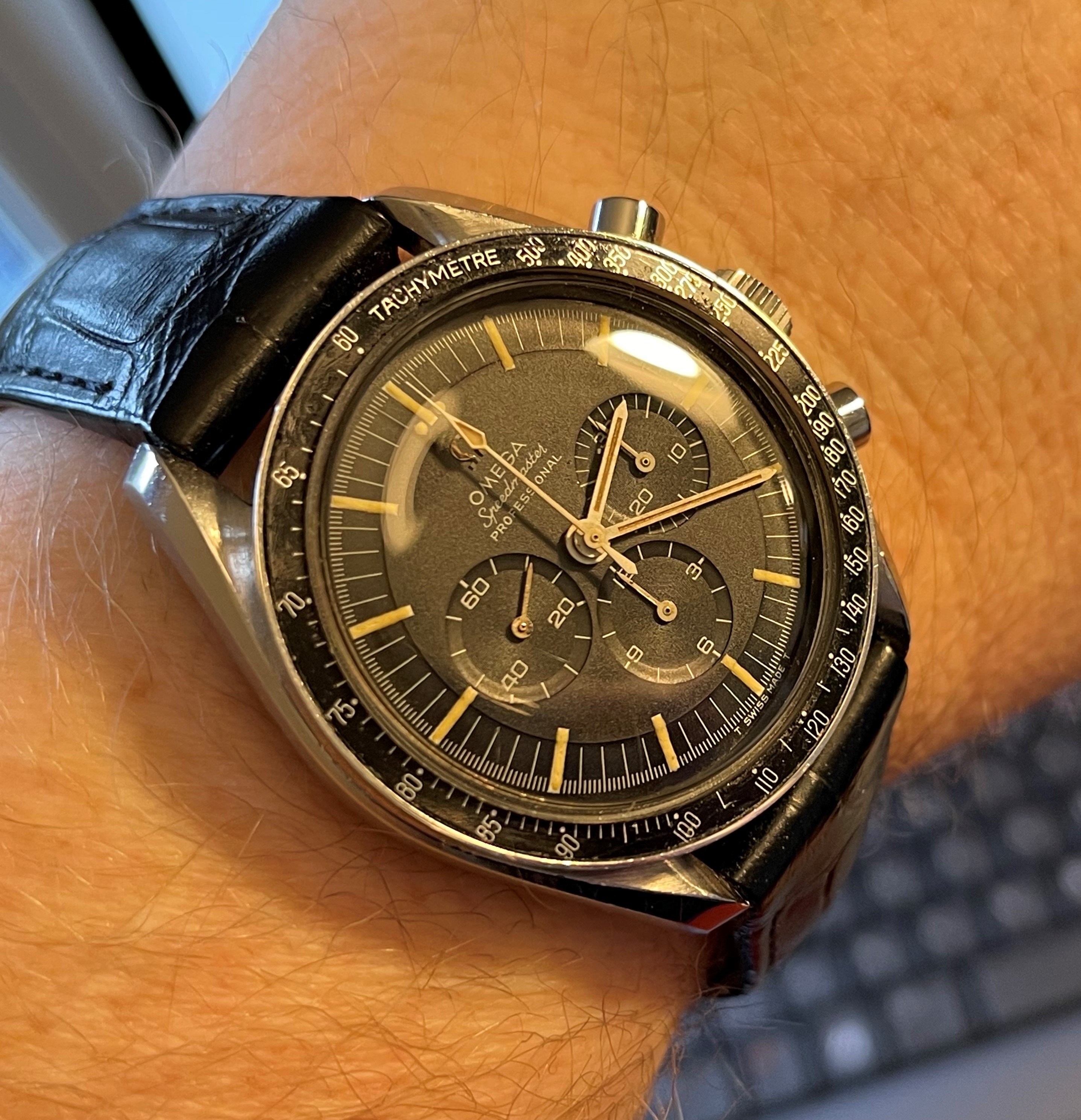

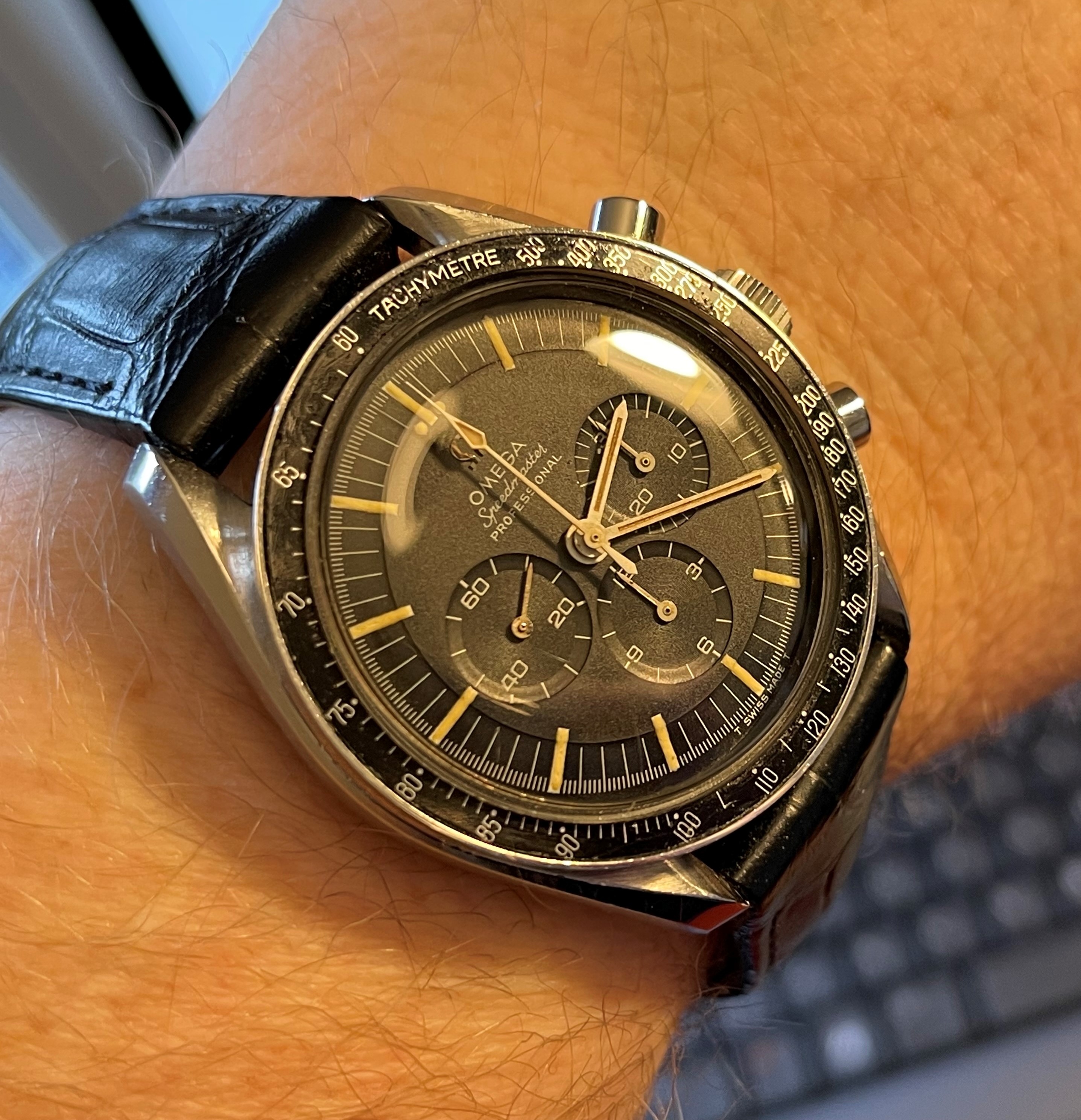

My daily is a 1968 Speedmaster 145.012 Cal.321, It runs superbly chrono running or not and I would say its with in 2-3 seconds a day. It's an amazing watch.
