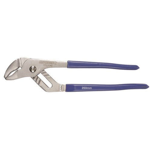

Once you have both springbar ends correctly aligned with the teeth biting in to the mesh strap, lay it down so you can compress and secure the two little tabs to hold the whole springbar end assemble again.
To prevent marking anything place a strong plastic bag etc over the top.
Next use pliers to compress the top springbar end (now underneath).
Once compressed back to its original position, use the nose of the pliers to fold the tabs inwards so they prevent the two toothed springbar end pieces from coming apart.
