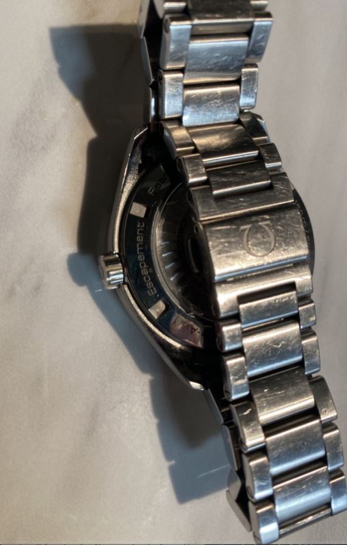

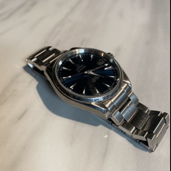

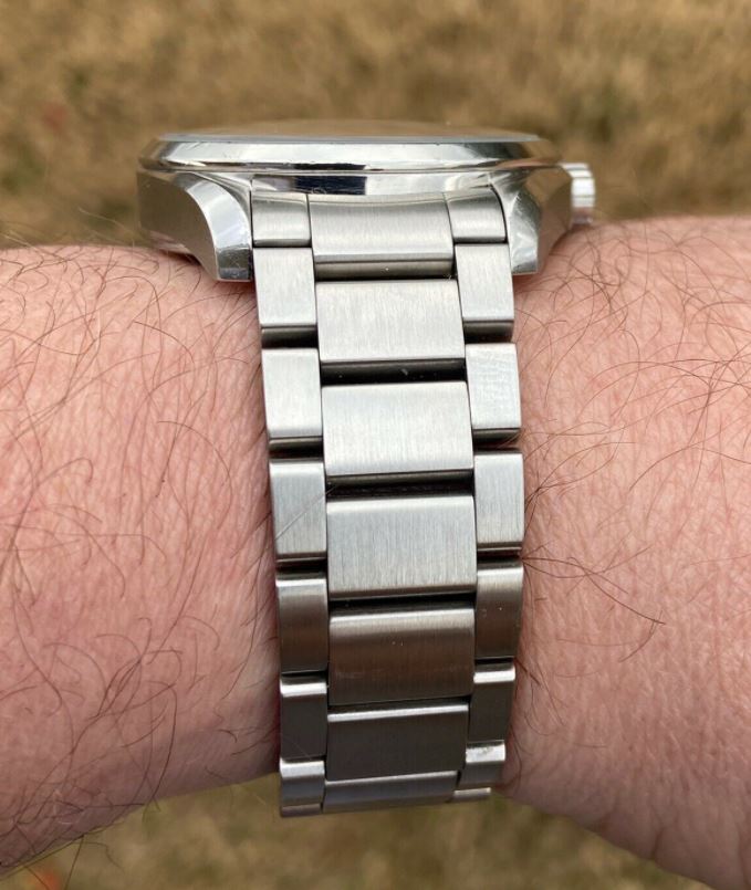

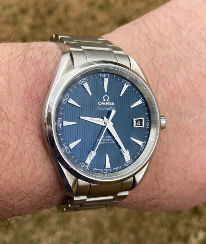

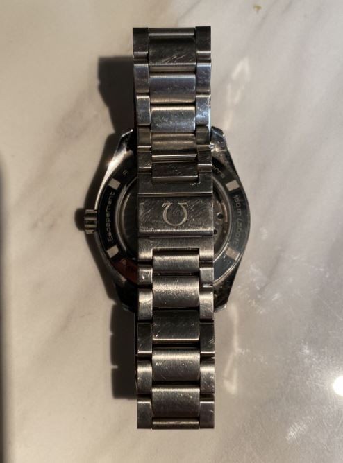

I have been looking for an Aqua Terra "Skyfall" in 41.5 for a very long time. I came across one on ebay that was very much abused and looked like it had spent much of it's time on the wrist of a concrete worker. I was high bidder at $2700 usd. My intention was to send it off to Omega for a service, but after receiving it, I realized it doesn't need a service. For the past 4 days it is only -1 second. So, I spent a couple hours re-brushing the bracelet and also polished up the bezel a bit. This one will be a keeper. When it is time for a service, I will ask Omega to replace the bezel since it has some rough spots that Cape Cod couldn't take out.
Looks great, did you initially use scotch brite pads?
84
76

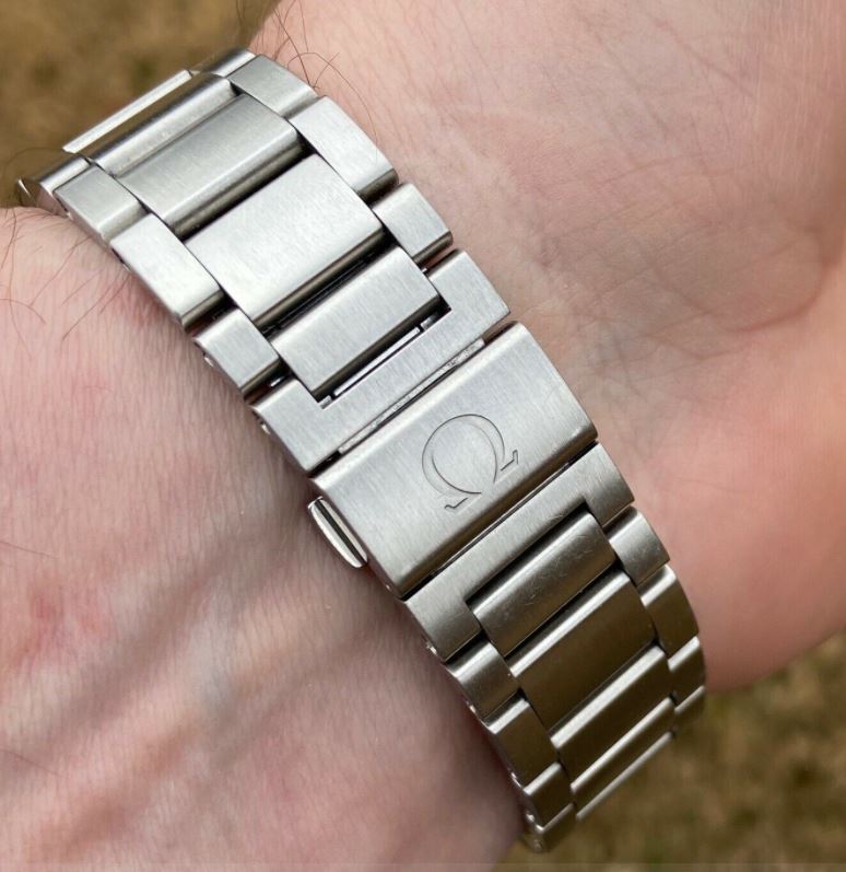

The bracelet was so bad I actually used a small piece of sandpaper to get all the deep scratches out. I then used a gray scotch brite pad to go back over it. I don’t have an ultrasonic cleaner, so I dipped the bracelet in a small pan of boiling water to get all the grime and grit out of it.
For the bezel, I taped over the crystal with masking tape and cut away the excess leaving only the bezel exposed. That allowed me to polish the bezel with a cape code polishing cloth without damaging the crystal. I used some dawn dishwashing liquid and a toothbrush to clean the watch head when I was finished.
389
569
Good job, you should be really pleased with that result.

Great job on the polish and finish mate, must have taken some work.

I've found that a Dremel tool with the cloth material polishing wheel attachment works miracles in a few of my applications. I use the reddish polish that comes in the Dremel kit. I recently purchased a Tag Heuer Monza Chronograph and the polished bezel was scratched up, no gouges, but still scratched. Taped it off and methodically (patiently) did one side of the square bezel at a time and it did wonders. Looks new. Don't try to do everything in one pass. The other application was on my 2296.80 with rose gold. The bezel and links scratch easily and the same combination put an "as new" shine on it. Light pressure is your friend. I have performed wet sanding on one of my Omegas due to a deeper scratch and then worked it out with less aggressive abrasives, culminating in the above mentioned polish. Actually got comfortable with this process while buying, restoring, and selling stainless steel firearms. Watches are just on a much smaller scale. I use the above mentioned pads on brushed stainless steel and titanium and it works great.
